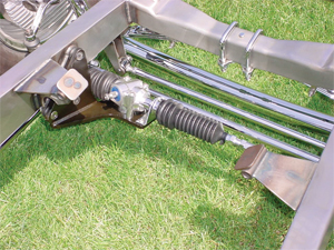

    Could somebody using one of these Unisteer setups please post some good close up pic's of how the bracket looks and attaches to both the chassis and the steering unit.

    I bought a close out unit which came without a bracket.
    I dont have a vega steering bracket on my frame so I was just trying to visualise how the original brackets work.
    I found this pic, but would hope to see what others have done when not running with the vega swap.
    I'd be real keen to know what thickness material I should be using for this bracket...

  5. Why not just pick up a vega bracket? They are only $15-20. Then you have the right thickness as well as not having to dick around trying to get the holes spaced properly.

    The unisteer unit did not come with its own bracket which I though would not be an issue since I did not have the vega setup any way.
    Now I'd like to see what brackest folks have when nit installing to a vegas bracket.

    I worked on a customers car last month that had one and was surprised by the amount of flex in the factory bracket. I did not get a picture of it sorry.
    The factory adapter bracket does not any gusset on it and the angle built into the bracket (97 degress) did not set the tie rod coming out of the rack at the correct angle. It was not at the correct height either.

    friend of mine , benflathead, his dad has a unisteer in his 33 roadster. I drove it the other day and it seemed pretty nice to me..... turning circle was better than the most common used steering box here in Australia.
    I can try to get bracket pics but I am sure they used 3/8 plate drilled and tapped with a gusset behind it where it dropped below the chassis

    here is a pic where you can just see the bracket

    Made my own one piece bracket, copied it from a friends bracket.
    You wouldn't know the difference.
    Thanks to Maval Products for screwing me around, gave me the determination I needed to do it myself and saved plenty...
