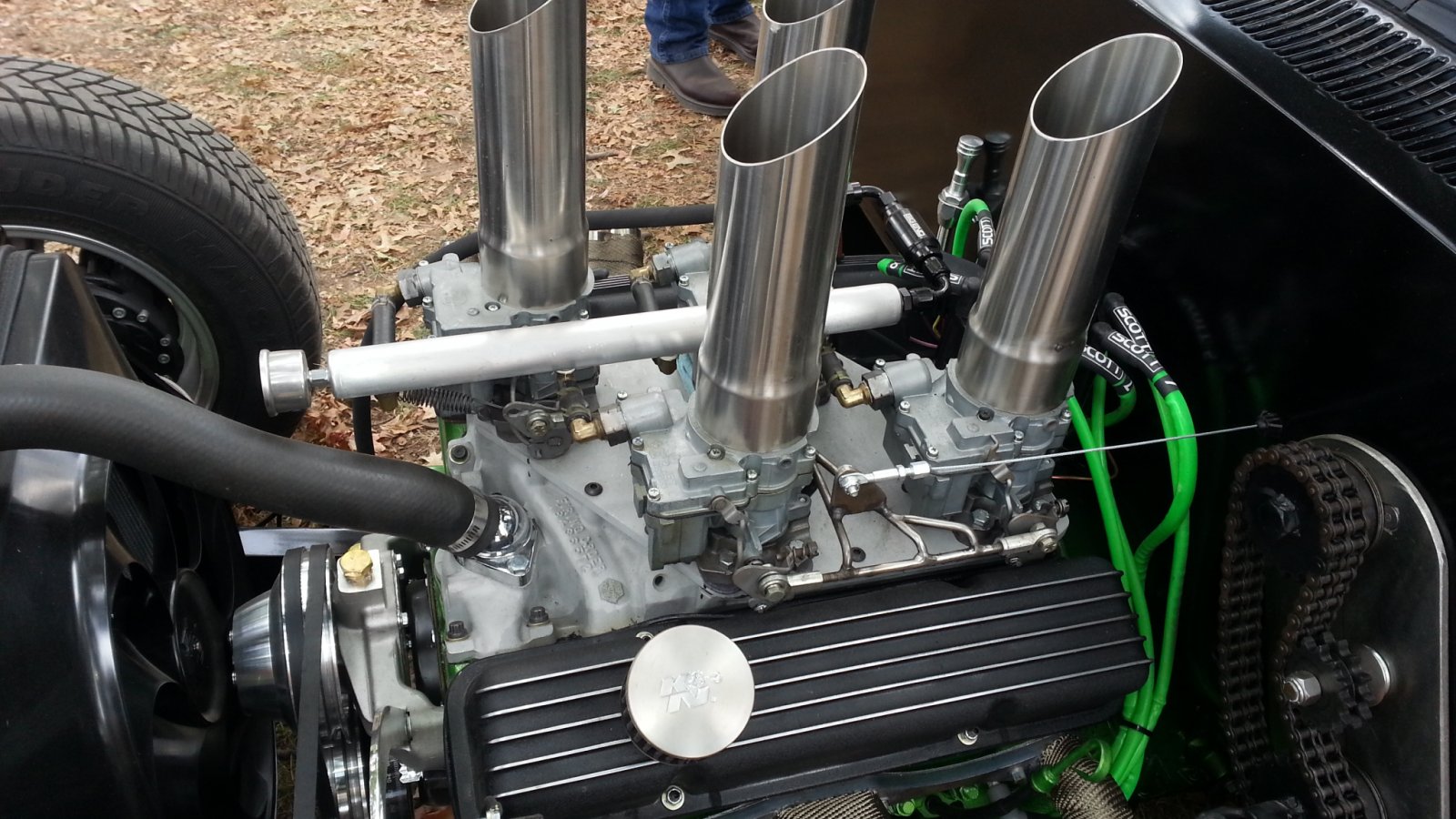

    This is the one I built. Sold it at a swap meet and found it on this.

  27. Seems to me if you're using one of these to emulate a early intake like a Man-a-fre, you could go whole hog and cut away most of what's inside this intake. Those early manifolds were all open plenum, doing this to the EFI intake would make porting one much easier.

    No meat in the ports....

    Completely off topic but picture this car on a mountain road in a turn at speed and that goofy steering chain lashup comes apart and wraps around that throttle cable!!!:eek:
