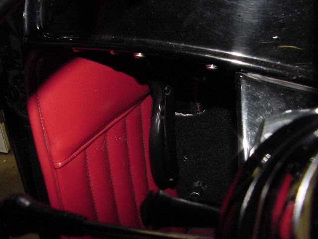

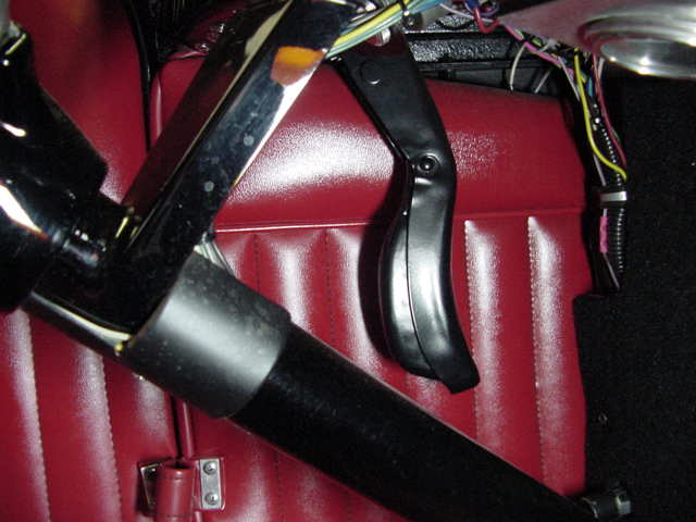

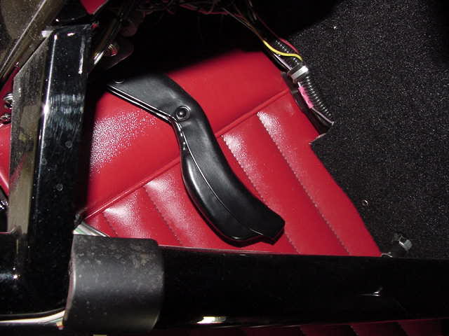

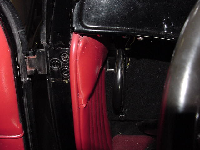

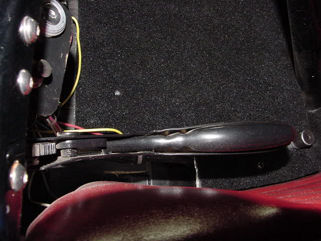

  8. Deuce Roadster
    Joined: Sep 8, 2002
    Posts: 9,519
    Deuce Roadster
    It is difficult to get a good photo ... with the steering column and the Banjo wheel in the way but here goes ...
    and the Roadster is a mess ... got caught in the rain Sunday and have not cleaned it up ... so water spots everywhere ... :(

  13. SimonSez
    Joined: Jul 1, 2001
    Posts: 1,664
    SimonSez
    Thanks heaps - that is just what I was looking for. Looks good and doesn't take up any foot room.
    The handle looks the same as my '38 Ford one, but as Bruce says the earlier ones have cast mounts that would be harder to modify. That one is working fine with the brakes on an 8" rear, and I have the same brakes on the 9" in my '32.
