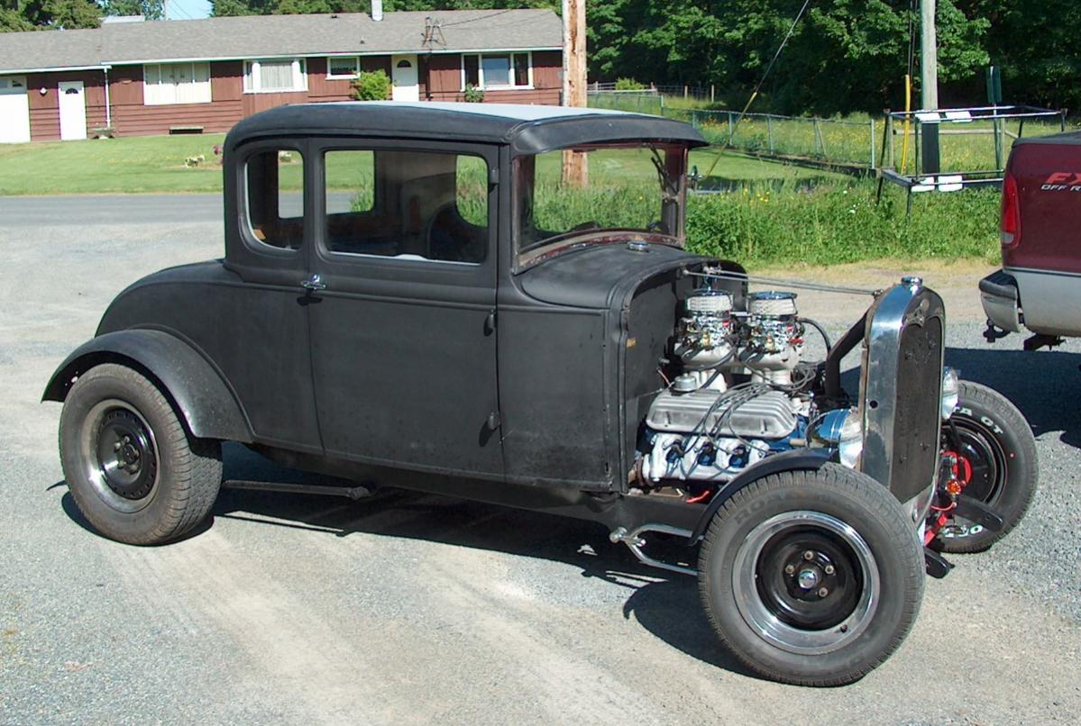

    heres a friends A coupe running a 302, the carbs are 500 edelbrock's, i'm not sure he even changed the jets and it runs great, idle is nice and smooth and lots of pull.
