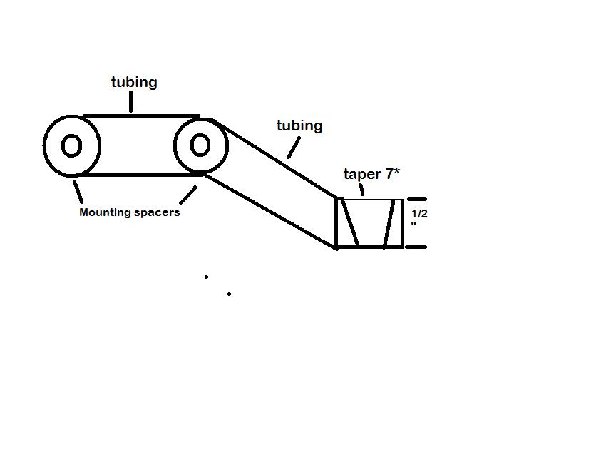

    I am planning to make some steering arms out of tubing and I am having a heck of a time finding a tubing spacer with a tapered hole so that a tie rod can be bolted in place.
    I am bending and cutting some tubing to make the arms and need the spacer, tubing, bung or whatever you would like to call it, to be welded at the end of the tubing, the tubing will be fishmouthed to the spacer and be given a solid weld.
    I have checked several places and I have only been able to find the bungs that one would use if they are splitting a wishbone and plug welding the threaded bung into the now two piece radius rod. I can find the frame brackets that have the tapered spacer already welded on but I only need the spacer.
    If anyone has a tapered reamer and can make some, I would need four of them. I would buy the reamer but at $70+ and I am sure I would only need it for this part only, it doesn't seem economical.
    Thank you for looking and help would be great.

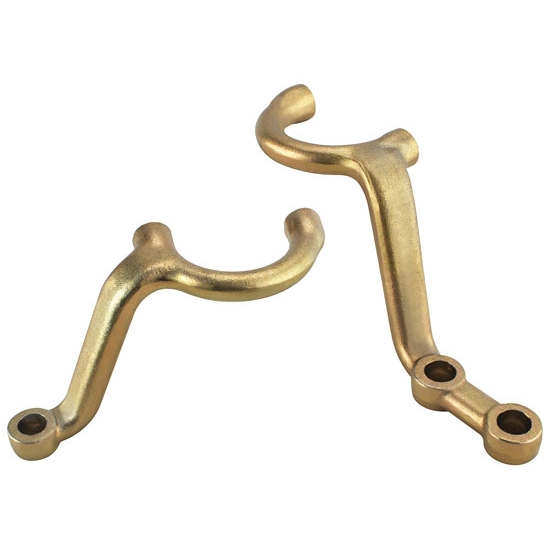

    Most steering arms are solid forgings or bar stock, not tubing. I suppose it depends on the weight of the vehicle on which you intend to install these parts, but it's no place to use material that doesn't offer a significant safety margin in strength.

    I was thinking of tubing since it is a light vehicle but will be switching to solid tubing for safety sake.
    Thanks Rotten for the advise.
    Thanks Tman, if I have to repair a taper, this sounds like good advise.
    See the pictures below for my idea.
