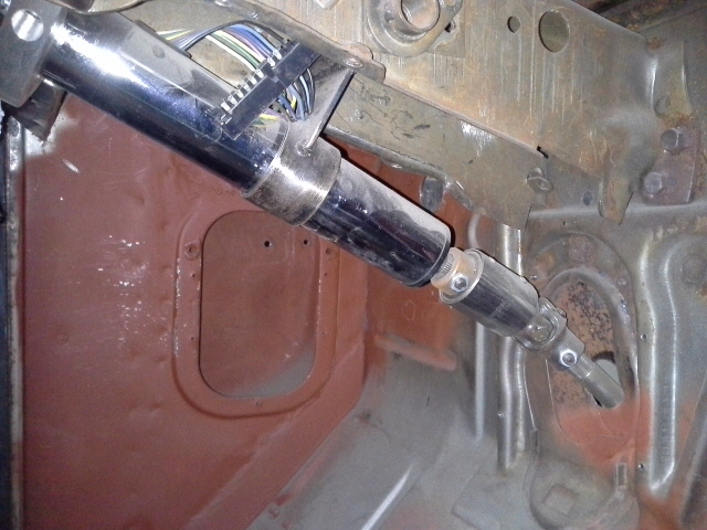

    This is the column in my 66 Suburban, no clutch pedal but you get the idea.
