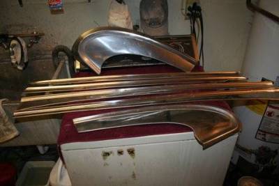

    I have a chance to purchase this trim, but it looks like the base of each side is different. is worth over looking for $500.? Is one off a two door one off a four door? It is for my 51 merc.

    Thanks Fordy, how about now

    The way the photo is presented it appears that the top piece of curved trim may be shorter than the bottom one. I can't tell the length of the other pieces, but that is info. you need to know. The top piece makes me think it might be a mixture of 2 door and 4 door trim. The 53 Buick trim that works on a 2 door 49-51 Merc is the 2 door trim from a Roadmaster or another 2 door Buick. In any case, I think you neeed 2 pieces of the 2 door Buick door trim since the one stock piece is not long enough. I recall it's only 48 in. long so it has to be cut and welded using another piece. The trim from a 4 door Buick will not fit on a 49-51 Merc as the pieces are too short and the curved piece is not the same contour as the 2 door curved piece. I am hoping that other HAMBERS who have used Buick trim can chime in here and help. I make these comments based on the set of 53 buick Roadmaster trim that I had a few years ago. If you can ask the seller to send you photos of the curved pieces side by side and also showing how it looks when laying on a flat table top.

    Ask the seller for a pic of the two bases only, side by side, and tell him why. There may in fact be a difference between the 2 door and 4 door bases (in which case probably the rest as well), and $500 is a little steep.

    I think Fordy is right. at first glance I thought it might me the difference in the angles. the piece in front is laying down, the one in back is standing up. But I see a difference in the contour of the short (under?) side. the back one looks smoother, simple. bottom looks ?compound

    Looks like the fender pieces are missing, there should be 5 pieces per side

    Both are 2 door, the 4 door would end horizontally near the bottom. The difference is due to different rocker trim; got to be 52 vs 53 or Roadmaster vs Special/Super. In any case $500 is too much for mismatched trim.

    The 2 door 53 Buick has 3 pieces of trim per side if you don't count the long rocker moulding. The 4 door may have 5 counting the little piece at the bottom of the rear curved piece and then counting the rocker moulding..

    yep, $500 too much for a little trim

    I think if you look at the skew of the washer, you can see that both pieces are almost as wide as the washer, so it is actually a optical illusion.

    Not counting the horizontal rocker trim, the 2 door has 3 pieces per side and the 4 door 5 pieces (including the sliver between the doors)

    Sorry for the misinformation, I was wrong. Should be 4 pieces with the rockers like MMCarnut says.
