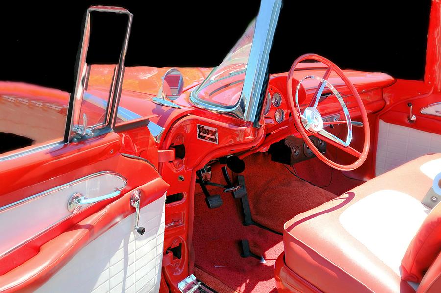

  20. That's a '56 in the picture, first year Ford had a dished wheel. A '54 wheel is flat and probably about the same diameter as your '50 wheel, so it wouldn't help you. As far as an attractive wheel, I like the '55 Ford wheel a lot, but it's large diameter and flat. A '57-'58 Ford wheel I think may be a little smaller diameter than the '56 wheel pictured. Best I remember, '49 and up shaft has splines, '48 and earlier has a keyway. I put an original Ford wheel for my '38 on a '77 Monte Carlo column. The Monte Carlo shaft is splined but has the same taper as the Ford shaft. Just cut a keyway in the GM shaft.
