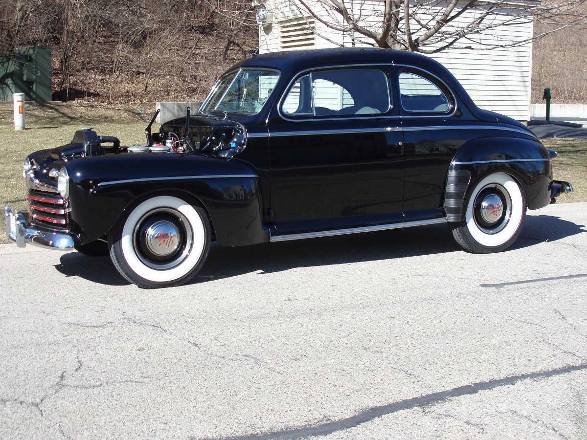

    Been waiting for this day since I started my re-do of my 46 coupe last fall. Added a fresh .040 over 283 with the original trans, rear end. Sid's dropped axle, reversed eye rear spring, and a load more. Just got back my exhaust system from having it coated that I fabricated, and re-installed it. Been dying to drive it, and today was the day! It goes down the road great, rides, stops good, and the 283 was just the ticket for this car, (even though it was a pain in the ass on some parts of the build). Still have some things to do, but all the time consuming crap is done. Going to do The Wisconsin 100 run this spring. Thanks for looking!, Mike. P1010005 (4).JPG

    Hi Chris, I used the Hurst front motor mount, wanted to be like the "old days" install. Used a wilcap adaptor with the merc pressure plate and 101/2" clutch. The install was easy, just a lot of other things that took time. Well worth the effort.

    I really like it better then the flatty, I have the clutch adjusted just right and it shifts smooth with no grinding. The original drive train will be fine as long as you don't beat the hell out of it. Thanks, mike.

    Hi Richard, been driving the car a lot when weather permits, and I'm real happy with it. runs good ,stops good and rides good. workin on putting turn signals in. The tires are 6.00- 16 and 7.50-16. Hope all is well with you. Thanks.
