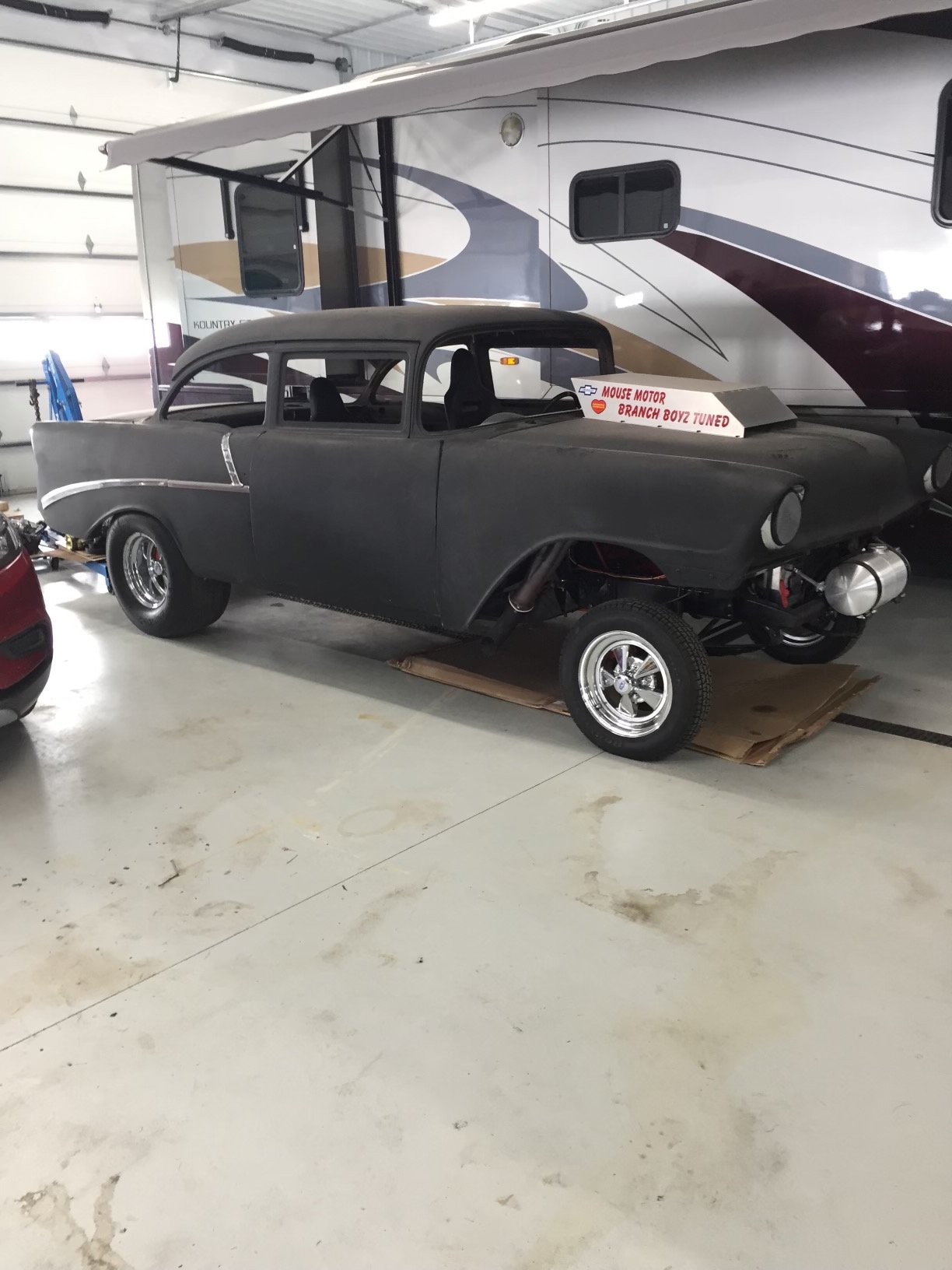

    As it sits today, but 4 matching old chrome reverse wheels coming this spring.

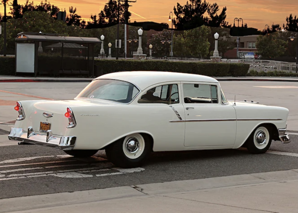

  2. Here's a picture of the 210 I owned in the 80's. My buddy has owned it since then, painted and freshened about 15 years ago. I still like it. (I have a 56 Nomad now) IMGP2226r.jpg

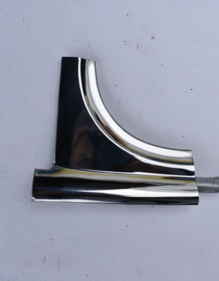

    Thinking? Like going 150 route rather than 210? Don’t let me sway you in any direction. Make it yours. If anything, you learned some details. This way you can explain why your 56 is trimmed out the way that it is. Simple answer to give to a Tri-Five purist that ask’s or say your car is wrong. Simple answer to give. Yes it’s a 150 with 210 trim. If it truly is a 150. This way you sound smarter than them.

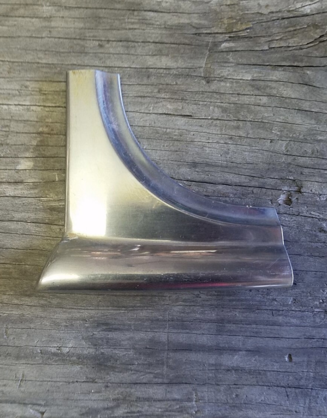

    Look thru your windshield trim. See which of these lower corners you have.
    210/BelAir Corner IMG_3827.jpeg

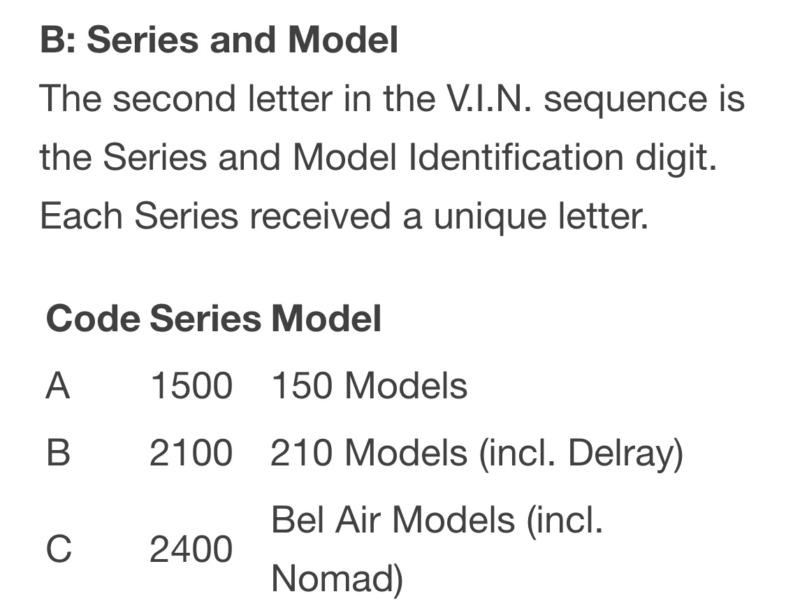

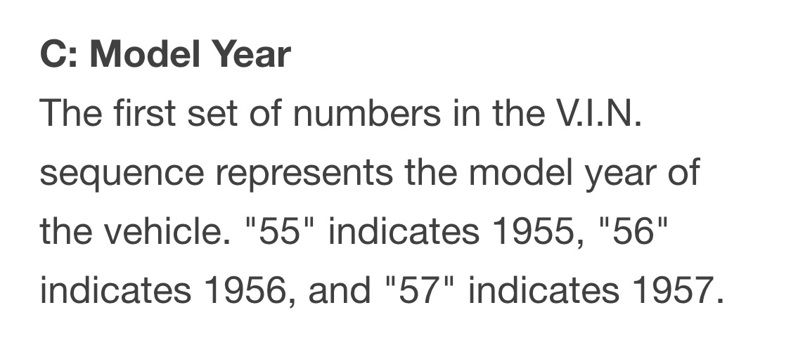

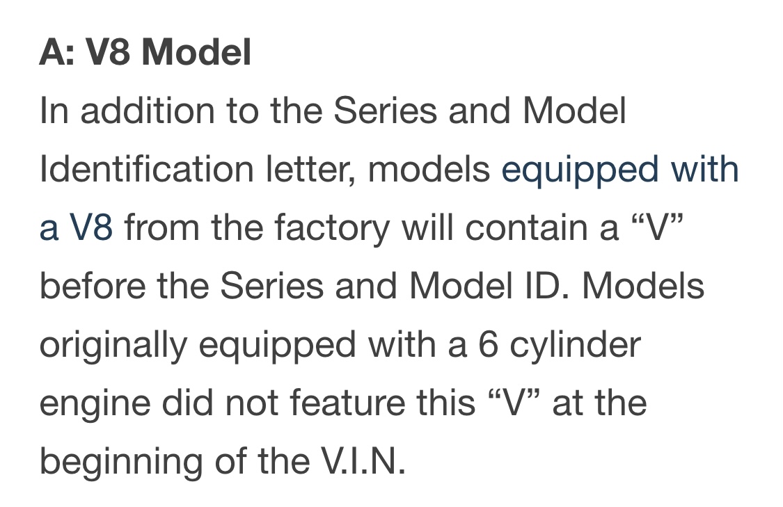

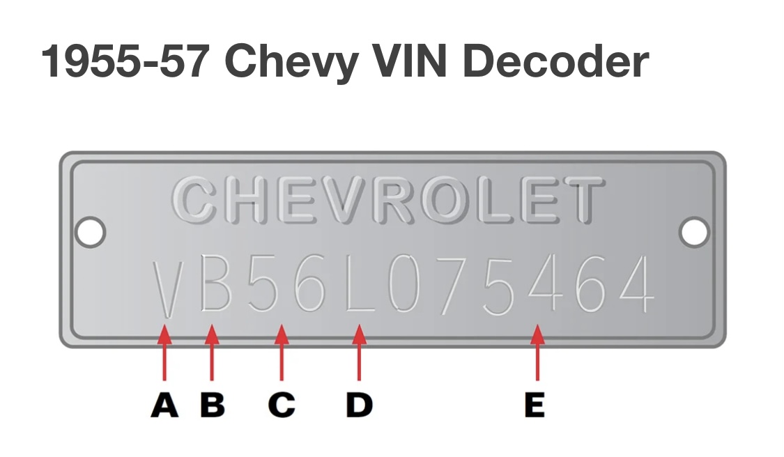

    The "VIN" (which isn't really a VIN but basically the car's ID number) on a '56 should tell you whether it was a 150, 210, Belair, Corvette or Sedan Delivery. There's also a digit for whether it had a V8 or 6 cylinder. Interestingly enough, the ID number does not say what body style it was (4 door, 2 door sedan, 2 door hardtop, etc).

    I found the windshield trim; it is 210 lower corners
    I didn't find a vin tag as you described, found a body tag on the fire wall
    STYLE No 56-1011D
    BODY No 10286
    TRIM No 575
    PAINT No 707D
    Looked at the title and it don't list the A and B code letters, starts at 56
    Lot of sins happens to old cars over the years :oops: learning a lot here, would love to make it the 150 but it's not in my budget, I'm not a body man and would have to pay one to weld in all the holes, since got most of the correct 2 door 210 trim except for correct rear fender trim for a 210.
    I'll get the extra hole welded in, found out body style No 56-1011D means it was born a BelAir
