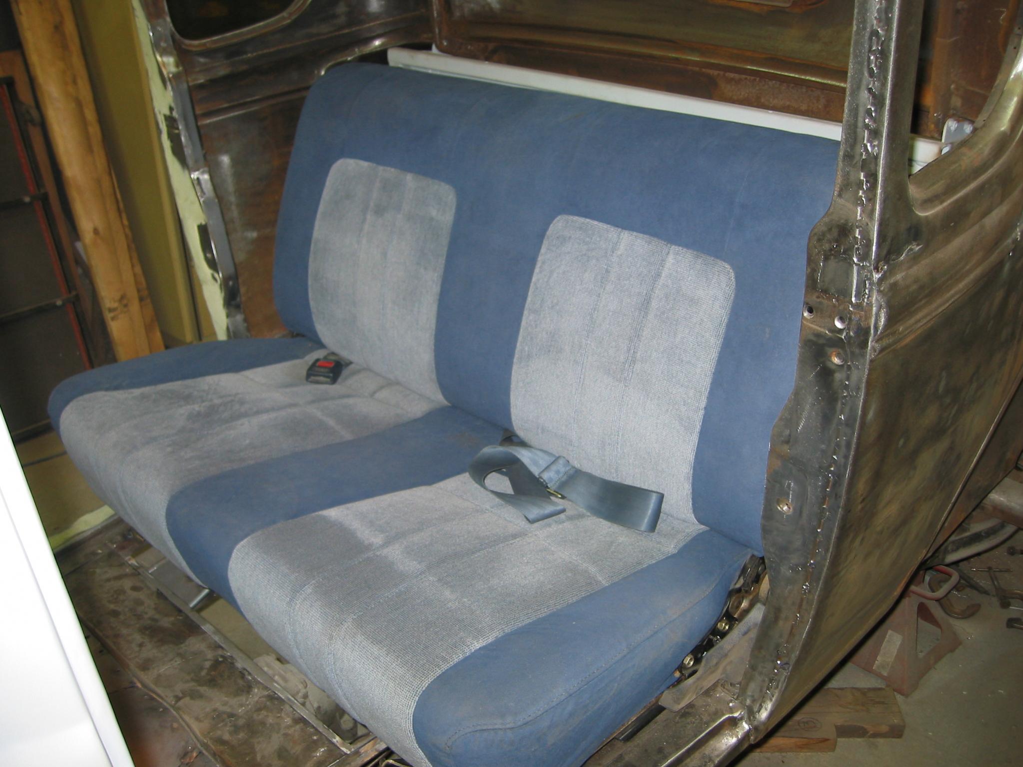

    I did not use one, but I guess you could. The MPV seat I have Reclines nice so I wouldn't want it. As for underneath, it's all stock & great for storage, I even used existing holes on top of the seat riser to mount, no drilling just tabs welded to the seat struccture

    The MPV still slides forward & back, tilts forward & back, & has a passenger seatbelt which works out prefect for my 3 & 8 y.o.

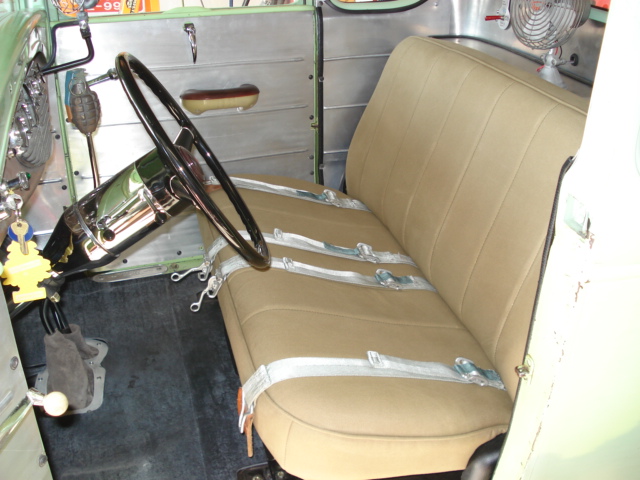

    I used a Dodge Caravan seat with the fold down feature so I could better make use of the space behind the seat. I kept my package tray, and fabricated a glove box for small items like registration and a few tools, etc.
    I used the Caravan seat mounts...just cut 'em down a bit to get the height and angle I wanted, and welded mounting feet to them. There's even a pull-out cup holder under the seat that was stock, and I kept that feature, too. I got a deal on some military aircraft upholstery material, so I had the seat re-upholstered with that.

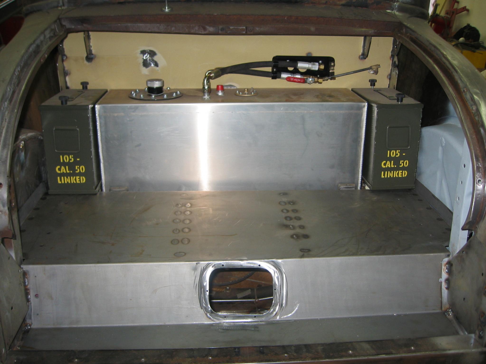

    Mazda MPV seat on sliders from a late 70s Ford to give a finer adjustment and mount the seat lower to the floor.
    Had to retain about 1/2 of the package tray so the bulkhead installed behind the seat would clear the gas tank in the trunk.
    Wish I could have eliminated it totally as leg room is in short supply with the reversed and recessed firewall.
