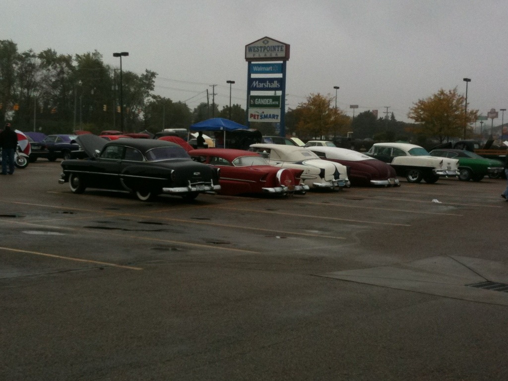

    ImageUploadedByTJJ1360065224.468974.jpg Paul, I know this wasn't what you were asking for, but I LOVE this pic! :D I also love this one. ImageUploadedByTJJ1360065559.506381.jpg
    As far as MY car goes, I don't want to lay frame. I'd like a "period" amount of drop, like the Hirohata or Moonglow. I just don't feel I'm there now. I have pictures of my car next to fellow HAMBer cars that make my car look jacked up!
    Before leaving: ImageUploadedByTJJ1360066019.903965.jpg
    And now playing with the other kids with their air shocks :(
    ImageUploadedByTJJ1360065679.170925.jpg ImageUploadedByTJJ1360065847.316778.jpg
    I thought I was low, but look how high up in the air I am!
    I guess I should get a picture of the underside of the car, it's just going to be difficult and I'm not sure how much you'll see, but I should do it. The front has been modified with a Mustang II.
