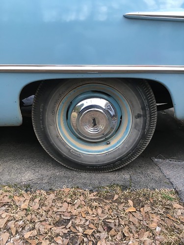

    My Buddy Don has a 51 Merc and is running 6.70-15's bias ply and he says it drives great, I think he ditched the radials for these 2-3 years ago Truman.jpg

    6.70 15 actually isn't small and skinny as far as tires for a 51 Merc go. As Mark showed they look right and fit right.
    I've never got a grasp on why guys think the L series aka Caddy limo tires look good on early custom Mercs or Fords or Chevys. Maybe because some of the magazine cartoon artists drew them back in the day and they go from that.
    I'm pretty sure these were 215-75 15 which comes out to 710 but the car came with 7.10 tires on the rear in 1963 when I bought it and they looked huge compared to the fronts.
    This is about the largest diameter that looks decent.

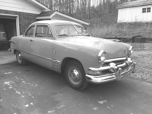

    I guess you could go narrower are you going to run the flatty or a lighter motor? I like radials cause I just never had good luck with the bias they make now. My 51 merc 0EE7AE01-48F2-4A3E-B064-01531F69E815.jpeg 0EE7AE01-48F2-4A3E-B064-01531F69E815.jpeg
