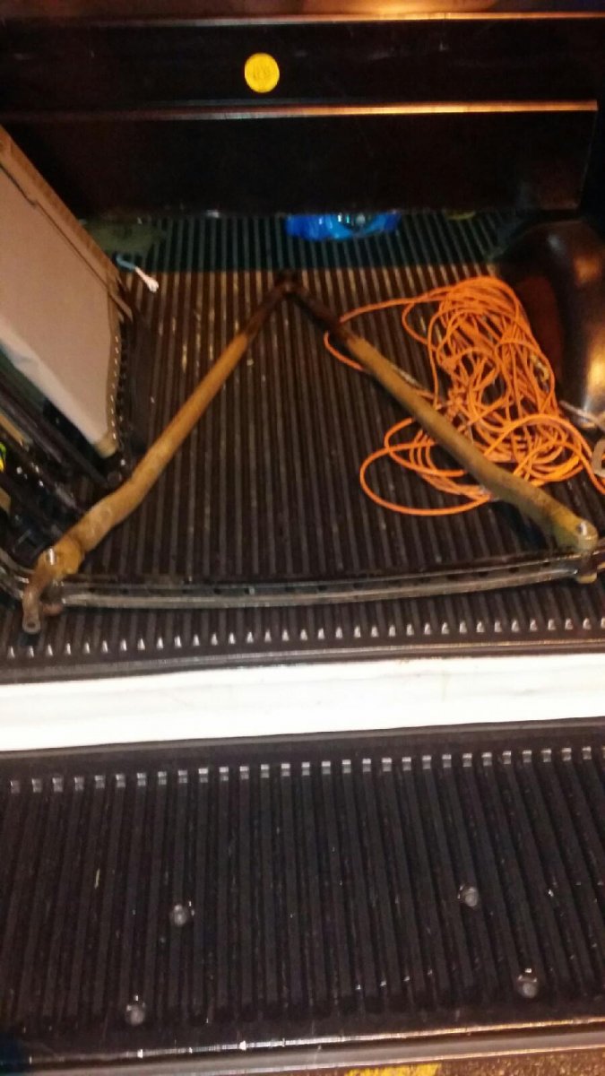

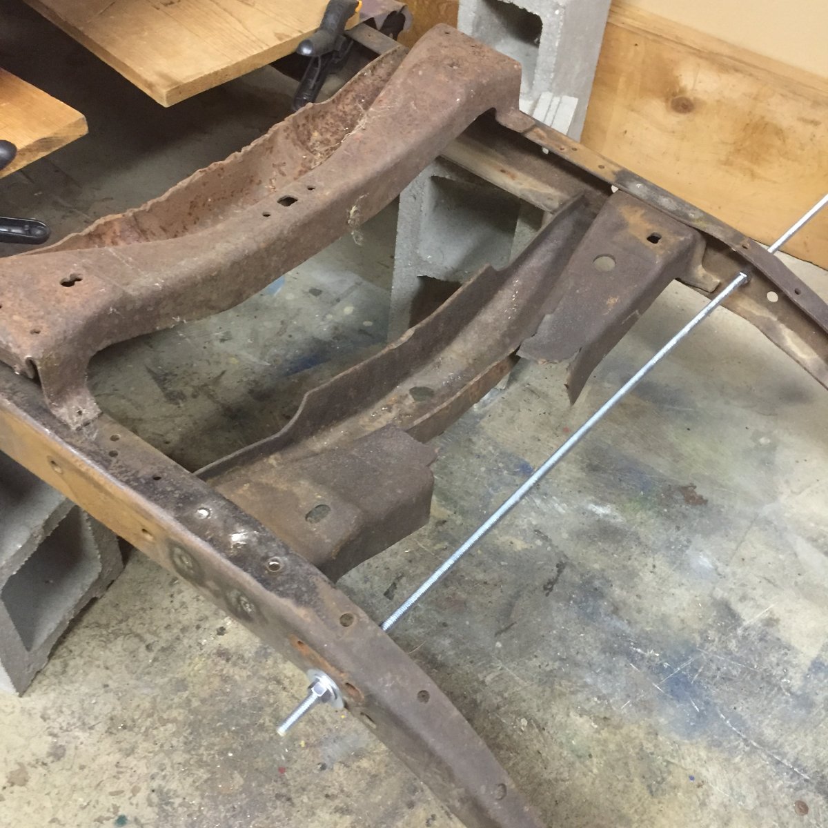

    Nothing to dramatic to post but I figured an update was due. Still dragging stuff home and figured if I could mock some stuff up, break some stuff down, I'd have more room for more stuff.
    Both in the idea that I can just put stuff on the car instead of laying it next to it, and getting rid of stuff I don't need.
    A lot of muscle and I got the perch pin nuts off. Stopped before I mushroomed the bolts to bad... Hopefully... I'll visit a torch today to get them out so I can harvest the wishbone.

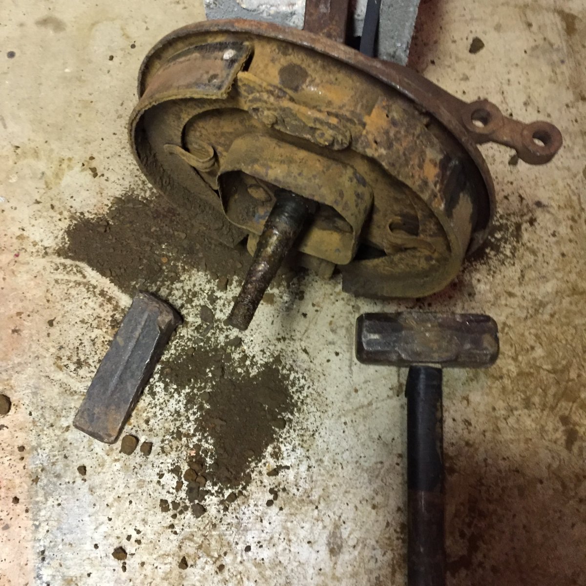

    In the process I tested how weak cinder blocks are in the wrong direction. Wow. image.jpeg
    I also got to work on grinding out the rivets in this tore up front crossmember. I'm about half way there. I've got an older model to replace it with. It has slightly different holes, I'm thinking my current one is late 29-30 because of the radiator drain hole and lack of tube shaped truss's in the back area.
    I'm planing on putting new holes in the "new" crossmember so it'll line up with the existing frame holes. Figure a crossmember can fit in a drill press and save me some time compared to trying to drill the frame which is honestly like to avoid adding holes to anyways. image.jpeg
    Anyhow there's some updates, sorta :)
    And yes I'll brace the frame better before I yank that cross member ;)

    Got the axle and the wishbone separated and one spring hanger cut off and about 70% trimmed and shapped. That shits beefy! Lots of working sculpting it but I'm sneaking up on it surely enough.

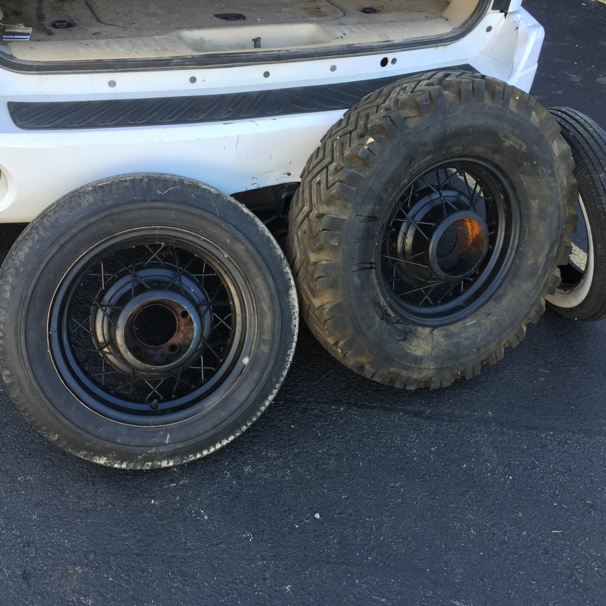

    I also rounded up my 35 wheels and borrowed some beefy tires that were just taking up space in a friends shop for mock up rubber. They are slightly taller and a bit wider than what I'll run but they will work for what I need them for.
    Either way got them mounted up so here's the rubber rubber rake for the car more or less :)

    - But one of the major things about it though, is the 18" wheels... I'm really getting more and more confident, the 4.75-17/6.00-18 combo on my '30 tudor might be the best set of wheels for it. :cool:
    I spy... a future TROG-winner with those threads! They're able to blast sand way behind! :D

  13. Actually having spent sometime in the sand you are better off with smooth tires. That is unless you have enough zot to really spin 'em. :D

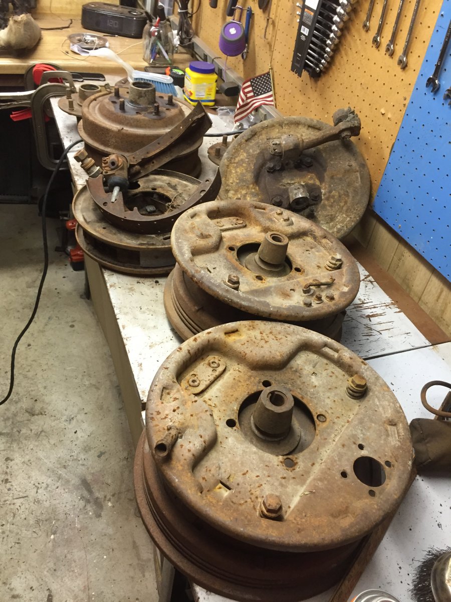

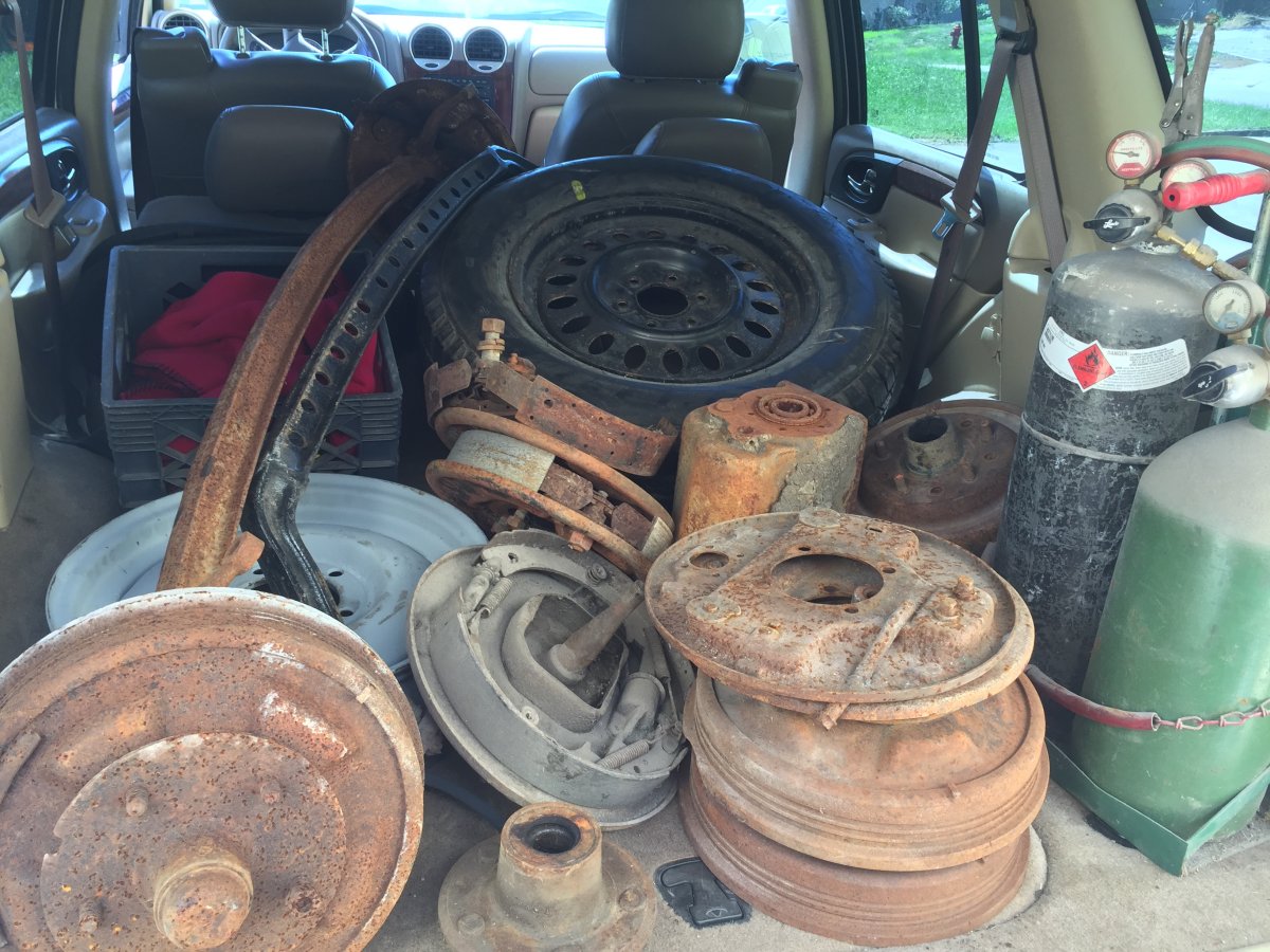

    brought the brakes and some other bits home this weekend. Made some other smallish progress as well but havn't got it totally finished so I'll hold off posting that for a minute. You guys just want to look at the photos anyhow ;)

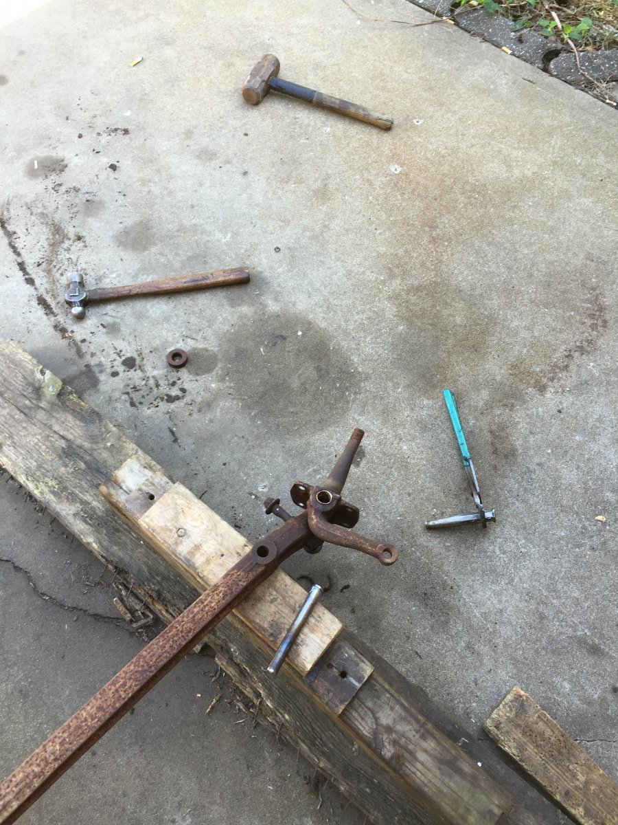

    Moved onto this 47-8 axle to get the spindles, had to get the hubs and brakes off before I could get to the king pins and have so far freed one spindle with the other maybe an hour away from being off. Those King pins are in there pretty tight and the remaining pin is even tighter that the first so best case senario it only takes as long as the first one with ol' John Henry @porknbeaner helping swing a hammer.

    IMG_3502.JPG And with a mighty swing ole' bean Henry beat the machine!
    Spindles are free, bushings are out of one of them. My new kings pins, spring perches and etc showed up yesterday. Should be on target to have it on its wheels by the end of the month.

    Got the last of the bearings out of the second spindle and chased the threads on the spindles and my U bolts. Well, the backs anyways. The fronts look pretty toasted I might have to use something else than the ones I have.
