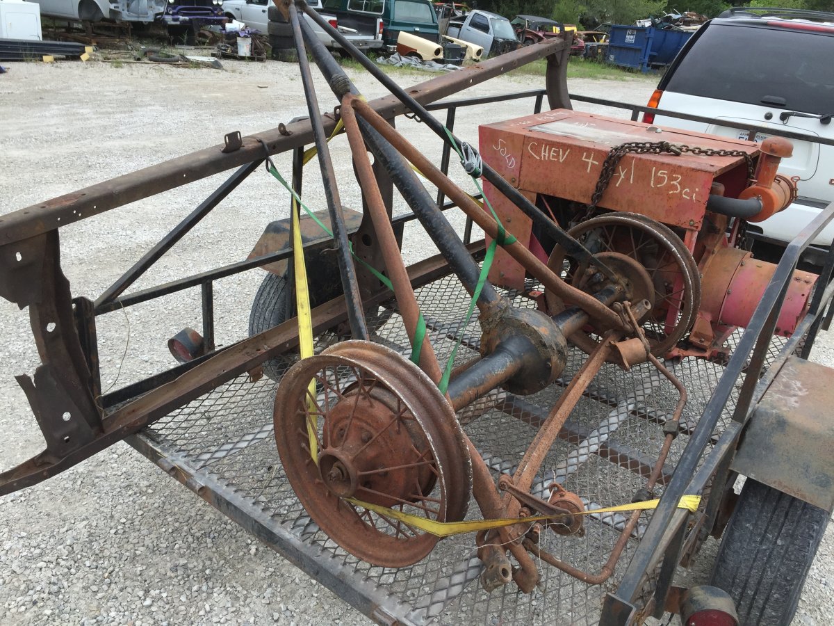

    Alright time for an update I suppose :)
    I've been collecting bits and pieces and with the interior of the 46 about done I've start bringing more of the A stuff into the garage
    They sure gave me plenty of room on the interstate lol.

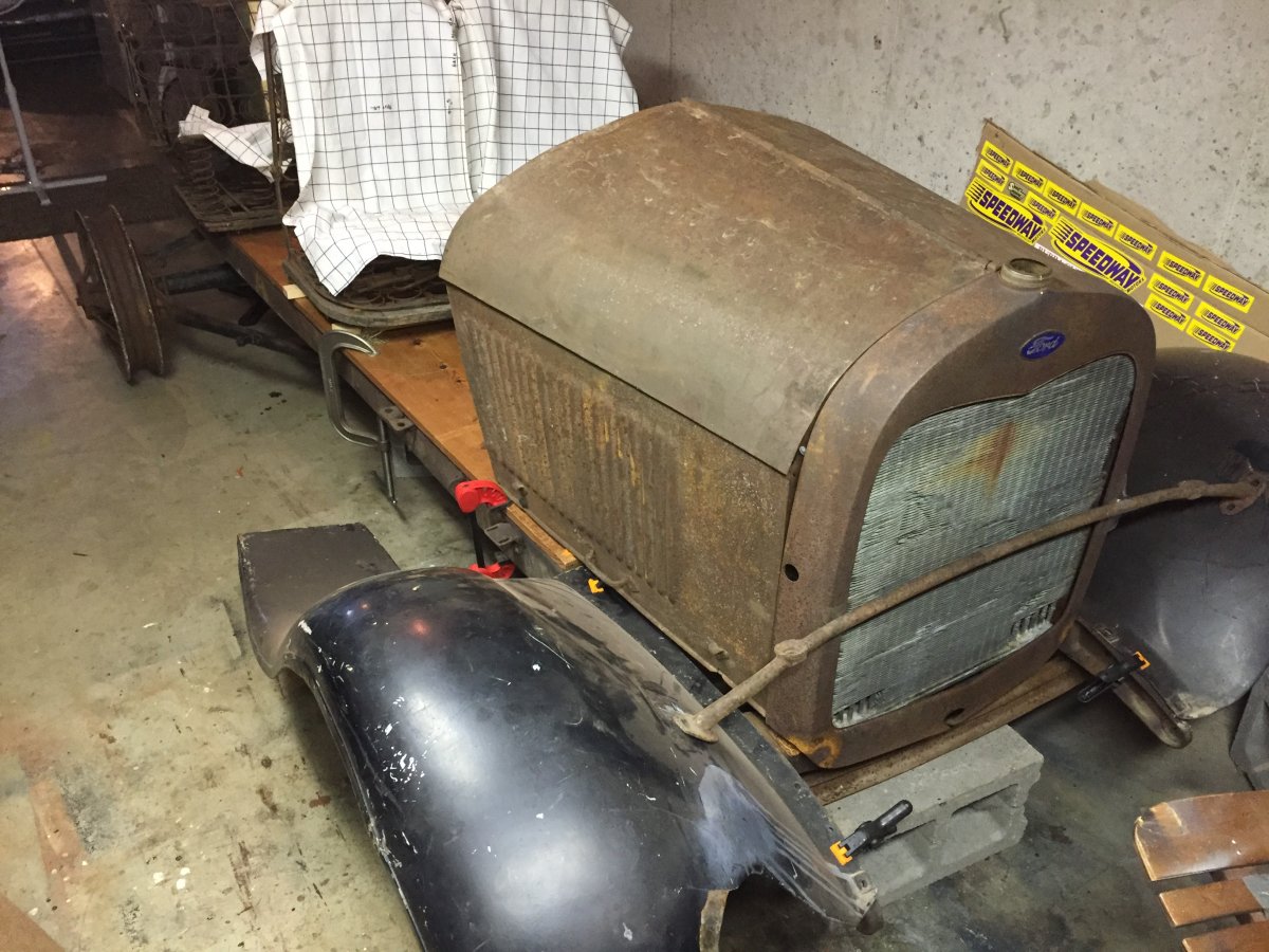

    With enough in the shop I started this first loose mock up
    Then I threw a hood and fenders on, one splash apron and some seats etc.
    There's some 35 wires wheels and tires under the fenders but you can't see them.
    Not really that exciting but I sure bounced off the walls excited about it :)

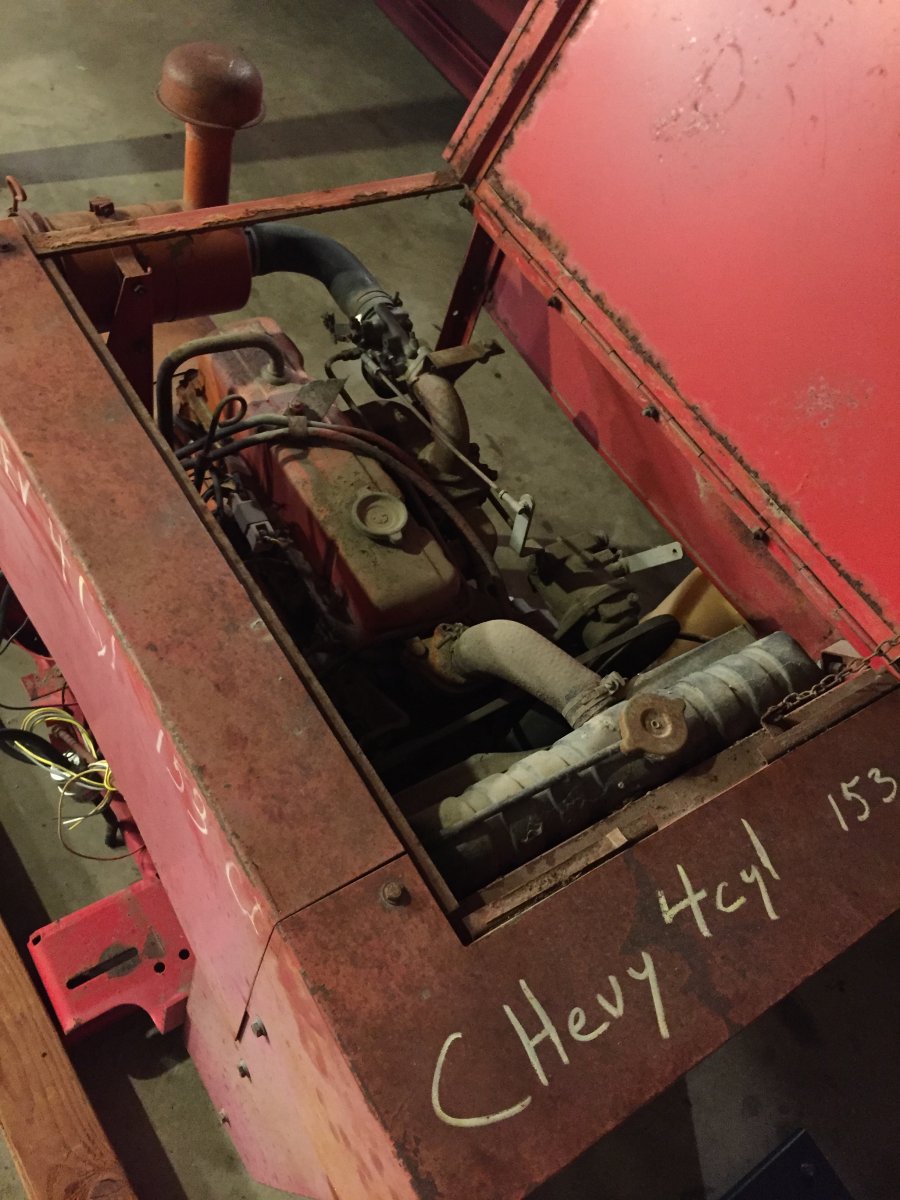

    2.5/ 153 Chevy four with a scratch made intake and exhaust with some cool stuff along the way. Might stick a different cam in it before it hits the road as well.

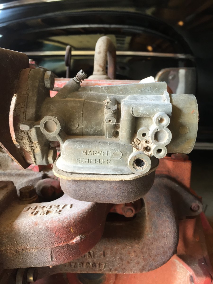

    Oh! And it's got this side draft carb on it.
    Flows about the same as a 97 and was used on tons of stuff including ford tractors. Thinking about running a pair of them if I can find a cheap second carb.
    It's a marvel schebler and I've yet to really find all the numbers on it but I think it's a VH model. Google says there should be a tag on it somewhere with more numbers. I'll have to investigate later.
    Any of you know these carbs or have an extra?

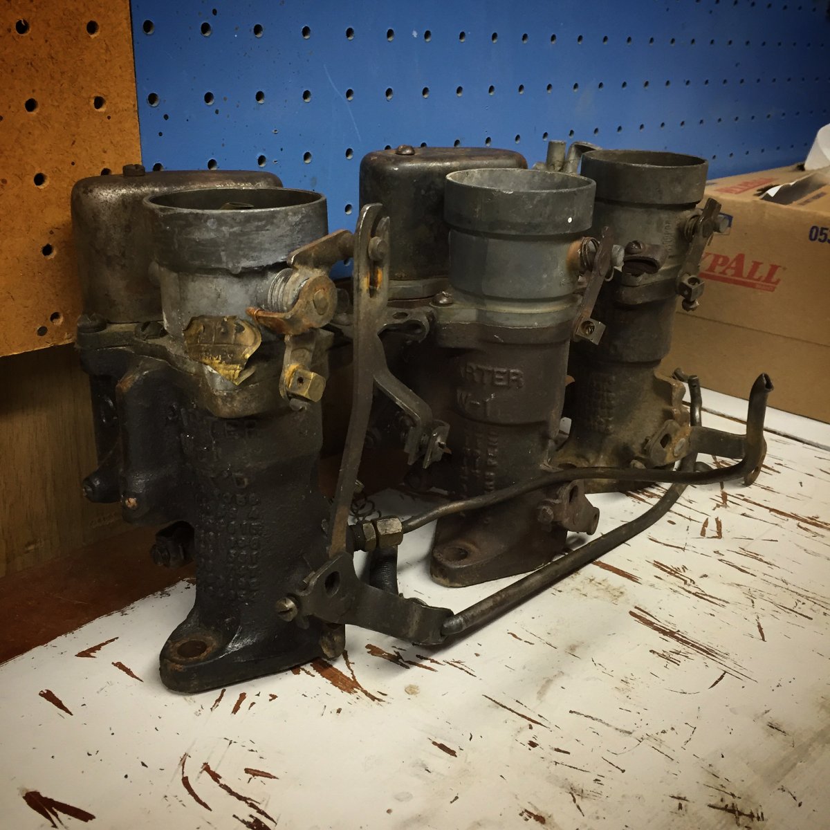

    Alright after some research, nosing around and help from a couple friends I made the call to ditch the weird side draft ( flows about 170 cfm I think) and go with a set of carter w-1's instead.
    I got three that I may be able to get two out of I need to start running all the numbers and learning a bit more about these specific carbs but I'm excited about them :) image.jpeg image.jpeg
    juan motime, kiwijeff and Dannerr like this.

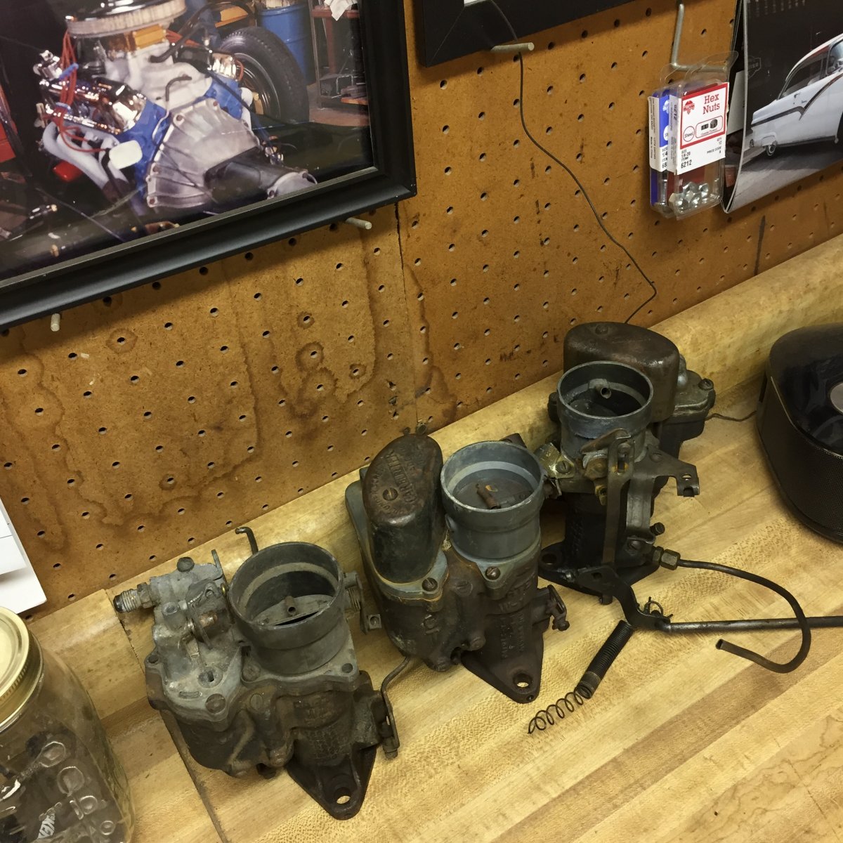

    Well via @carbking 's website I have a very complete 1932 chevy w-1, a 1934 Chevy w-1 that's a little rough and missing the cap and some little bits but pretty complete.
    The last is a 1949 Chevy that's 100% complete. That one came off my friends running driving car so I guess that one is my 1 out of 2 that I'll need. I'm half way there! Haha
  22. carbking
    Joined: Dec 20, 2008
    Posts: 3,925
    carbking
    Tim - a bit of free advice:
    Don't use the 1949, parts are unique (read expensive)!
    Generally, the W-1's to use would be;
    420s (1939-1940 Chevrolet)
    483s (1941-1942 Chevrolet)
    574s (1946-1948 Chevrolet)
    The 483s and 574s may be mixed. If you use the 420s, you need matched 420s, do not mix these. The 420s has a wee bit smaller venturi than the 483s and the 574s.
    Jon.
    Kan Kustom likes this.
  23. Tim
    Joined: Mar 2, 2001
    Posts: 19,628
    Tim
    from KCMO
    Good advice thank you!
    These are the numbers of the style not the tag correct?
    If my 49 carb is complete and I'm rebuilding it just to be safe and clean it up would you expect I'd run into needing to replace the one year only parts?
  24. carbking
    Posts: 3,925
    carbking
    The numbers I posted are the tag numbers we generally recommend for aftermarket use. They are relatively common, not expensive, and parts are readily available.
    The 49 carb (tag number 684s) has a unique accelerator pump. Not sure, but I think we are the only supplier, and I make the *&^%$ thing one at a time by hand in my shop! There are other parts which are difficult.
    The good news with the Carter W-1 is that original accelerator pumps (as are the ones I make) were made from leather. Often, one can remove the accelerator pump from the carb PRIOR to dunking it in any cleaner, and soak it in a light machine oil overnight (3 n 1 oil, neetsfoot oil, or sewing machine oil). Often, this will rejuvanate the leather, and it will not have to be replaced. But in the case of the 49 carb, if it does have to be replaced; very costly.
    The '49 is a good carb, but no better (other than the "fast idle" choke control) than the others, and parts, if needed, ARE expensive.
    Jon.
    Kan Kustom and Tim like this.

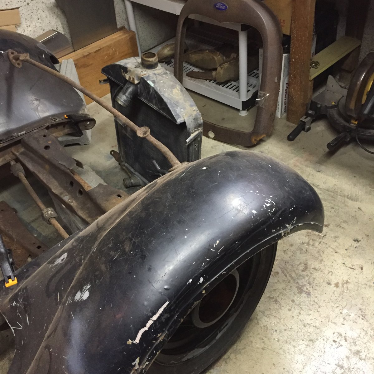

    It kinda looks like you have a 30-31 headlight bar there since the one you show has a curve in the center. If it is, that will eventually make aligning things difficult since it has a different shape.
  28. Tim
    Joined: Mar 2, 2001
    Posts: 19,628
    Tim
    from KCMO
    Thanks for the heads up, I'll compare it with another one I have access to and see what we have. This one will end up dropped so maybe ill align it with a 28/9 and drop the 30/31 to fit?
  29. Corn Fed
    Joined: May 16, 2002
    Posts: 3,411
    Corn Fed
    The 28-9's are flat on the backside where they meet the fender. The 30-1's have little knubs around the bolt holes. The 30-1's won't sit flat on a 28-9 fender without some grinding.
