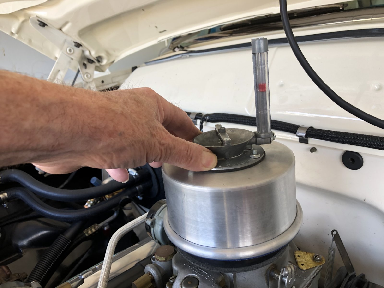

    If your idling on both which I do on my dual quads you should get a Unisyn and an aluminum carb cover to get equal vacuum on both with idle mixture screws…I’ve been running on mine for 7 years. I’m not familiar with your AVS carbs. View attachment 6047588 IMG_3732.jpeg IMG_3728.jpeg
