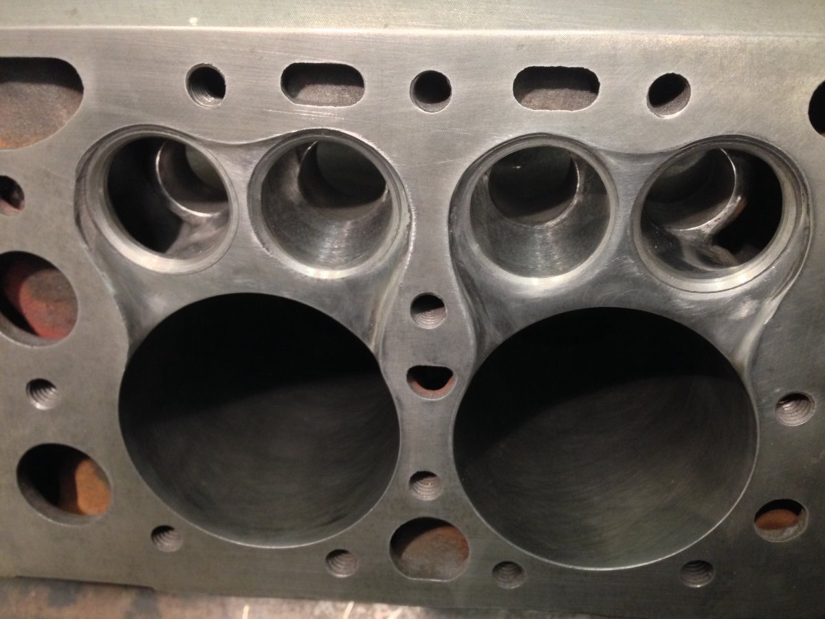

    Although the block had already had the ports smoothed over, I wanted to have a go at porting and so set about it with a flexi drive in the bench drill with a selection of burs. I have a high speed air die grinder, but my garage is very close to houses, and not wanting to upset any of the very understanding neighbours I have I chose the quieter but slower option. I spent about 25 very therapeutic hours removing smoothing and polishing metal.

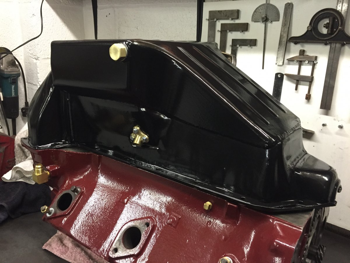

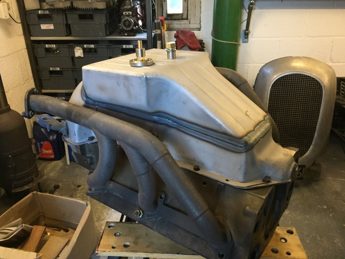

    One thing I wanted to do was to upgrade the sump pan. The reason? I couldn't find any tangible reason why the motor failed in the first place and all I could think of was an oil starvation issue. The problem occurred while full throttle, 5k rpm competing up Prescott hill and I think it just ran low in the sump when cornering and bang went my motor. So I made a much bigger pan and welded it up with baffles and mesh screens to remove the air. It will now hold 5 lts minimum and up to 15 lts if I thinks it needs.
    So that's it, motor built and fitted, heads and intake cleaned and fitted, plumbed up to the rad and fuel, dizzy's fitted and set up. Time to fire it. Yup, straight into life, count to ten watching the oil pressure, gonna go up at any time, any time now, must be time now, really? No bloody oil pressure. Arse, bugger, poo and fuck!

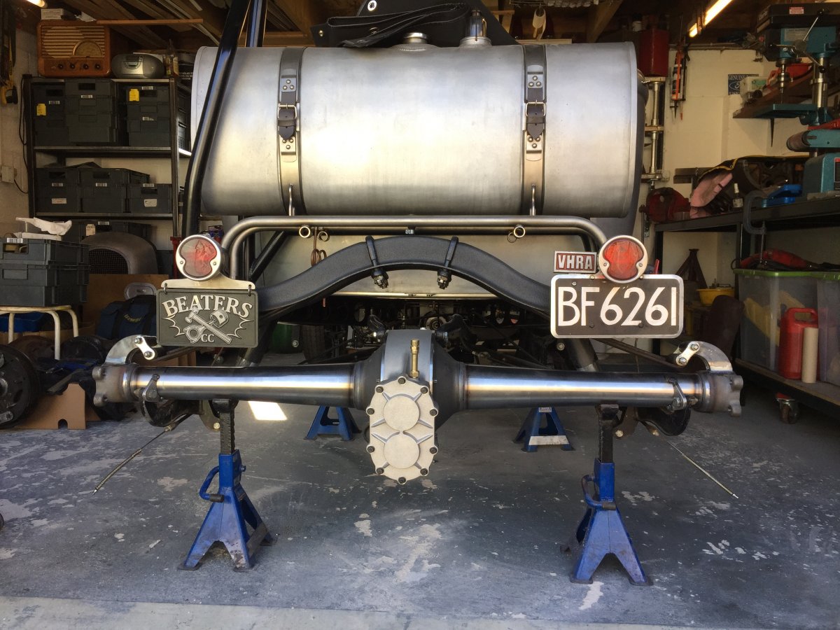

    Now with the motor being 304ci and hopefully putting out a bit of power I got to thinking the rear axle wasn't going to last very long. I did rebuild it a while back but I was always a bit unsure of how much stick it would take. So I bit the bullet and called Hot Rod Works and ordered a complete Winters QC axle complete with Winters Wedgelock diff and 9" type axle shafts. That made a dent in the pocket but once it arrived I was pretty pleased with the quality.
    After making all the brackets for springs and wishbones and welding them to the bells the axle was lovingly assembled again, and Arse, bugger, poo and fuck again. The bloody axle shafts were 3/4" too long on each side. Sits on the floor with head in hands. Ten minutes later I had a plan to make spacers, modify the brake backing plates and trim 1/4" from the ends of the shafts. Took about two days but it all worked out and now I have a back end that looks great and works very very well.

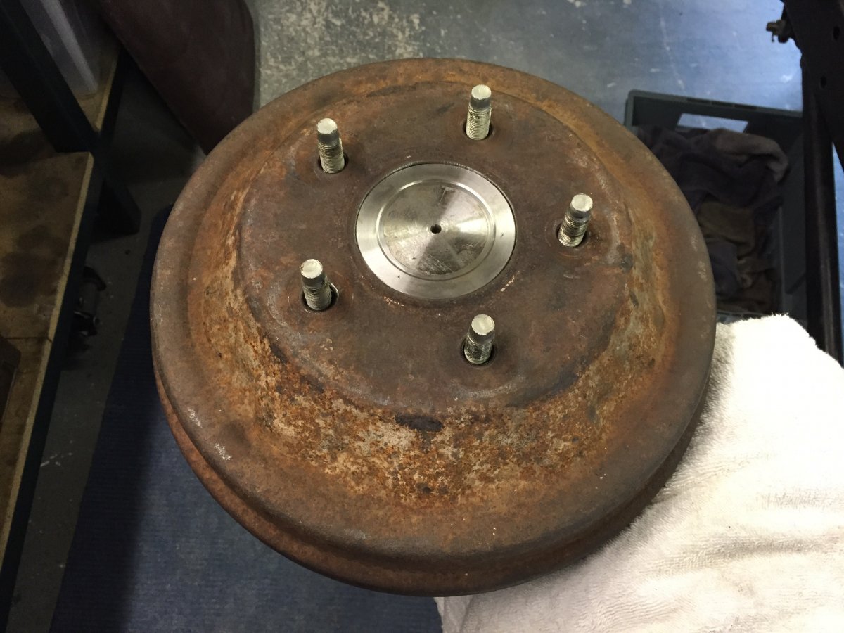

    As I use steel wheels without caps for competition I found the flat ends of the axle shafts a bit plan looking so made a set of dummy banjo axle ends.
    To go from this
    To this. I made some threaded inserts and machined up a couple of brass castle nuts but can't find a photo.

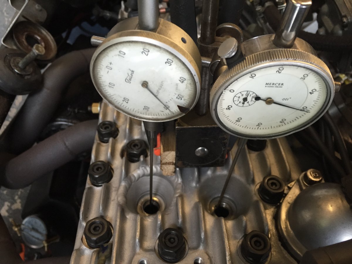

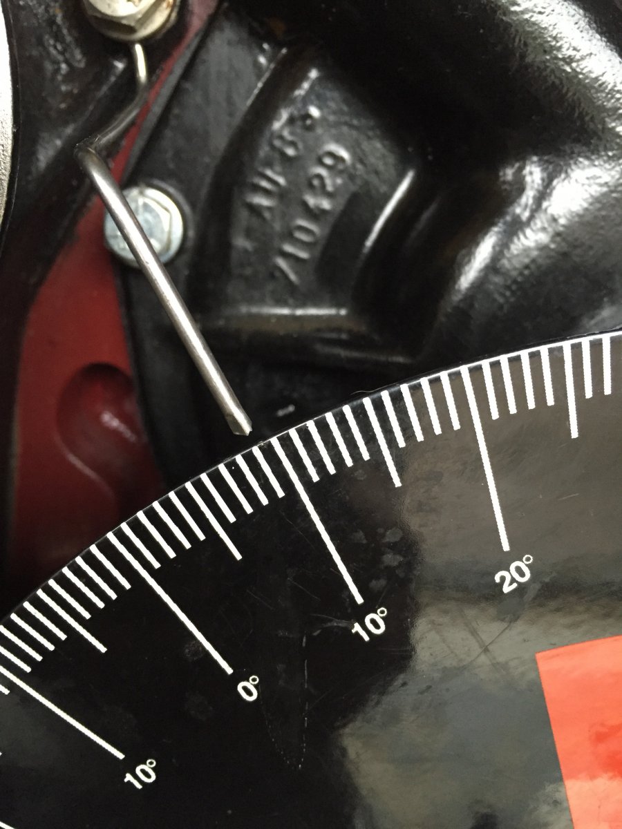

    For those who are asking for more updates, here goes.
    Last update was the rolling road. I was a little disappointed with the numbers so once I got the car back home I pulled the rad and checked the cam timing. Having twin plugs means I don't need to take the heads off, so set it all up and cam timing spot on.

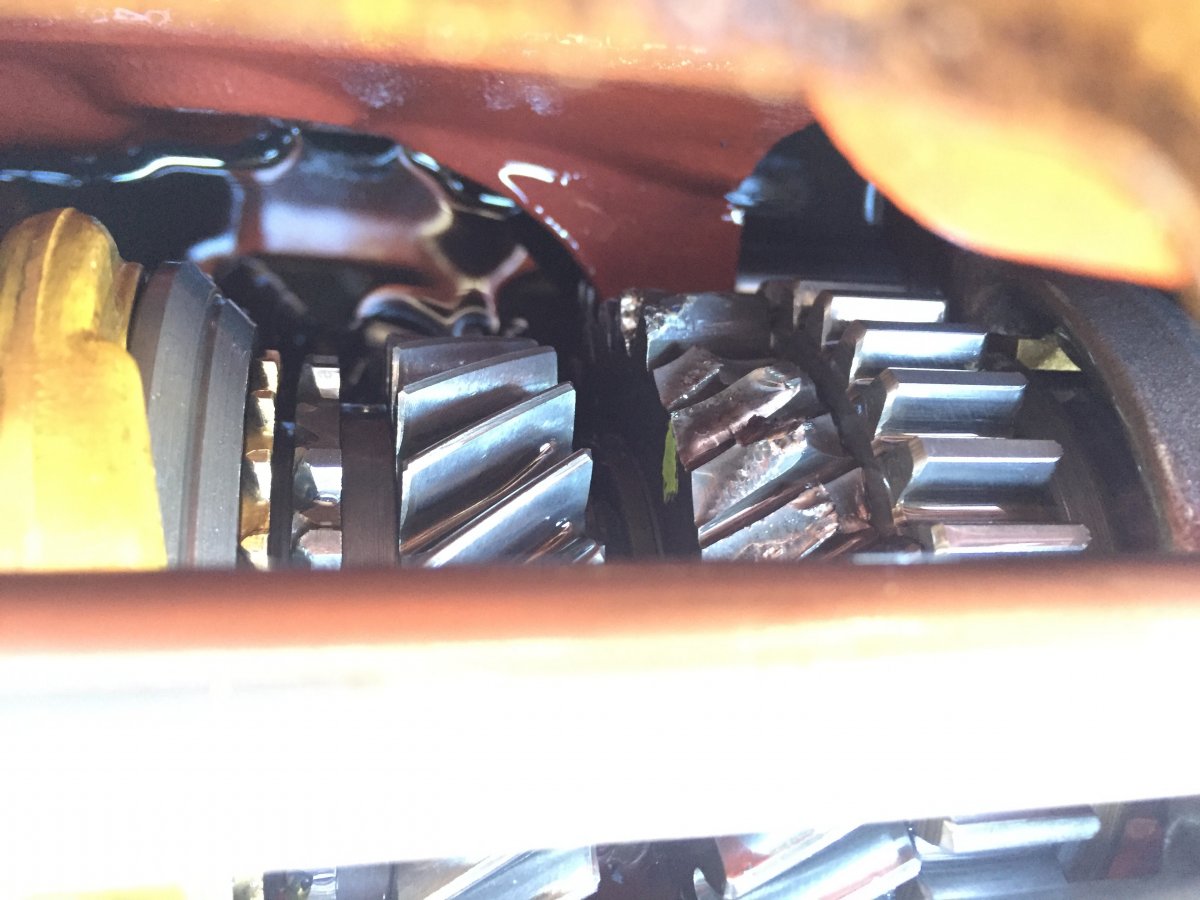

    Can't find anything amiss so bolt the car back together and take it for a drive.
    Bugger, bugger, and bugger again plus a holy crap thrown in. Three miles, three bloody miles the gearbox lasted before ripping second gear out. Guess the Volvo box isn't up to the job.
    It's Tuesday lunch time, and on Friday morning I'm off to Pendine Sands and need the car. What to do? I could swap the box for another the same, but I'm guessing that the box isn't up to the job any more and there's a very high chance of the same happening again especially with the drag of the sand and my heavy right foot.
    I could go for a t5 etc but that means lots of chassis work as well as clutch, drive shaft etc and only two and a half days!
    Now I know there are guys who race the old Volvos so I hit the net to see what I could find. Bingo! Found a UK company selling Quaife (makers of fine racing gear clusters) gear clusters for the M40 Volvo box. Great news, and after a quick call and selling my soul at the cross roads I had a complete Volvo box with straight cut close ratio Quaife on its way for 24 hour delivery.
    Yay! Lunch time Weds and the knock on the door saw a man with a gear box. Yay!
    No time for pics, just check it over, fit the top from the old box and bolt it up. 5pm on the weds and the car was back in one piece. Test drive time. The gearbox sounds like a bag of bits and can be heard over the exhaust. That can't be right I thought, but yup, that's what straight cut gears sound like. But when they're running they howl like a screaming banshee. Bloody love it.
