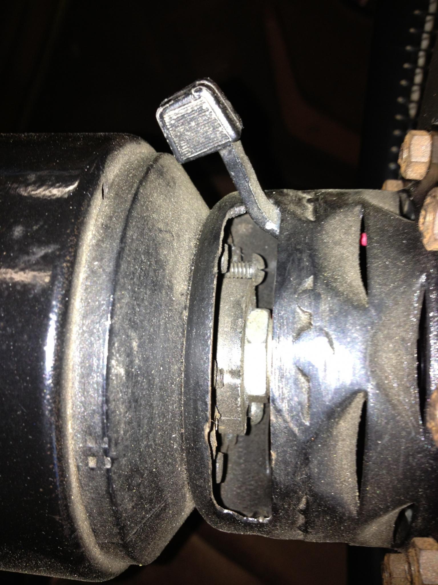

    I have adapted a after market whell to my cad tilt and tele column and kept the tele working, had to make a slot in the wheel adapter for the locking lever, was really no big deal.
    Any GM wheel will fit, just have to get creative with installing the lock mechanism.
    I will say this though, I never use the tele feature, I don't like the wheel that close to me, I never use the tilt in my daily, set it and forget it, no one drives it except me.
  7. Thanks. That was the only way I could think of also. Got a pic of yours?

    :D Did a Caddy T/T in my '32 Tudor, but it's not channeled or chopped. The column came out of a '73. You can buy a "Momo" adaptor, as I did, and mount an aftermarket wheel.:) Later I decided that I wanted a different wheel that did not fit the Momo, and so I made an adaptor, like "maniac" did. Not really a big deal, but to make it look decent requires some machining. :cool: So now I have a "Momo" adaptor for sale. :mad: I use the T/T feature every now and then.

    OK, heres a pic of the release/lock for the telescope, this is thru the adapter of the after market wheel.
    Like swade said thru the horn button would work, but then you would need a remote button for the horn, by the way parts for these columns are available thru Ecklers Corvette parts, these columns are all the same.

  14. Interesting post for me because I too have a Momo adapter and a slot milled in the side of it. Brazed an arm onto the disc for the telescoper that sticks out thru the slot. 300,00 on the setup and going strong.
