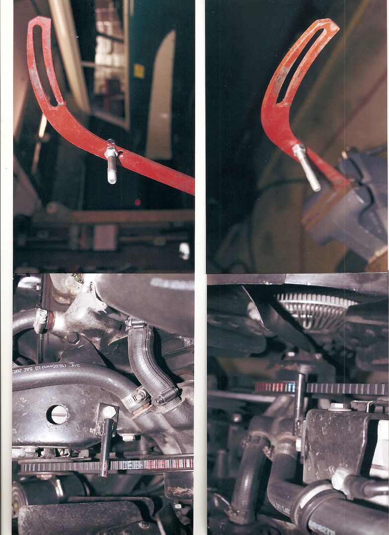

    OK,not much tech here but it is basically free, simple and easy.Not only did this work on my 9500 rpm G/MP 287" but it works on just about any combo w/o serp belts.
    Got 4 pics.The 2 with the orange generator bracket is off the race car and bottom 2 are off my 454 1970 Chevelle.Constant problem in modified production was that you had to run street equipment including charging system.Generator in the case of my 57 chevy.After numerous belt tosses I drilled a hole in bracket just above where the fanbelt ran and bolted a stud/cutoff bolt,etc.Position just above the belt pretty much in the middle of the belts long run to the generator.Never lost another belt over many runs at 9000 plus.I will continue to use this when I get the 57 back nostalgia racing.
    Same with the Chevelle.6200 rpm motor.Flipped the belt a couple of times at the drags.Welded a stud to a plate and drilled hole in alternator bracket.By loosening bolt you can adjust spacing to the belt.I close it up to race and back off a bit on the street.
    Sometimes the belt gets a little shiny but never tore one up.And yes,I do spend effort to get things lined up.I did run deep pulleys on the 57 and have got to get a deep alt. one for the Chevelle but have not lost one since doing this.
    That's it,stupid easy and free.

  6. Cool fix,,and simple and cheap as well.
    That is what engineering is all about!

    The easier way to fix something like this is to use an OVERSIZE PULLEY on the alternator, The belt is going around it 2 to 3 times faster than the crank is turning, a belt can not make the curve that fast, Sense from an old drag racer......try it, the pulleys are avalible at Summit or Jegs

    Ran the 57 before there were oversize pulleys in the 60's.Did use Stahl/Moroso pulleys in 70's.
    The Chevelle is bone stock,have a 375 alt pulley but have not put it on because this is so simple,different and it works.
    I also have been racing since the 60's.Don't want new stuff,want to do it the way I did back then.[​IMG]

    That's a good question.Don't know about length differences.I know that there is a lot of variables such as pulley alignment,different water pumps and pulleys and the angle of the mounting of the gen/alt.Sometimes gotta shim brackets to help align.

    Very common problem in the 60's-70's, especially with SBC's. And, a very common approach to dealing with it. The oversize pulleys on the generators were really intended to slow them down, so they would'nt throw solder, the deeper pulley grooves were secondary. If anyone remebers, the 283's (like Bucksnorts' bored out 283 to 287), had the rivited pulley on a hub. You could'nt really call them balancers or dampeners. Those pulleys were often bent, and prone to wobble from being beat on and pulled off the crank snout. I think that probably had a lot to do with tossing belts also. I used to have a 265 that would toss belts, and a simple bolt on the tension bracket did the trick; it used to really polish the bolt and wear into it. Butch/56sedandelivery.

    A SBC doing 9500 rpm? I see it loosing more then a 1/2" fan belt!
    Plus a couple of bolts welded to the frame isn't going to keep the belt from coming off. I'd think it would do more damage to the belt when they make contact. Rubber and friction don't mix.
    You should be installing a serpentine belt set-up. But that might cost more then $5...

    Seems to me that a roller bearing mounted on the stud would eliminate a lot of the wear on the belt.

  24. Ford does generally mount the alternator much closer to the pulleys than the early GM stuff and aren't any where near as prone to throw belts.

    Assuming you have good pulley alignment and can hold good tension, you might try
    link V belt...It does not flutter at high speed like a conventional V belt.
    A V belt track will grow or expand coming off of a pulley at high speed. When this happens,
    it will start fluttering or wobbling. This can be easily observed with a strobo-tach.
    Years ago I was modifying drill presses for high spindle speeds around 10K rpm for drilling
    .010 diameter holes in various aluminum alloys. I used link V belt because it did not cause vibration in the spindle at these speeds. It runs true on track.
    Attached are a couple pics of the belt setup driving the power steering pump on my roadster. I only turn 8K but have never had any belt problems.

    Simple but effective cure for the chevy belt throwing problem. You new guys are forgetting that we didn't have billet, modern belts, and serpentine drive stuff back in the day. And remember the belt would only come into contact with the bolt for a few seconds at most if it was starting to come off it was not in contact at all at lower speeds and if the bolt stared to show signs of wear throw it away and put in another and go RACING.
