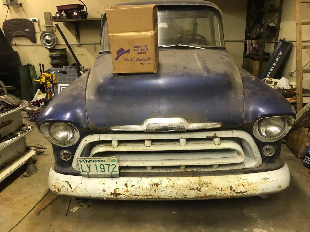

  1. 20171010_153505.jpg I haven't even gotten it here yet but I'm pretty excited to get into another 55-59 task force truck ! The only other 57 I've owned was a GMC that I sold right before leaving for the U.S. Army, one of those immediately regretted things I managed to pull off in my life time.
    I've already built this thing in my head a hundred times and can't wait to lay hands on it ! The plans are not to over power it like I do all my other builds, but instead build a daily driver that can tow my Henry J to the race track. It will be built in Popular HotRoddings most famous 57 chevy build, Project X' s style. I can see it now, yellow with big n little Cragars, minus front bumper, black tuck n roll, sitting tough with the M/T cross ram on its hopped up small block and the bronco 9in out back. Oh man I can just envision this baby now, oouuulala...

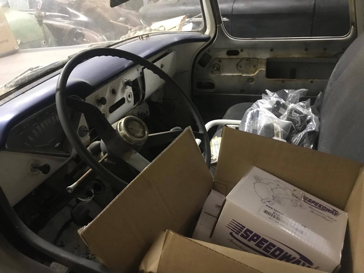

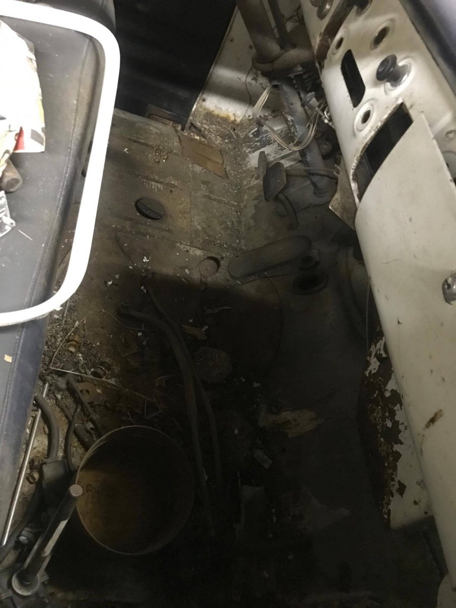

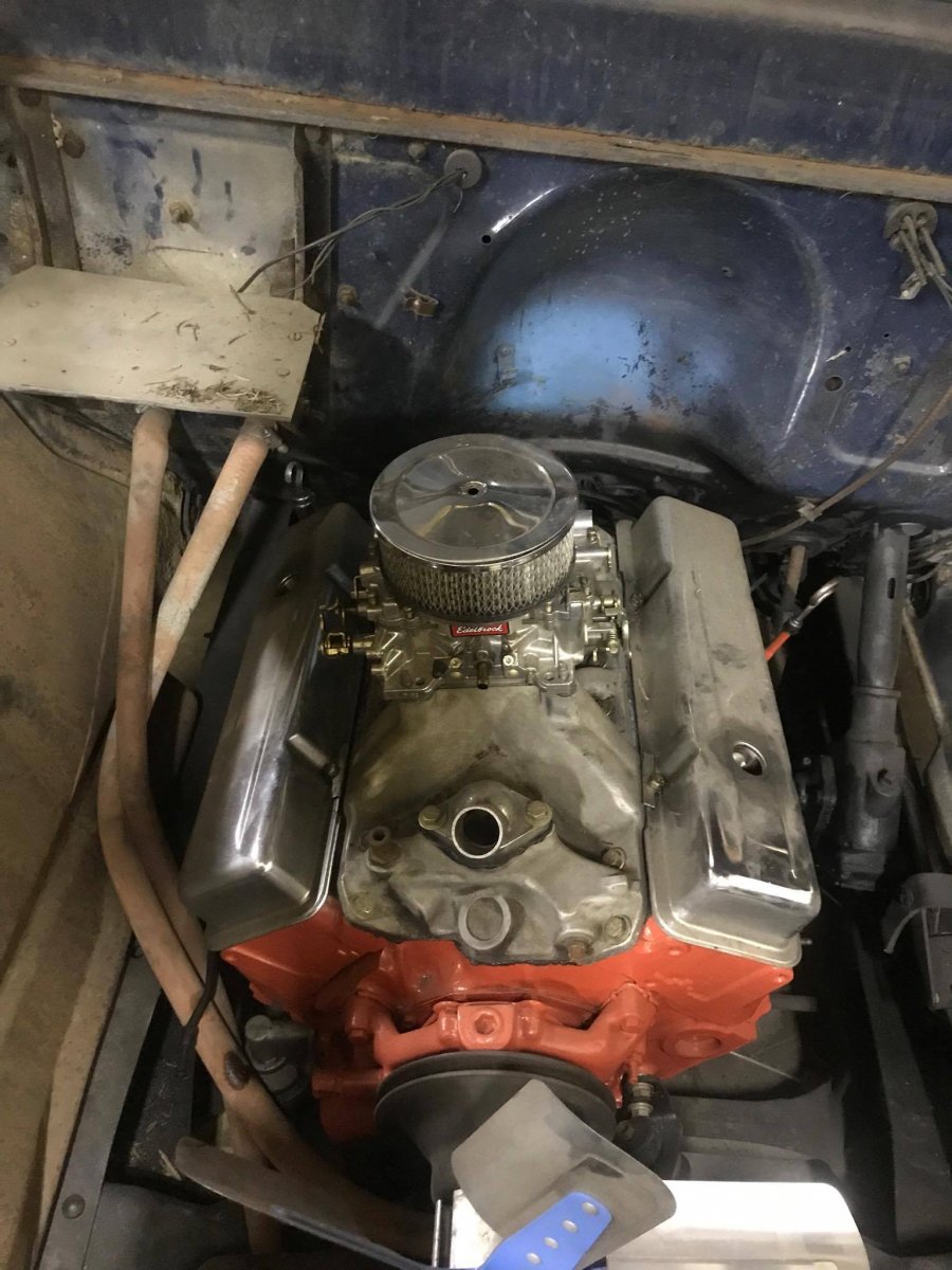

    It's a pretty solid short bed, big back glass, uncut dash received_2012404058991361.jpeg and comes with a new disc brake kit, tubular motor/trans mounts, 350/th400, extra bed and extra front/rear fenders. FB_IMG_1508788435120.jpg received_2012404082324692.jpeg received_2012404112324689.jpeg received_2012404108991356.jpeg received_2012404105658023.jpeg received_2012404095658024.jpeg received_2012404055658028.jpeg received_2012404072324693.jpeg received_2012404068991360.jpeg

    Washington State plates still on it? How did it end up in NY state? Nice score. :)

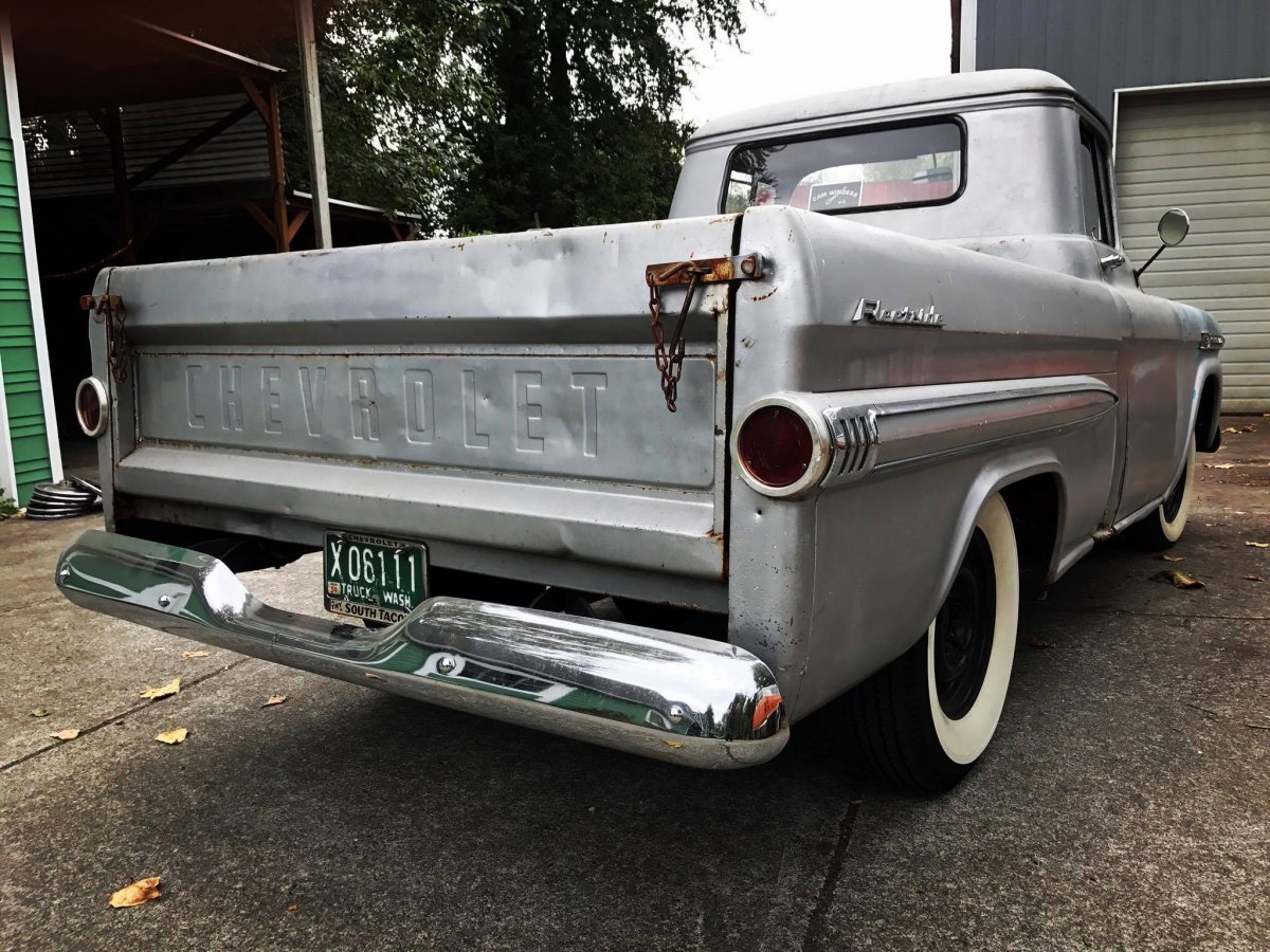

    I've built and rebuilt 2 '56 Pickups. And of course I get excited about something else and have sold them. I'd do another if it it worked out. Here's a picture of the most recent one. Enjoy your '57! IMG_1502.JPG
  10. I noticed that it has the mill mounted with the stock pedestal,s at the front. If the rear mount crossmember hasn't been removed. I would be installing a stick bellhousing and a granny 4 speed. especially if I was planning on towing. That granny low is nice when you need to creep around. And the super slow reverse is great when you are backing up a trailer. Everyone will start touting the benefits of a overdrive trans. However with a granny 4 speed you can use a tall rear gear and big tires and still run with modern traffic. My 66 long bed 1/2 has a factory SM 420 trans and a dana 44 mounted on leaf springs. It has 336 rear fears and a stock factory 250 engine. The only engine mods are a HEI and a mono jet carb from a newer truck. And it will go 80 MPH no trouble and will pull a load or haul one. and I aint afraid to load it. Forget those leaking worry Grayson & papa's truck 008.JPG some automatic transmissions. Put a stick in it. All real hot rods have three pedals.

  12. I'm bringing it in and it's actually waiting to be picked up yet by the shipper.

    For now the engine/trans is just held up with a ratchet strap, no mounts yet, I do have a Hurst style front mount out in the garage (on that injected motor) and the tubular ones that come with the truck. I did think about a stick but think about clutches burning out too..lol

  26. Fife, near Port of Tacoma he said.
    He just sold a silver 59 short fleetside with chrome bed trim to someone in B.C.
    He also has a 55 suburban if that rings any bells. received_2012643025634131.jpeg received_2012641698967597.jpeg

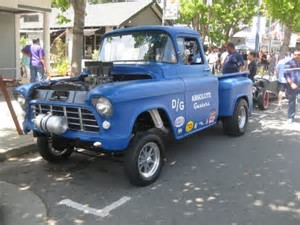

  28. Jim I'm not sure what all is left, maybe just the column linkage, I am thinking column shift if I keep the auto though. I'd like to keep this a little uncluttered in the floor department, just a basic truck, although I do have a couple Ball's power window kits out in the garage I never used on the 41. Maybe rig up that factory column shifter to work the th400 ???
