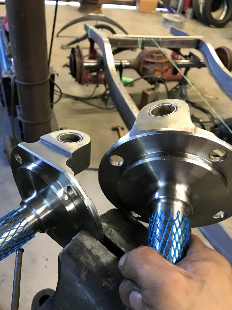

  3. JWL115C
    Joined: Jan 28, 2010
    Posts: 286

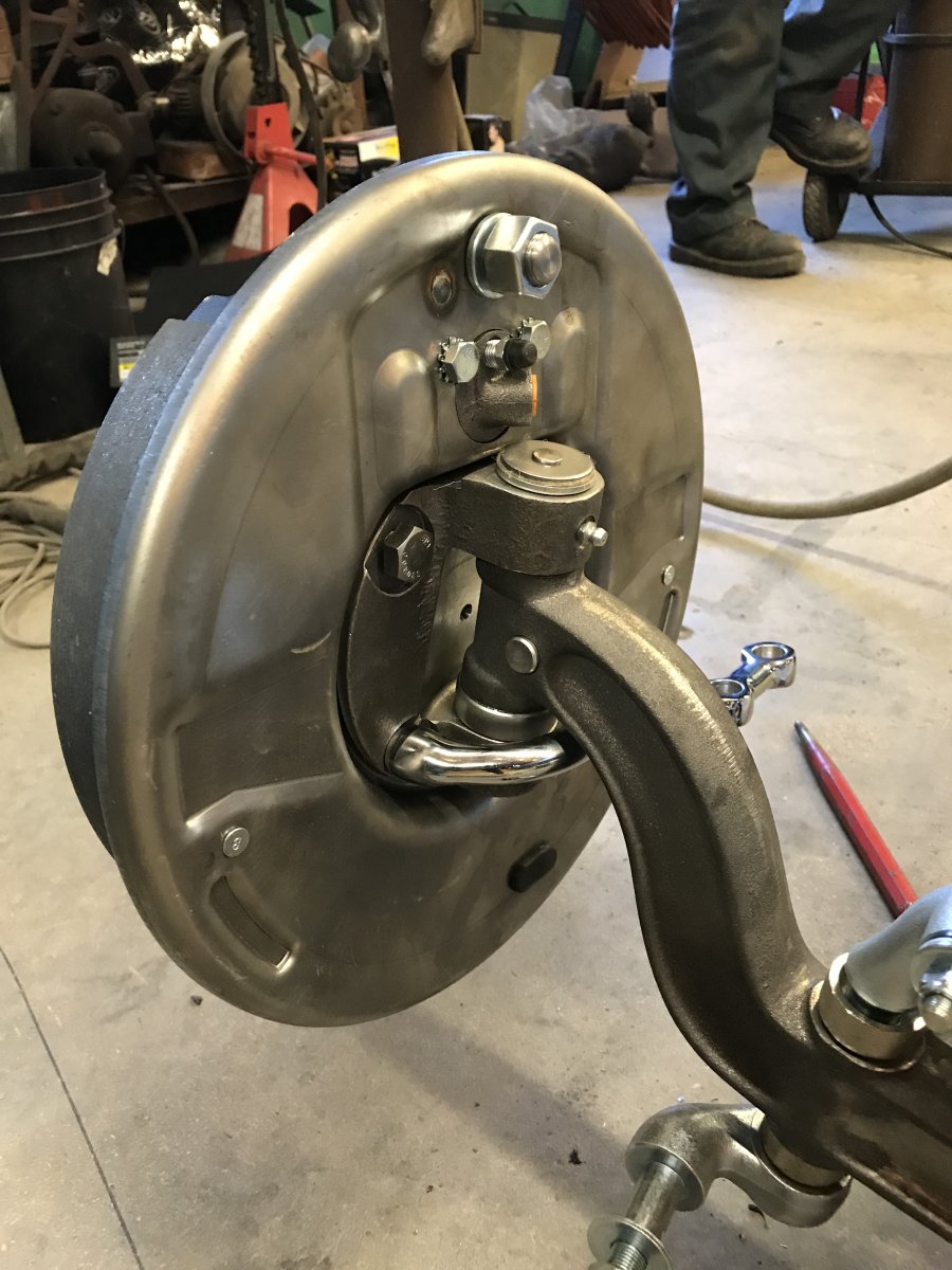

    JWL115C

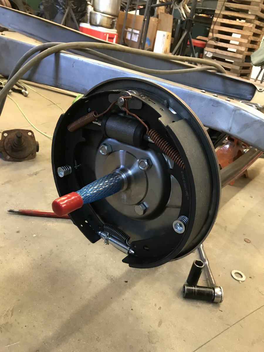

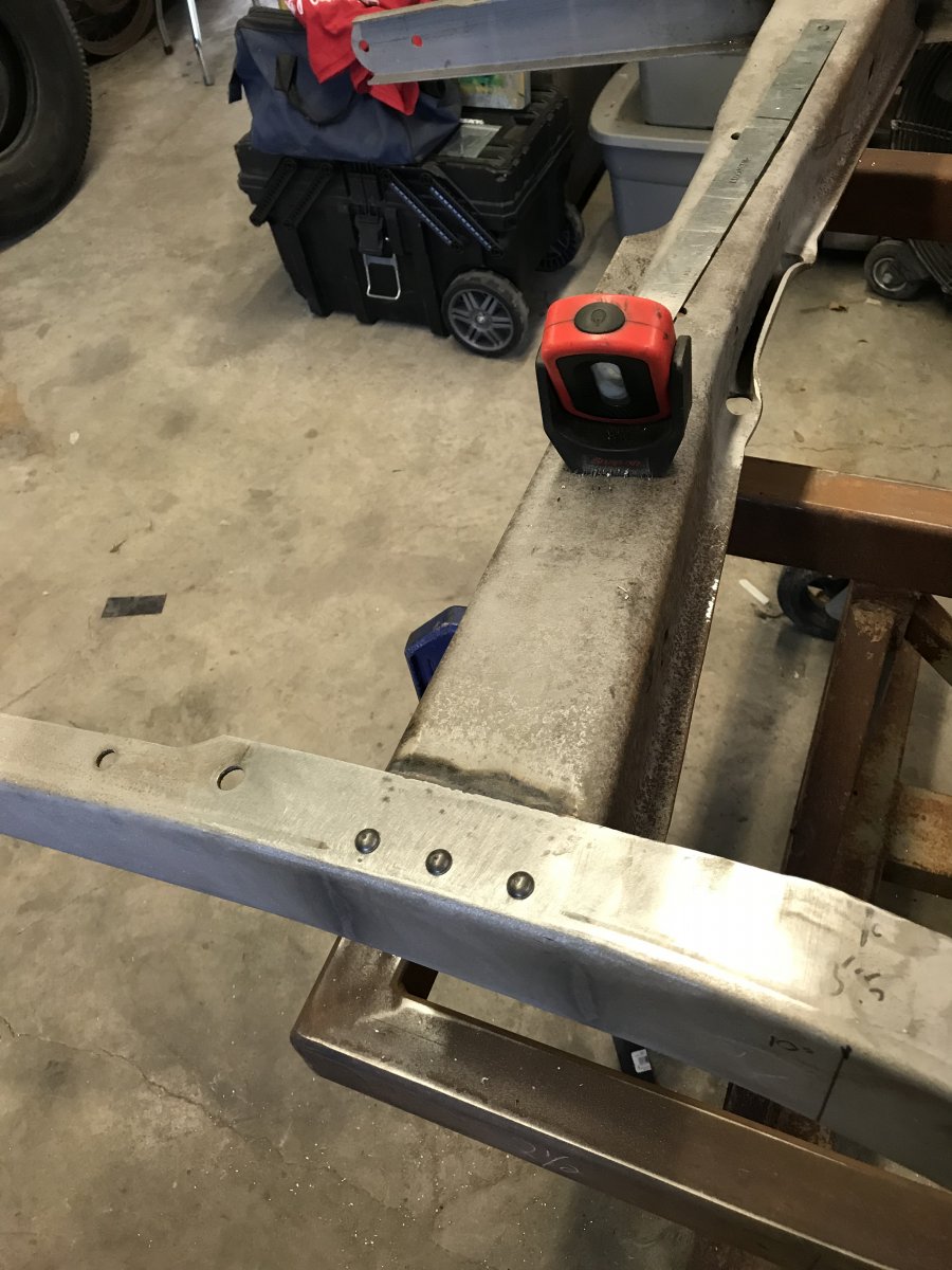

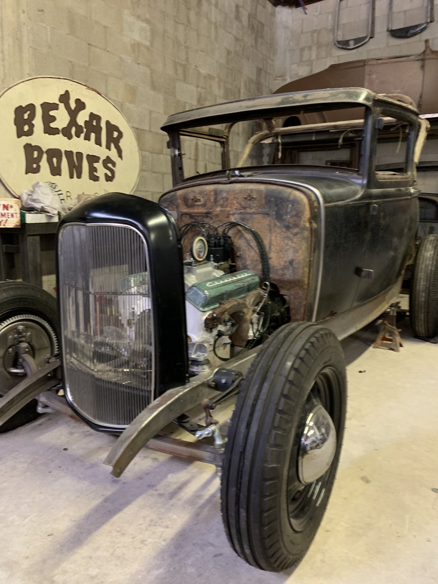

    Beautiful and thoughtful work. In one of the first photos posted is one showing the front brakes. It looks like to me that the shoes are installed backwards. That is, the primary shoe with the shorter lining should be on the front. Maybe I am looking at the photo wrong, but just in case... JWL

  5. Joe Rosales
    Joined: Jun 25, 2015
    Posts: 197
    Joe Rosales
    Yes, we didn’t notice until after I posted the pictures. Problem fixed. Thank you

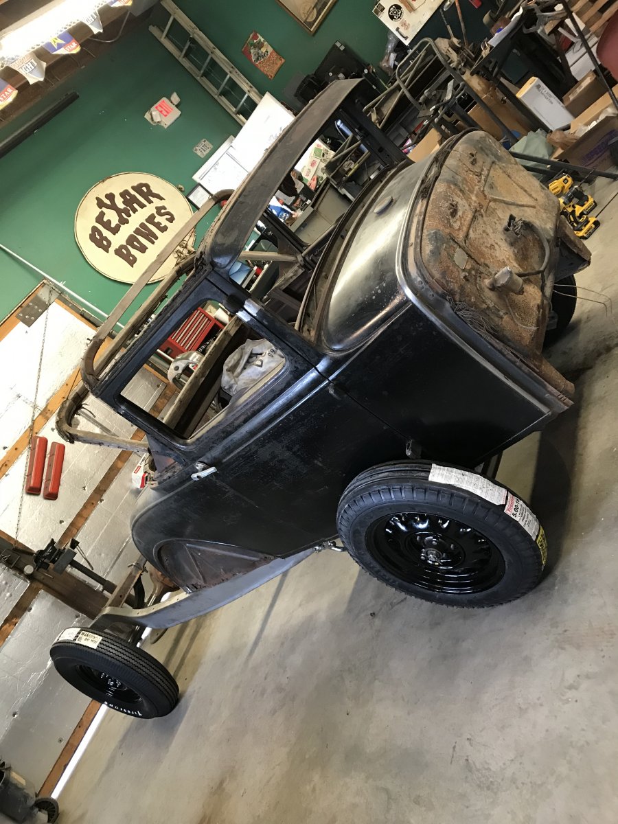

  8. Joe Rosales
    Posts: 197
    Joe Rosales

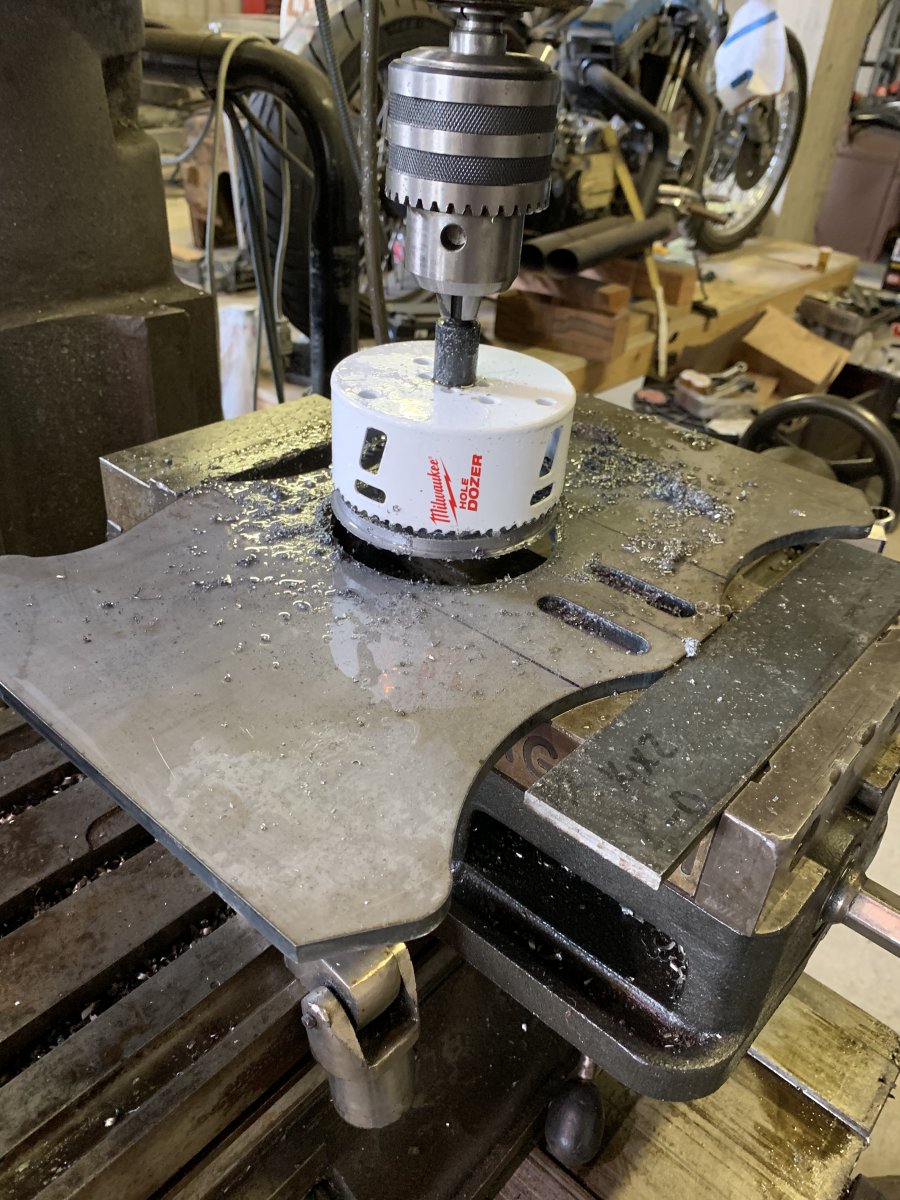

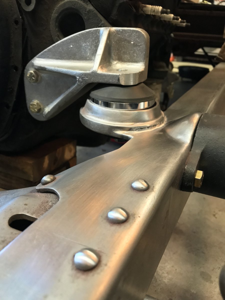

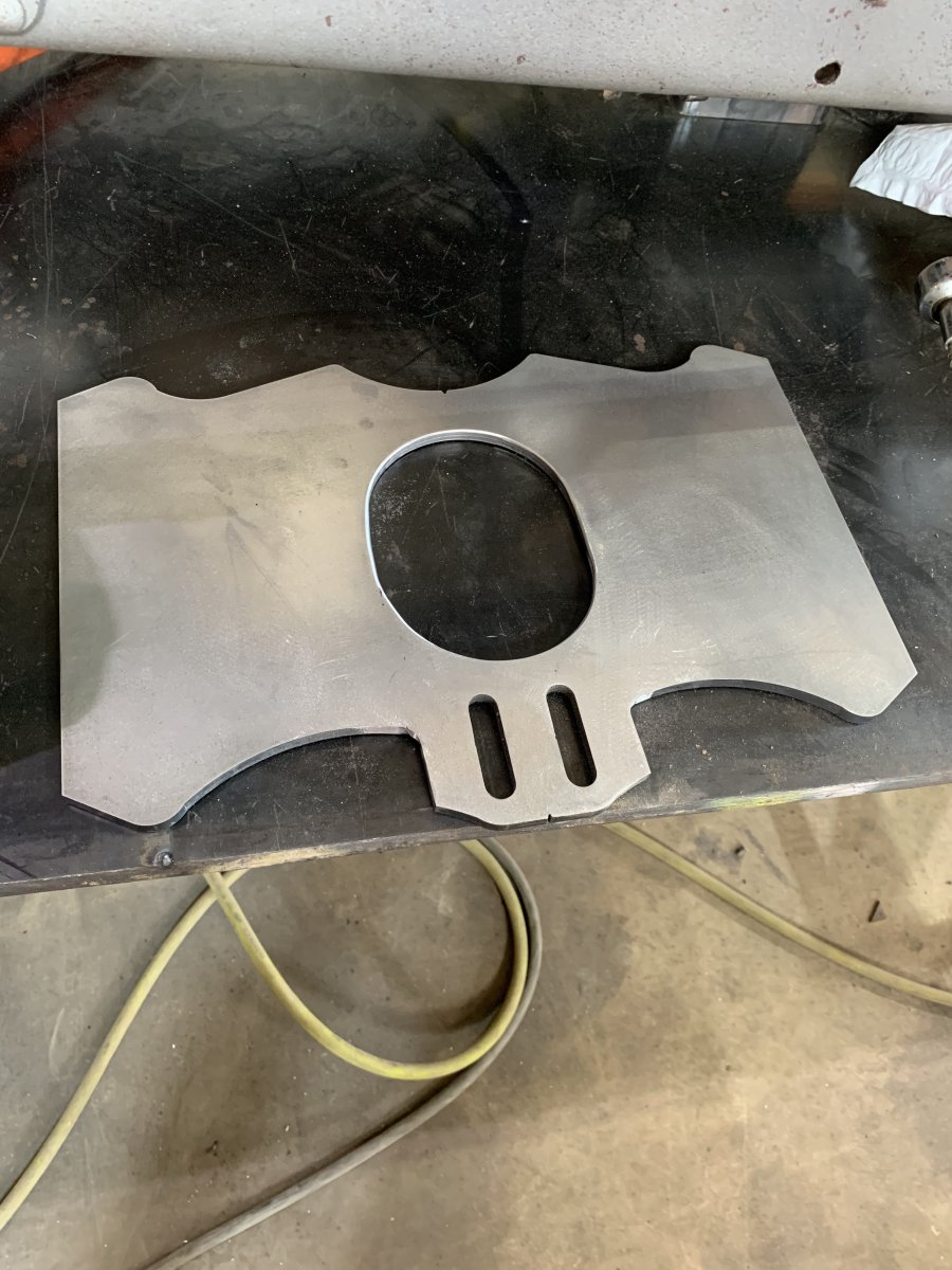

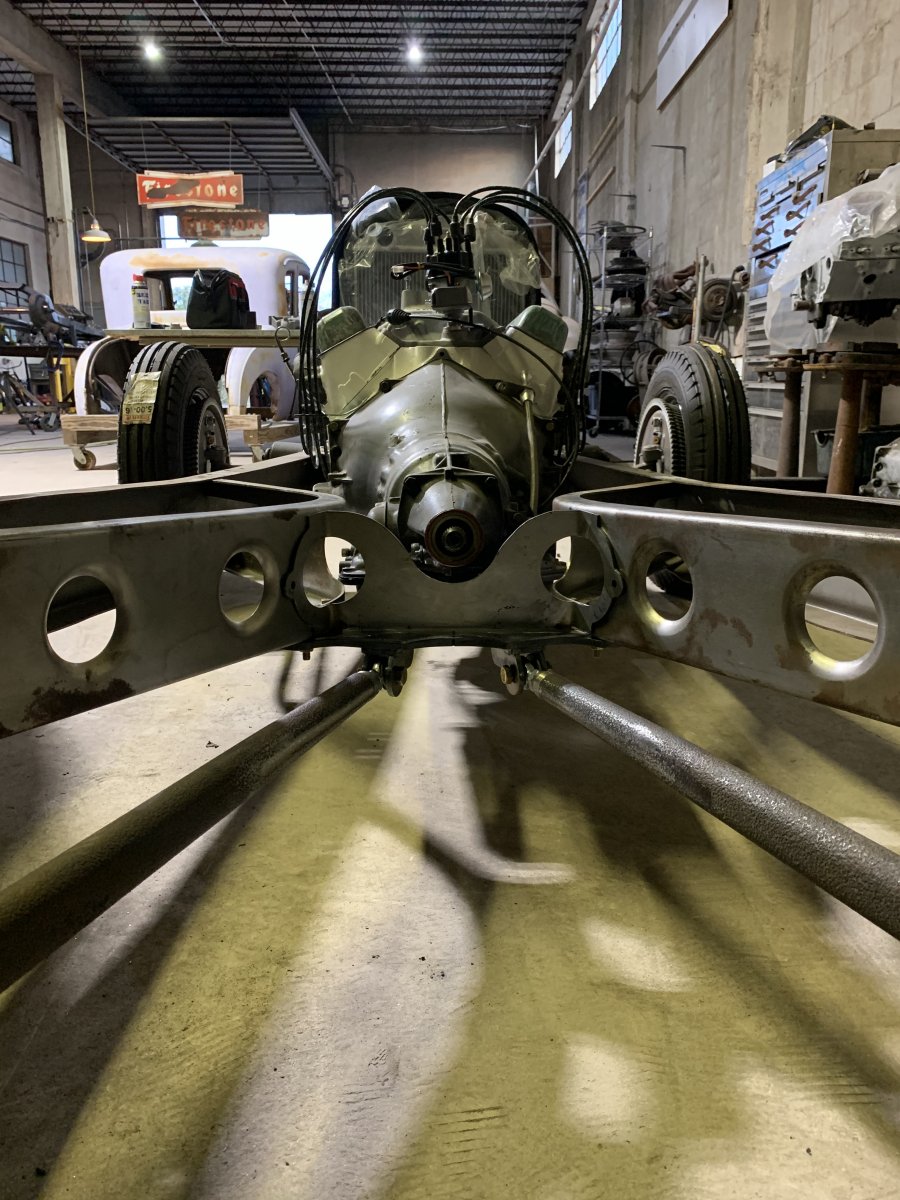

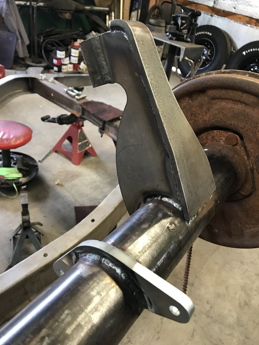

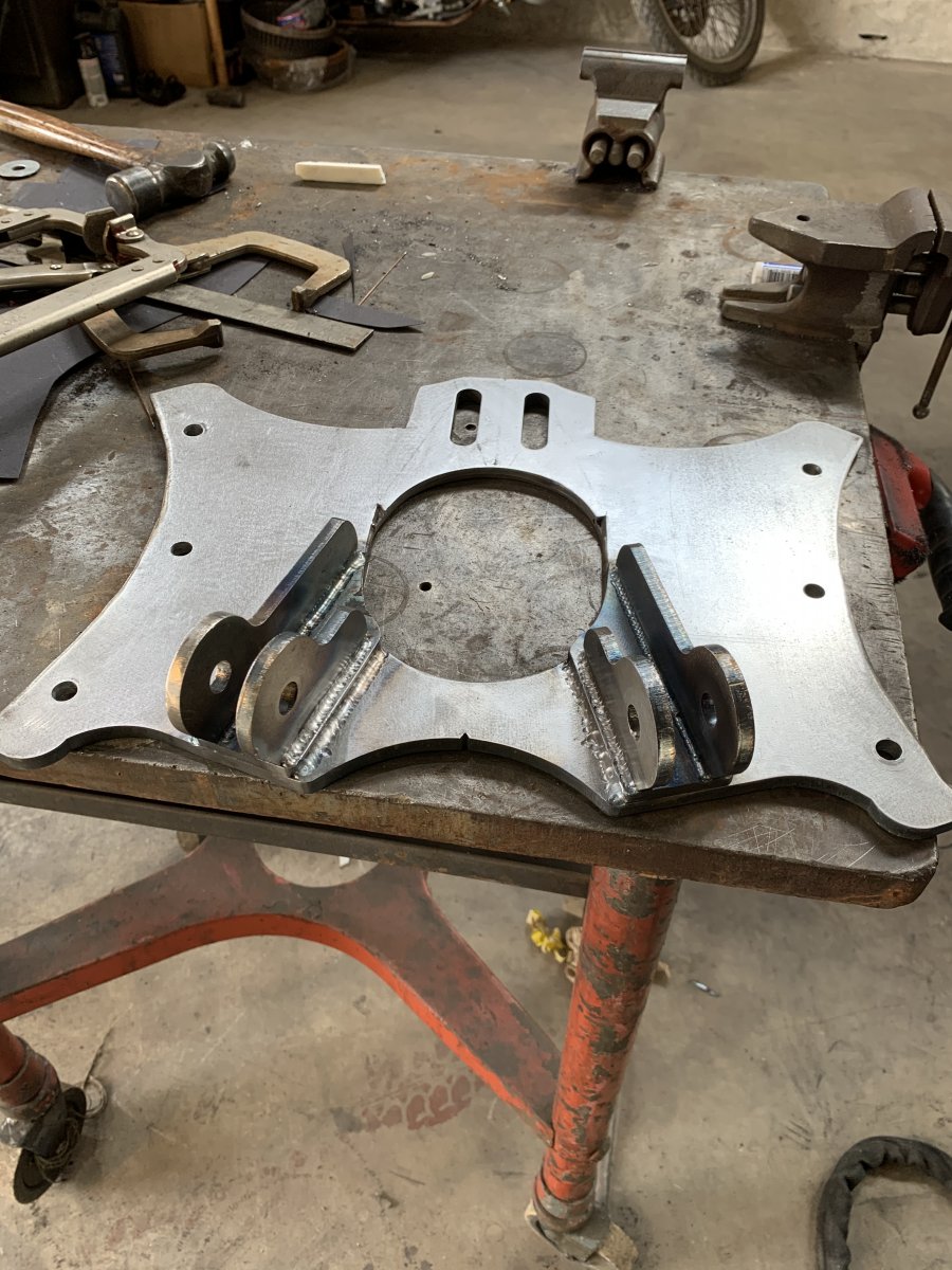

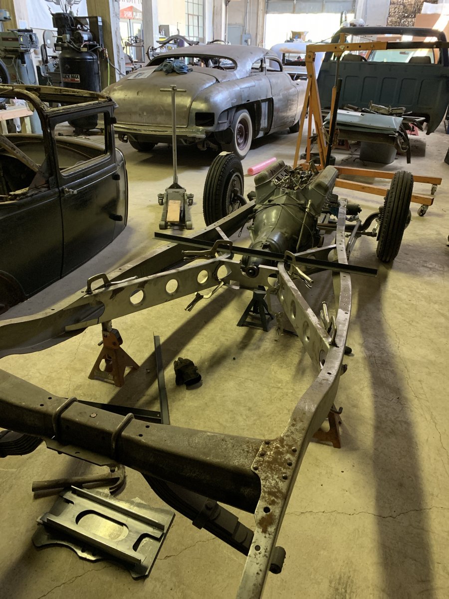

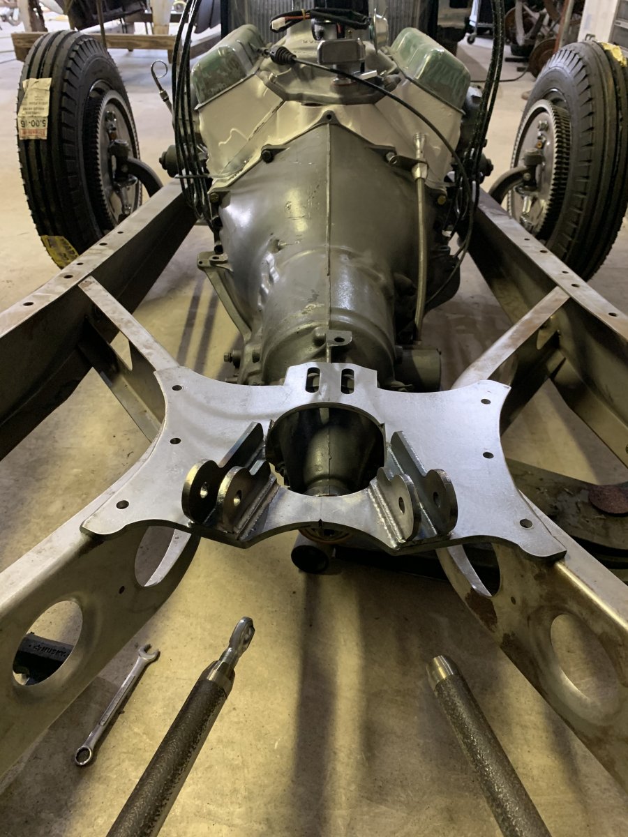

    Build is going good had to do a few modifications to the transmission plate that goes to the new xmember. Cut out and moved up about 2 inches, Slowly but surely.

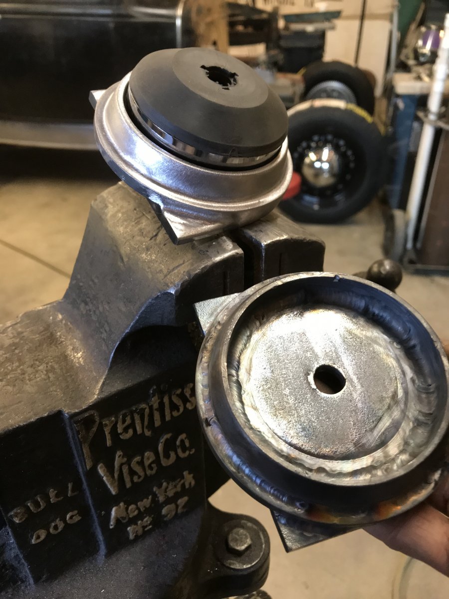

  9. Joe Rosales
    Posts: 197
    Joe Rosales

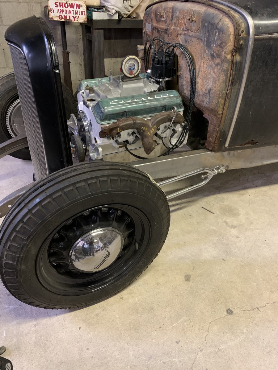

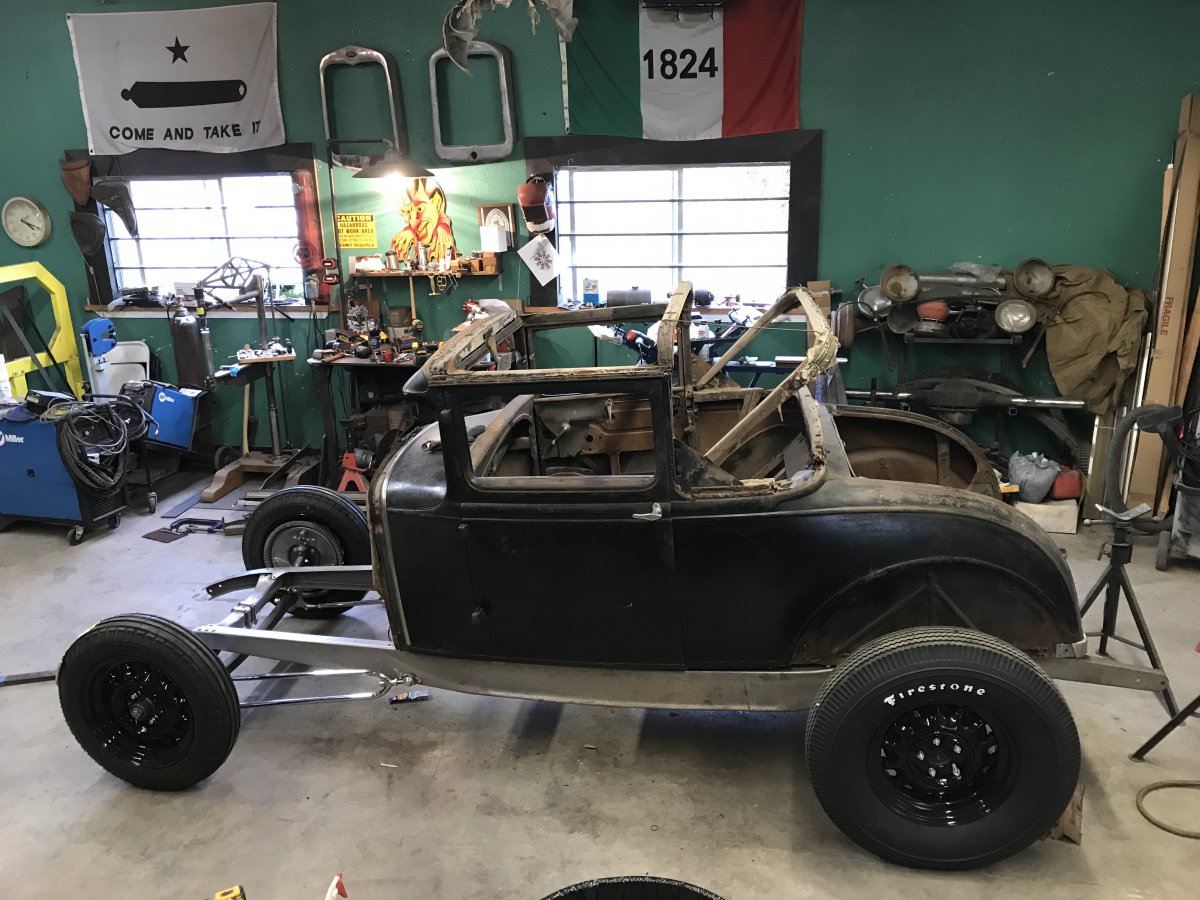

    327 motor fit like a glove, Still have some more work to do to the rear end, but car is coming along nicely.

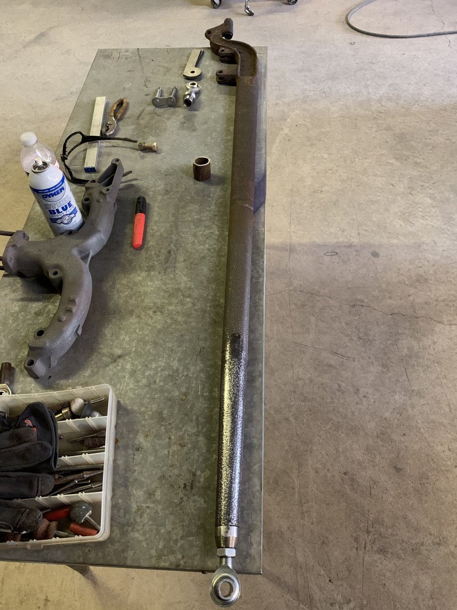

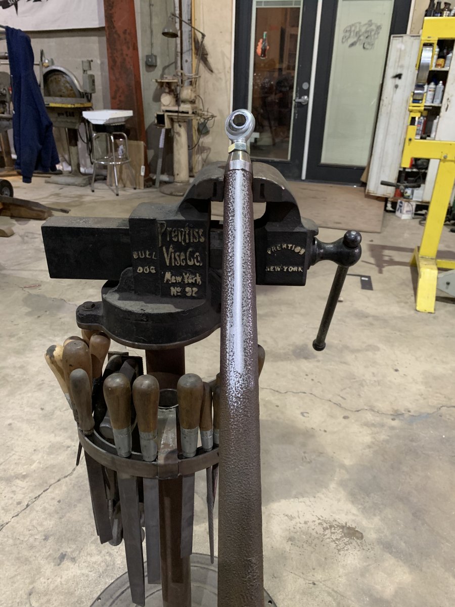

  10. Joe Rosales
    Posts: 197
    Joe Rosales

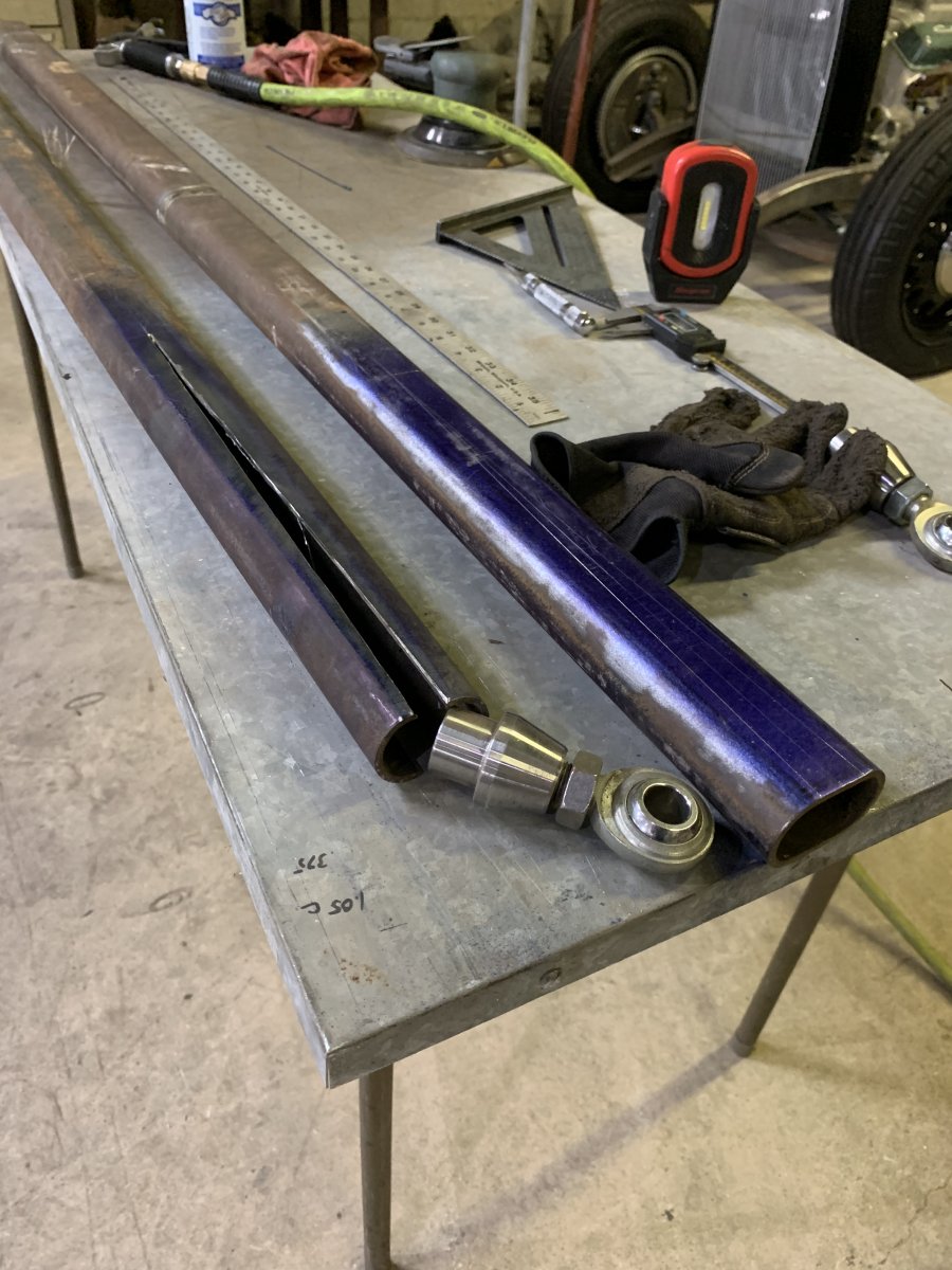

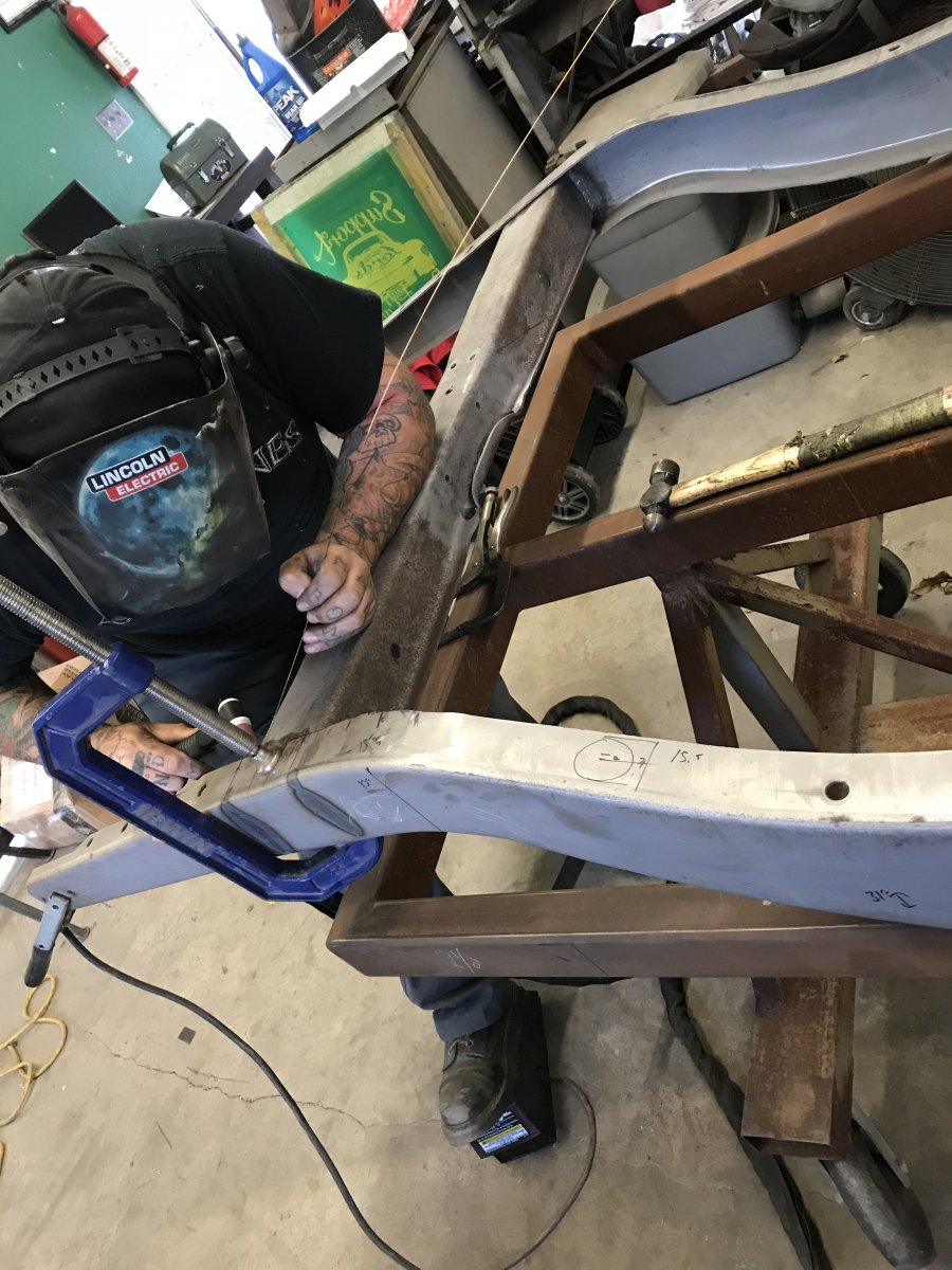

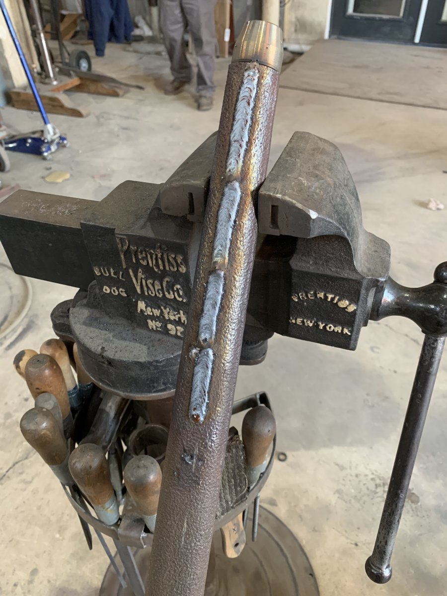

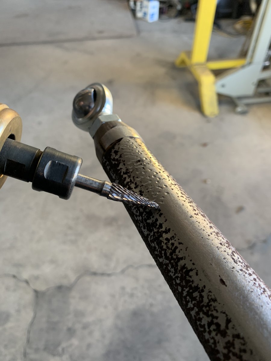

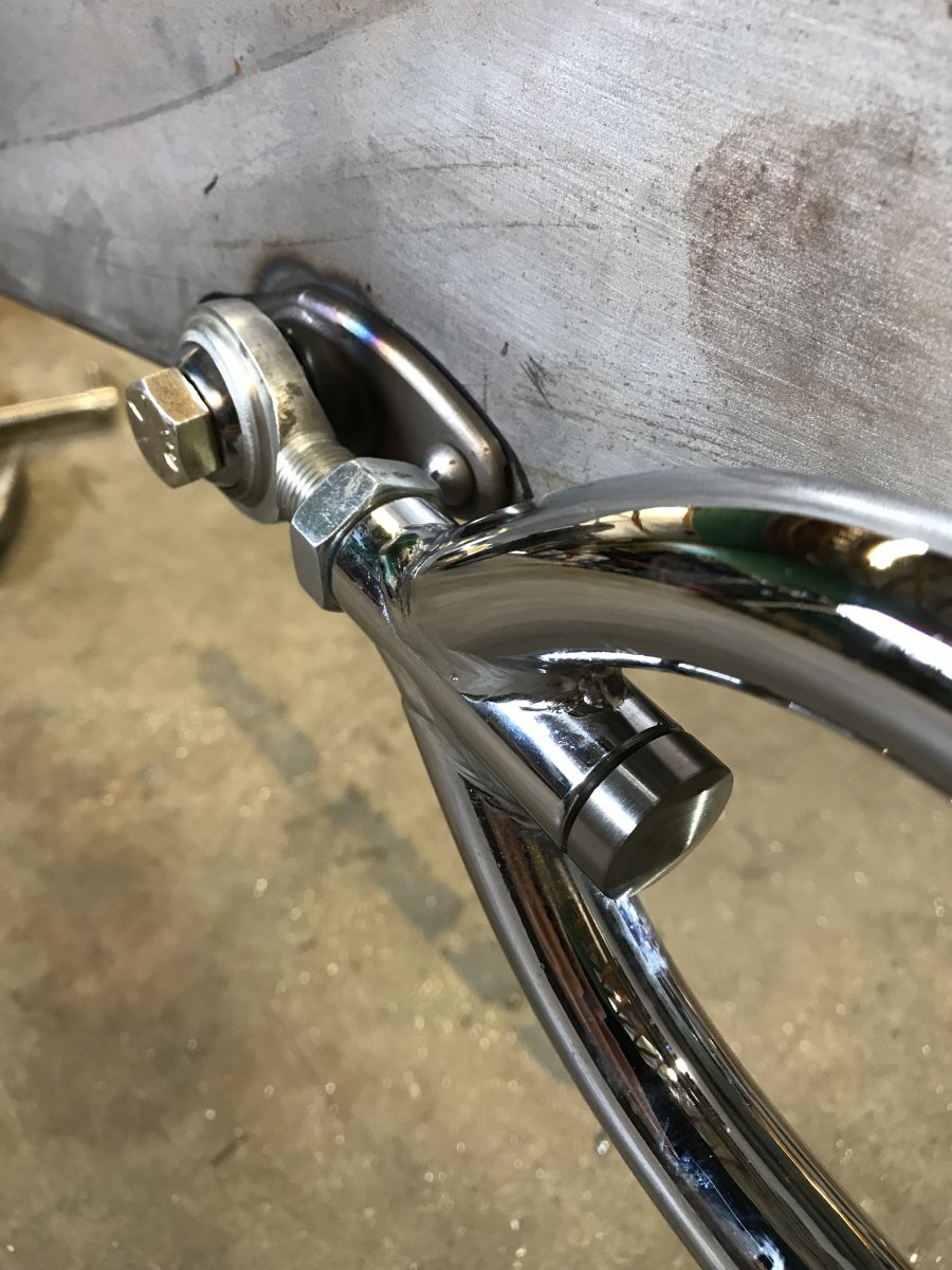

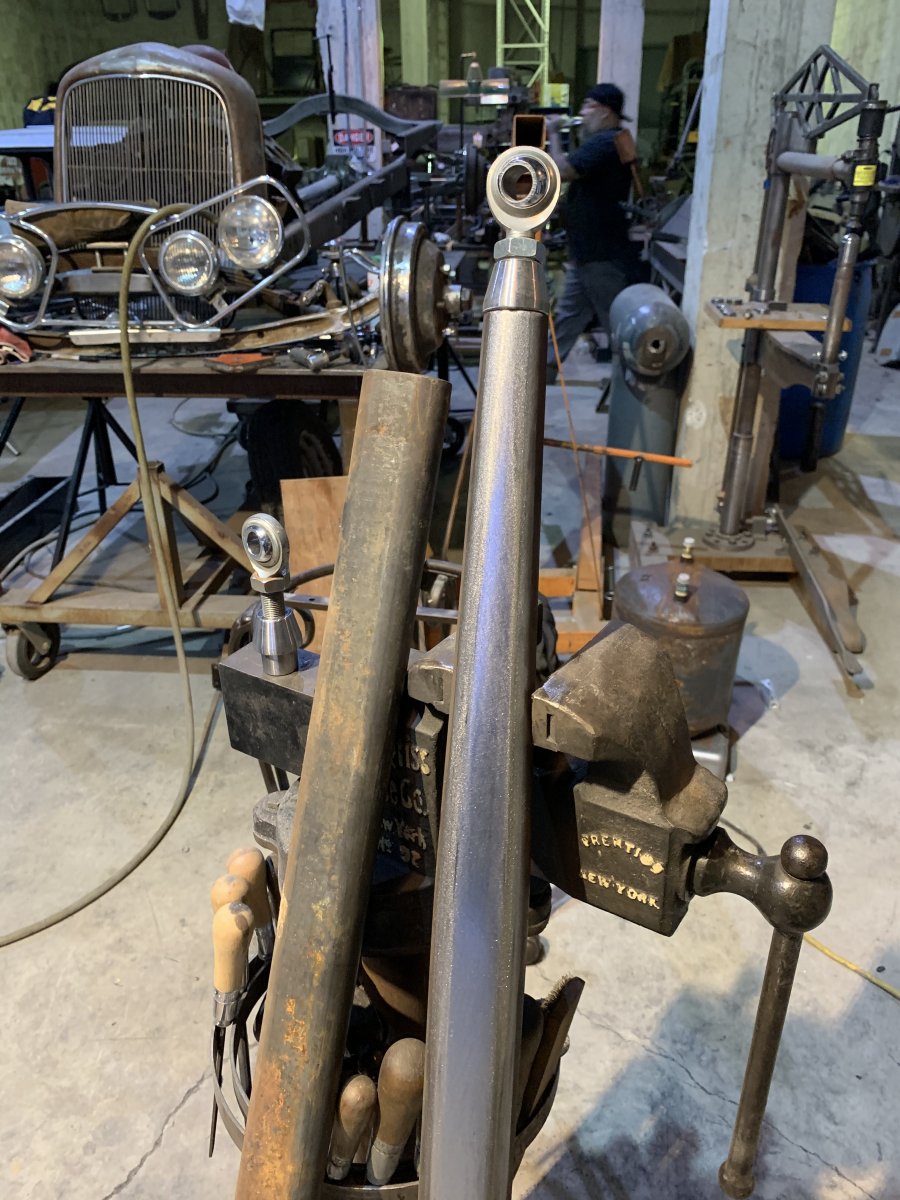

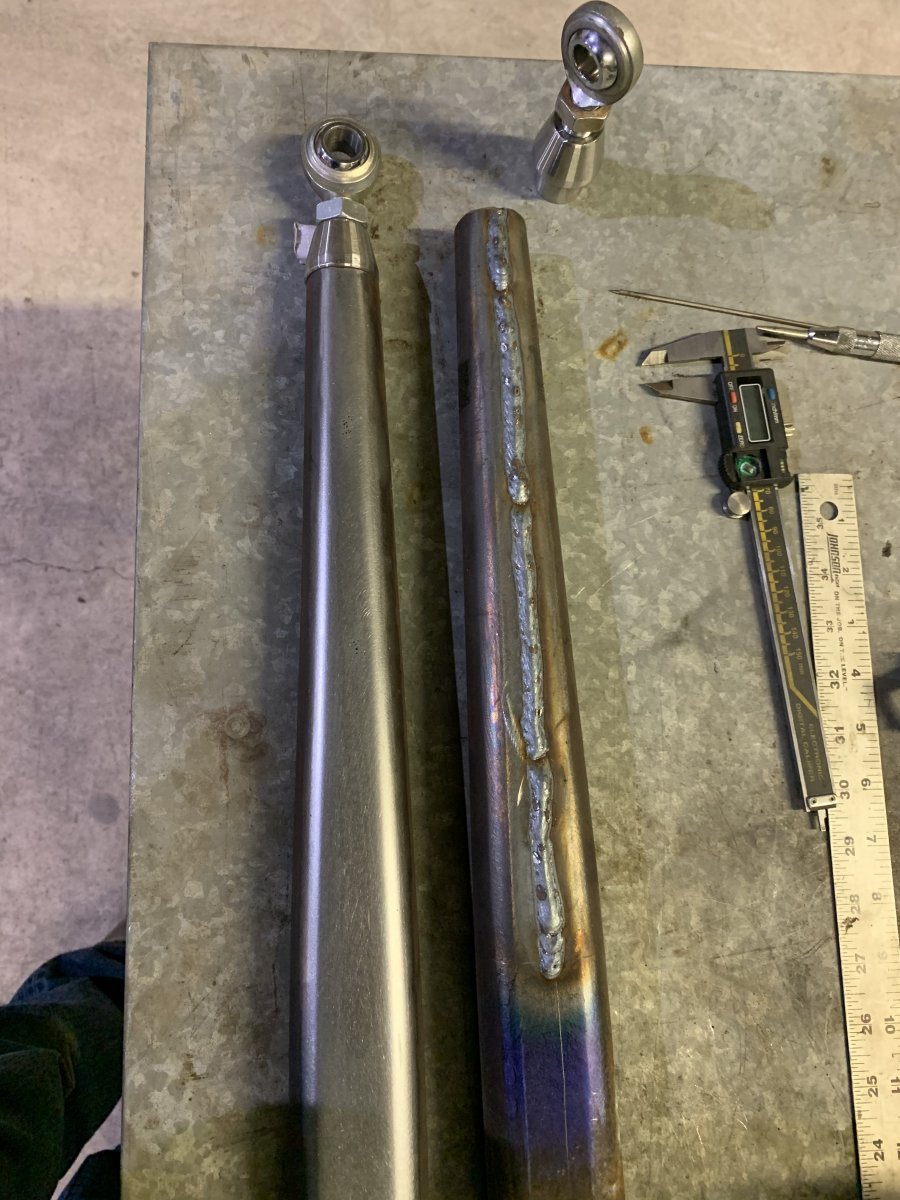

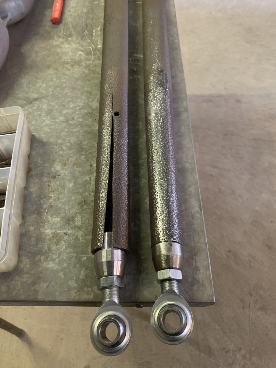

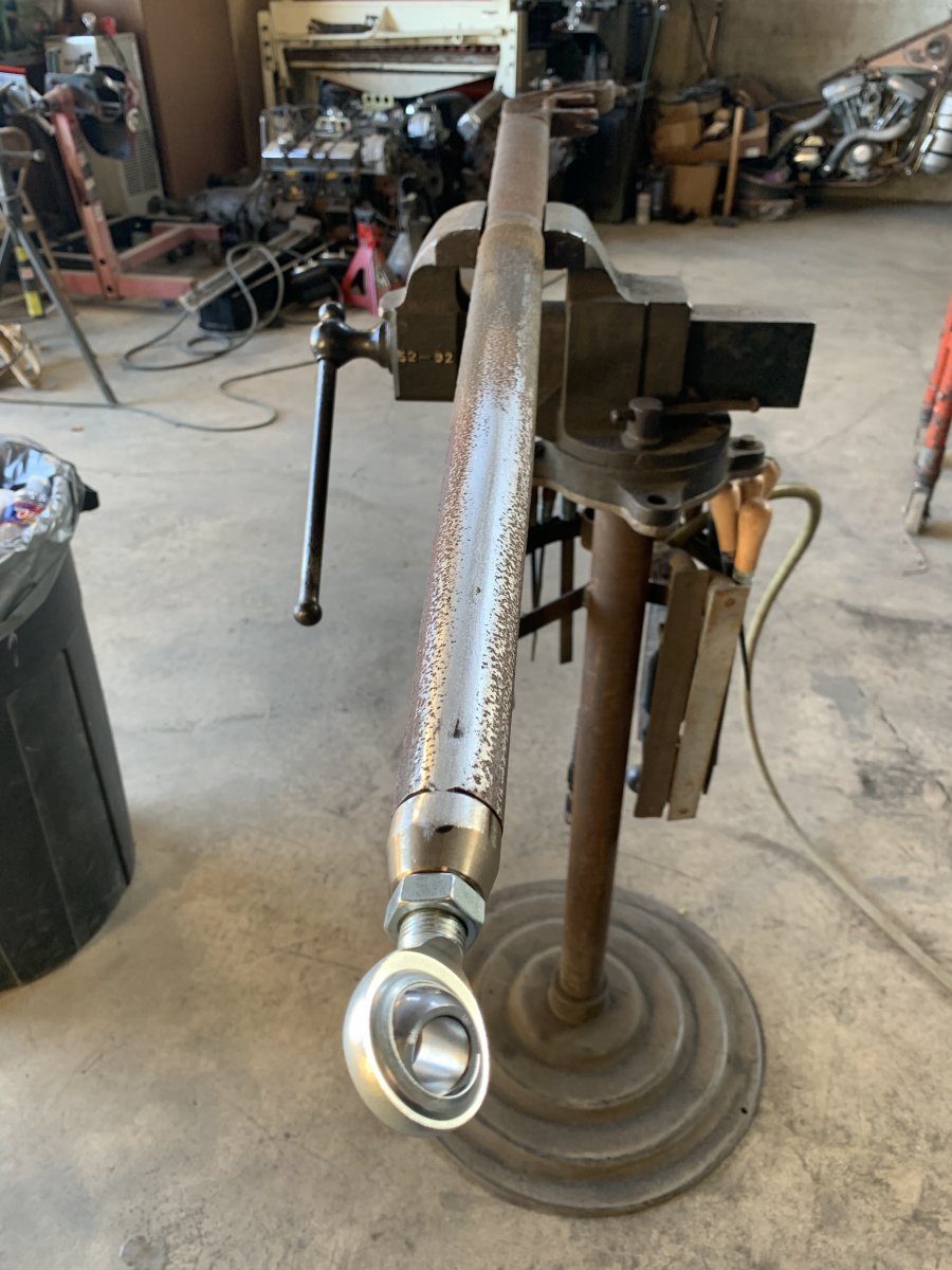

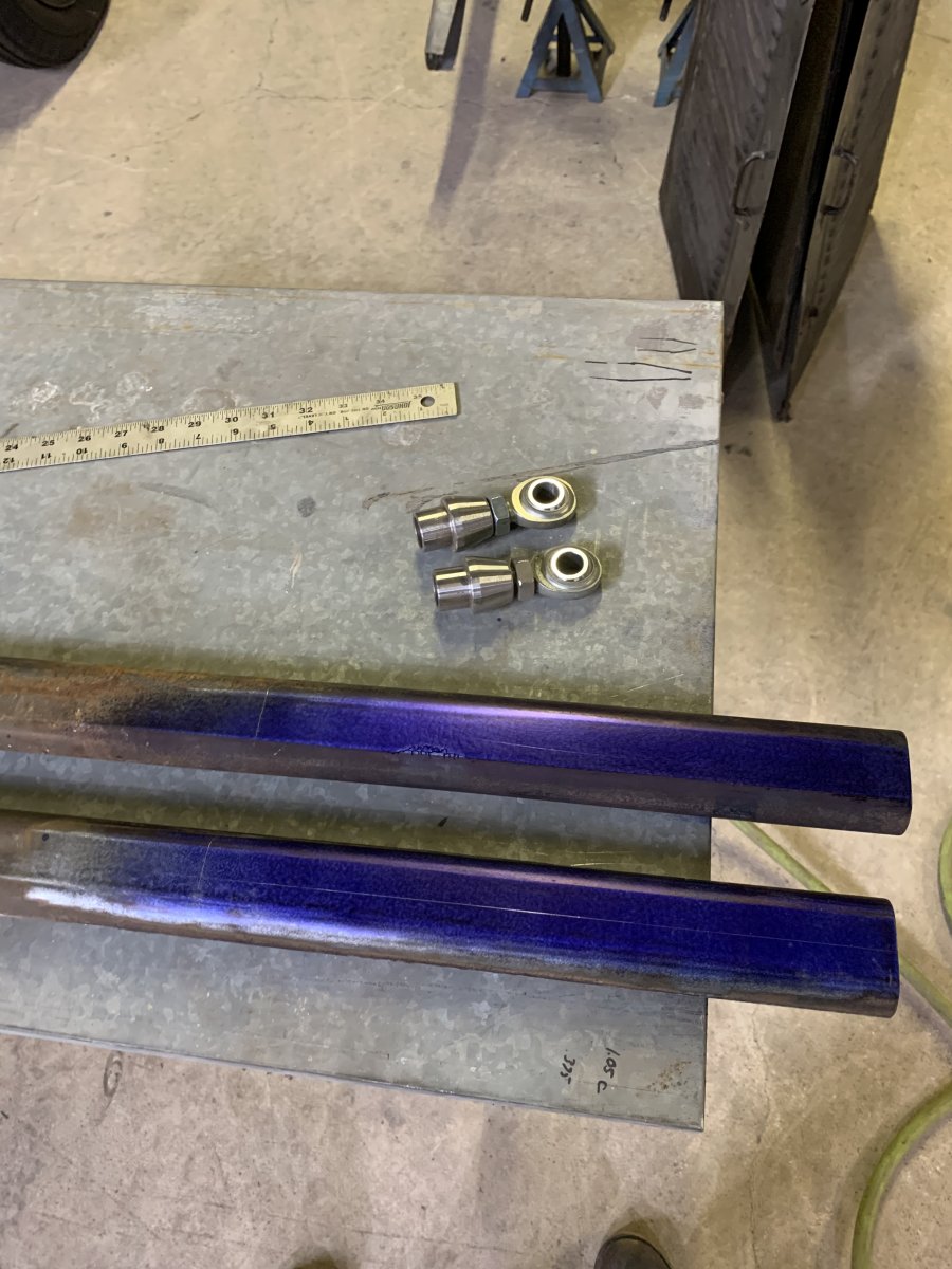

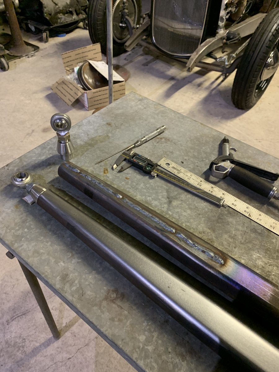

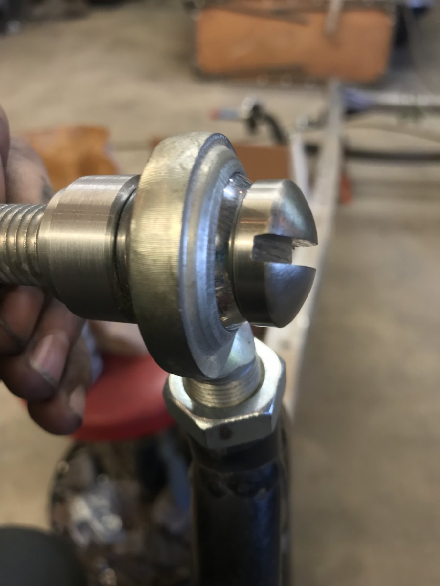

    Some before and after of the rear radius rods that were cut to fit the heim joints. E9ECA354-8235-495C-8C02-3EB287CFA001.jpeg 285A86D1-4A4C-4FE5-BE05-1BCB07834302.jpeg C20D38B9-60A3-4BEB-94F2-84D08EF45294.jpeg F905C825-294A-43C0-8E65-65CF7994EB56.jpeg B494ACB9-CD14-4326-AAA0-5A2448524B23.jpeg F72BA2AF-784C-46F7-8663-F3AA9977020F.jpeg

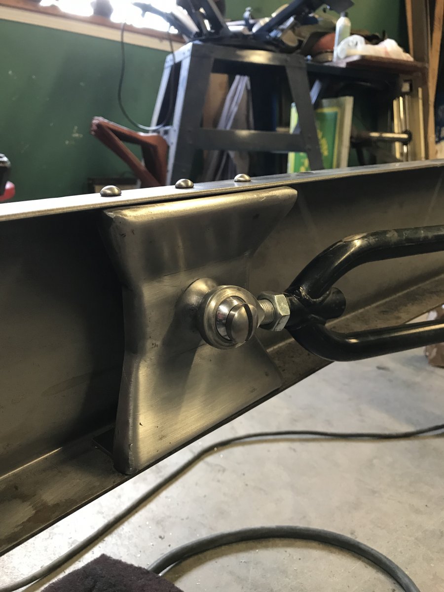

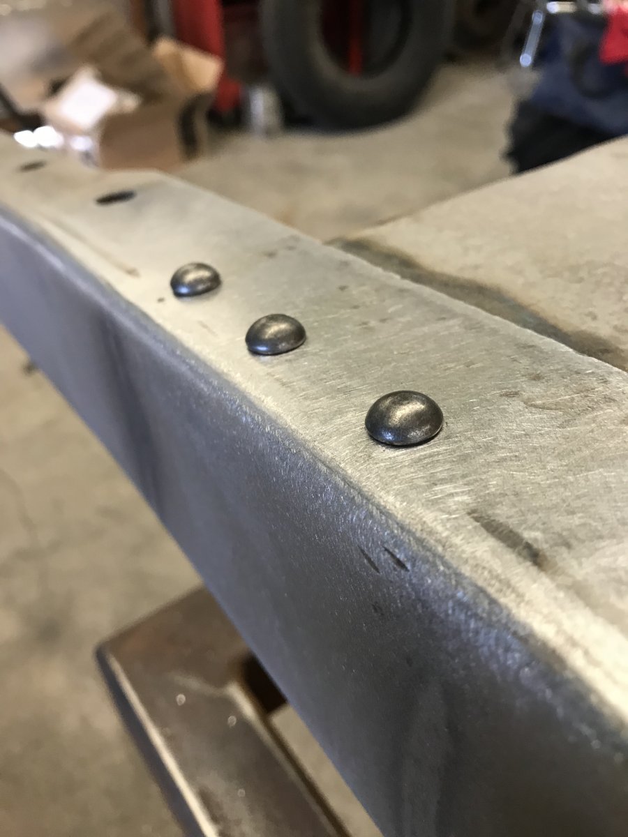

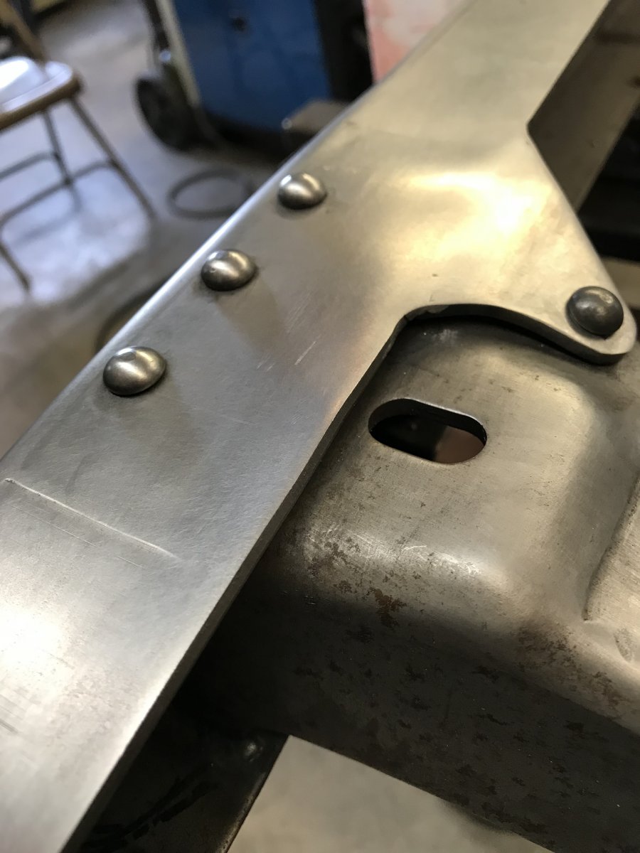

  16. speedster t
    Joined: Nov 19, 2019
    Posts: 29
    speedster t

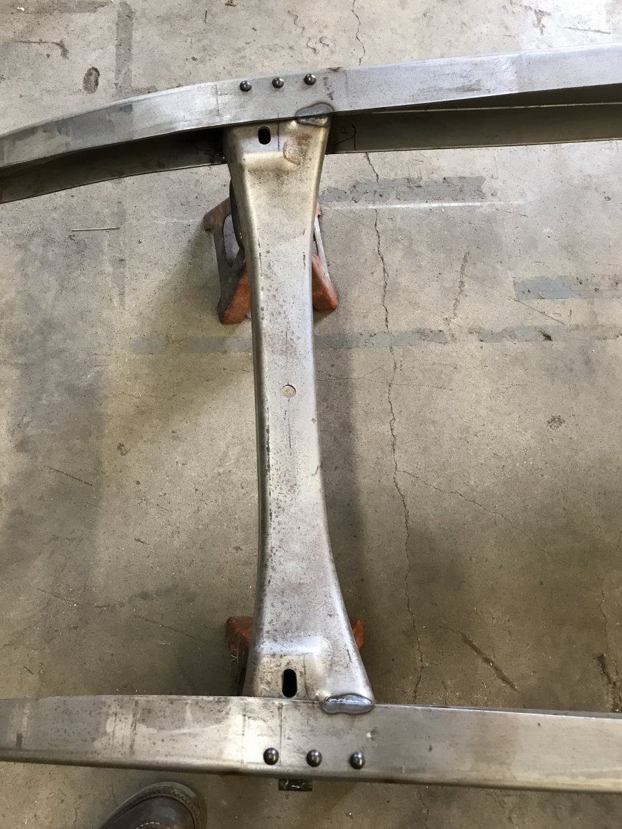

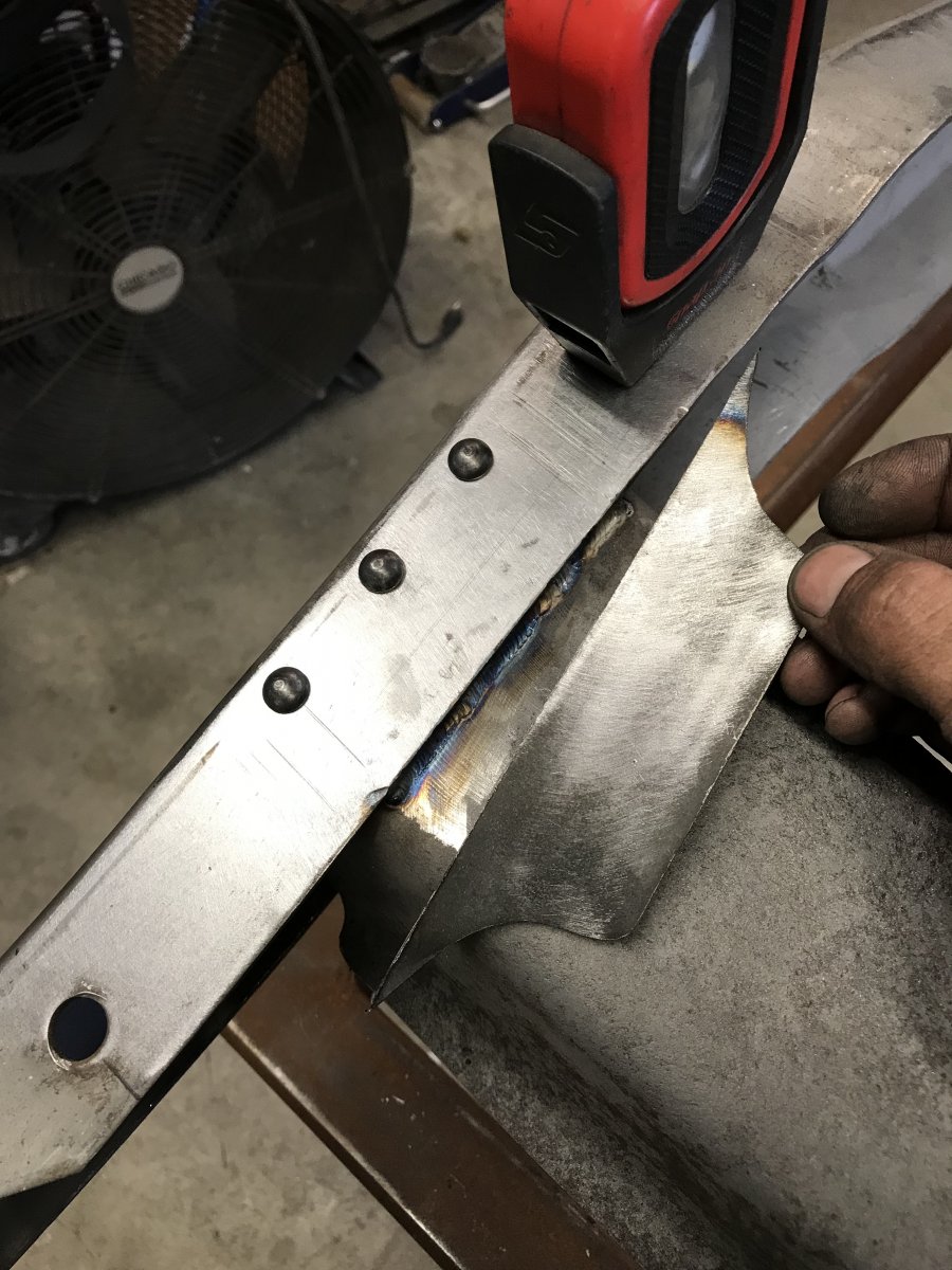

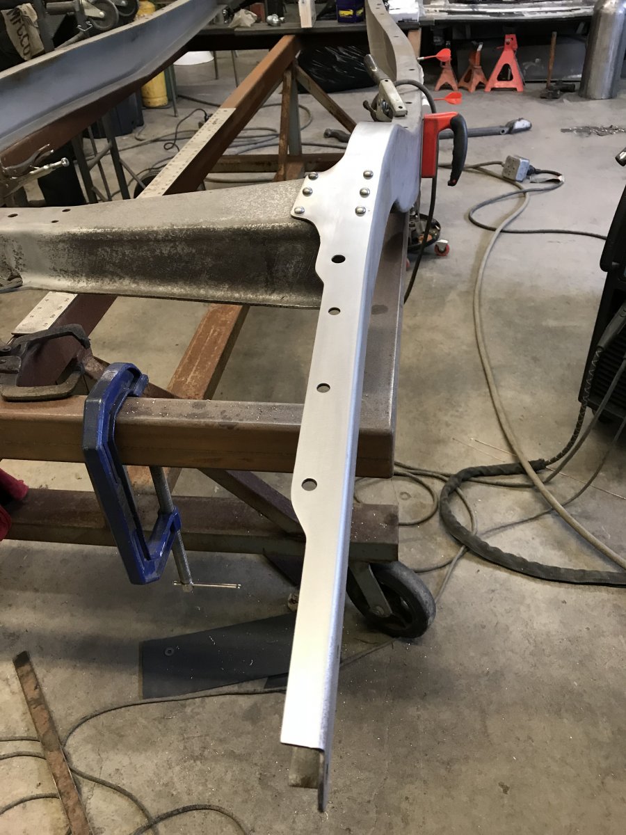

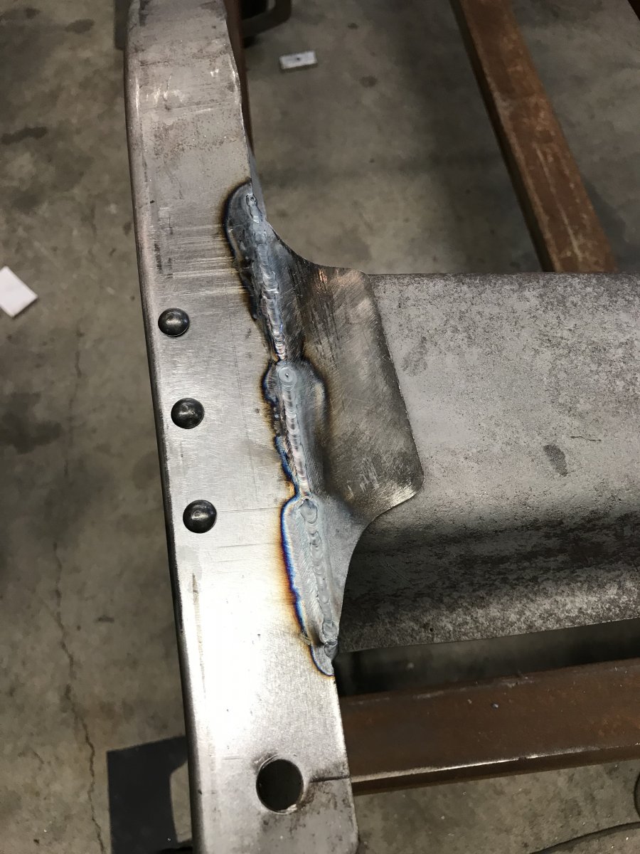

    It looks like you first welded the crossmenbers to the frame rails. The rivets are mostly for detail correct. Very nice build
    Stogy likes this.
  17. Joe Rosales
    Posts: 197
    Joe Rosales
    Yes, that is correct. The cross members have either been Tig or MiG welded in the inside.

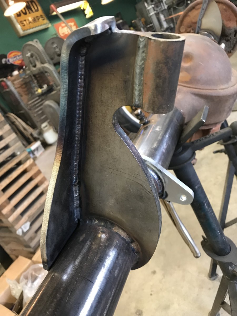

  18. 6sally6
    Joined: Feb 16, 2014
    Posts: 2,467
    6sally6

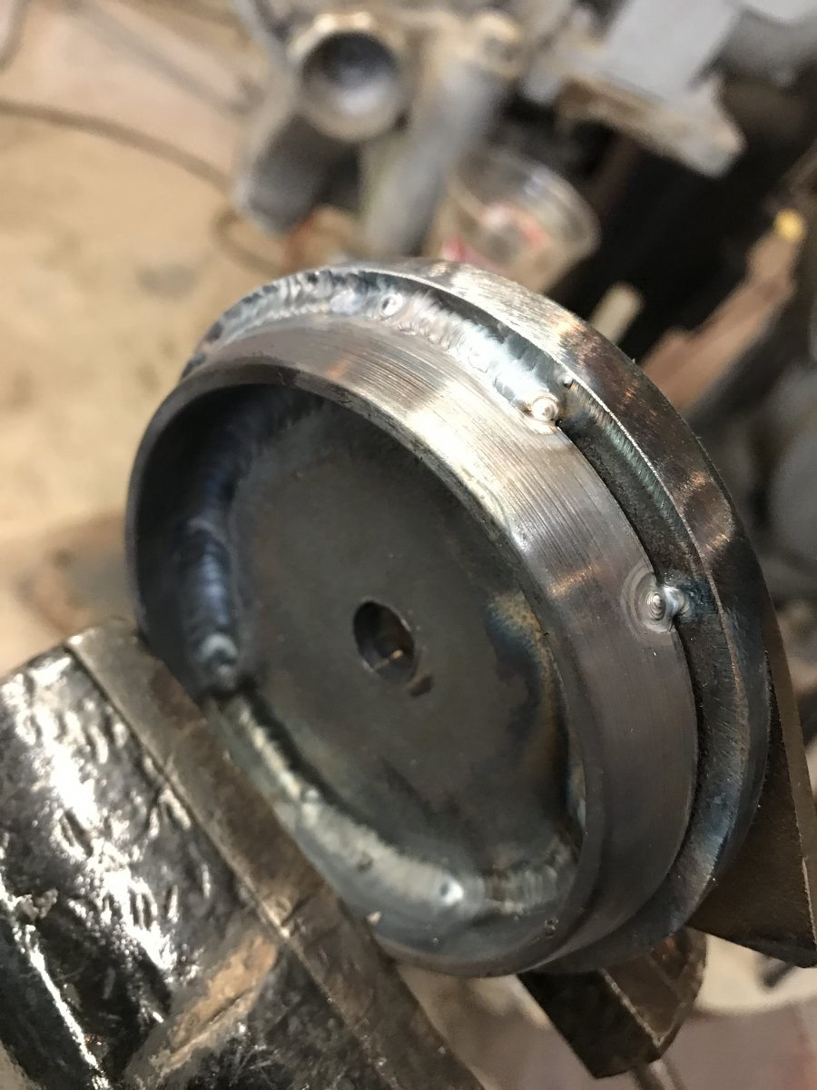

    Nice fab work and welding.

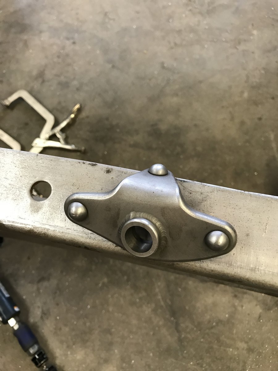

    As a retired welder I have a question though.. Are you going to put a "cap"/final weld around the under-cut spot on the motor mounts where its welded to the frame? Nice 'row-of-dimes' cap around the mount would be purrrrfection IMHO!
    You know how it is......being a welder I look at stuff most non-welders don't see.....not throwing stones.

  19. Joe Rosales
    Posts: 197
    Joe Rosales
    Frame mounts will have a cap around once they are finished.

  20. Joe Rosales
    Posts: 197
    Joe Rosales
    Ok guys just a update from my previous post. Originally I was running rear hairpins, but I just didn’t like to look of it so I removed them. After installing the xmember to the deuce frame 35-36 rear wish bones seem to be the perfect fit. Not only was little to no mods had to be done they look great and also give me that traditional look that I want to stick with. Of course I had to pie cut the rods to fit the heim joints and a bit of magic to recreate that pitted look that time has done to 80 year old parts. Thank you everyone for following this build. Not as close as we would like to be but she is coming along nicely. Chris and I are very proud of this little car!

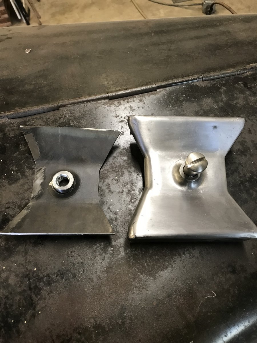

  24. Joe Rosales
    Posts: 197
    Joe Rosales

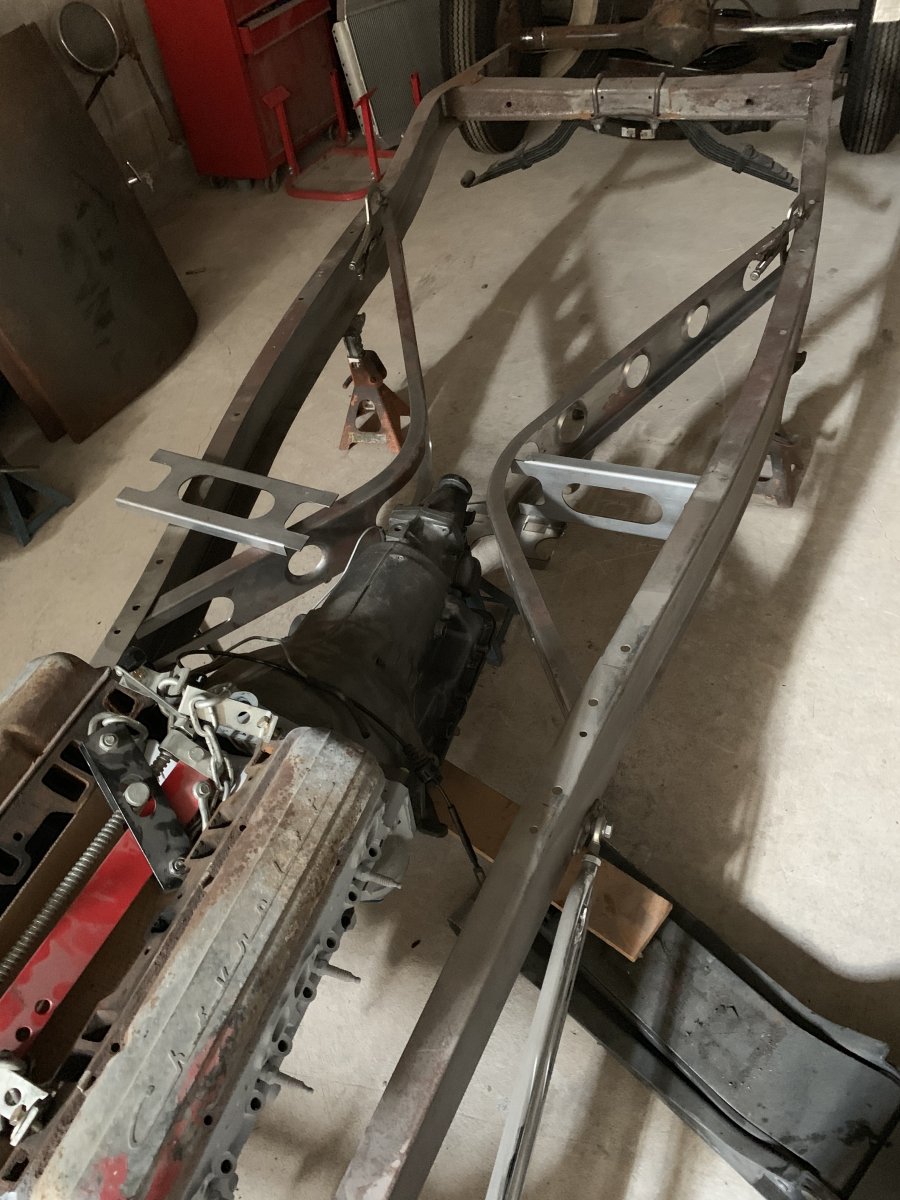

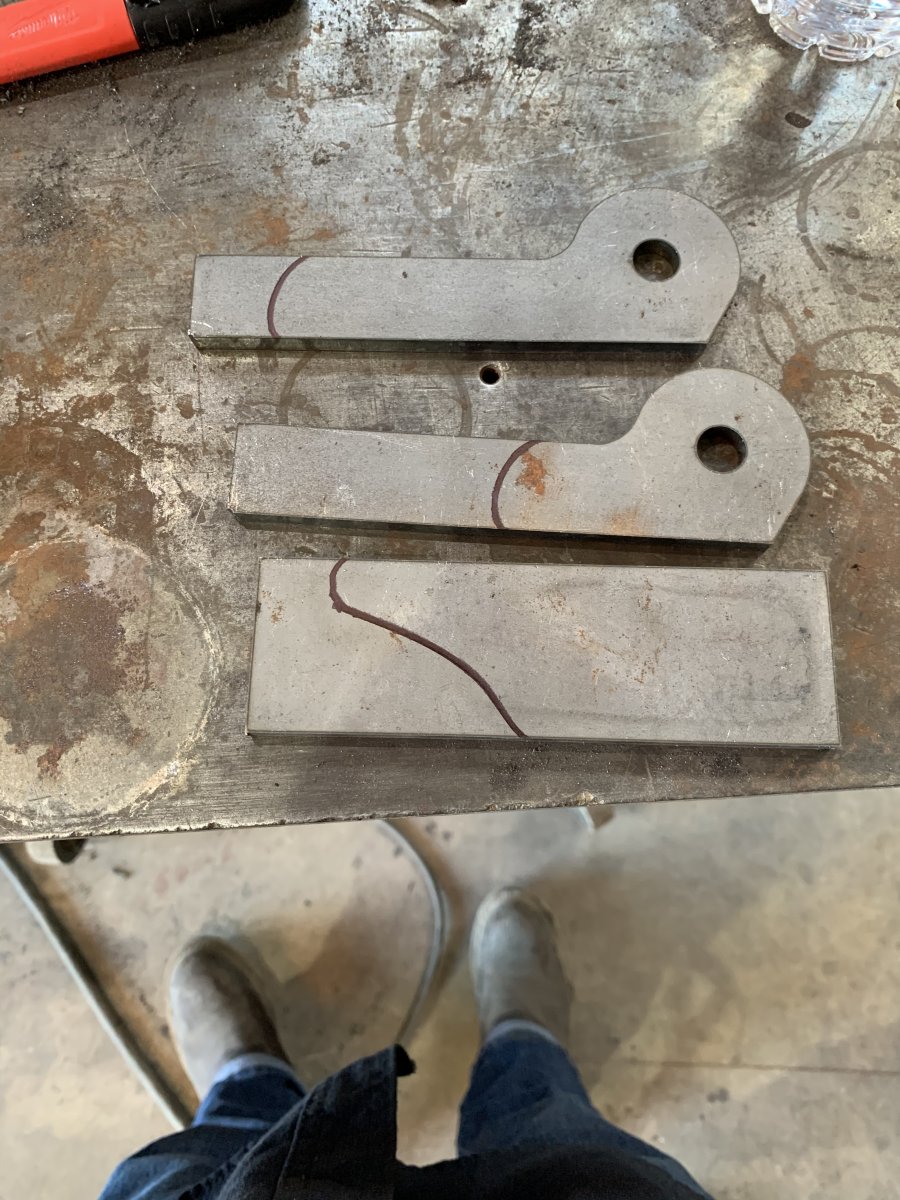

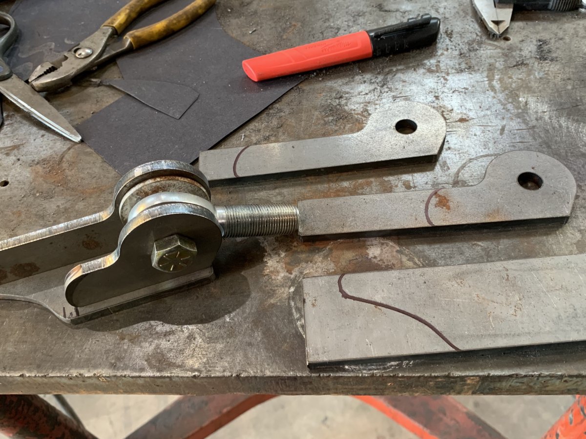

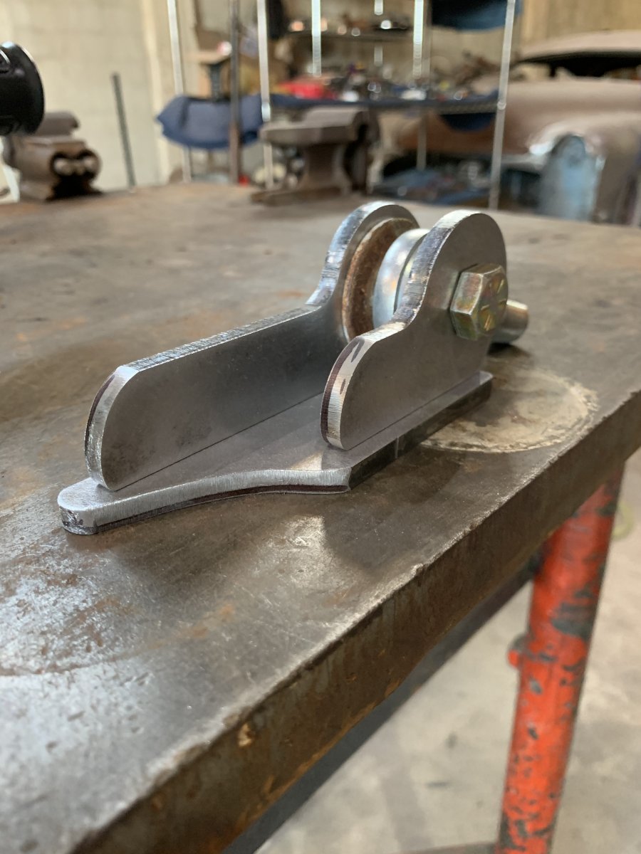

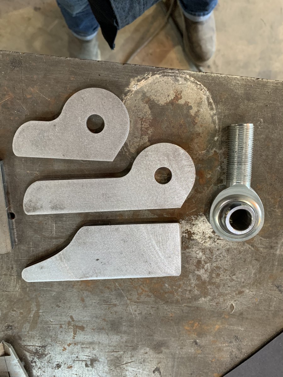

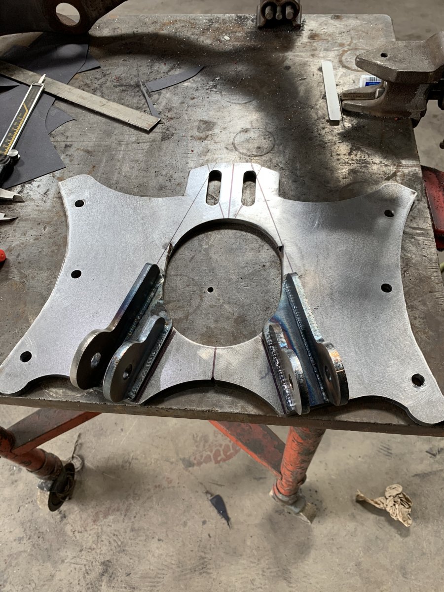

    Some brackets for the rear wish bones that will be welded to the xmember transmission mount.

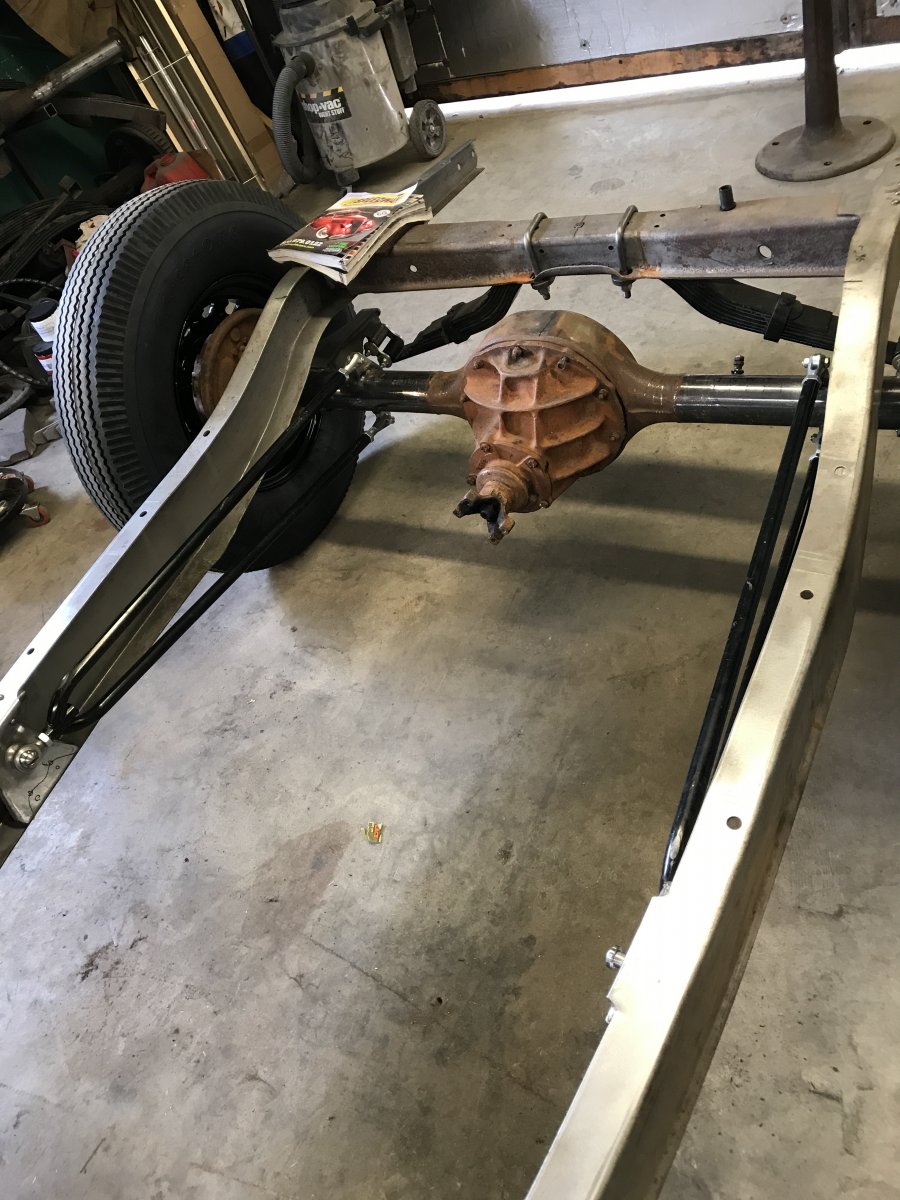

  26. Joe Rosales
    Posts: 197
    Joe Rosales

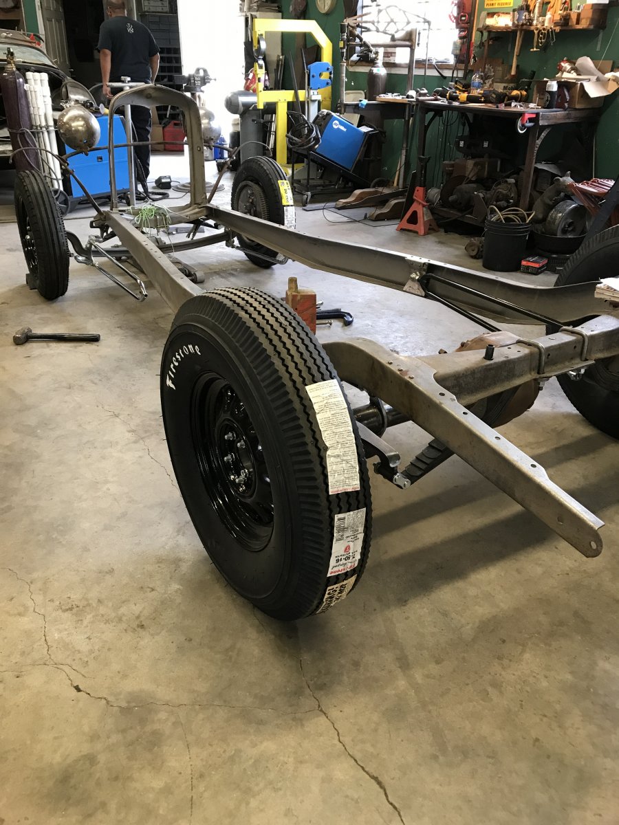

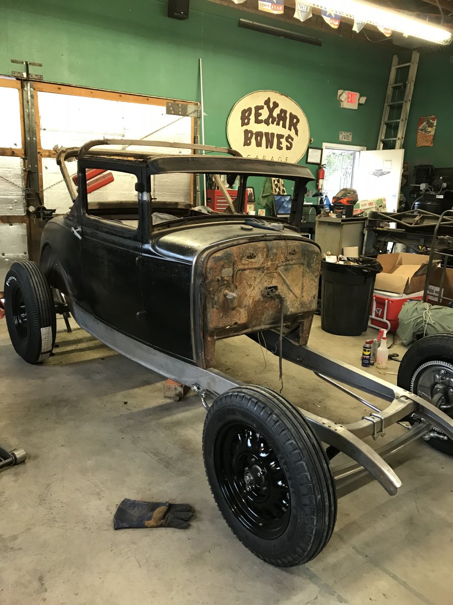

    Finally got the rear end all back together and officially a roller again for the last time. Everything looks and fits great with the Xmember. A few final touches to frame rails and then on to the steering box. I thought building a car was supposed to be easy.
