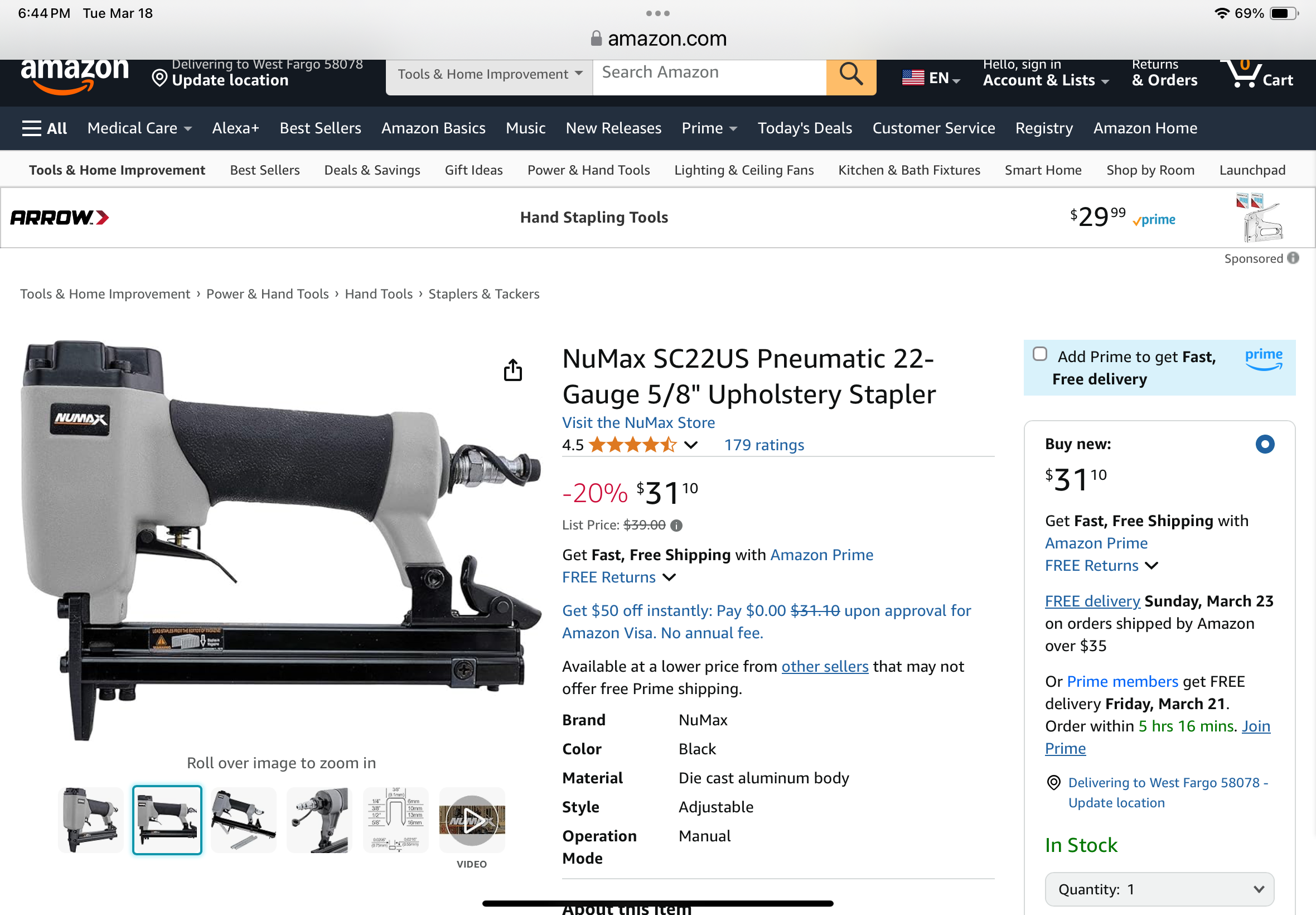

    @SDS sorry I cant help on the stapler as mine is on its last leg. @jakesbackyard looks like a inexpensive replacement. I was wondering if anyone tried the milwaukee battery ones

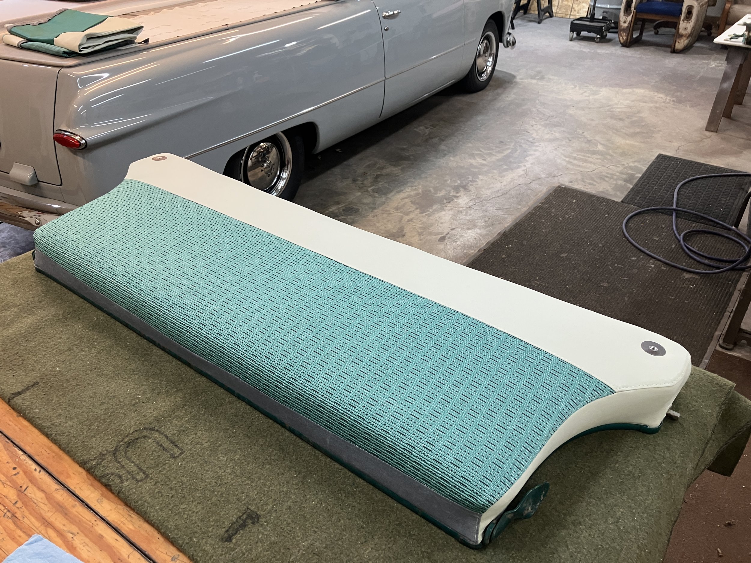

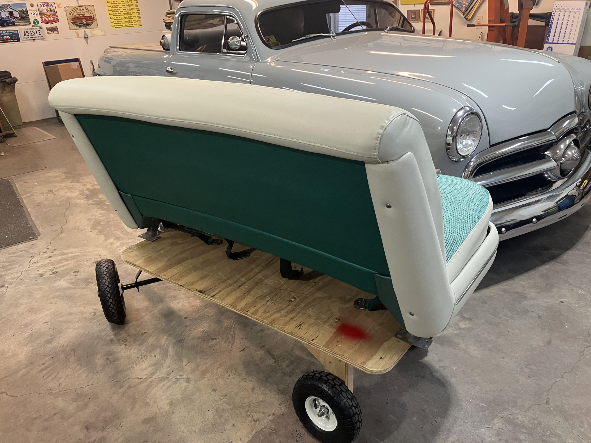

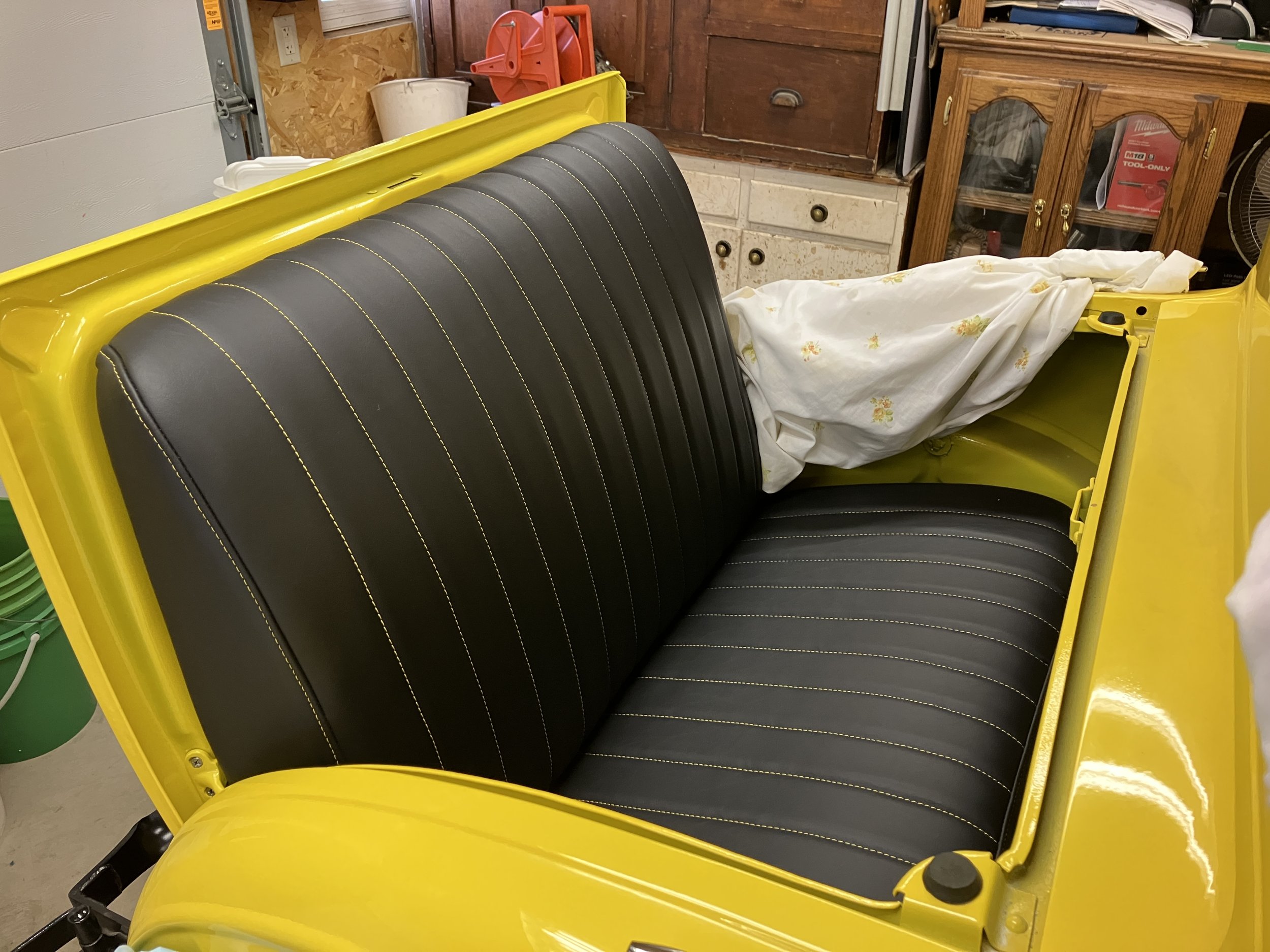

    1. Upholstery
    Did another Hot Rod Model A Coupe seat…
    34 GAZ, clem, 3quarter32 and 26 others like this.

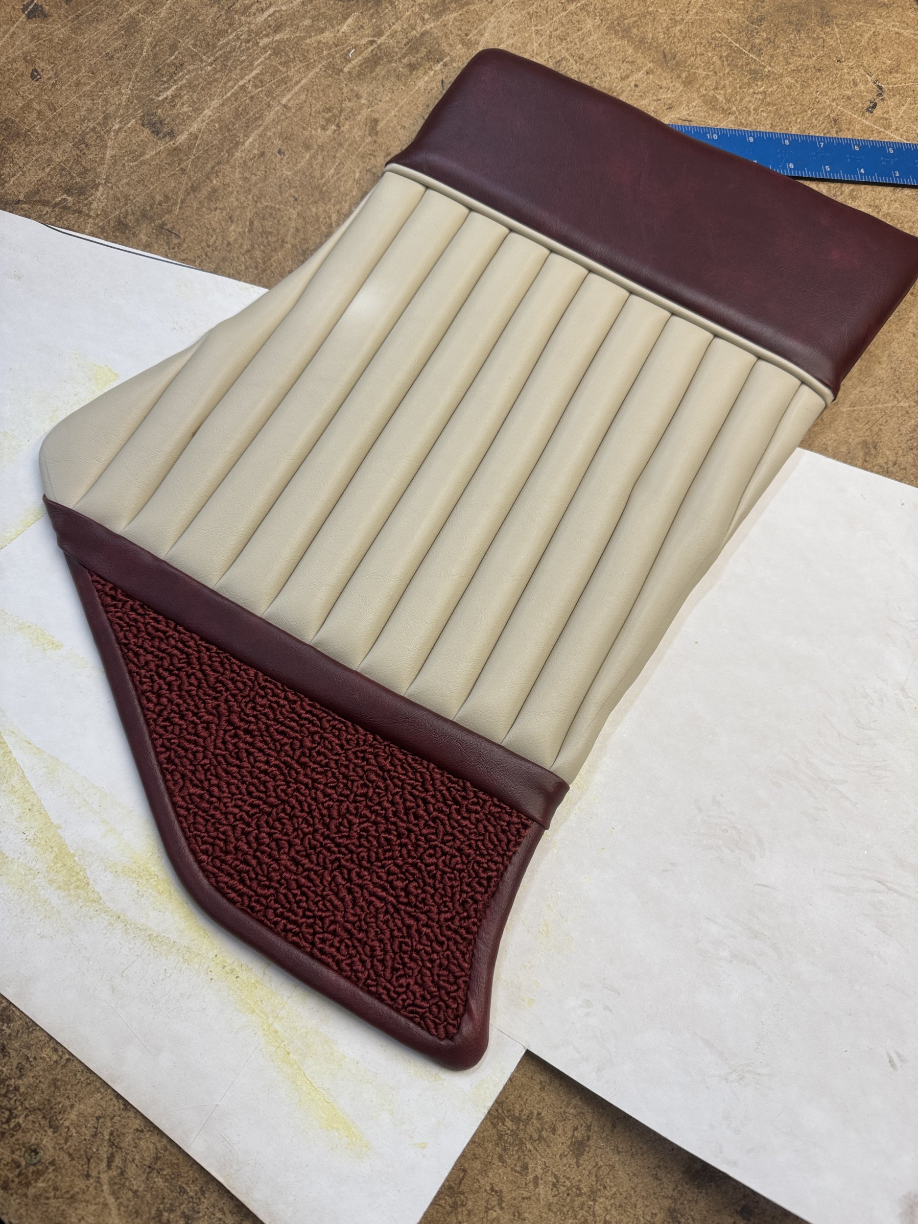

    Here’s one I did for my coupe, I made a thread on it but it dropped like a rock IMG_5332.jpeg IMG_5498.jpeg

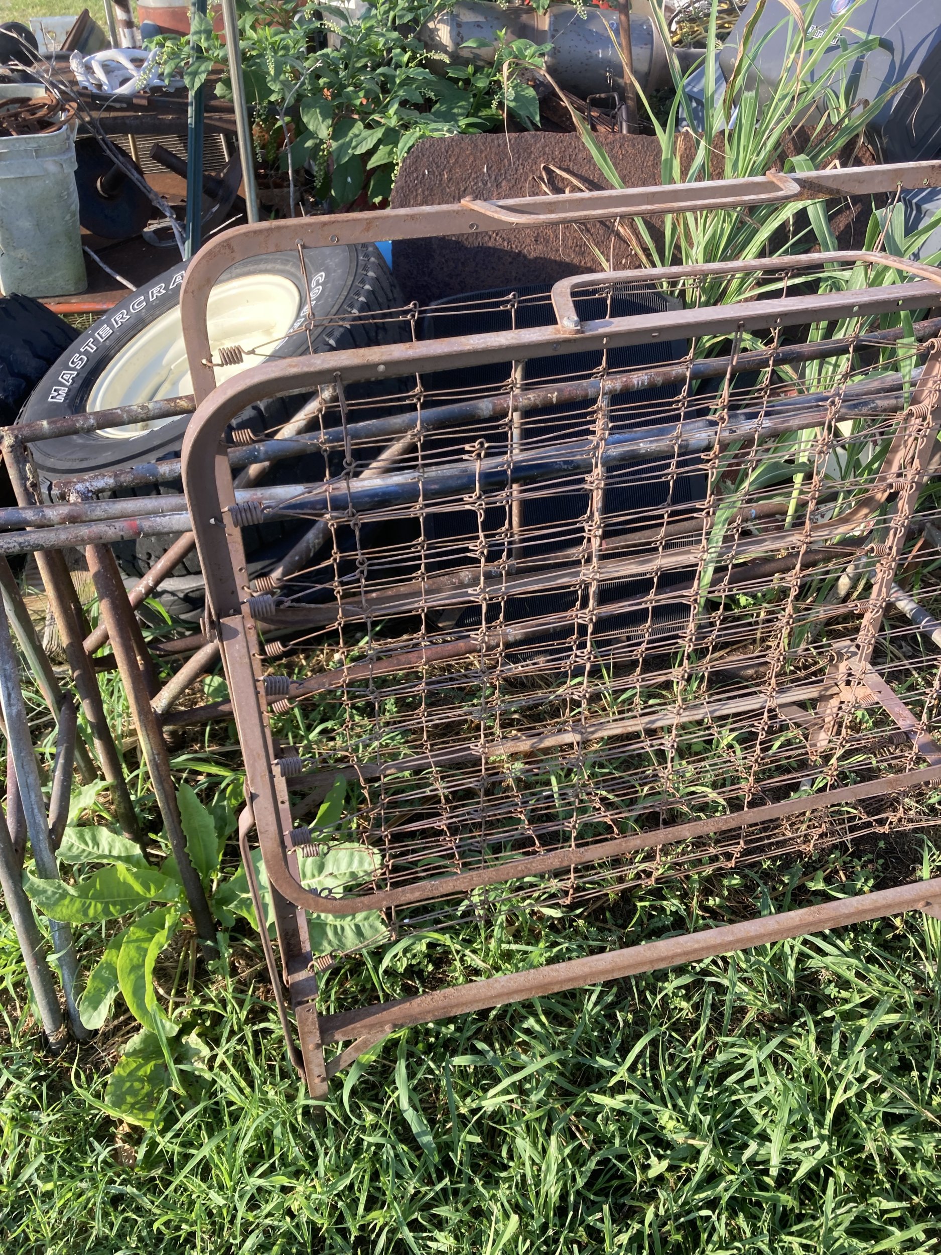

    IMG_2378.jpeg I have this daybed frame . Would the springs be a good choice for a seat ?

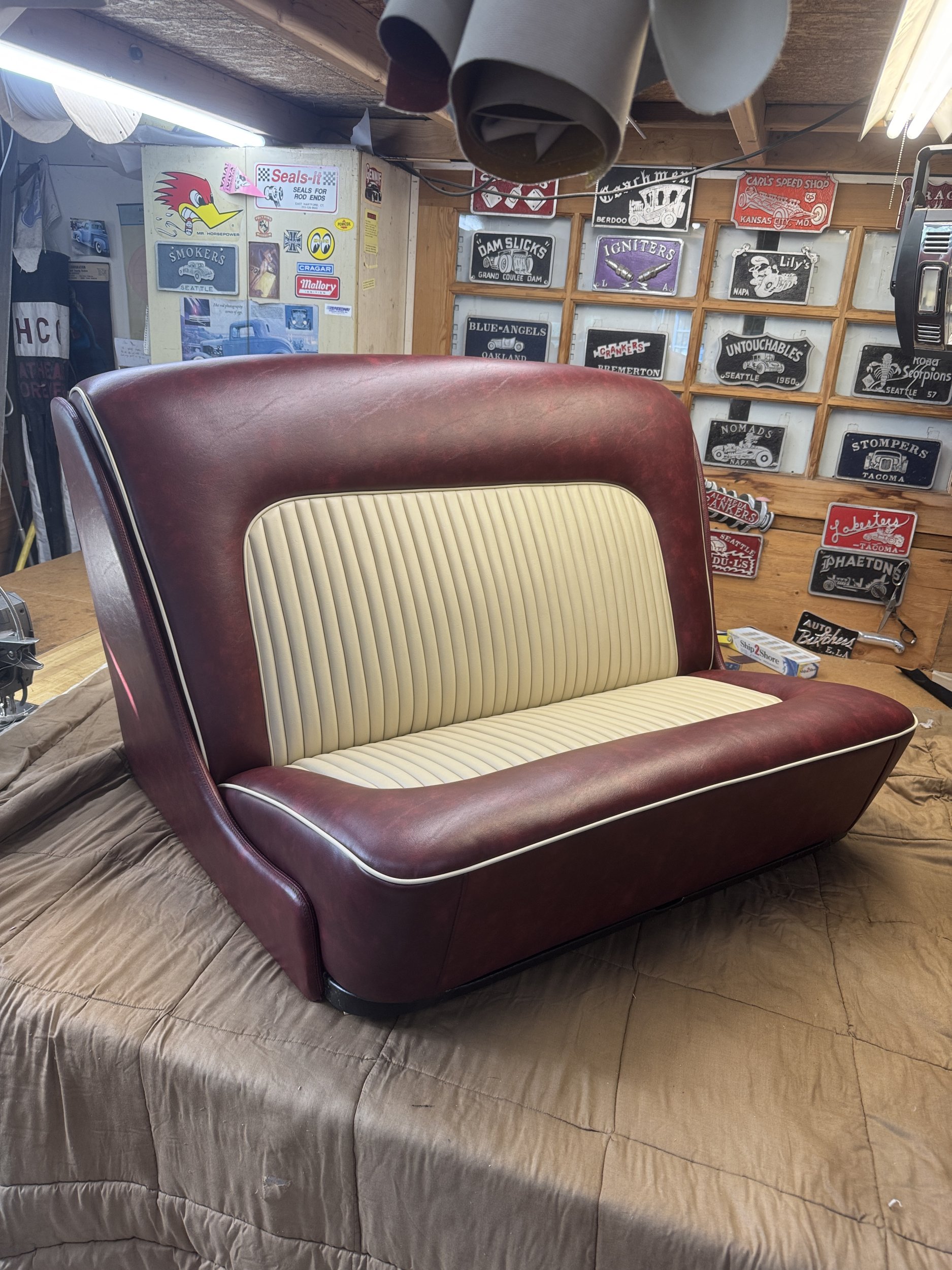

  13. F-head
    Joined: Oct 20, 2007
    Posts: 1,446
    F-head
    I always tell people to buy some cheap vinyl and some 1/2” scrim foam and make a few pleated panels , then make a mini bike seat
    Then just scale it up
    There’s a few simple rules I was taught
    Everything has a 3/8” seam allowance
    If you always make a 3/8” seam allowance you get used to lining that up as it goes under the foot of the machine
    I always just use the same welting foot for everything on my machine
    I use 1/8” solid nylon welt cord and the vinyl is cut at 1 1/4” for the welt cord
    The welt cord sews on the facia first then the boxing ( sides) goes on
    I use 1/4” scrim foam on the boxing
    That helps the boxing stay smooth
    If you are doing tuck pleats you lose 3/4” for every pleat, so for 2” pleats they have to be layed out and sewn at 2 3/4” then after you sew them on the back they come out at 2”
    Here’s a pic of my coupe seat in the car with the door and kick panels
    Upholstery is achievable with a little practice and a lot of hard work IMG_5614.jpeg IMG_5611.jpeg
    rod1, Deutscher, alchemy and 15 others like this.

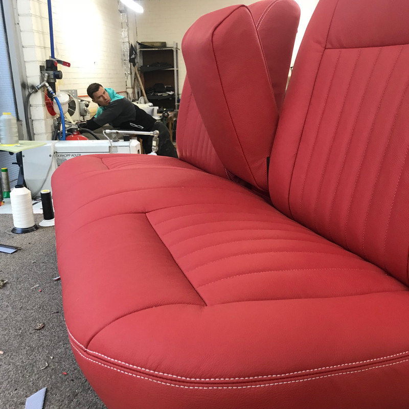

    I thought I would add a picture of my bench seat that my trimmer sent me that's going into my Ranchero build. Done in red leather with some selective white stitching. I am happy with it
    Cheers Turns
    Deutscher, 3quarter32, drdave and 9 others like this.

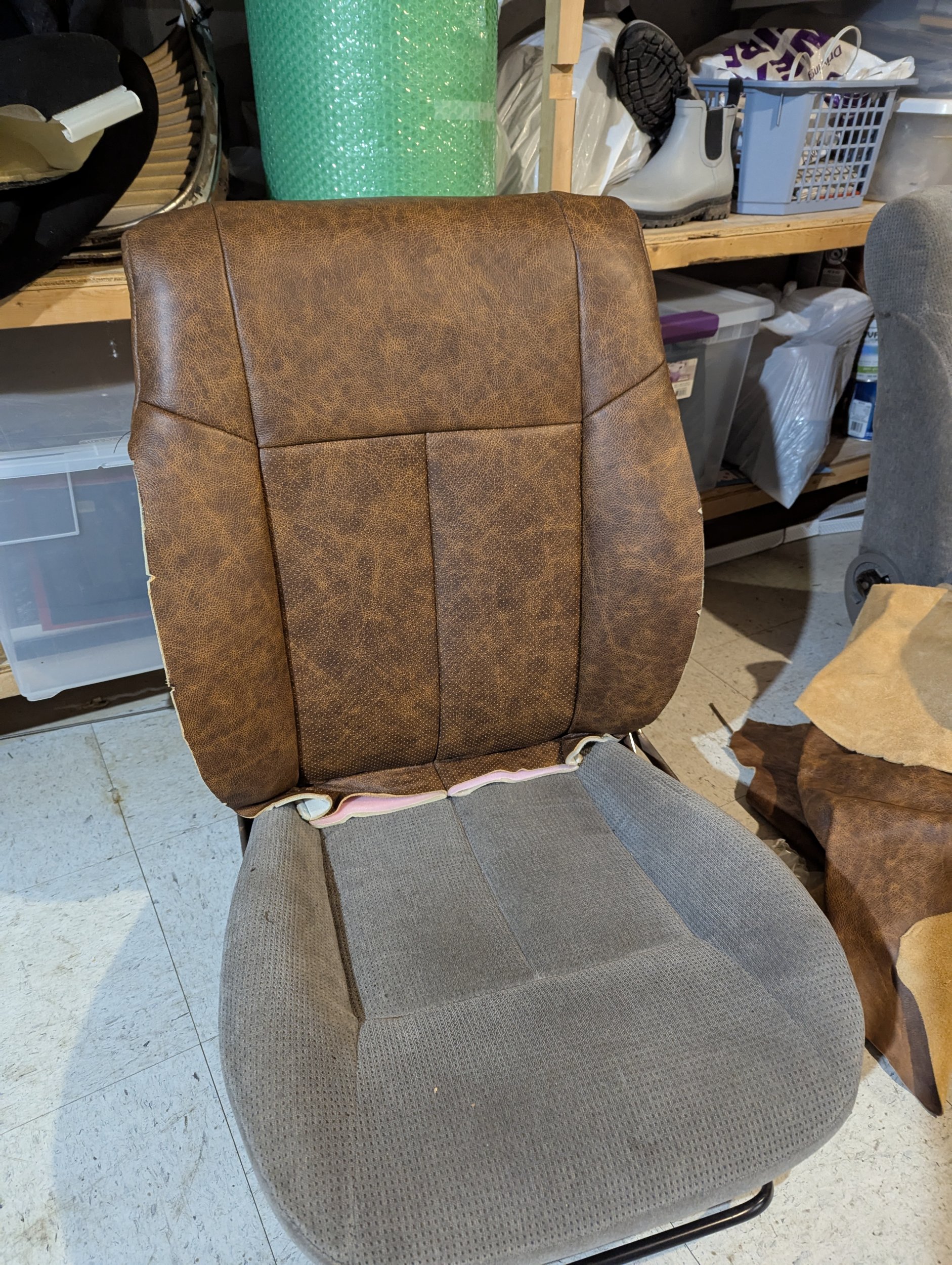

    2025.07.16 Startingon the leather seat trim.jpg I decided it's been too hot to work in the garage, so I finally started working on the new covers for the '33 Pontiac coupe seats.
    The seats came out of a 2000 or 2001 Saturn L series sedan.
    Replacing the gray cloth with "Saddle Bag" leather.
    rod1, Okie Pete, Deutscher and 4 others like this.

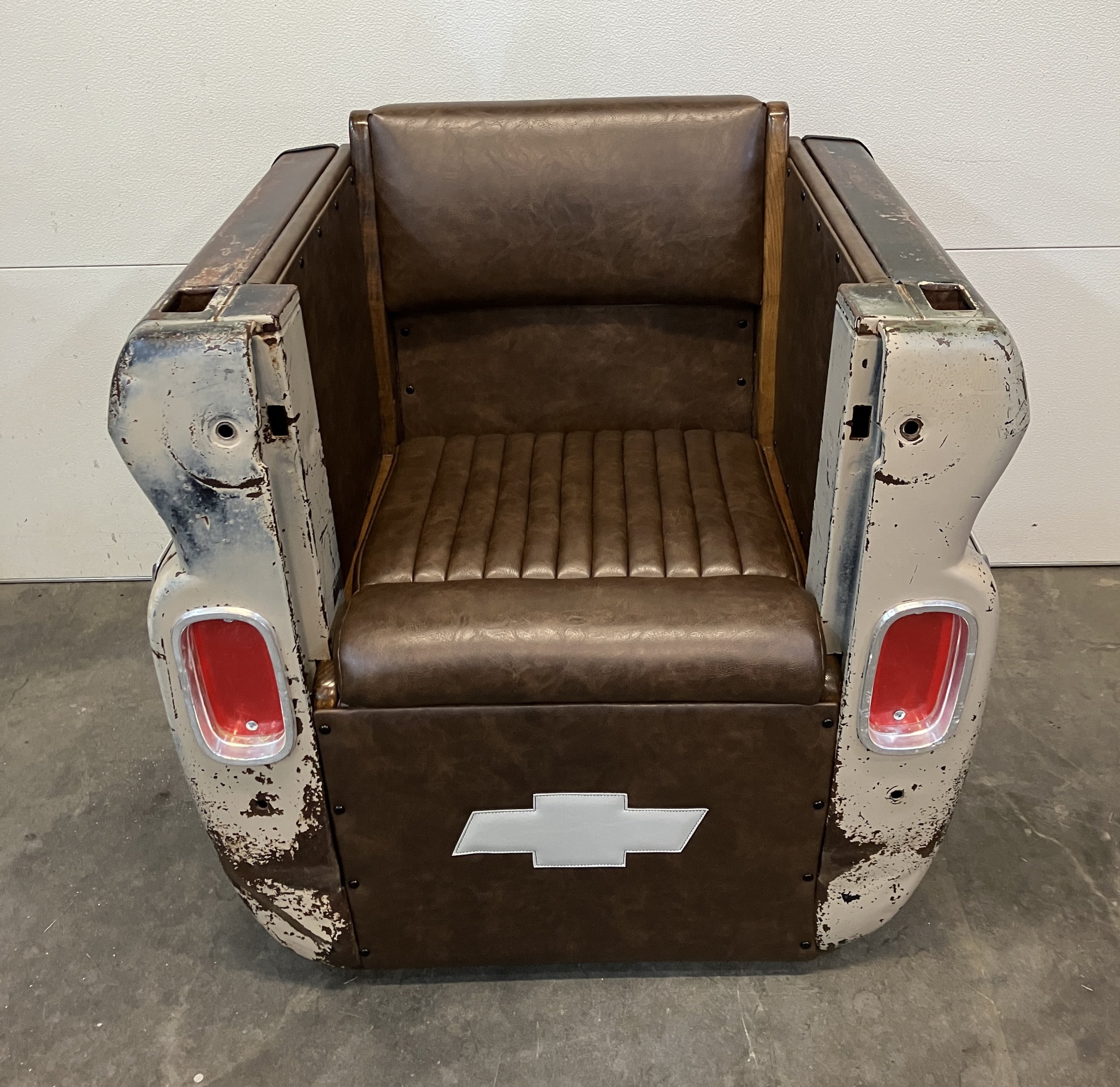

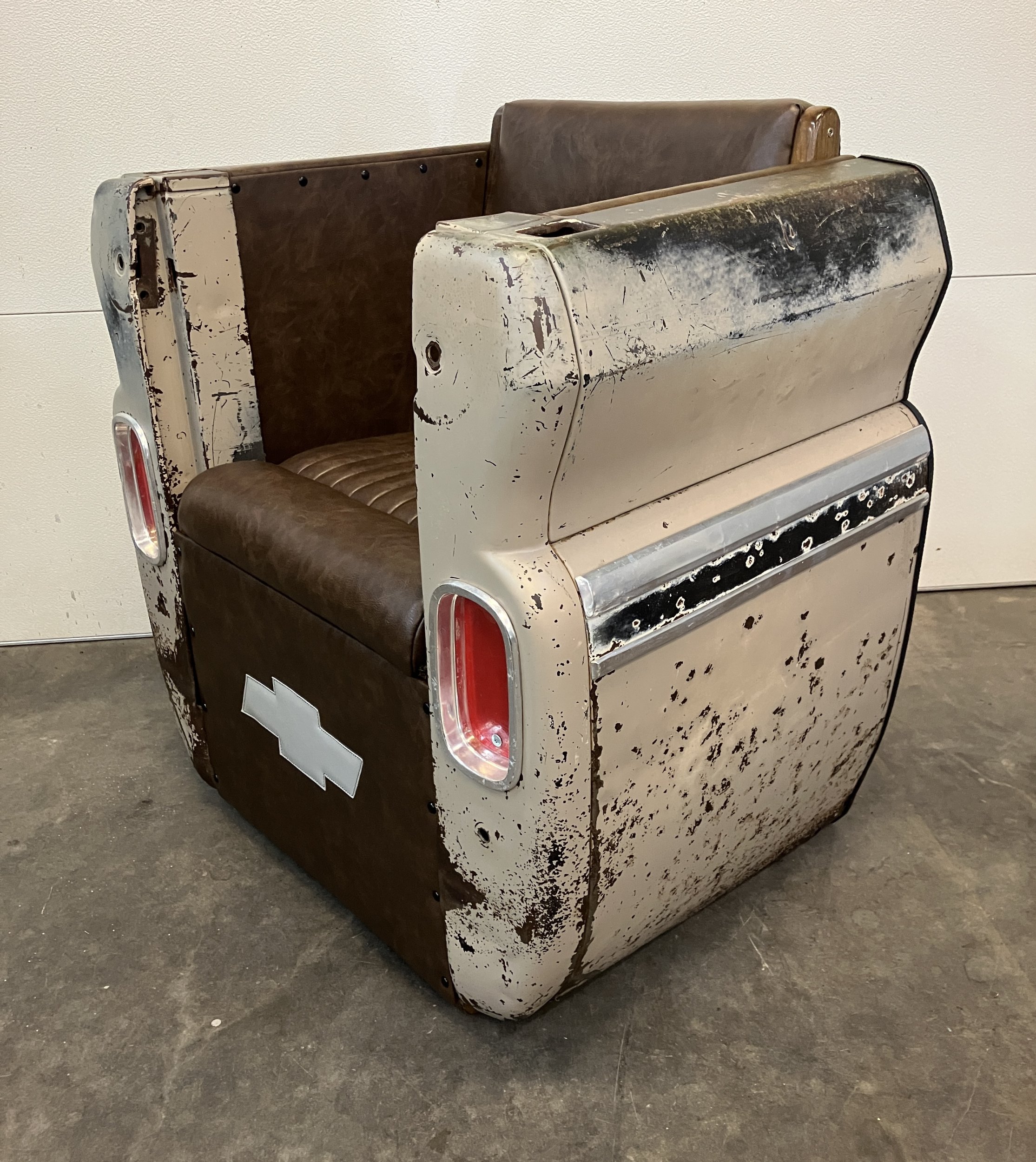

    1. Upholstery

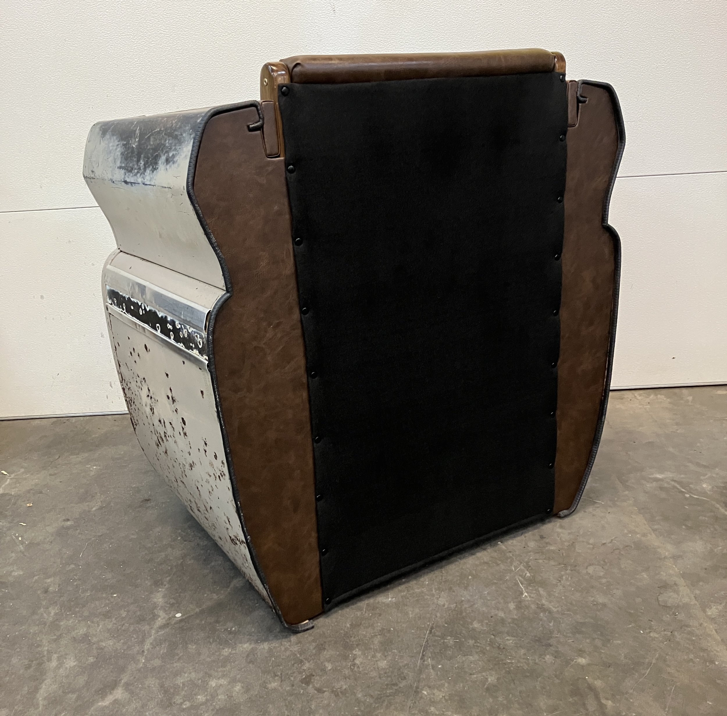

    I finished up a patina 60-66 Chevvy box side chair. Scrubbed the box sides with hull cleaner and scotchbrite and then sprayed with 2 coats of matte finish clear. Attached the sides to some side chairs and panels I made and covered in distressed brown vinyl.
    3quarter32, rod1, Okie Pete and 7 others like this.

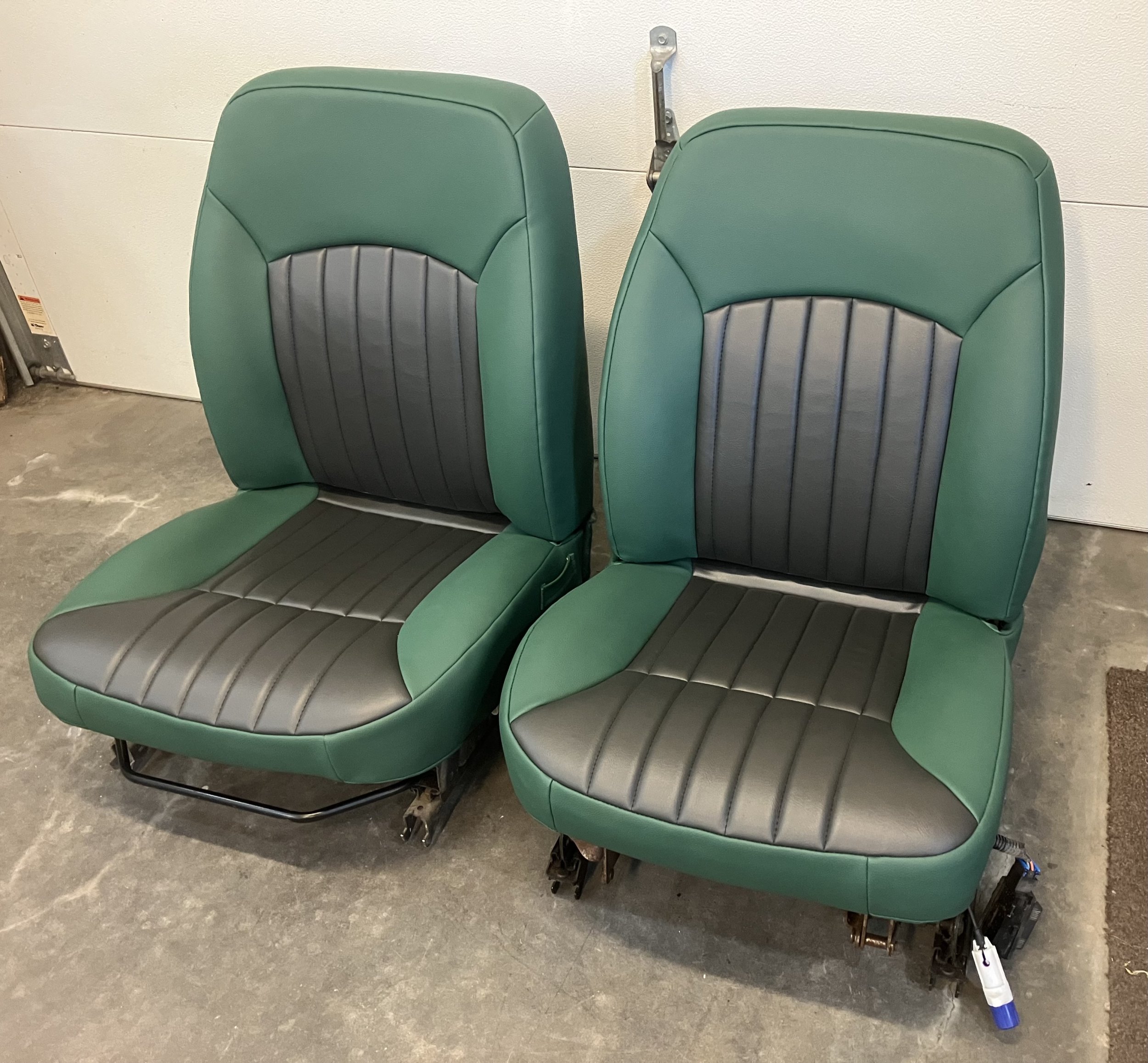

  25. is the stitching always supposed to be hidden?
  26. jakesbackyard
    Joined: Feb 13, 2007
    Posts: 922
    jakesbackyard
    from ND
    1. Upholstery
    It’s personal preference. If you look close (blow it up), the inserts on the green and charcoal buckets are only pleated on the inserts. You can see the thread.
  27. F-head
    Posts: 1,446
    F-head
    Pleats with hidden stitching are called tuck pleats as in Tuck and Roll
    Pleats with stitching that shows are called top sewn pleats
    An interior with top sewn pleats and a roll on the bolster would be called rolls and pleats
