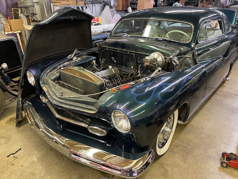

    Demolition has started, if even just a little bit....

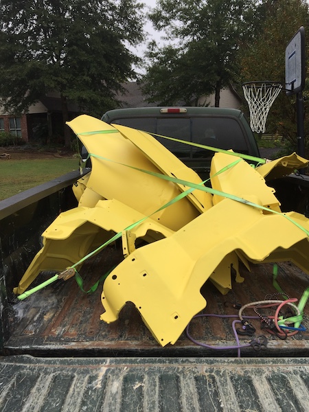

    Just for grins and to keep things rolling, here's the new front cap going on. Stumbled into a whole front end a few years ago for suuuper reasonable, so I picked it up and had it blasted and put in epoxy. It's been standing in the corner and the rafters teasing me ever since. The time has come....good bye chopped up inner fenders, hagan headlights, semi truck wheel trim rings posing as Buick portholes in the hood and the rest of the ghost flames...
