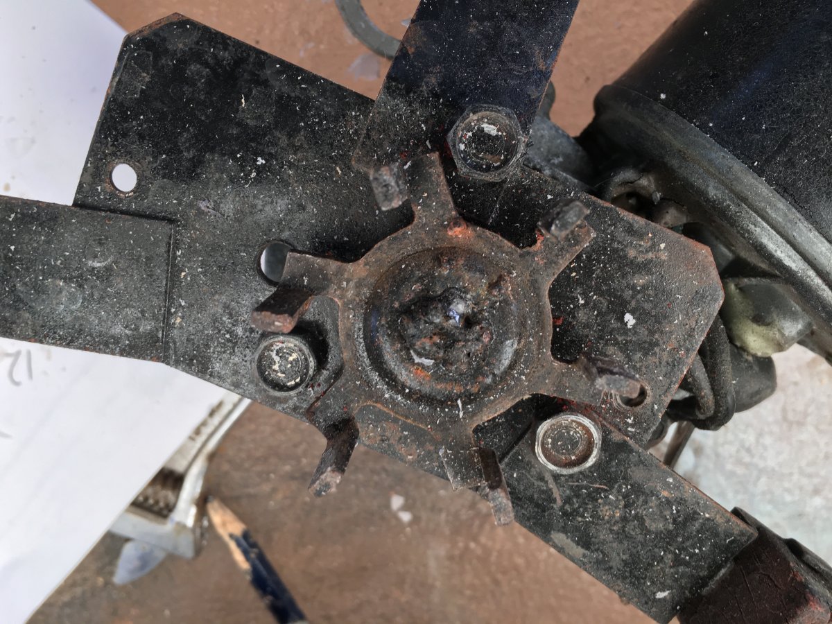

    IMG_1337.JPG IMG_1338.JPG drove the Vedette to work the other night, 10% chance of rain the forecast said. It started raining at midnight and was still drizzling at 0600 when I knocked off.
    Off I went on the 50 km drive home, big clunk under the dash and wipers stopped working right in morning traffic. Got home and headlights would not turn off. :(
    On investigation it was simple, linkage fell off the back of the wiper motor and just needed a circlip.
    That's where it started........
    Took dash out to access rear of wiper motor and replaced clip (I have my doubts if there was one there at all). Found a broken wire to the dimmer switch that was obviously hit by the linkage but couldn't find where it was from. Spent the better part of the day trying to trace the abortion of wiring under the dash and ended up completely rewiring the headlights. Problem solved?
    Went to put the dash back in and found a hot piece of wiring by chance. Traced it and discovered the thermo fan had been wired direct to power and a switch without a fuse or relay. Spent another half day rewiring that correctly.......
    Thought (what was I thinking ?) that I would take off the the wiper motor and have a look at it as it had a bit of slop in the shaft and I was curious as to how it had been adapted to the car. Found this setup.

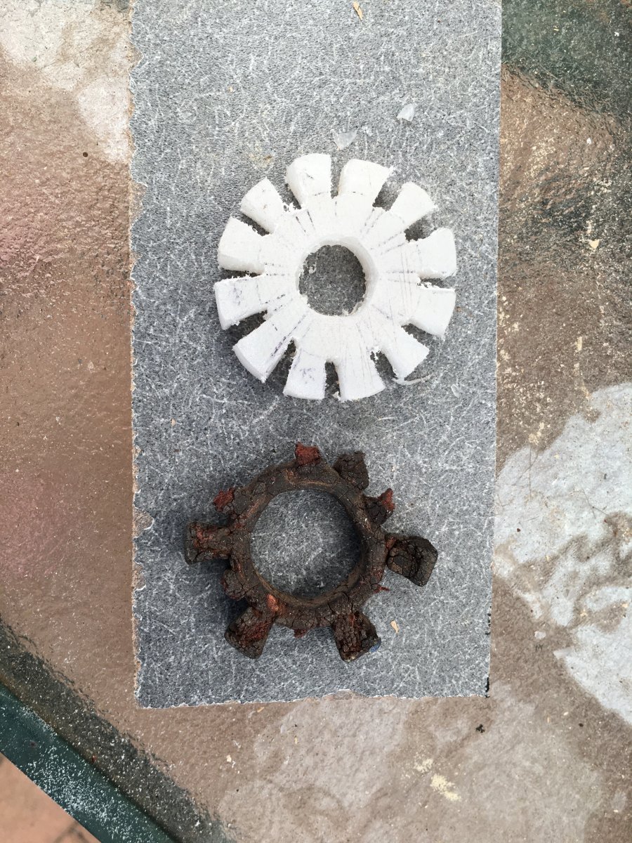

    IMG_1334.JPG The rubber gear on the bottom was the cause of the slop, I am amazed it worked at all.

    Looked around for something similar size to make one out of and thought nylon would be better than rubber so the wife lost a cutting board :eek: :D That we will never speak of again.
