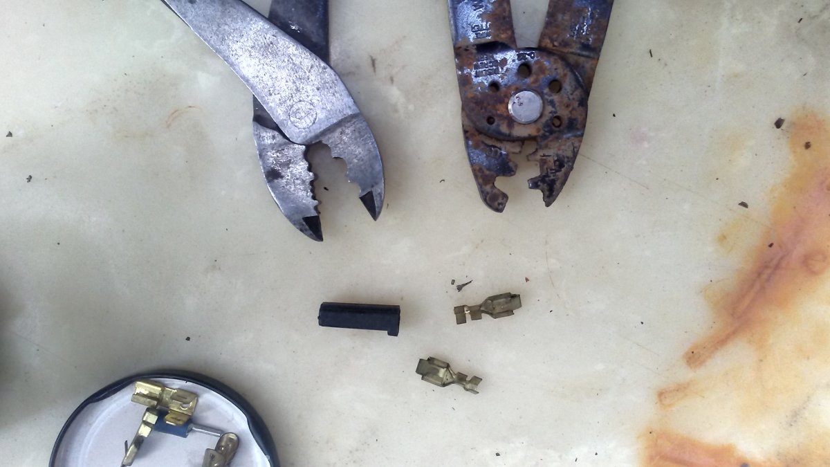

    Are any of these crimper positions the correct one for these terminals? 0326201312_HDR.jpg

  2. bill gruendeman
    Joined: Jun 18, 2019
    Posts: 940
    bill gruendeman
    I have the one on the left and like it. Not sure if it’s the right one for the job . The nib ( male)goes to the back side and flaps on the terminal go to the rounded side ( female). The one on the right is for plug wires I think.

  3. blowby
    Joined: Dec 27, 2012
    Posts: 8,663
    blowby
    from Nicasio Ca
    Thanks Bill, yeah that's my go to for the usual crimps but when I do these it looks like a 5 year old did it.
  4. oldolds
    Joined: Oct 18, 2010
    Posts: 3,595
    oldolds
    I was told the indentation is supposed to be on the opposite side of the split in the terminal. I have both kind as well. Usually go for the left side pair. I seldom use ends like you show. Usually use the kind that are round already.

  5. winduptoy
    Joined: Feb 19, 2013
    Posts: 3,976
    winduptoy
    The connectors you show in your photo, one set of tabs is for the conductor and the other set is for the insulation. I don't know if it is correct but using that type of connector, I always bend the ears over on to the stripped conductor using needle nosed pliers, then crimp...

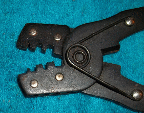

    Paul,
    For Packard terminals the crimp needs to double fold inwards.
    You need a crimper with the peak in the centre of one side so they fold inwards.

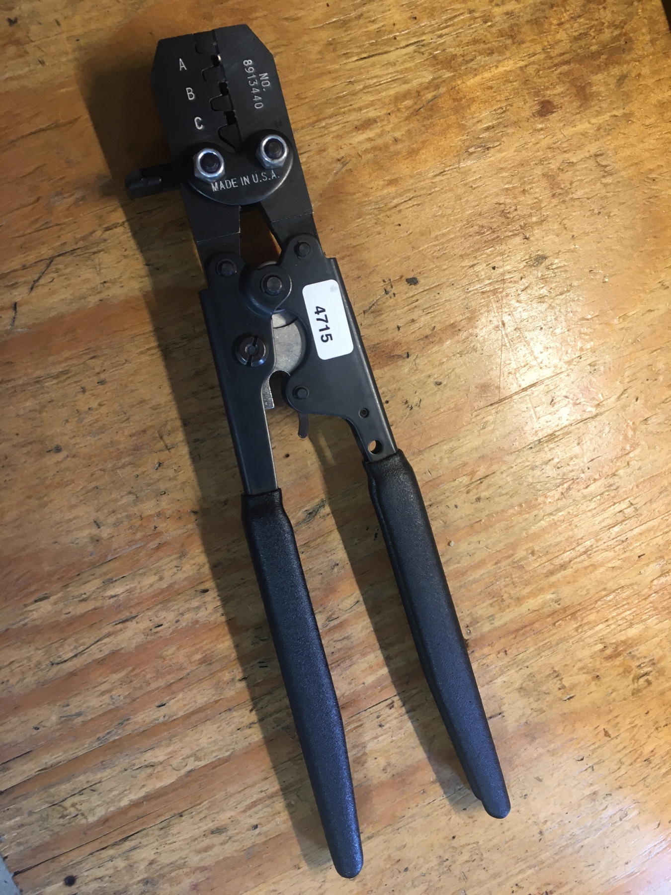

    Just bought the correct crimper from O'Reilly's for $32.00. The part number is SG 18600.
    When I worked for Freightliner we had all the crimping tools in kits for Packard 56 terminals (that's what you were showing) and other terminals used in the truck wiring. The Packard tools are still available, but they are around $100.00. I just tried the O'Reilly tool and it works perfect.

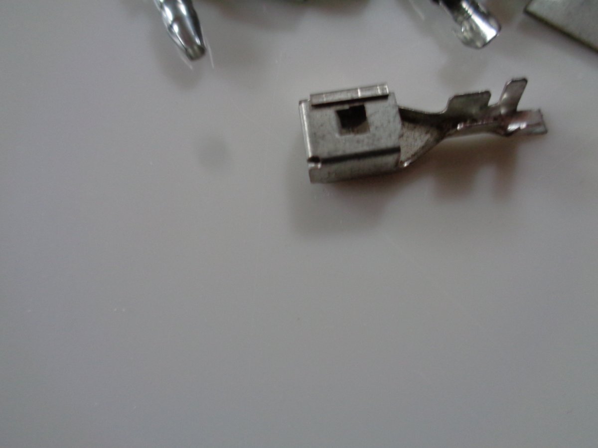

  16. You can order the Packard terminals form mouser electronics. The spelling might not be correct. You can use them no solder required. In the factory we could do a wire repair and never have an issue. They are expensive. The Packard pliers will crimp the insulated terminals nicely. I take the plastic off with the rotating wire brush.

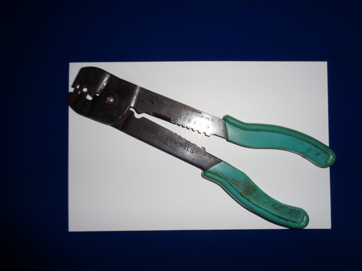

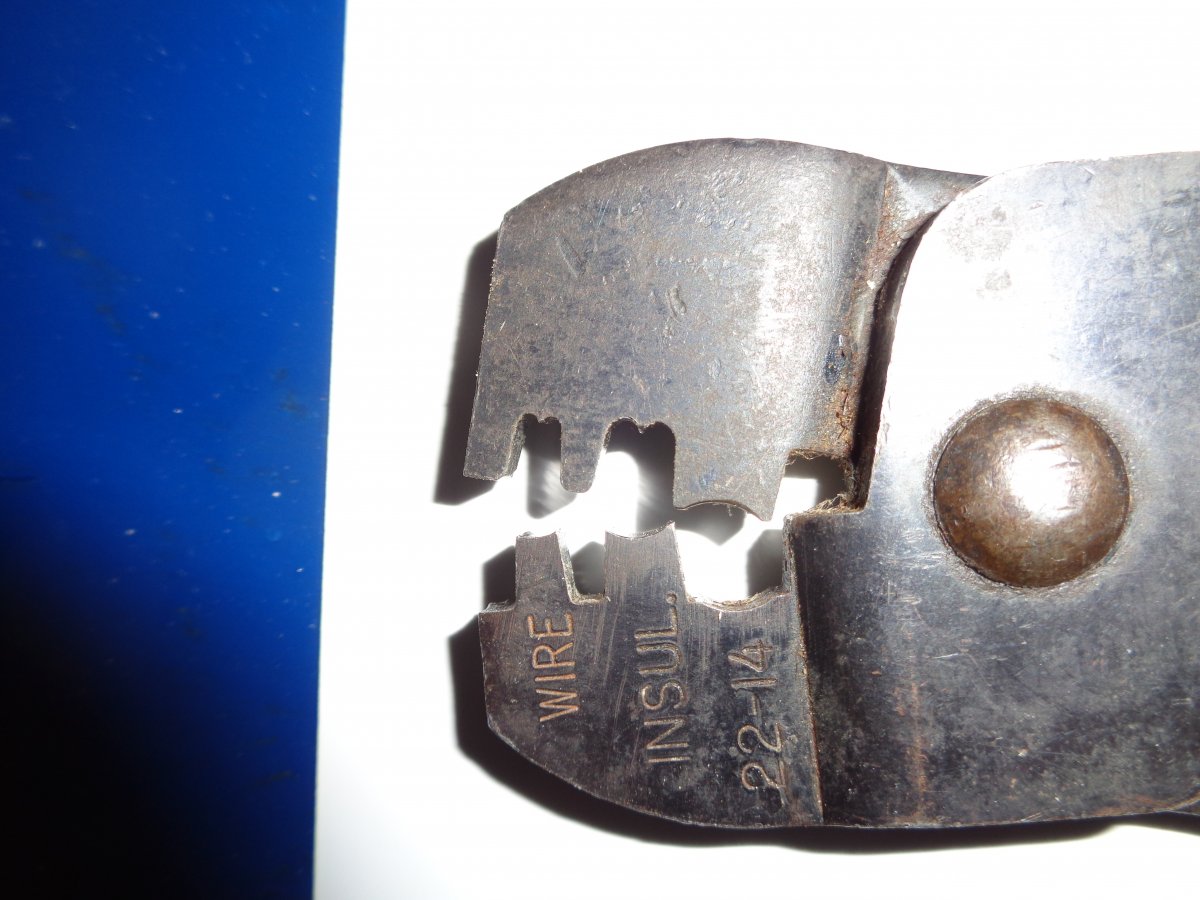

    I do have a few other crimpers but my "go to" set I've had for 50 years, made by Essex Terminals who made wire harnesses for the big 3. We never soldered wire terminals. DSC05870.JPG DSC05874.JPG DSC05880.JPG The wire is stripped to length allowing it to be crimped separately than the insulation.
    There sometimes seems to be a little confusion about "insulated". When I refer to insulation, I'm talking about the wire covering, not the plastic ends on cheap aftermarket terminals, which I have no use for.

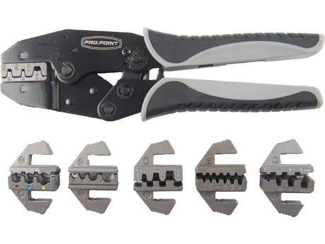

    My son recently showed me a very nice pair of crimpers he uses for work. He is a machine repair man. They had a whole lot more capability/versatility than anything I ever used. I'll ask him for some more details but I know they had to cost more than I would be willing to spend.
    Using a simple set like in my pic, there are quite a few different operations that can be done, not readily apparent for prepping or custom/odd terminals.
