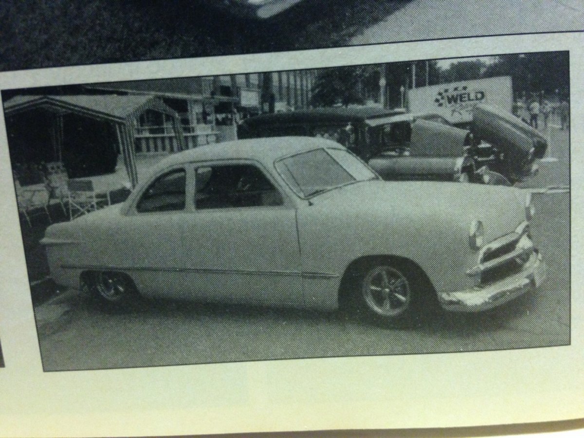

  10. I also hated the way a shubox handles so I made a few changes in my 49 coupe. I used a super low mileage steering box from a 51 parts car...Lowered it by flipping the spindle supports and heated and bent the steering arms down to clear everything. This effectively shortened them, making the steering a lot faster...no more doing 4 turns of the wheel to get around a corner. I replaced the puny stabilizer bar with one from a 70s Trans Am.....1.25" diameter. I used Olds coils, cut down a loop or 2. No more leaning in the corners. I rebuilt the front brakes and used the Maverick rear brakes..felt and worked great using the original 49 master cylinder and pedals. I also dumped the giant ships wheel for a smaller 14" wheel. This alone makes a big difference. And lastly, I could not keep the car in my lane with the old, hard Goodyear Double eagle bias plys. The car was actually dangerous to drive! Switched to a set of radial tires [GASP!] and the car drove similar to my old '64 corvette. It became a joy to drive. Rockbox@demoines1993.jpg
