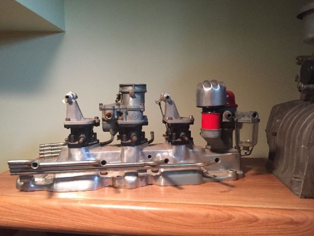

  3. I sold this one last winter, worked great on the street, and good mileage. Offy intake with rochester 2 jets WIN_20160212_114535.JPG

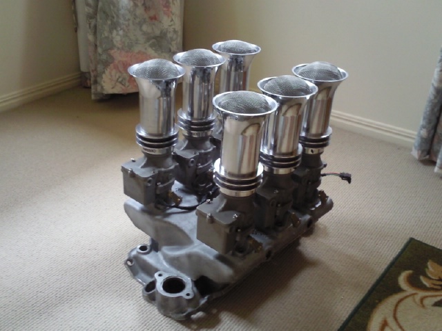

    Sold the former (C67) to build the later (X1). Still a work in progress :mad::( 6X2......jpg 6x2 with stack.jpg

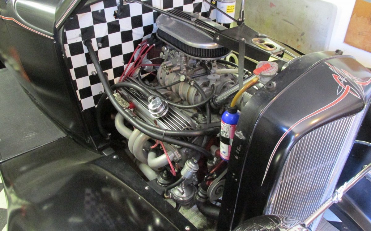

    [​IMG] Just got my setup up and running on my 1927 Chrysler 2 jets on offy intake

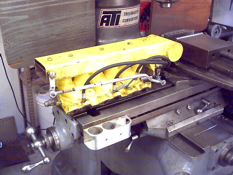

    Built my hotrod as a teen for highschool in 1959,over the years rebuilt it many times yet never really changed much,between doing other hotrods for others an myself. This is my homemade 4x2 Y-block set-up, tubing used was a old driveshaft cut up. Biggist thing not seen,is there are deviders inside the standtubes up a little into the log vs most old home designs had open between ports. As did most after market cast alum types. 001 (4).JPG

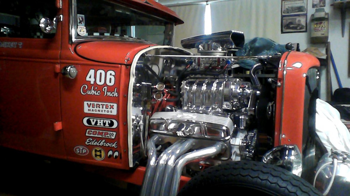

  14. I've always liked a belt driven, forced induction system! ;)
    I've got almost 200,000 miles on this one in a couple of different vehicles.
    Gobs of torque and 18-20 mpg with a 750 Edelbrock in this car.

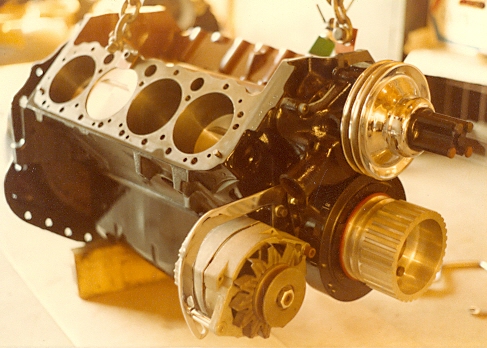

    My 350, 8.6 compression, 15% under 6-71 on a Weiand competition manifold. scan0017.jpg scan0020.jpg
    Also, you can see why I run an electric fan. Channeled coupe with a 5" short radiator, low engine for leg room and the 2" blower drive make it necessary.

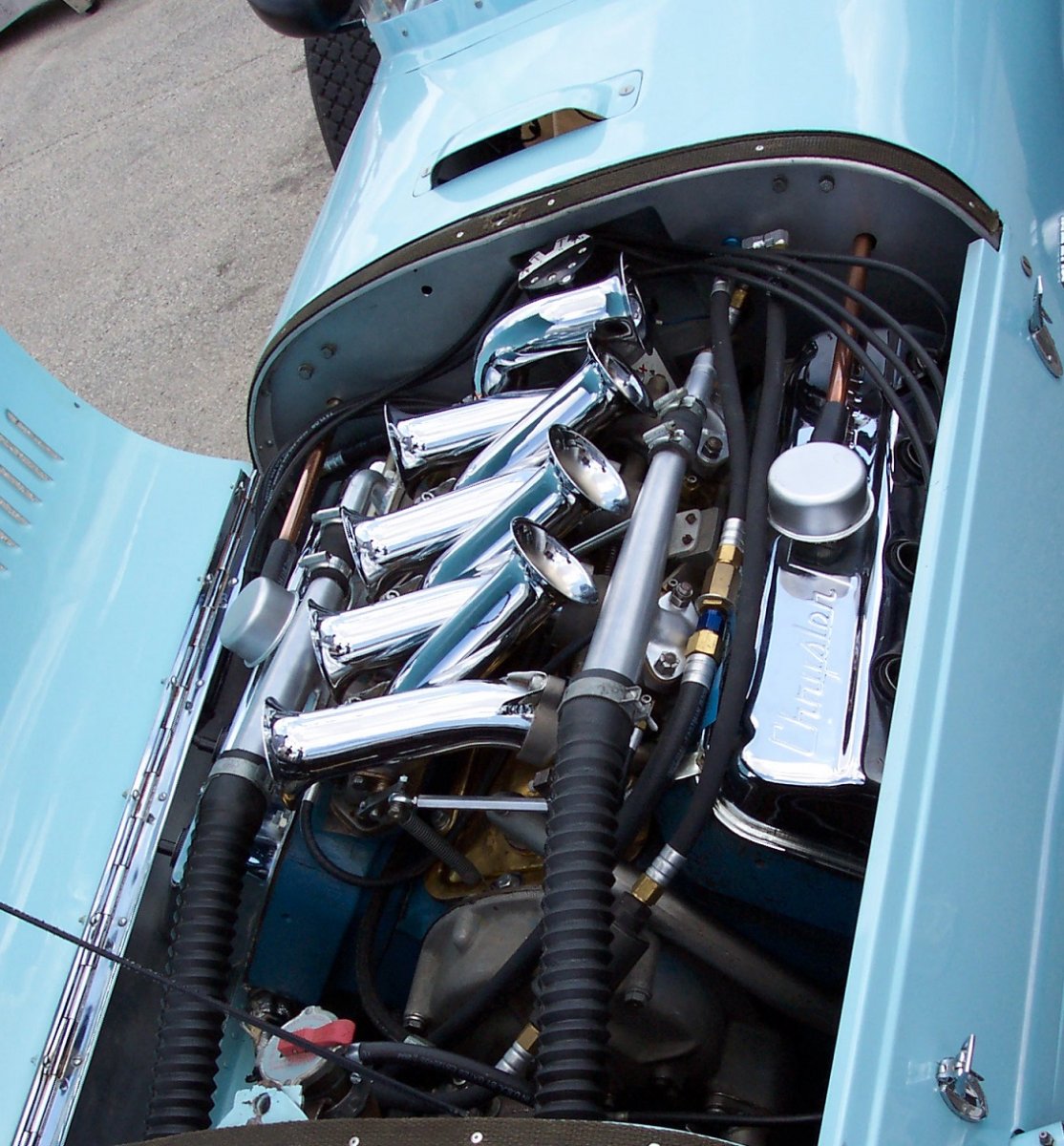

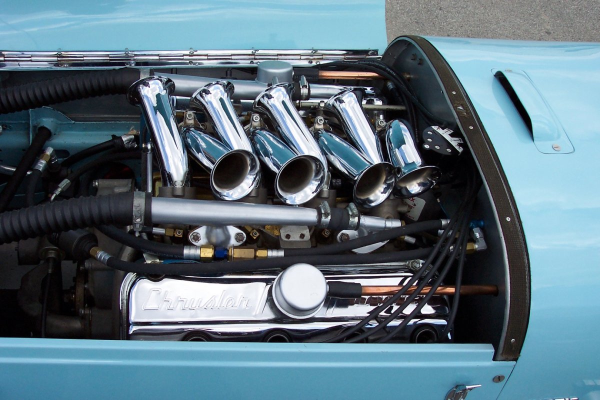

    I've posted these before, but they fit here as well. I took these of the Hemi-Kurtis Indy roadster at the '06 Miller Meet.

    I really respect what you have done here. It looks fantastic for something a young guy whipped up from a driveshaft! I am so glad that you are still keeping it alive. My Valiant got my 25 year old brain to build it. And now, a tad over 20 years later, I STILL am driving it. I suppose I can post a pick. It is nothing exciting, but I did have to do some fabrication on it....

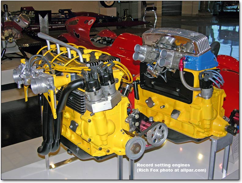

    Some I did. A baby bug catcher for a non HAMB V6 in a Bonneville streamliner and some '32 Plymouth injectors. Home made is HAMBer. engines.jpg .
  23. Very impressive Rich. Outstanding work.

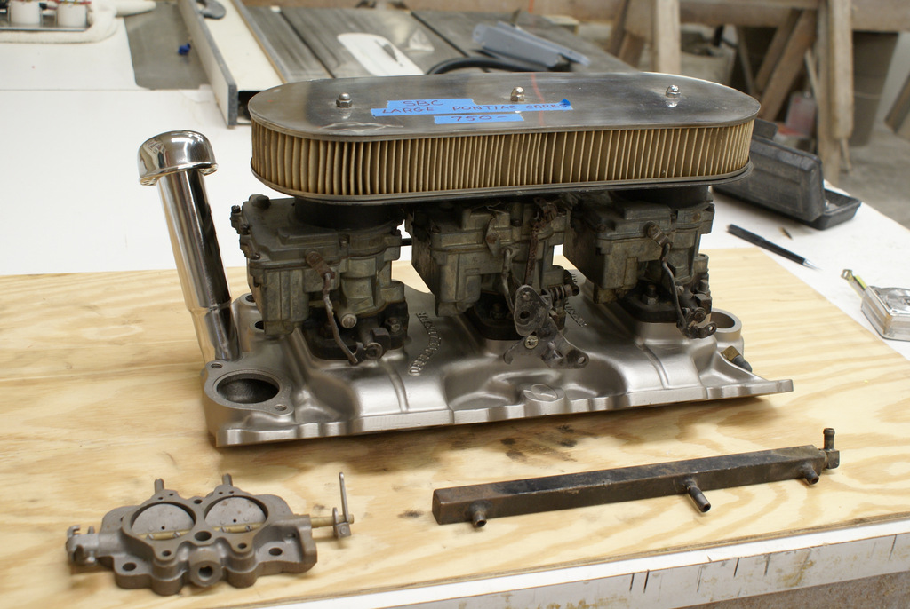

    DSC00782-001.JPG SBC Offy cast for large Rochester (Pontiac) carbs.
