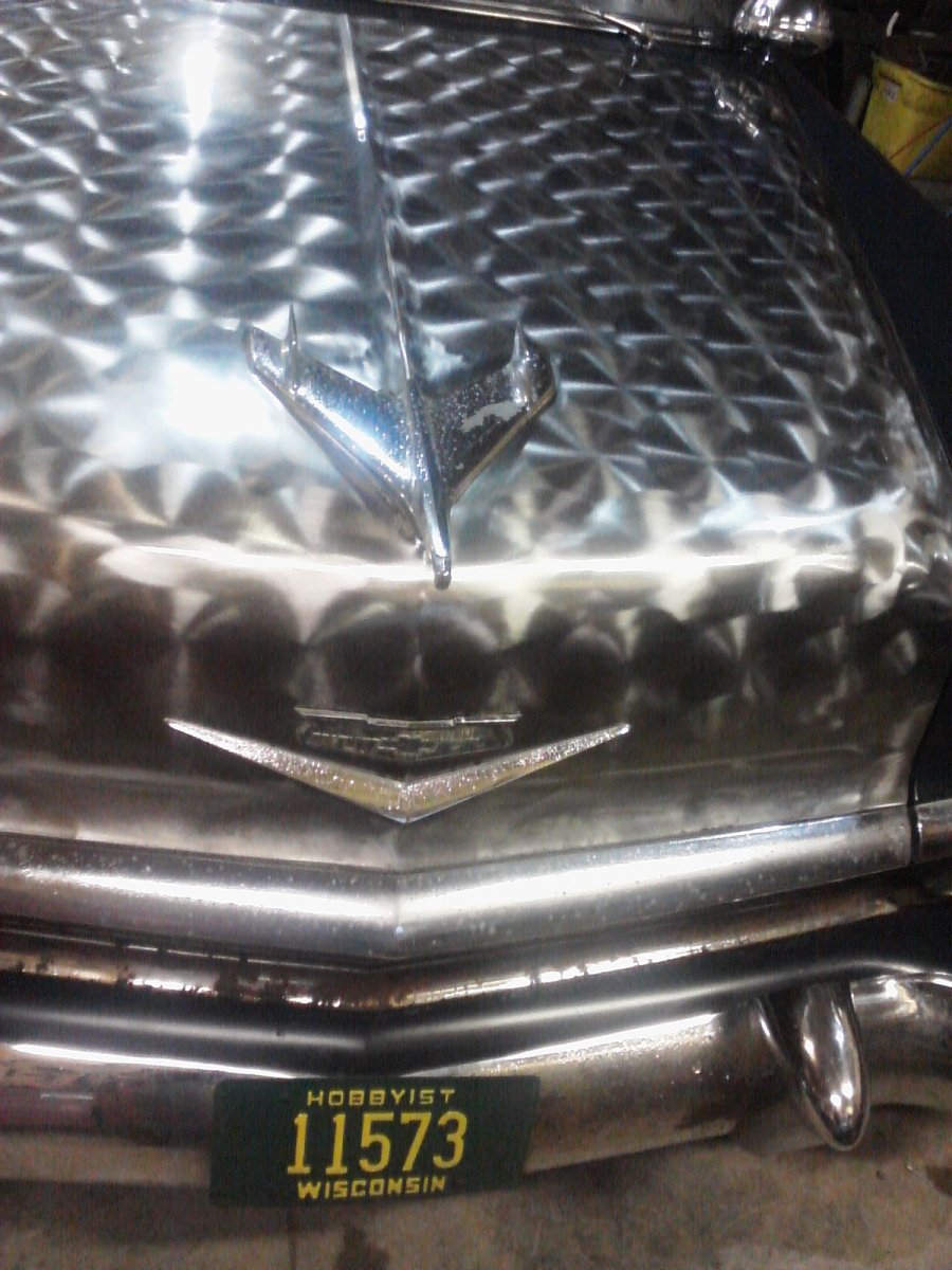

    Some I did on a 56. The hood and deck lid were perfect not a dent or ding.
    Balljoint, rod1, Budget36 and 12 others like this.

    Bonzo...you must have had guide lines!
