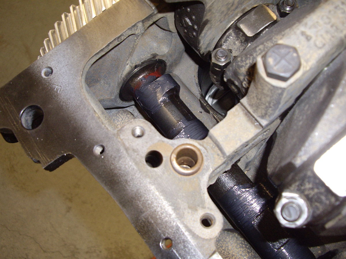

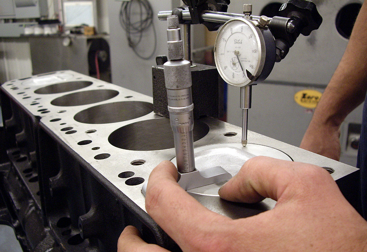

    Talked to the boys, they decked the block .050 It's partially back together, new cam is in, pistons are in. Gonna be ready again for this weekend. Building a Zoomie header in the next day or so.

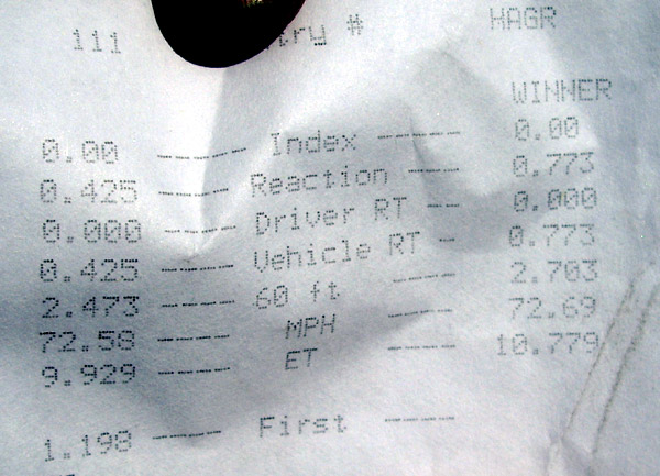

    I finally got around to finding the pictures I took of the time slips... funny how what we thought it ran wasn't exactly the result. I coulda sworn there was a 9.2 in there. Slips tell the story though. 2nd slip, he was trying to burn the tires as far as possible. :)
    1) [email protected]
    2) [email protected]
    3) [email protected]

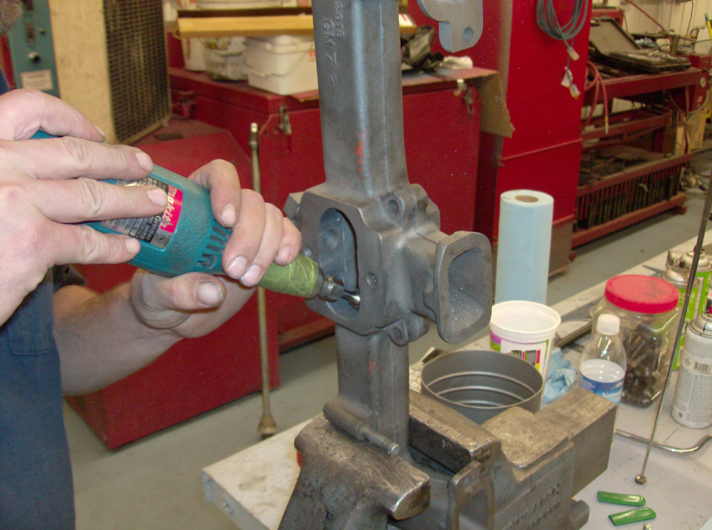

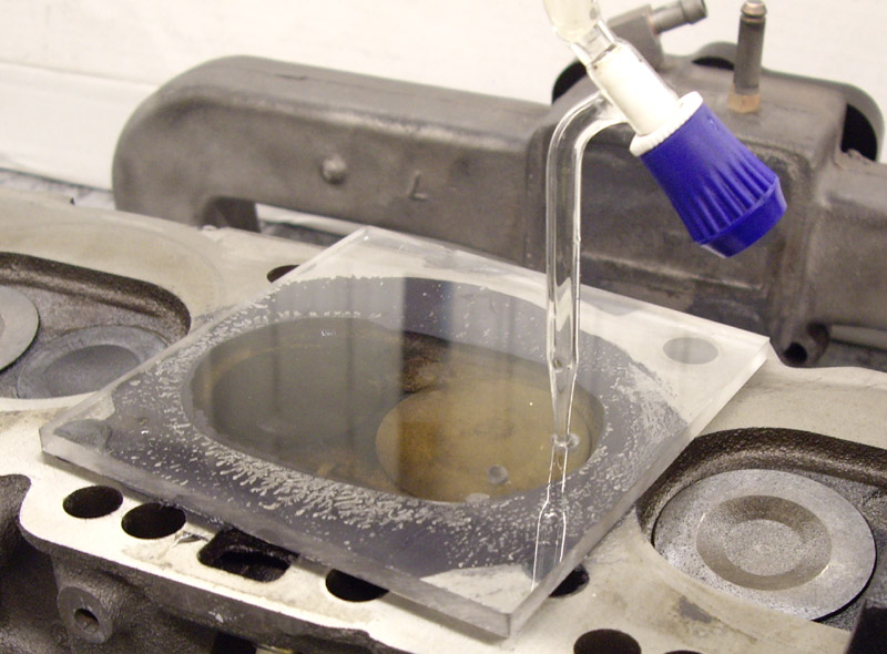

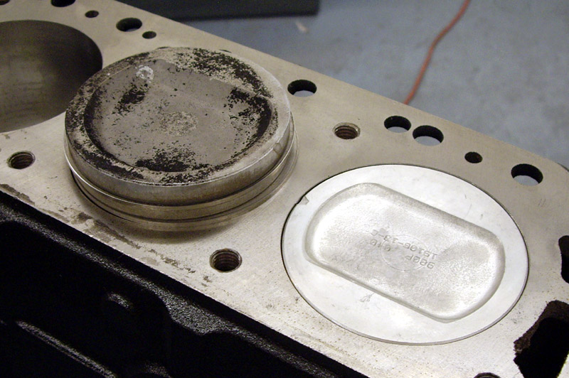

    I was down at the machine shop, and the boys were furiously putting the engine back together.
    as it sits now,
    Bore: 3.915
    Stroke: 4.12
    298 cubic inches
    Chamber: 65 cc's
    Piston dish: 14 cc's
    With all the decking, shaving, etc. with a .040" head gasket,
    Compression: 10.368:1

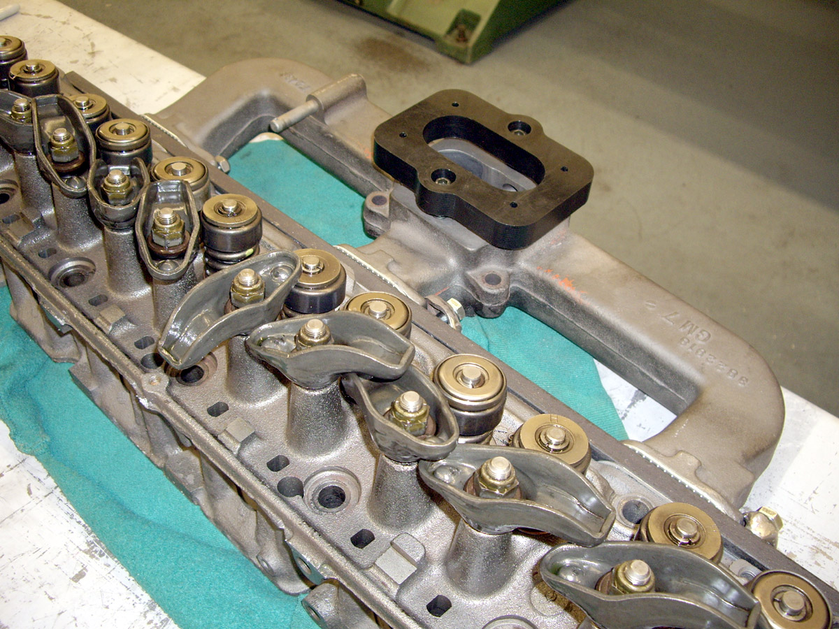

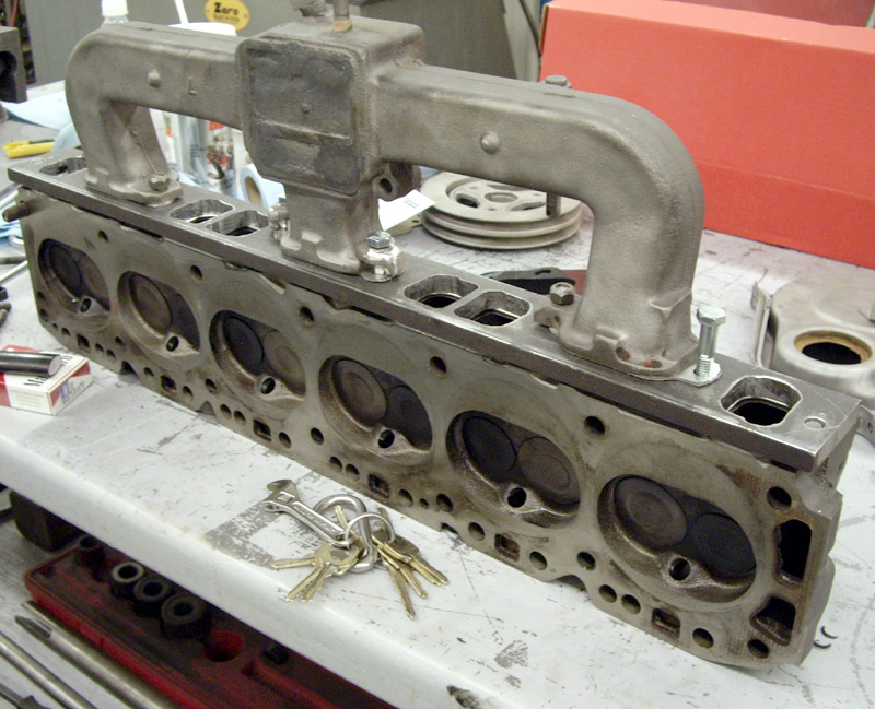

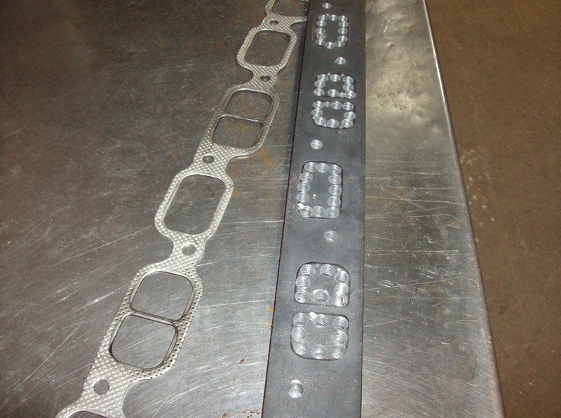

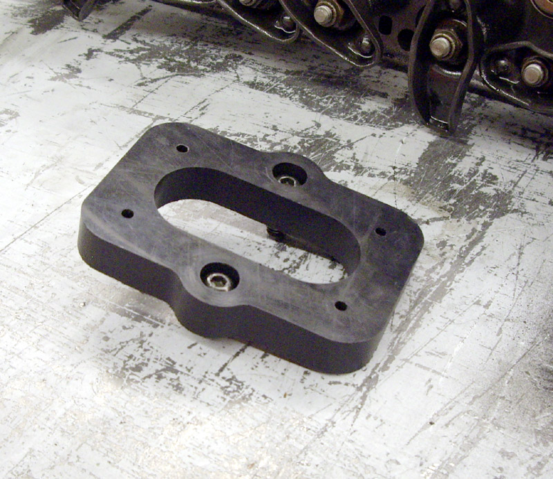

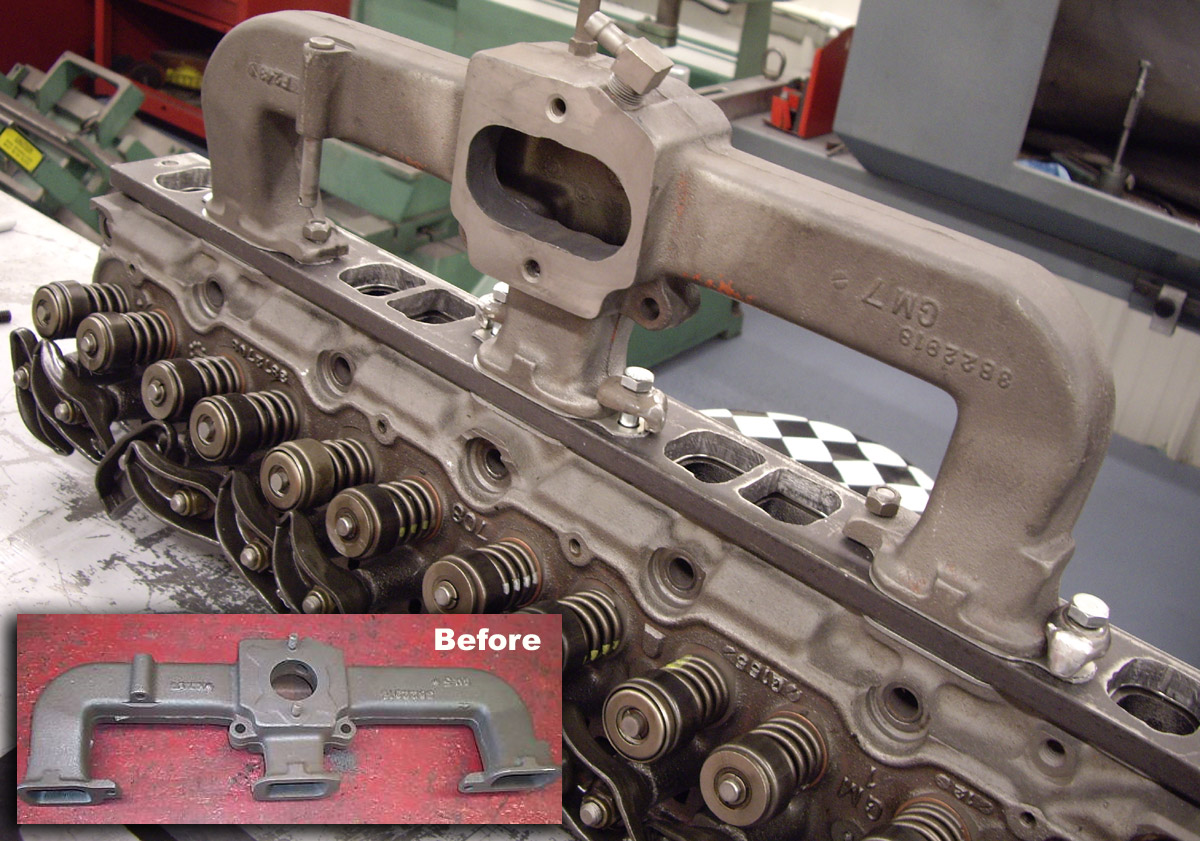

    I got some pics of the 2bbl adaptor setup and the flange we're gonna try and use to make a header. And a before and after comparison of the piston dish.
    Check out the base circle on the cam... ;)

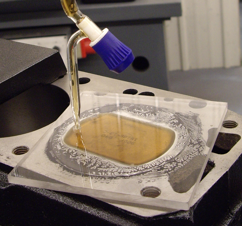

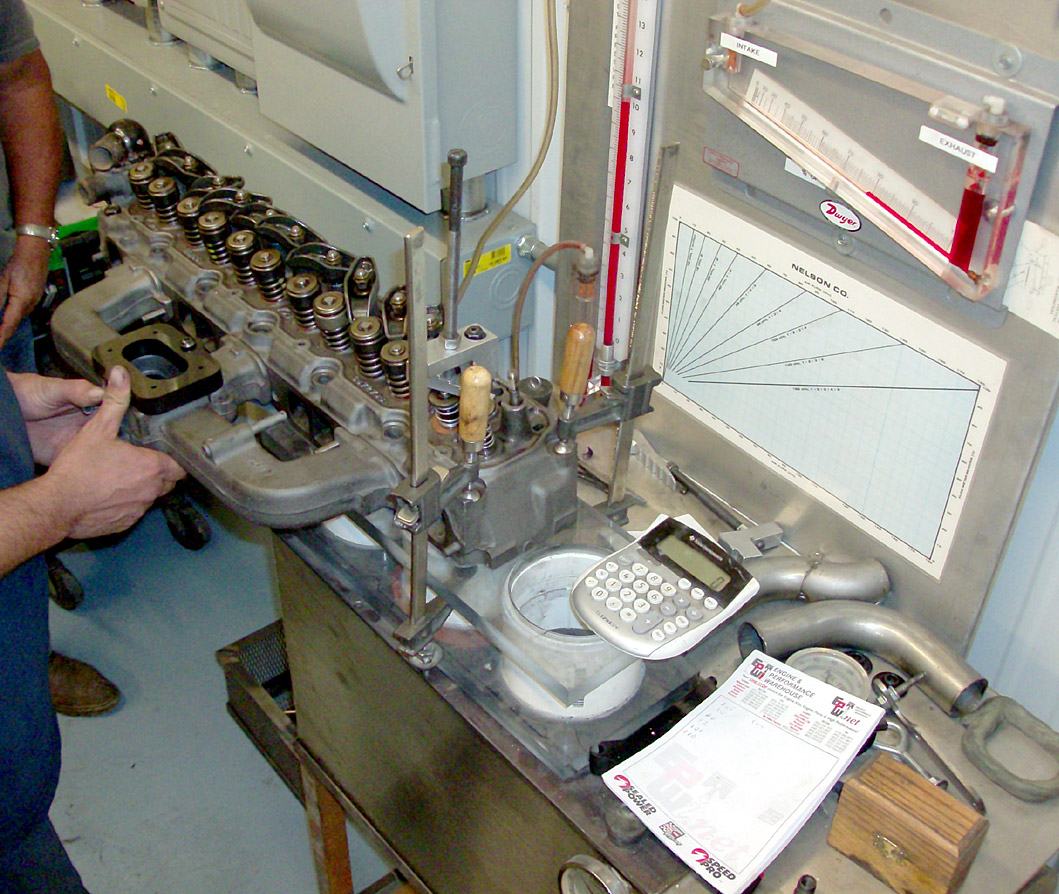

    Just came back from the shop. They flowed the head. It went 183cfm@28" with the intake it went 154cfm. They did some quick work and removed a few areas that they thought were causing some turbulence in the intake and got it to flow 159cfm. All things put together, they are estimating the horsepower at 210 without hitting the dyno with it. Head could use some port work, but we are running out of time. Engine is still apart it's Wednesday night, and we leave Friday night for the track... :eek:
    Some more pics.

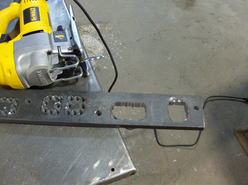

    Here's how the flange started out before we cleaned it up with the mill.

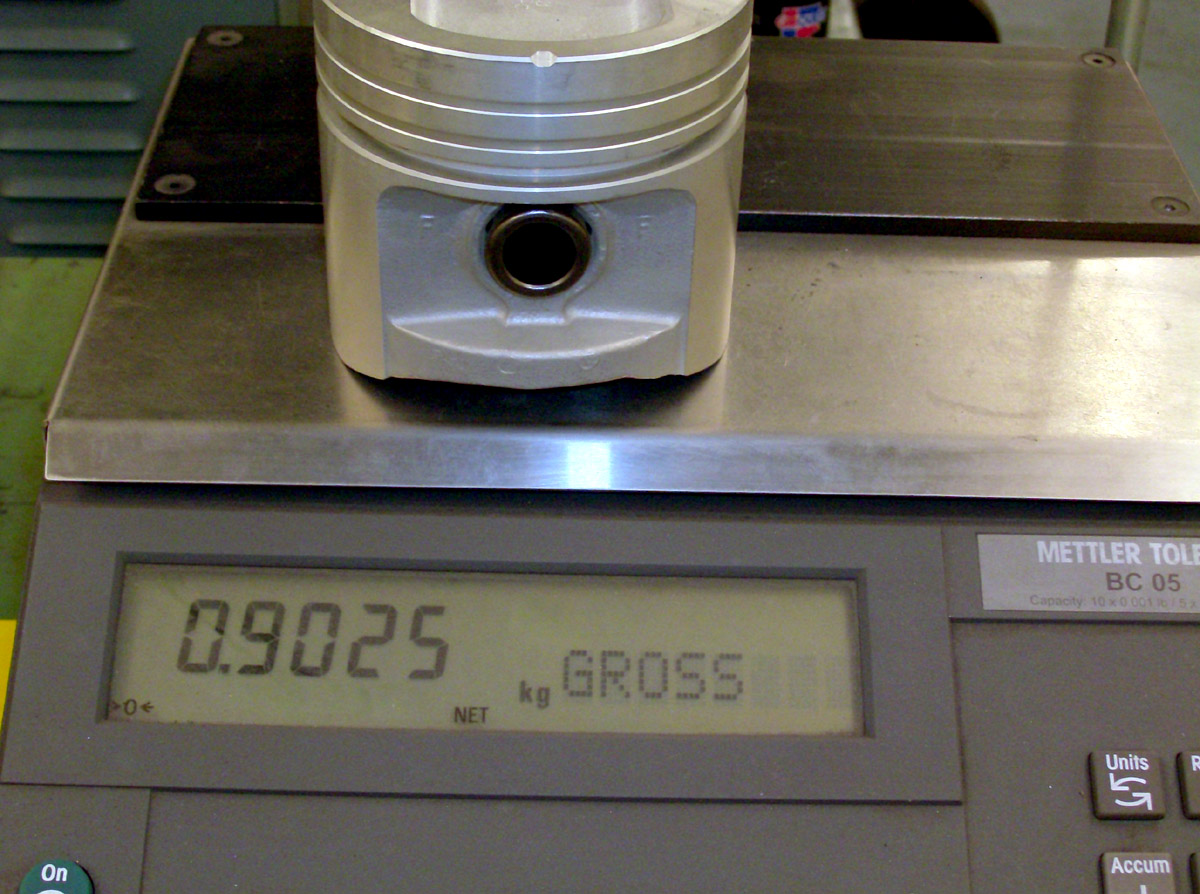

    I'm diggin' those new pistons. I haven't seen a stocker piston with that dish, who made 'em?
    That ol' girl will surpise you this weekend. Very nice looking work - many compliments to your engine shop crew. Inline fever has set in, its highly enjoyable to step off the beaten path occasionally.

    Hi guys, I'm the machinist. :)
    Here are the numbers we got off the 292 cylinder head.
    Stock:
    .1 lift = 55cfm
    .2 lift = 105cfm
    .3 lift = 142cfm
    .4 lift = 160cfm
    .5 lift = 164cfm
    Mild port: 1.94 intake/ 1.60 exhaust valves:
    .1 lift = 65cfm
    .2 lift = 125cfm
    .3 lift = 175cfm
    .4 lift = 200cfm
    .5 lift = 208cfm
    With the intake after the port job, the long runner ran 194cfm @ .5 lift.
    Do to time restraints we didnt test the exhaust but picked up good gains.
    Conservative numbers 240hp @ 5000rpm

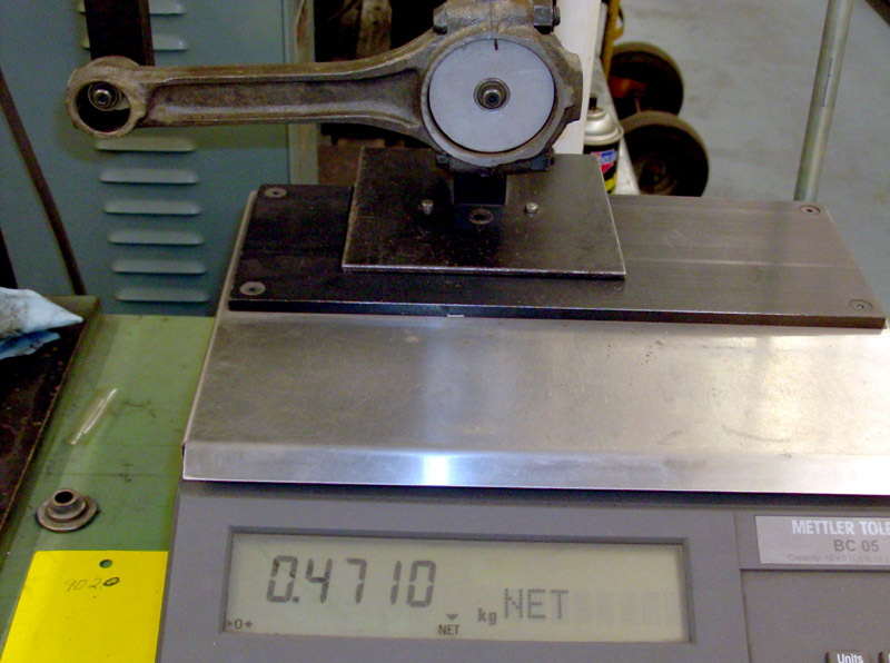

    the pistons are Fed. Mog. 980p they are heavy!!!

    980 grams? Yeah, that's heavy. So much for that, love the top - not so crazy about the weight. Stock replacement Hudsons weigh 740 grams (and I thought that was heavy-ish).

    Thats a wierd coincidence the pistons are part # 980P but they do wiegh about 980 grams.. imagine that con rod jerking a 2 pound piston @ 5000 rpm's (that slug is travelling at about 3500 feet per minute!!) I'm a little "dubious" about the life of this essentially stock rotating ass.
    Anyone have any Ideas on a longer rod shorter piston combo? this is one reason we are goofing around with the short deck 250 with 4.120 292 crank, 6" rod and one really short piston, however 1.45 crank to rod ratio is not a good plan!
    We didn't have time to cut the bolt bosses out & put in the humps so I narrowed them up a bit and just consentrated on the wall at the end of the port to get the air in. getting the shape for the area between the valves right was one frustrating piece of work!!!

    A set of Ross custom pistons weigh significantly less. They also cost about $150 each. I can't remember how much they weigh, I'm thinking in the 500g range.

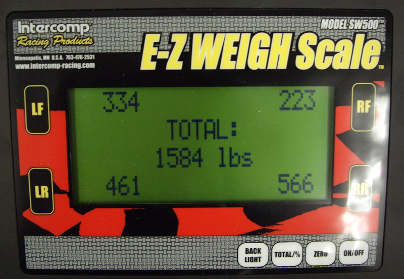

    Car is back together and we scaled it. It's lighter than I thought. This is without driver. This is good news. figure 1800 pounds with driver.

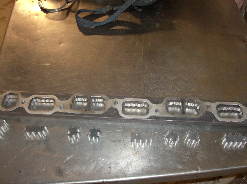

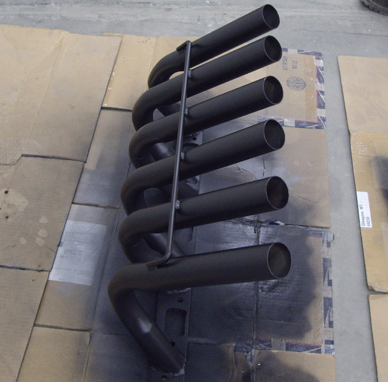

    Got the Zoomie built. I wish we had started with better bends. We cut up a set of crap'd out old big block headers and played with those for about an hour before we realized how little of what we needed was in the pile. So we whipped on down to the exhaust shop and whipped up some bends. the exhaust machine put some crazy kinks in it. But it's what we had, and we were down to the last build night. We'll get proper bends next time. Still though, pretty serviceable and adds to the appeal of the car. I'm glad we painted it black.

    More of the Zoomie header build.
