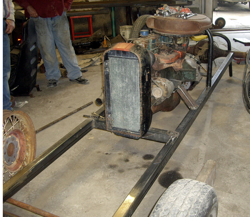

    Here are a few build pics.
    The first section was fooling around with different ideas.

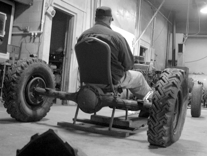

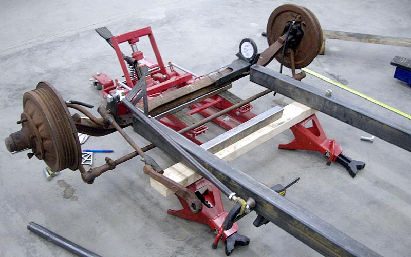

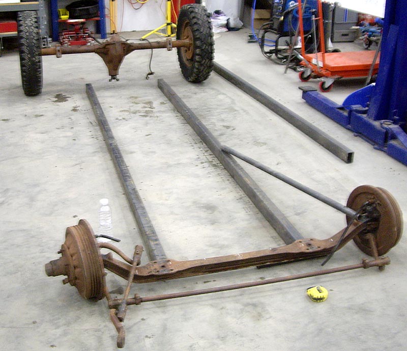

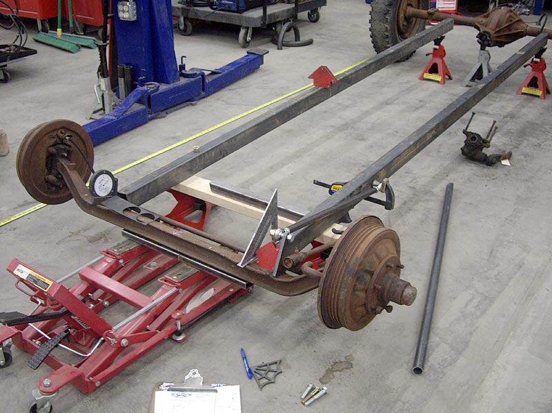

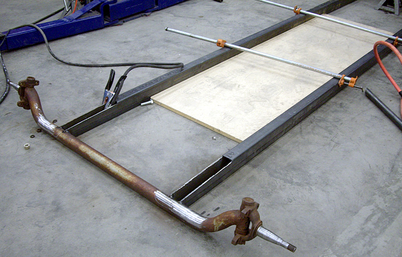

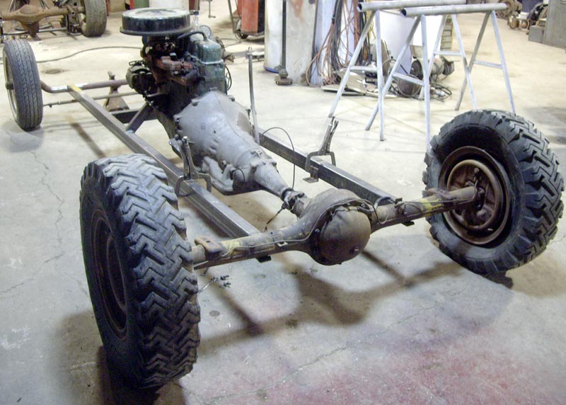

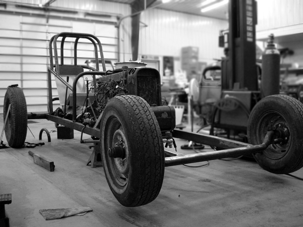

    Frame and axle pics.

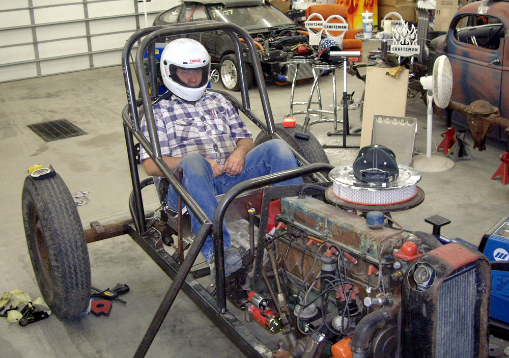

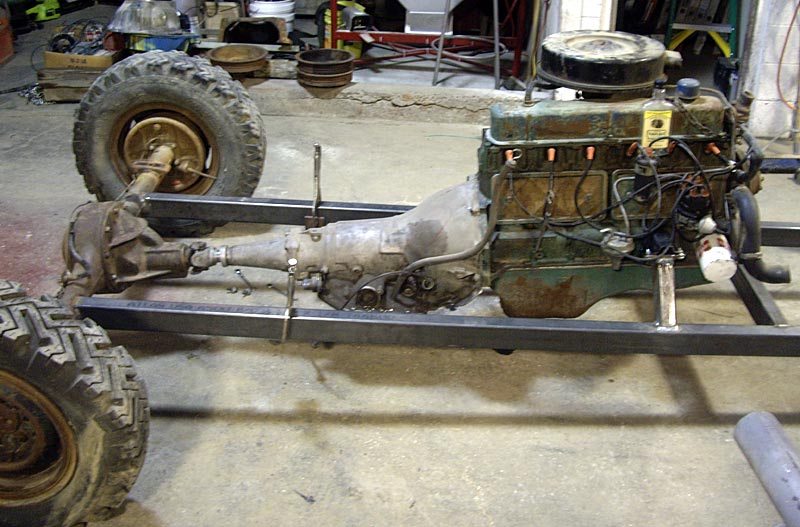

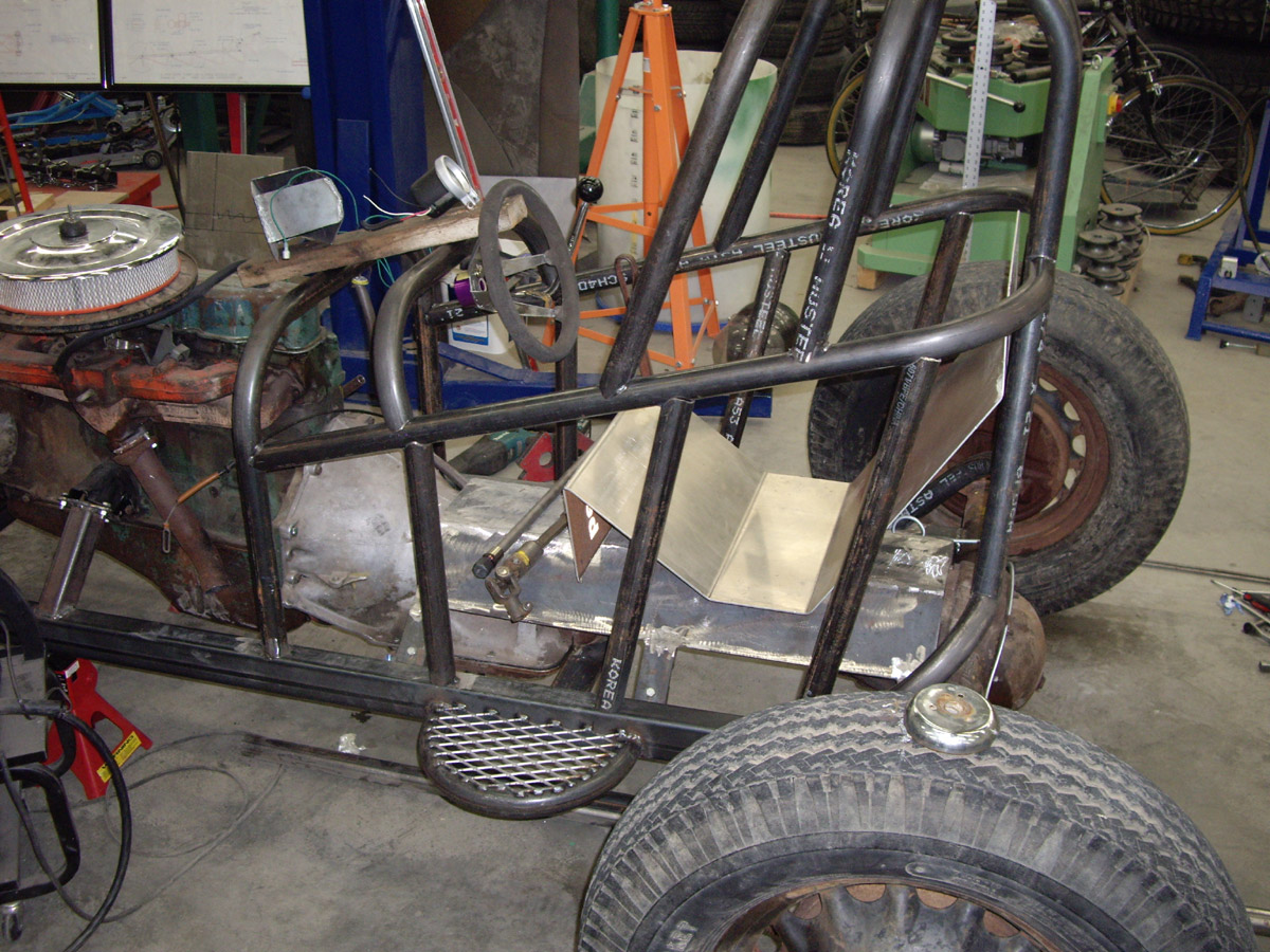

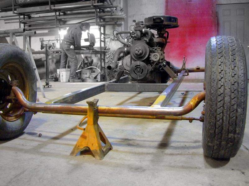

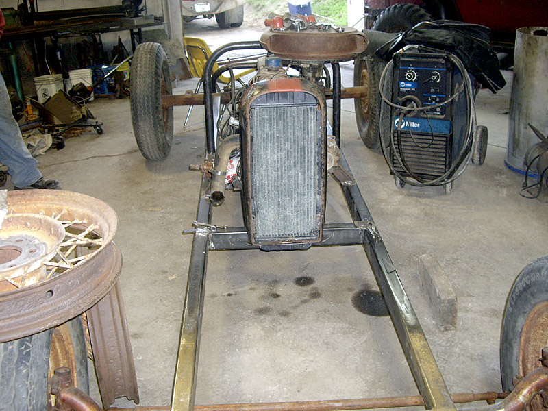

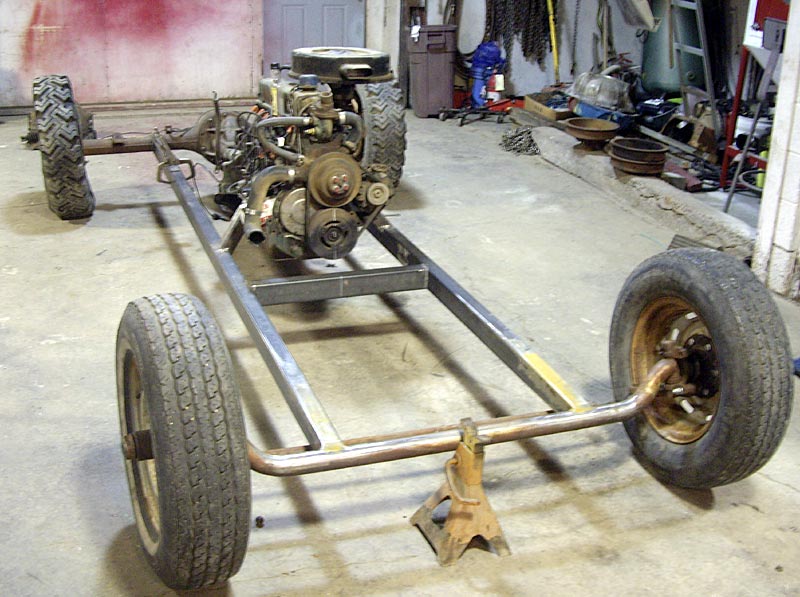

    Getting the engine and transmission mounted and in.

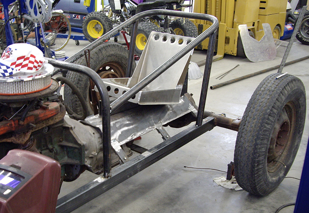

    radiator and gas tank. We made the radiator shroud. Tank is off what we think is an old generator. No Moon tank for this group, and I like it!!!
    Car has a radiator and an alternator. We want to be able to hot lap the car. No battery chargers, no cooling down in between passes... Just FLOG IT!!! :D

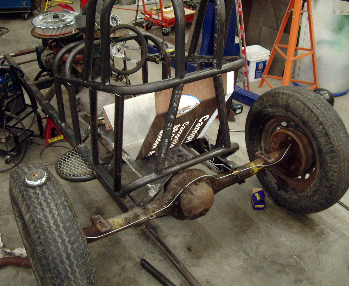

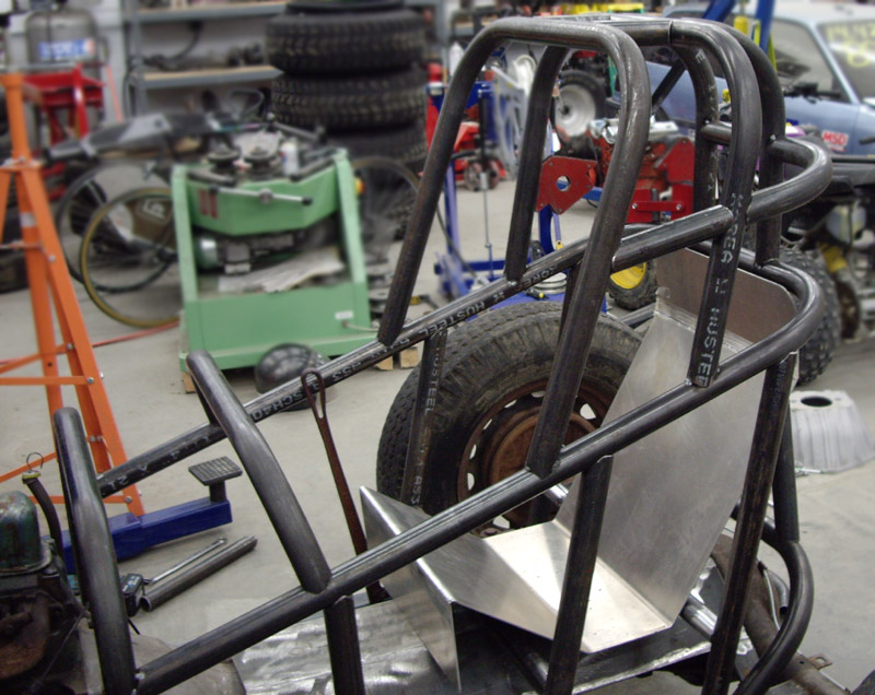

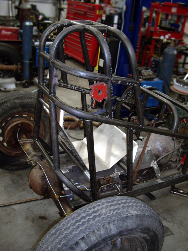

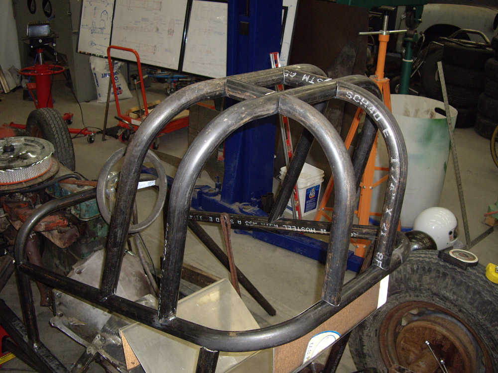

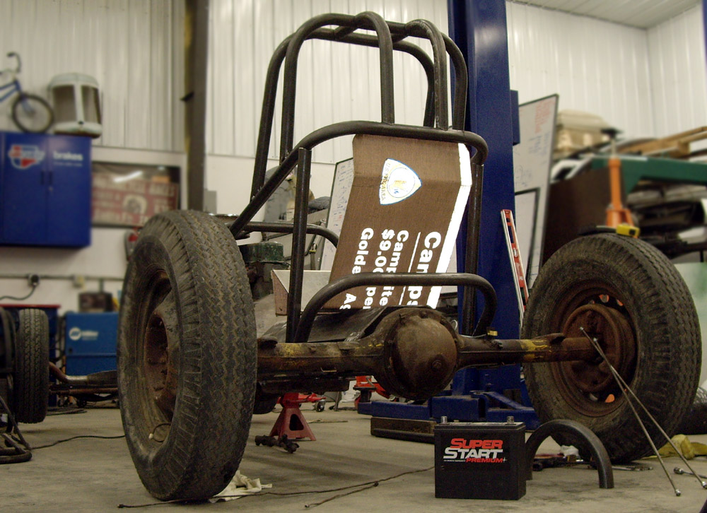

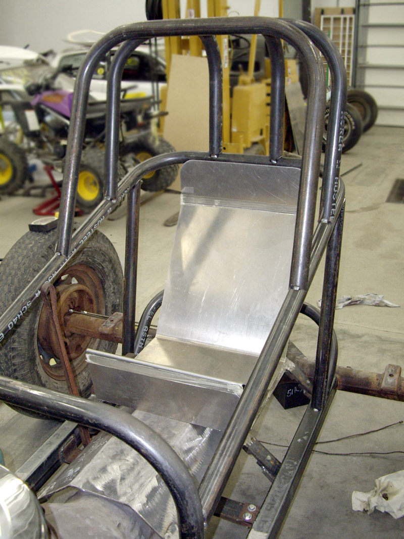

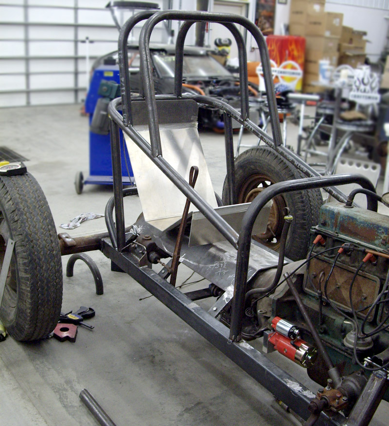

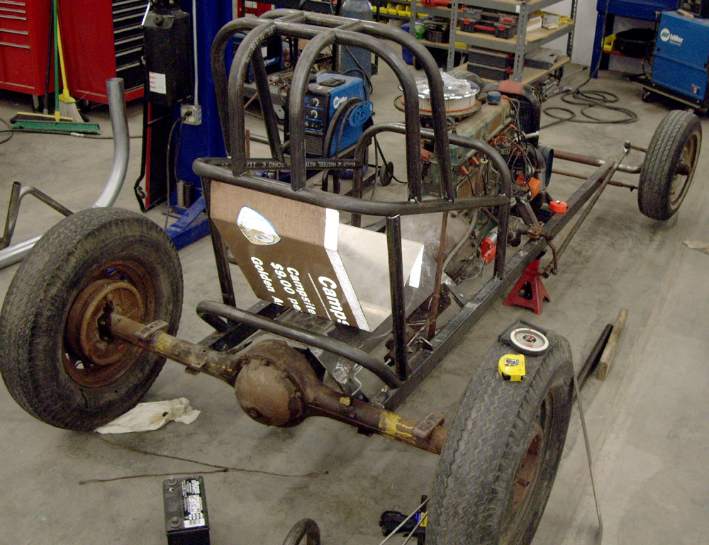

    Starting on the shoulder hoop. Master cylinder and Brake lever in, scatter shield on. the seat in these pics is just to get the angles and "feel" right, it's not staying.
    Cage is "roughly" patterned around the 6.0 legal cage from Mark Williams. When it's done, I want to see if it will cert. Just a curiosity thing, locally. We need to be able to pass tech for the IHRA and NHRA. Some concessions had to be made, but I feel the spirit is there. and it will look more vintage than anything else in attendance locally.

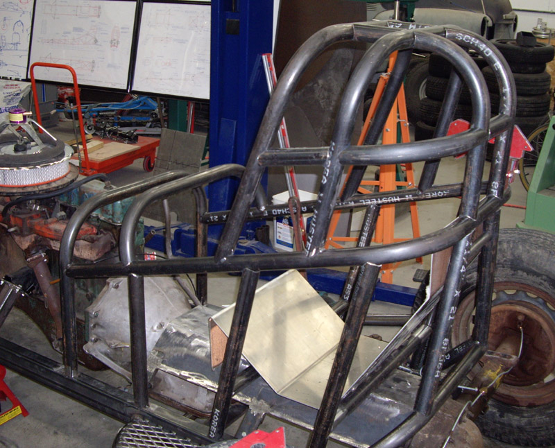

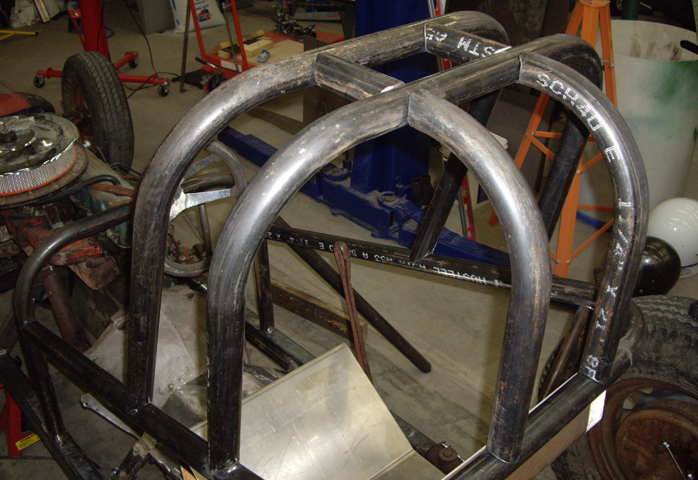

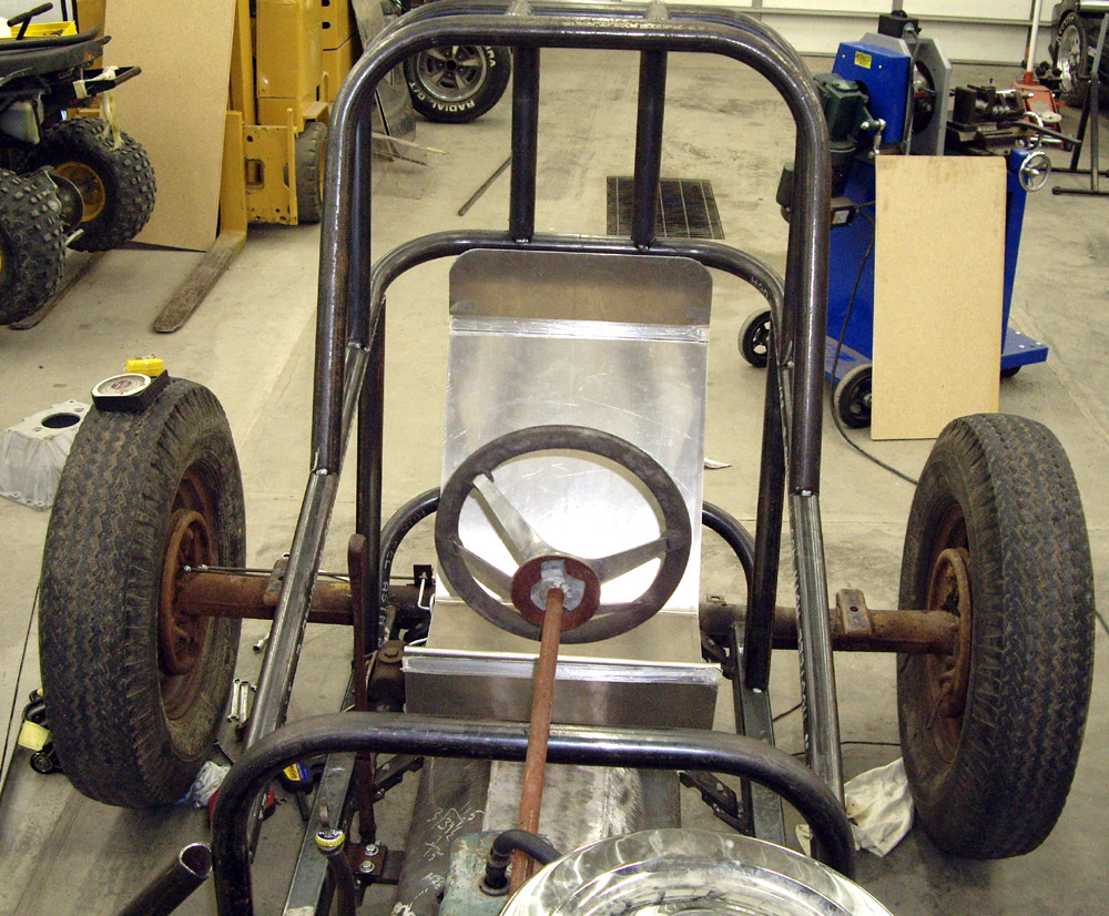

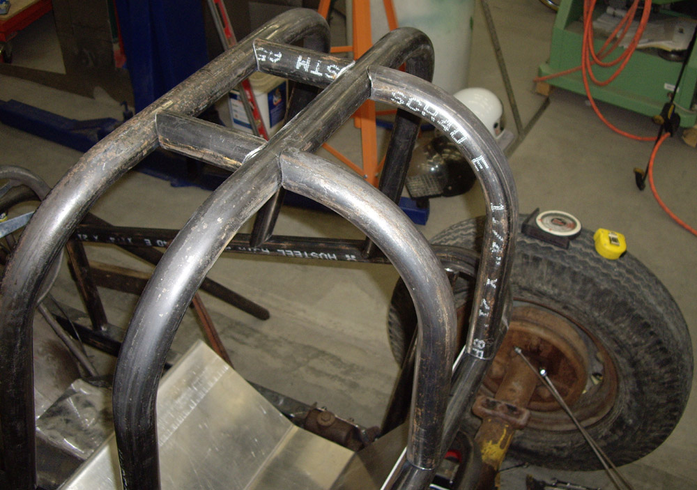

    Working on the roll bar and helmet bars. New seat is bent, and mocked in place. We get aluminum signs turned in from the State to a local re-cycler. We can buy those bad boys for 50 cents a pound. It's got to be 6061, takes two guys on my big brake to get a bend in it, and it will crack if you do a 90 with to little set back. STIFF... and a bargain! ;) We use it all the time and for lot's of stuff. Just got to make sure the radius on a 90 degree bend is not to tight and you're golden.

    getting closer.
    I'm guessing 20 more pieces to cut and cope to finish the cage... sure is a time consumer. Gonna be worth it when we get it to certify. Possibly wishful thinking, but we can dream can't we? ;)

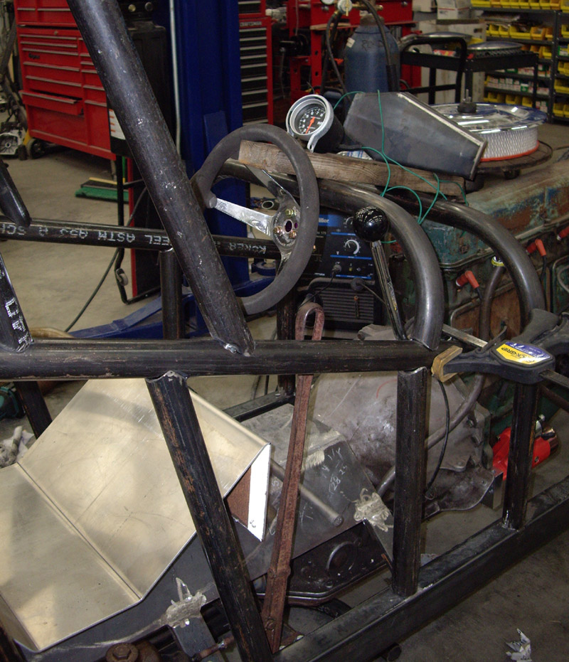

    Thing sits so tall that it's almost hard to get in, even if you stand on the frame in front of the firewall. So we put a step on it. When you stand up to exit, and through a leg out, it hits dead-on in the middle of the step. Keeps from wracking the old "twig and berries" on that shoulder bar. :) Freaking awesome to use. It's half of a 12" diameter circle. I like it on just the one side, adds a look of purpose.
    We're starting to mock up the dash area, and I "REALLY" want to have the shifter on the far right where I mocked one up, just above the brake lever. Anybody up on a dash mount shifter stick solution for GM.? I'm of the opinion that this might be a solution. We need it to be operable with one hand. not sure how user friendly this is.
    http://www.summitracing.com/parts/HUU-3160006/?image=large
    Now that I think about it... That ain't gonna work for shit. You can't hold the brake and put it in park or in gear with the same dang hand at the same time... If we foot braked it we could... Maybe we are gonna end up with a shifter in the crotch. Needs more thought.
    What moving it to the dash does is frees up the entire floor space making entrance and egress of the cockpit easier. Car is entered from the right and exited from the right with nothing to snag on, catch, break or bend. All the controls will be on the right in the cockpit, including all electrical. Everything mechanical on the right side. entrance on the left with nothing to step on.
    There's a difference between a 10 second or slower altered/funny car and a 6.0 or slower funny car, one of which is moly. I'm leaning toward changing a few bars you won't see behind body work to be more accommodating to the 10 second or slower car build rules. I really wanted to see an 8.50 cert as a badge of pride. But I'm starting to be of the opinion that they don't do this style of car that way. Which means we'd be overkilling for a 10 second cage that doesn't even require a cert in the first place.
    Is there an 8.50 cert for a car with the driver centered? I have no idea.

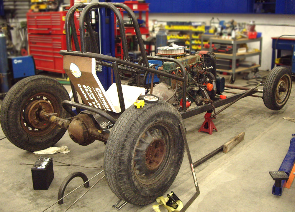

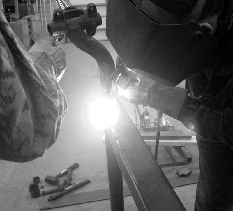

    I've developed a new found appreciation for buying a $5000 altered chassis when you see them for sale. ;) I've done my fair share of simple roll cages and bars... THIS is work......lol...

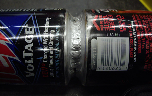

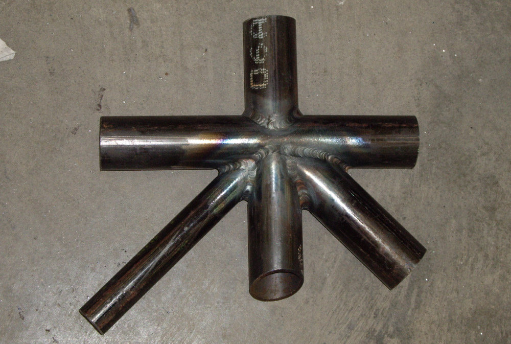

    1) Made a test piece for notching and welding. Wanted to see the differences with 1" and 1.75" into a 90 degree corner.
    2)Got the helmet bars in.
    3) All 3 seat belt bars in.
    4) re-fit the seat.
    finally got around to trying to weld pop cans together. Gonna need more time on that... ;)
