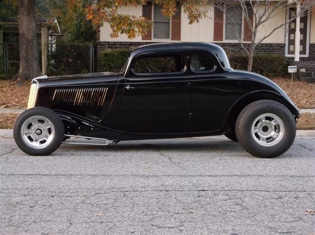

    Here is mine 3 in front and back. Might have been 3 and 1/2 or 4 I can't remember...
    looks like this with color on.
    Keep after it, it is going to be bitchn. -Abone.

    I actually looked at your chop a long time Abone! The color does make the eyebrow less noticable.
    Keep after it, it is going to be bitchn. -Abone.[/QUOTE]
