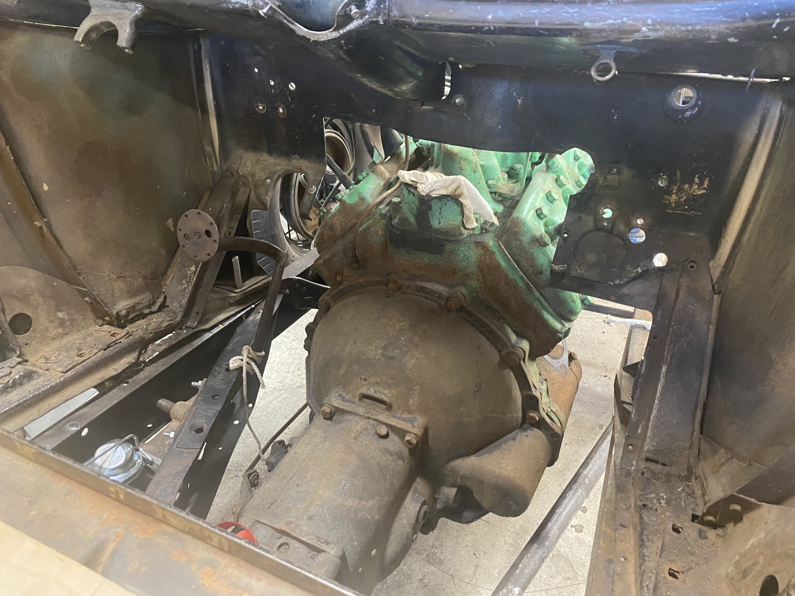

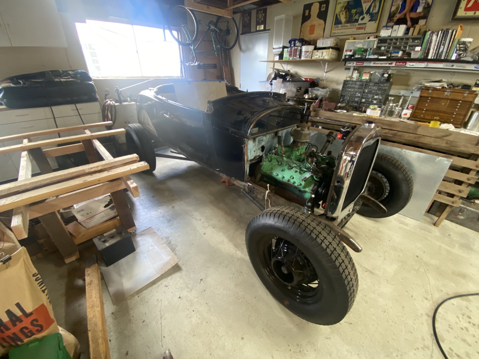

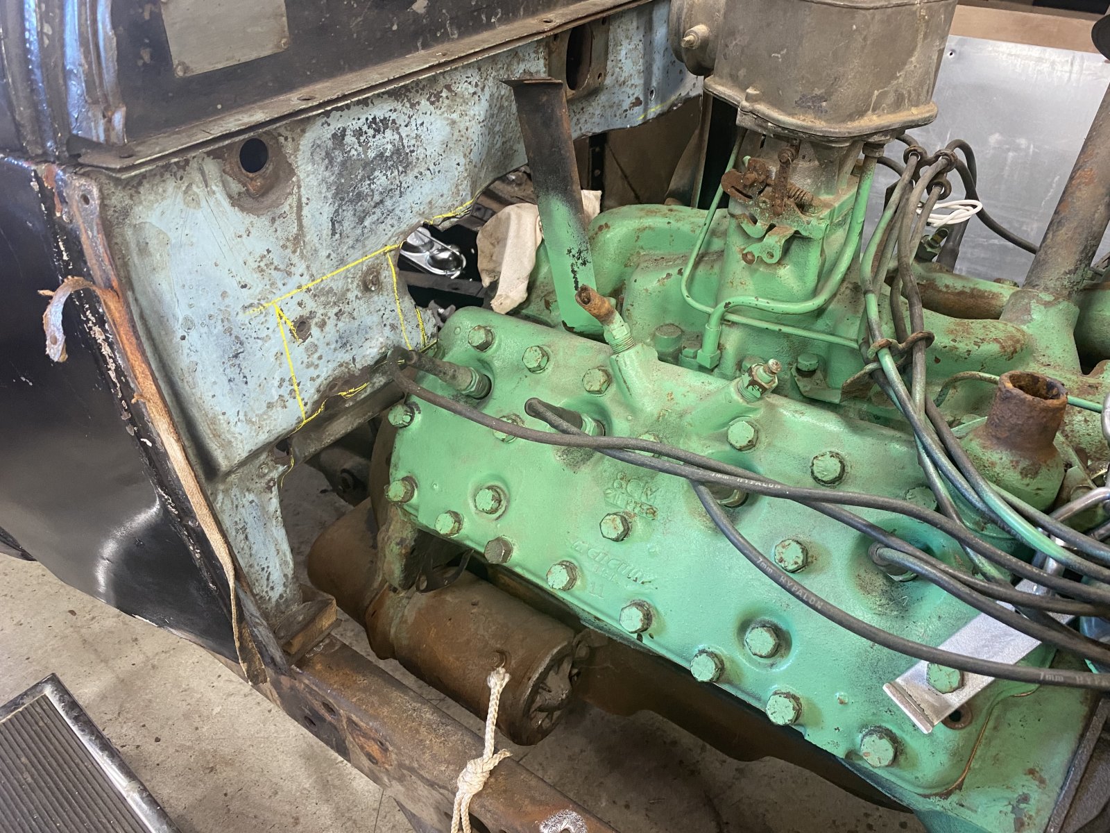

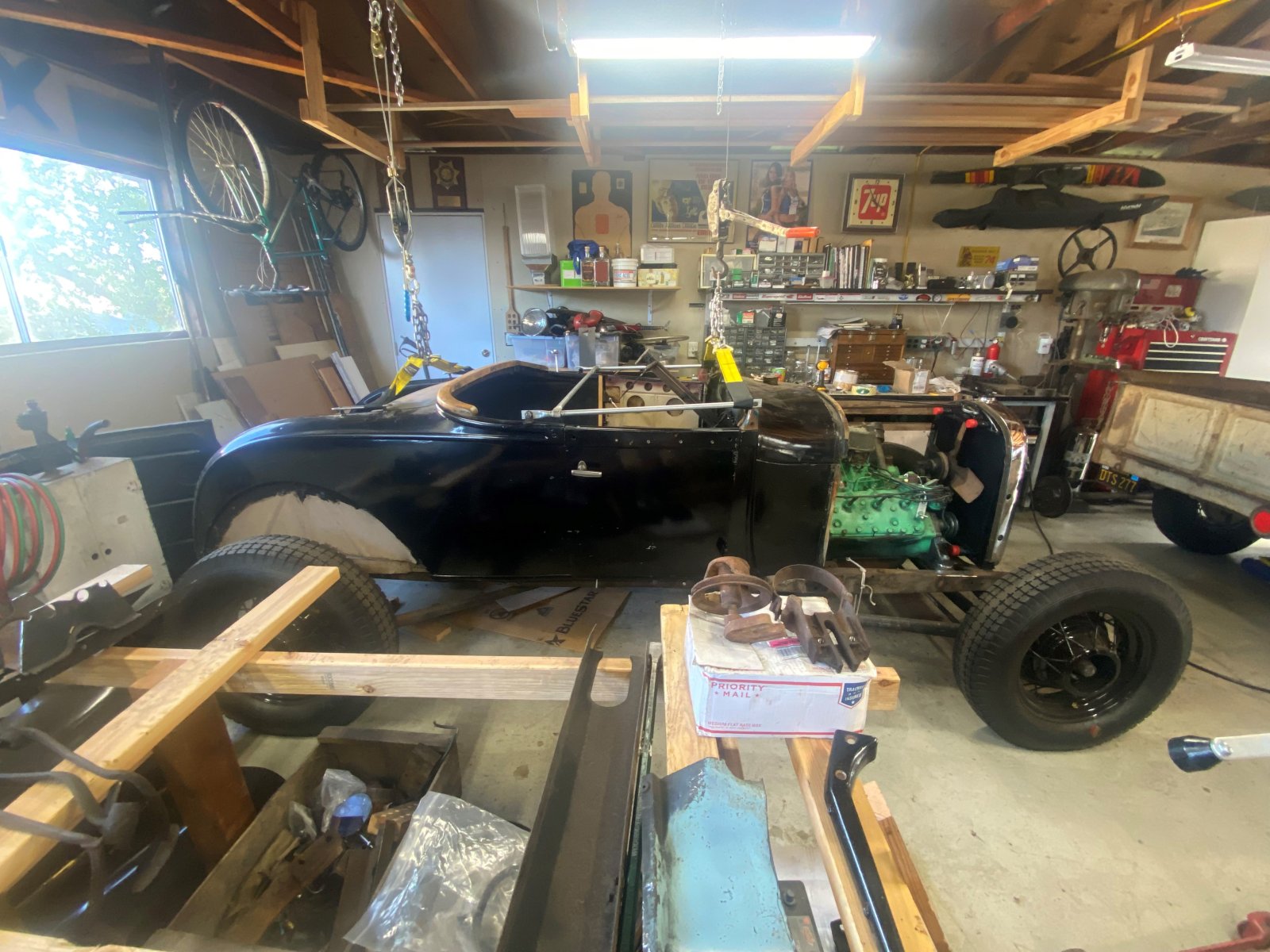

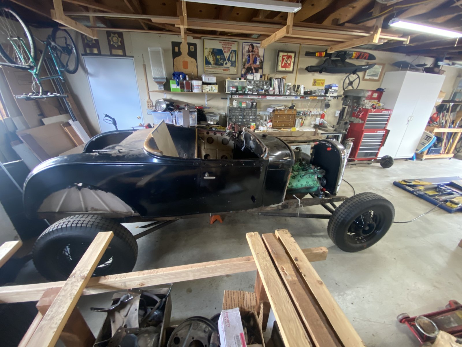

    Dropped the body back on the chassis to see how it all goes together. I’ll need to “adjust” the firewall a bit. Body still needs to move forward by 2”. And I still need to cut the sub to clear the frame step, so the ass will drop another 3”. Feeling good about the proportions and stance. IMG_3198.jpeg IMG_3196.jpeg image.jpg

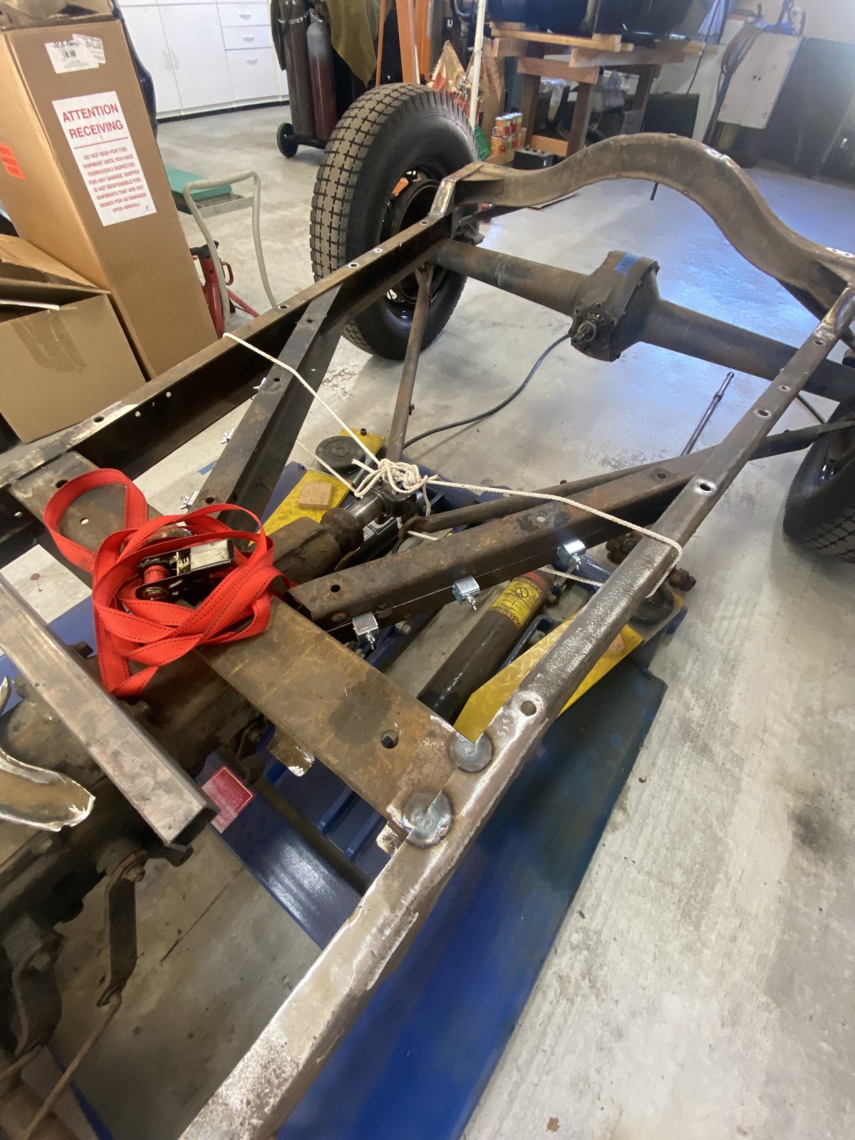

    As with any build, I had a change of plans. The ‘40 X member alone was frustrating me, so I changed my path to a hybrid approach. I put the ‘29 cross member back in. Now I’m using pieces of the ‘40 X member to stiffen things up and make space for pedals. Looking good so far and seems like a good alternative. If you see anything I’m missing please let me know. IMG_3208.jpeg IMG_3207.jpeg IMG_3206.jpeg IMG_3205.jpeg

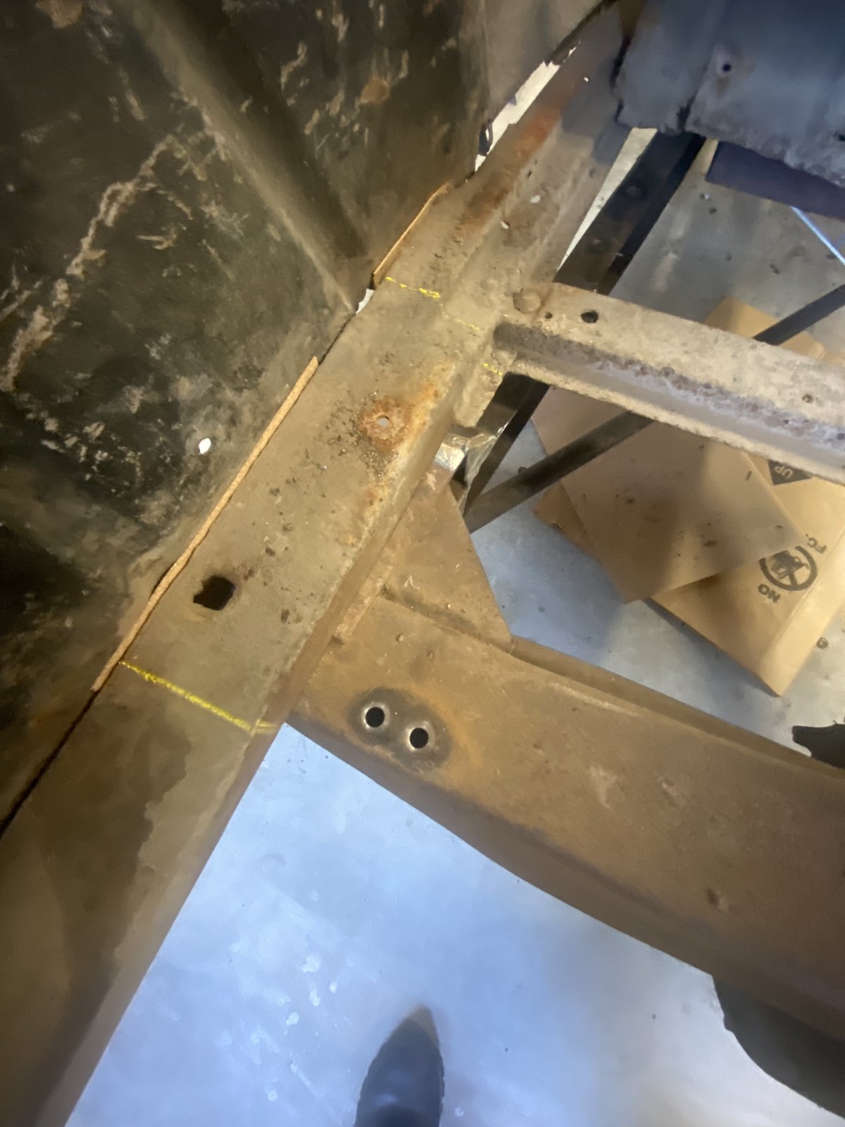

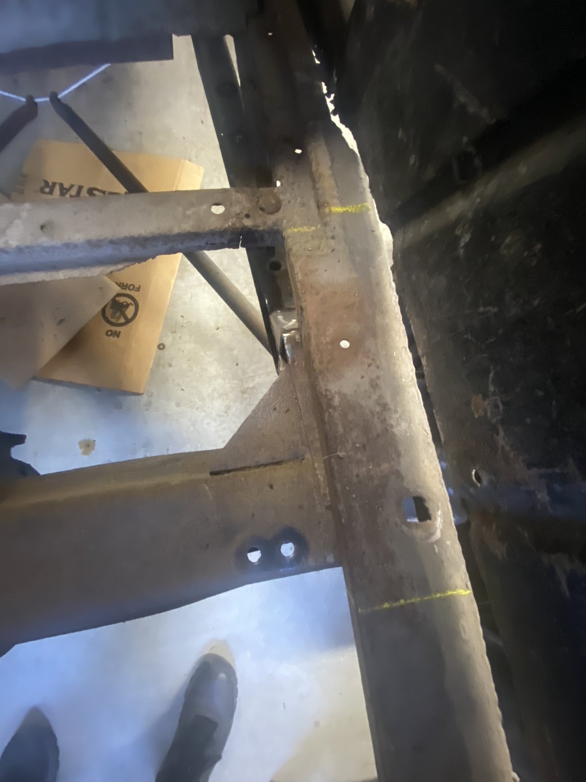

    Marked the rear subframe to remove the section at the step. Time for more cutting. IMG_3212.jpeg IMG_3213.jpeg IMG_3214.jpeg

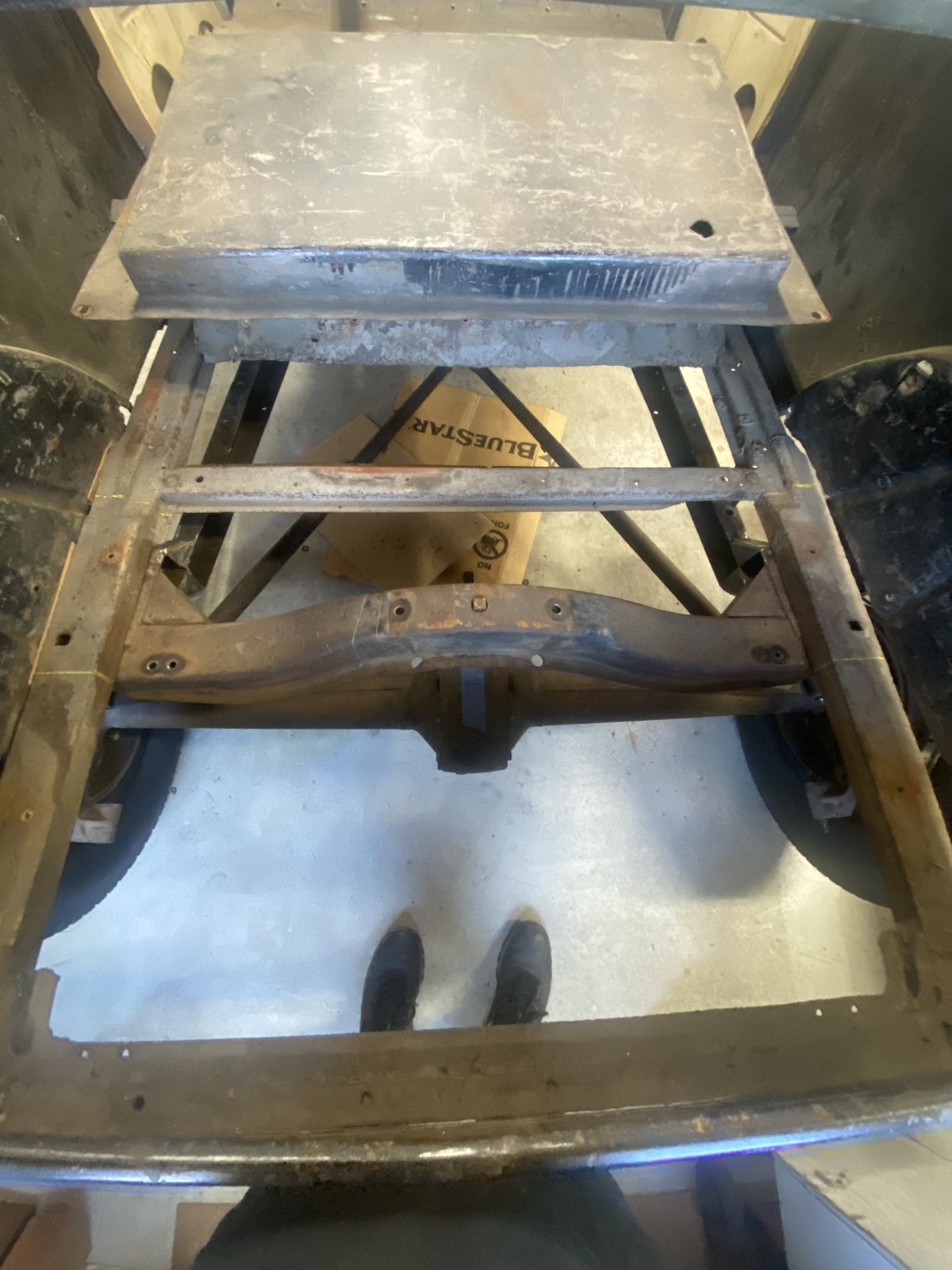

    Had a few spare minutes in between meetings today and got the subframe trimmed to clear the step. I left a bit on the top to keep it structurally stiffer, and I'm going to weld in a piece of sheet metal to "box" in that part of the subframe to stiffen it up more. Of course, the subframe isn't in great shape and will likely get replaced, so I'll try not to spend to much time and effort on this since it is "sunk cost" Cut1.jpg cut2.jpg

    Now it's sitting lower in the back than it was before. Sits almost level. May need to adjust the front or the back depending on how it sits when more parts are on the car (seat, gas tank - trunk, battery - trunk, deck lid, etc.)

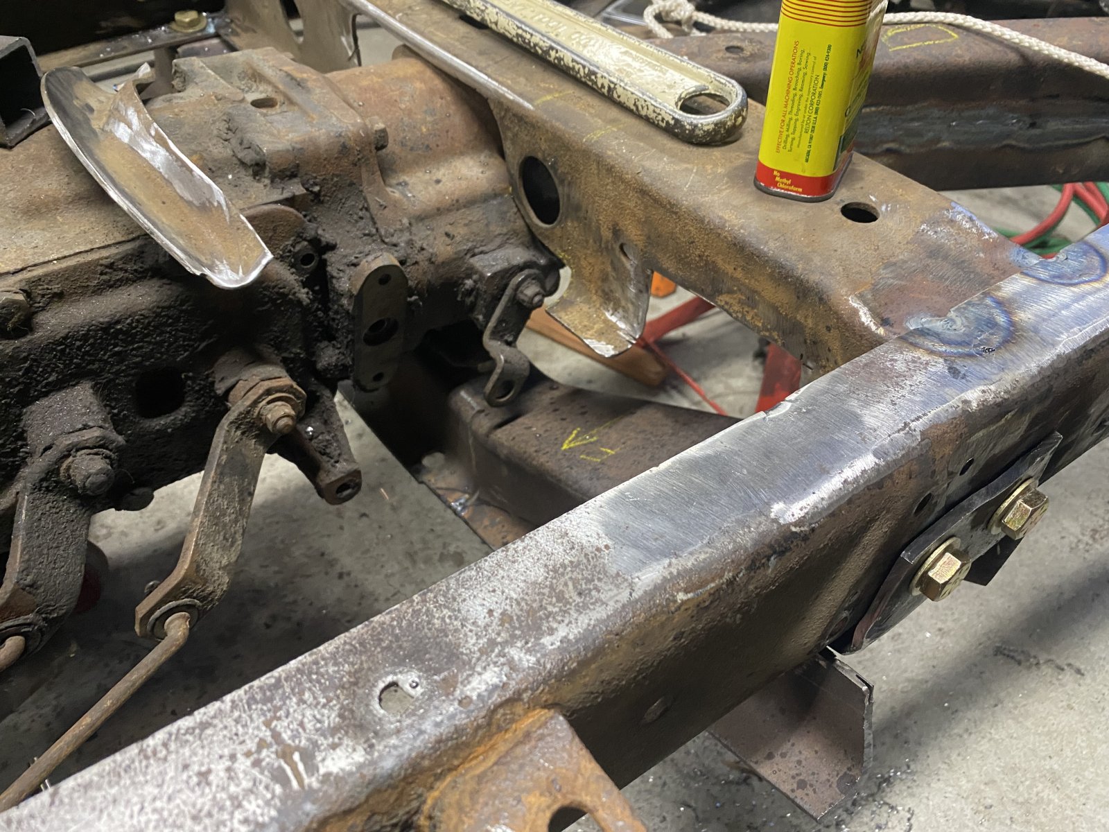

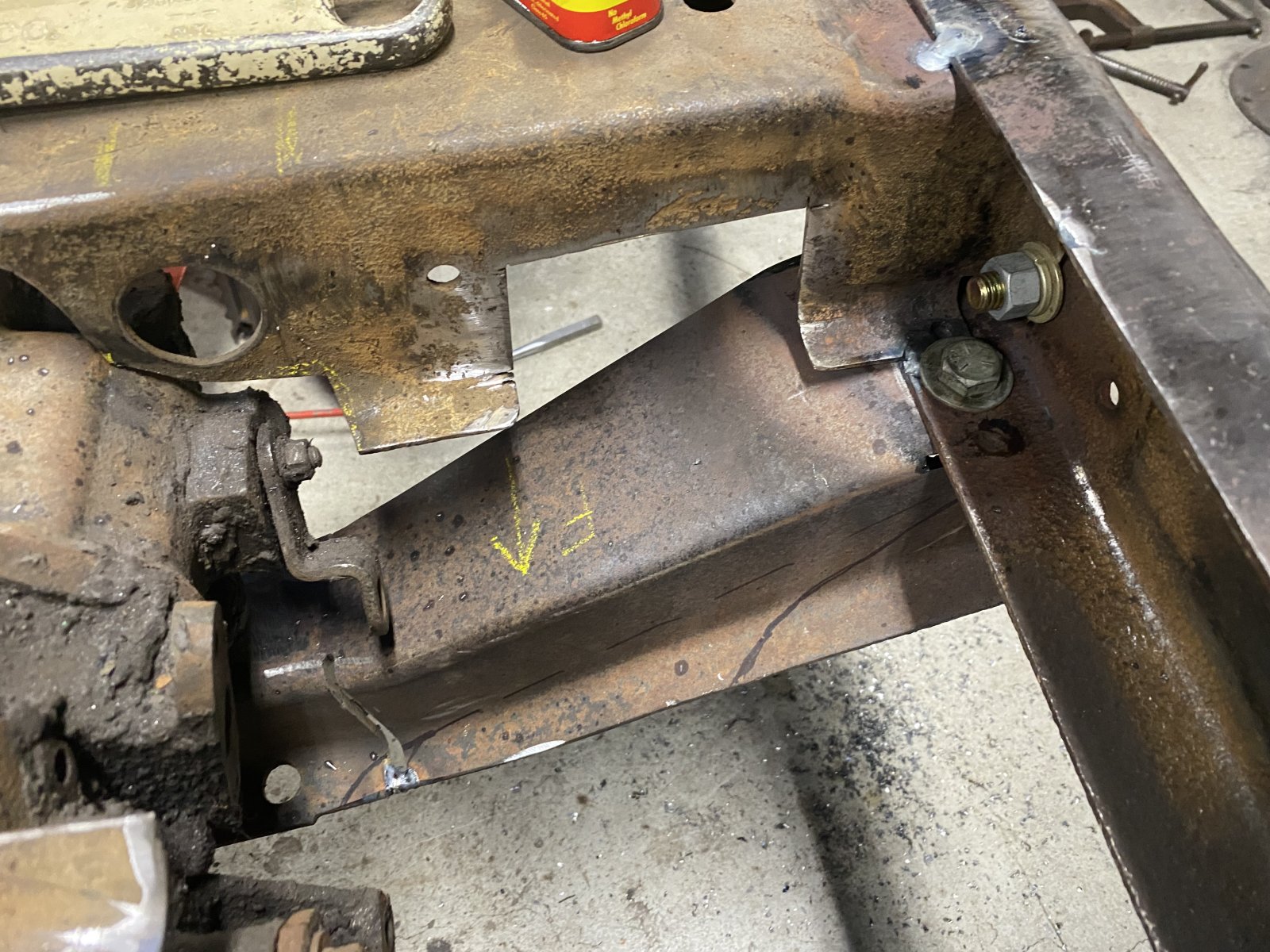

    A little progress. Cut down the ‘40 X member to go behind the model A cross member. Sectioned them ala @Aaron D. to fit inside the frame. Today was garage clean up day. IMG_3273.jpeg IMG_3272.jpeg IMG_3271.jpeg

    Hope to get them welded up and in next weekend. Then on to the trans mount.

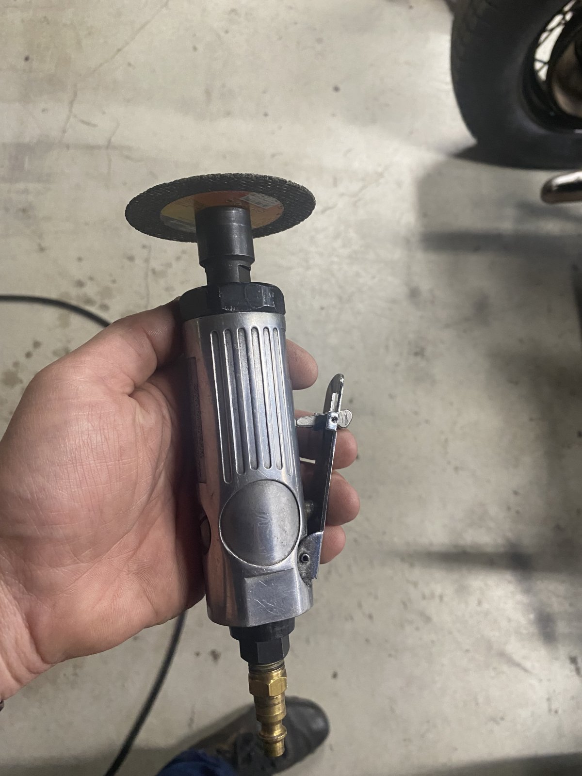

    Looking great, Jeff. The cuts look clean. Did you use a cutoff wheel or a Sawzall?
    Outback likes this.
  16. Jeff34
    Joined: Jun 2, 2015
    Posts: 1,197
    Jeff34
    thanks, Joey. I used a cutoff wheel on an air tool. Smaller than the angle grinder in tight spaces

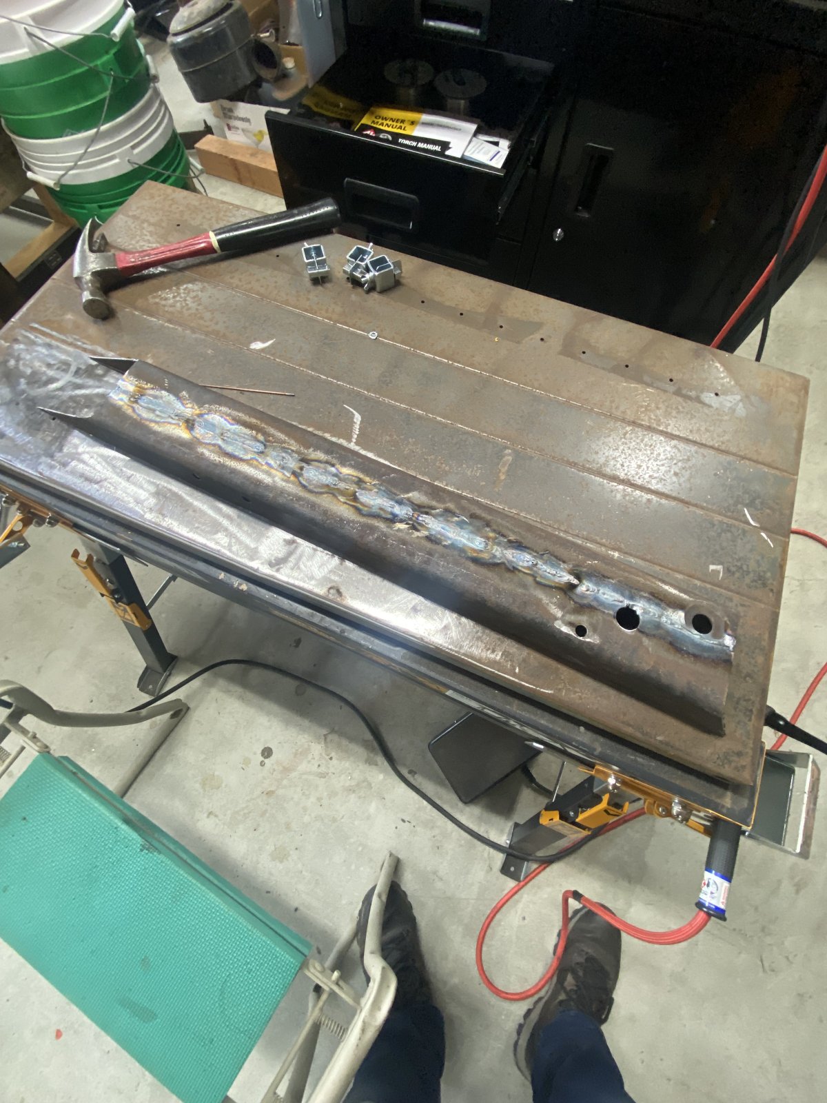

    Got one of the rear X members welded up. Still needs some trimming to get it tacked into the frame, but I’ll wait until the other one is finished and do them both at the same time. IMG_3284.jpeg IMG_3286.jpeg IMG_3288.jpeg

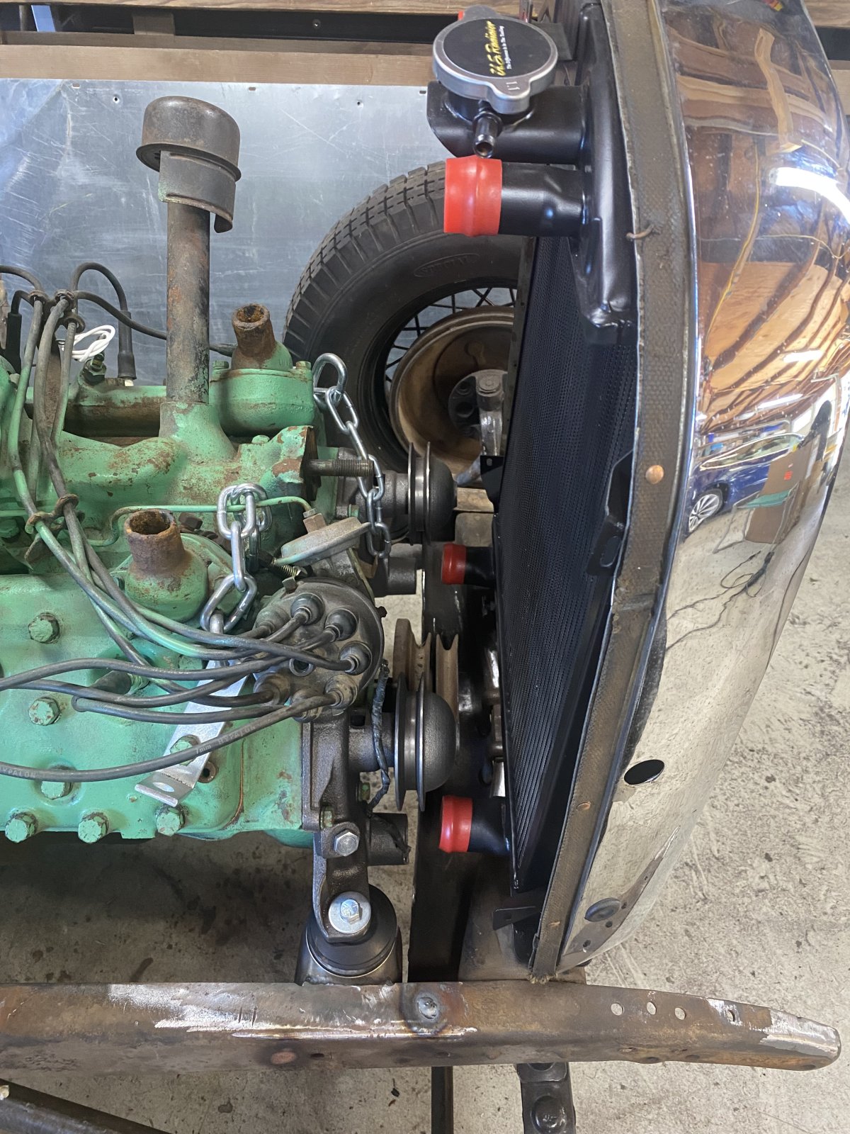

    The 8ba is running all wide belt accessories on the front. 8RT pumps, double wide belt crank pulley, and a wide belt Powergen. The rear belt drives both pumps and the gen, and the front belt runs the fan.
    Question: what belts do I need? I could just call C&G but I thought I’d ask y’all first.

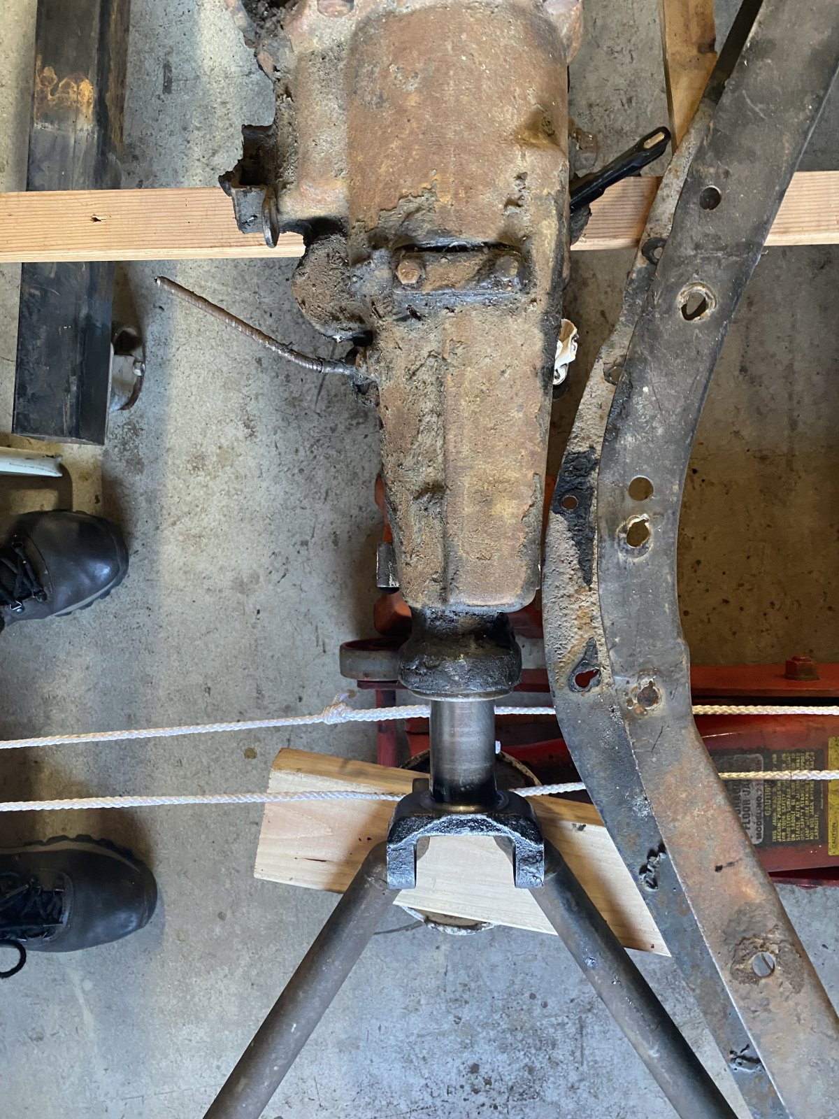

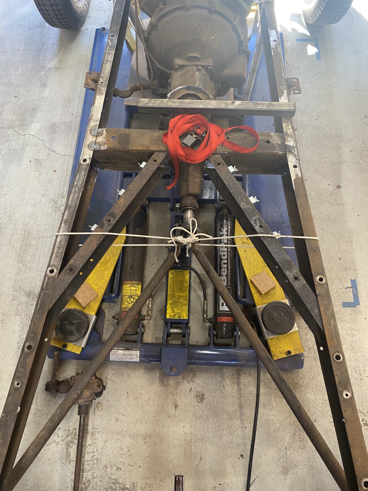

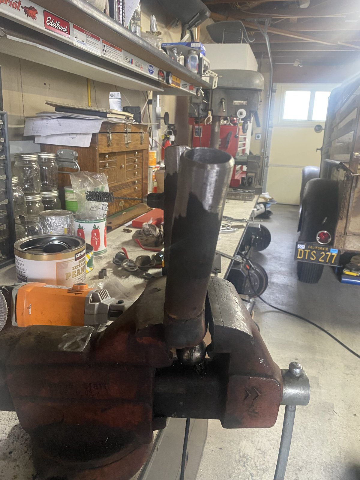

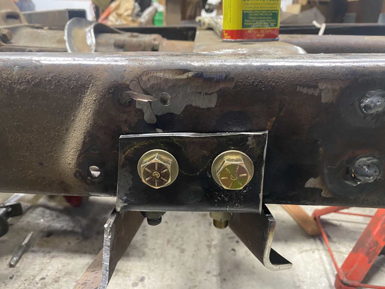

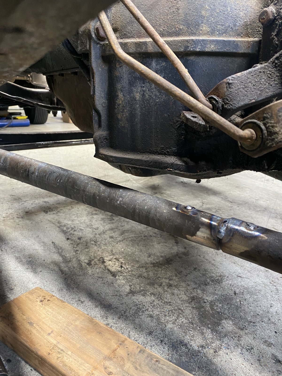

    Got the transmission mount fabbed and installed. I’ll trim some off the underside of the ends so they can’t be seen, and I still need to finish rounding and smoothing the ends that will be seen. Then I mounted the ‘29 yoke to the trans crossmember and bent it to align with the’40 wishbone. Cut bothe to length. Now to weld something inside to join (ala AaronD’s build. Thanks Aaron!)
    Slow progress but progress. IMG_3347.jpeg IMG_3349.jpeg IMG_3348.jpeg IMG_3526.jpeg IMG_3523.jpeg IMG_3524.jpeg

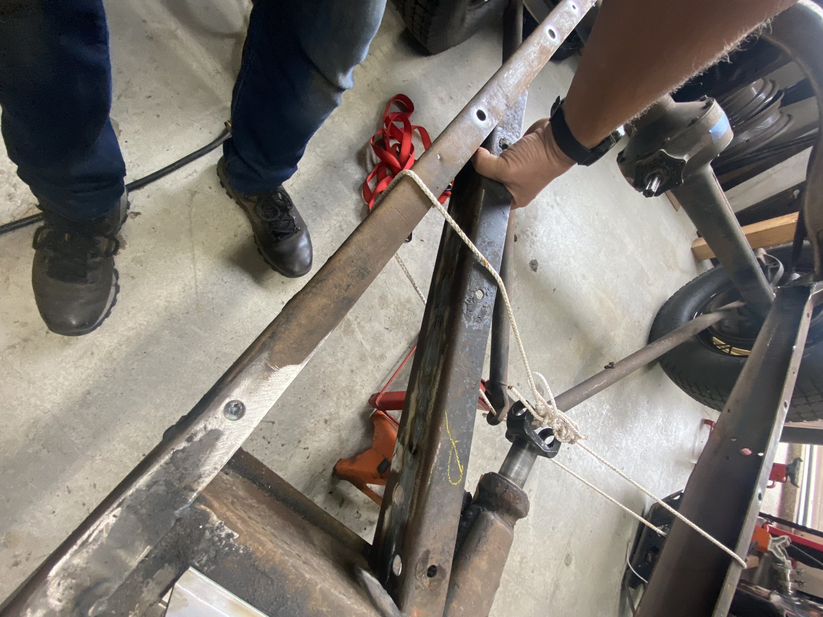

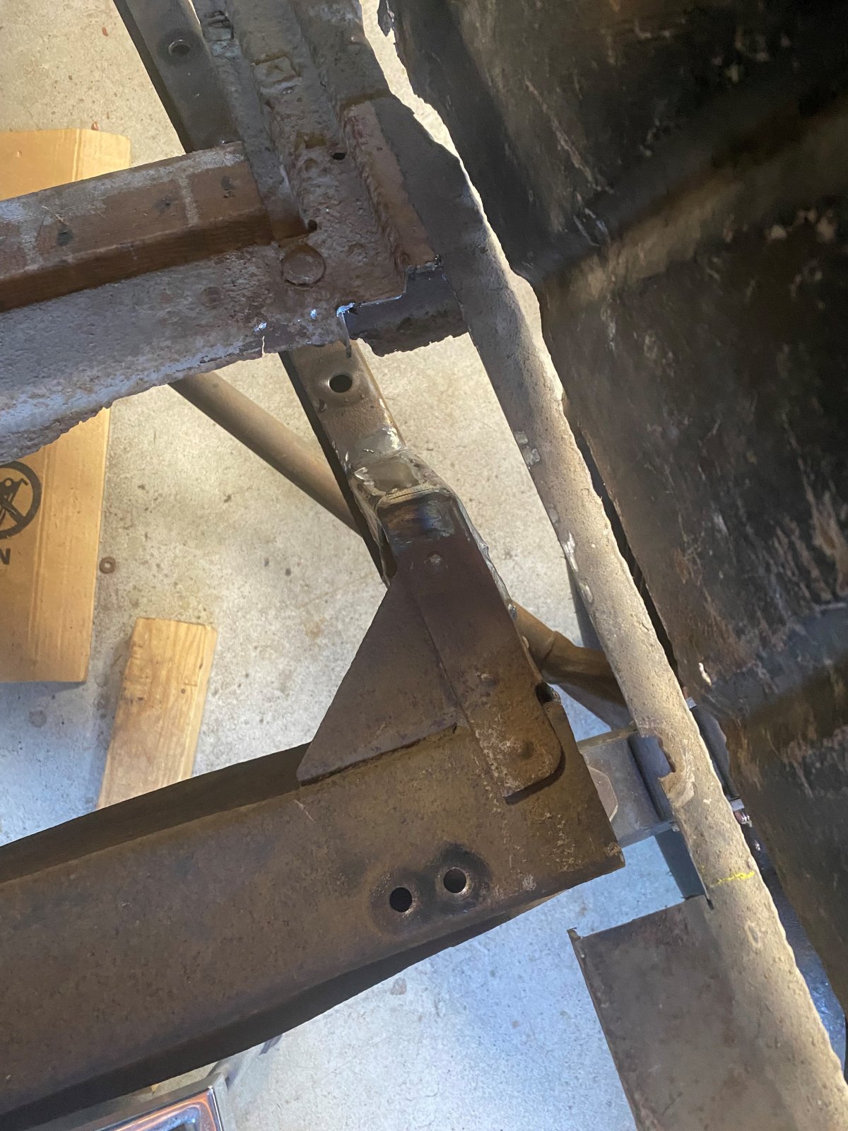

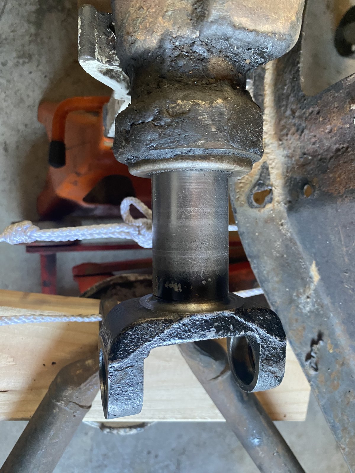

    I was working on getting my wishbone finished up, but something looked wrong. The yoke was sort of twisted. Turns out that when I bent the legs of the ‘29 wishbone in to match the ‘40 bones, I bent one out of plane. Need to get that right before I weld it up. IMG_3546.jpeg

    Got it straightened out and in place. Lines up nice and everything is tight. Next is the rear X members and a mount for the rear bones. Then I should have a roller. IMG_3549.jpeg IMG_3548.jpeg IMG_3550.jpeg

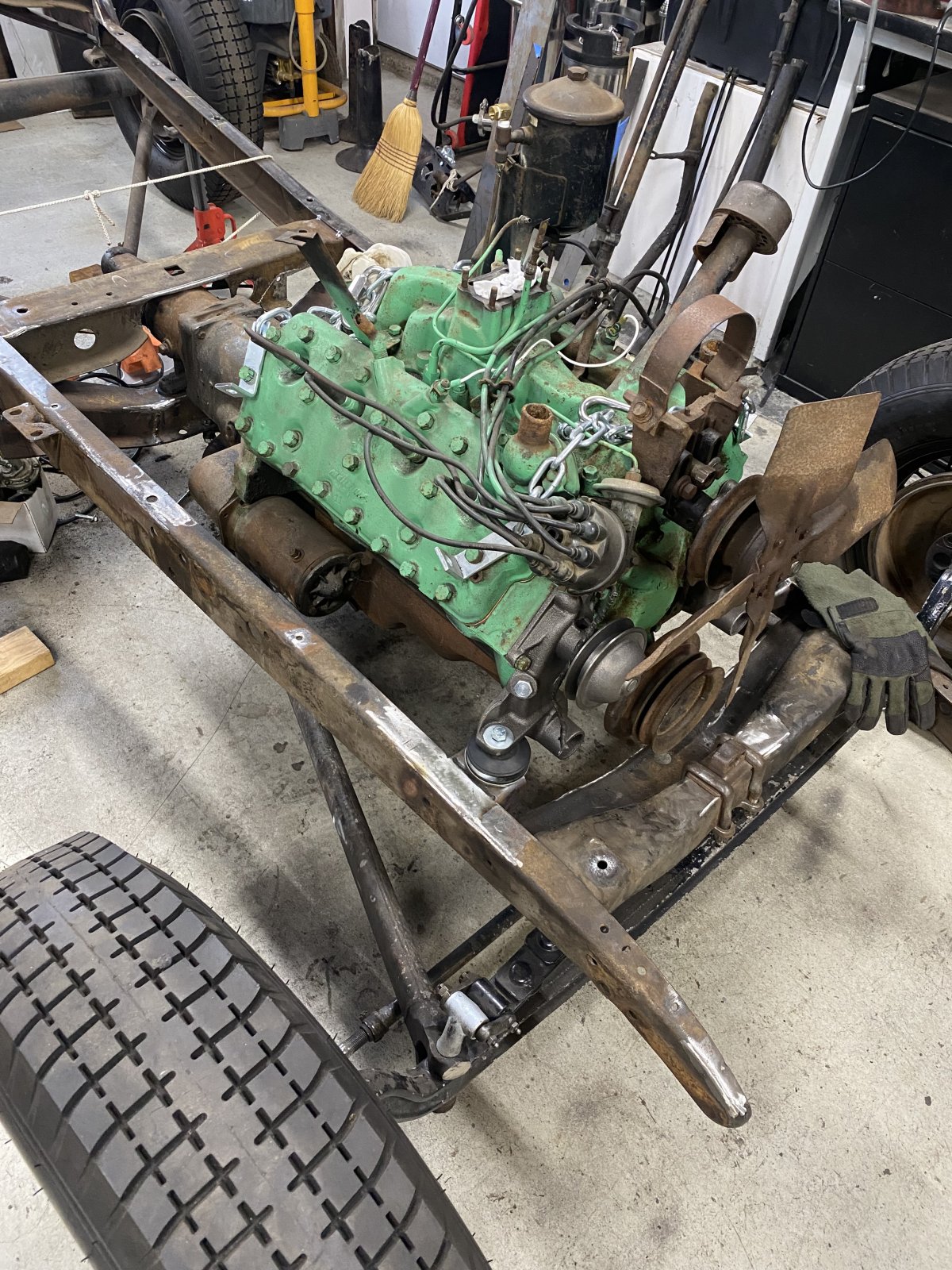

    IMG_3555.jpeg I made all the measurements to make sure the pan wouldn’t contact the wishbone, but you know how that goes. I put the engine back in and bolted it down to check. I’ve got just over an inch on both sides. I also did a very objective “bouncey” test to see if they would make contact. I’ll see if I can figure out how to upload that. Seems like it’s all good. Moving forward. IMG_3557.jpeg IMG_3556.jpeg

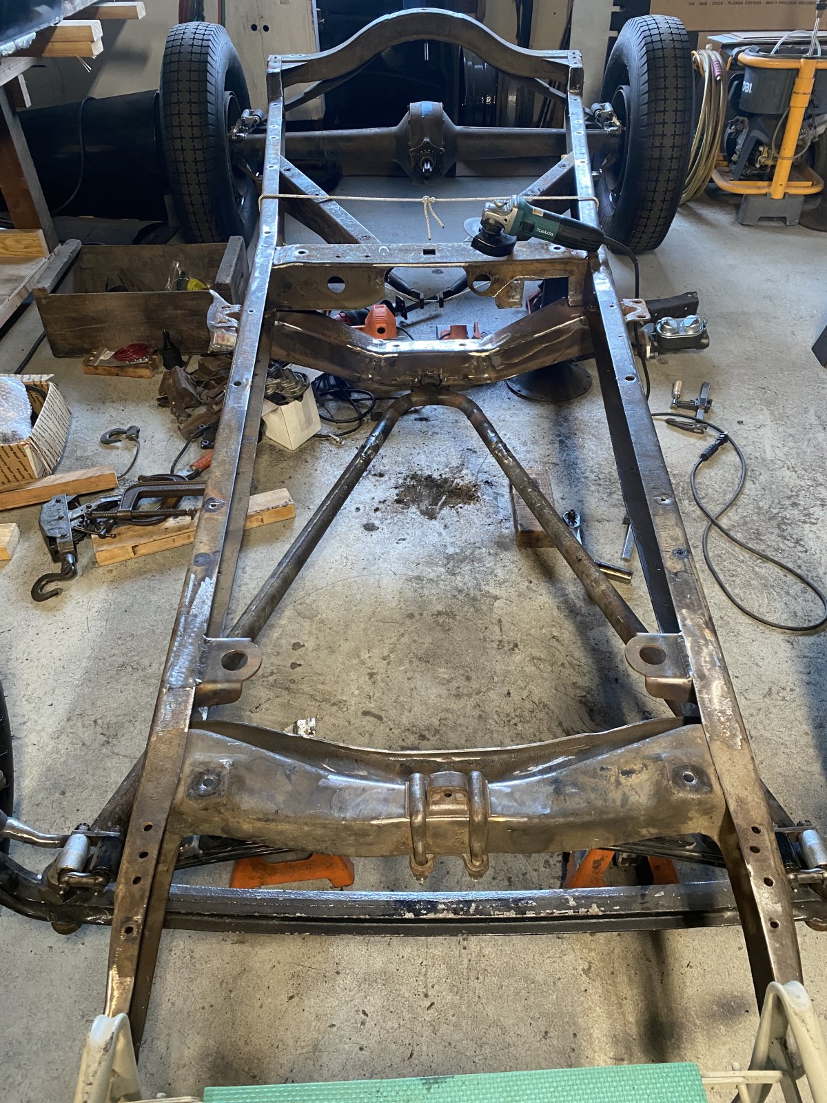

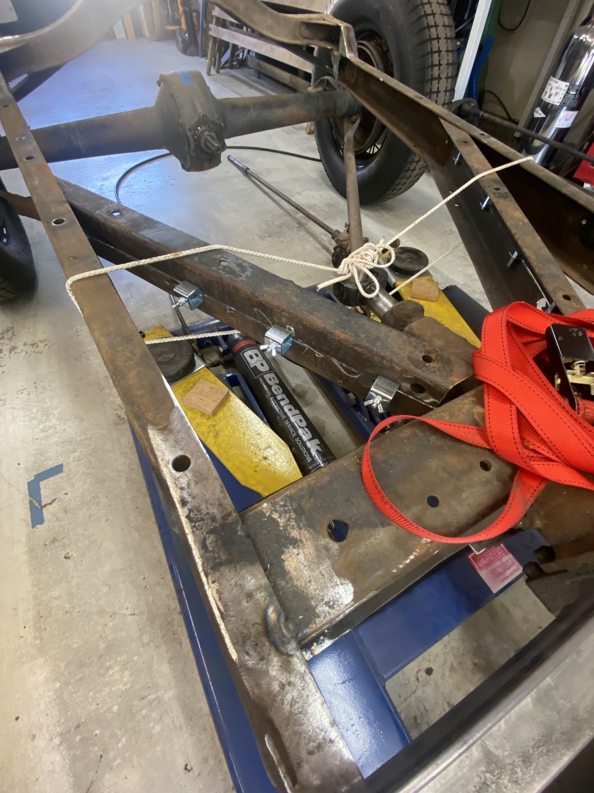

    With the front suspension done (enough) to roll the car on it's own, I decided to spend some time on the rear suspension. I got a Rock Johnny Joint for my radius rods to bolt to, and I'm working on a small crossmember for that. Planning to weld it in between the rails, and then add some braces from that forward to the trans crossmember and back at an angle to the frame rail on each side as well, like a pseudo X member. Should stiffen things up a bit and provide more than enough support for the radius rods and third link from the banjo. I'll flip the Johnny joint over so the zerk is on the bottom. IMG_3565.jpg IMG_3566.jpg
    brEad, Spooky and Craig Owens like this.
