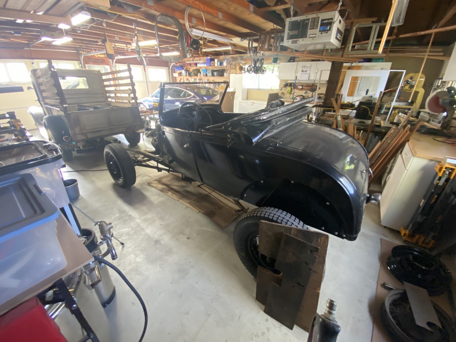

    Thinking about these for my roadster...Aye, Nay? WTF are you thinking? These are new.
    Outback, Vic Walter, Jet96 and 14 others like this.
  6. loudbang
    Posts: 40,344
    AYE they look pretty spiffy. :)

  7. sloppy jalopies
    Joined: Jun 29, 2015
    Posts: 5,256
    sloppy jalopies
    aye plus !

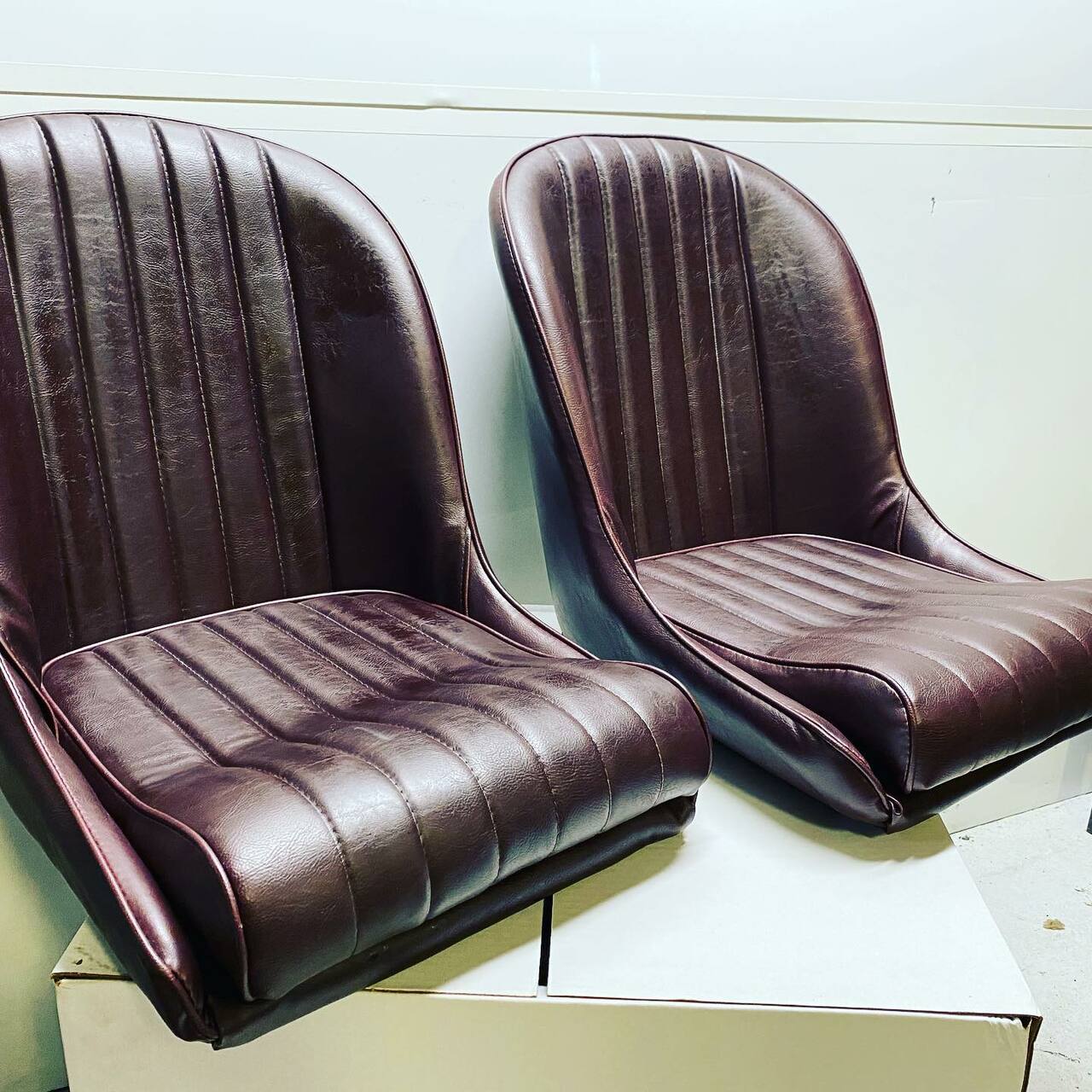

    the seats are new from where/ whom ?

  8. Those are killer tires!
    loudbang and Jeff34 like this.
  9. Jeff34
    Joined: Jun 2, 2015
    Posts: 1,197
    Jeff34
    They are from RSHRP in the UK. They are not cheap, but I'd probably be in this much to get a custom upholstered seat anyway.
    http://rshrp.com/vintage-collection-low-back-bucket-seats/
    Thanks! They're also from the UK. I really like 'em.

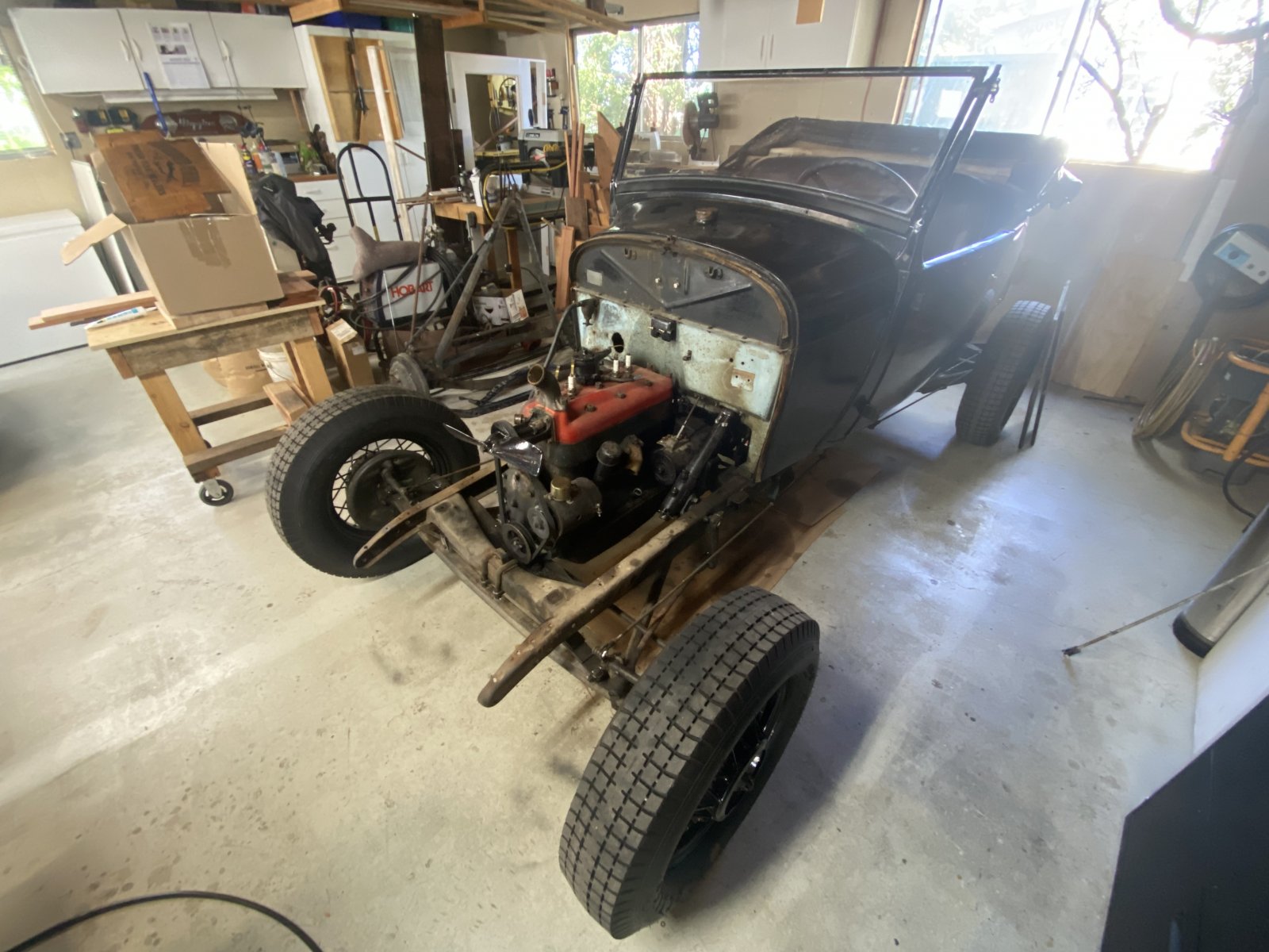

  19. Jeff34
    Joined: Jun 2, 2015
    Posts: 1,197
    Jeff34

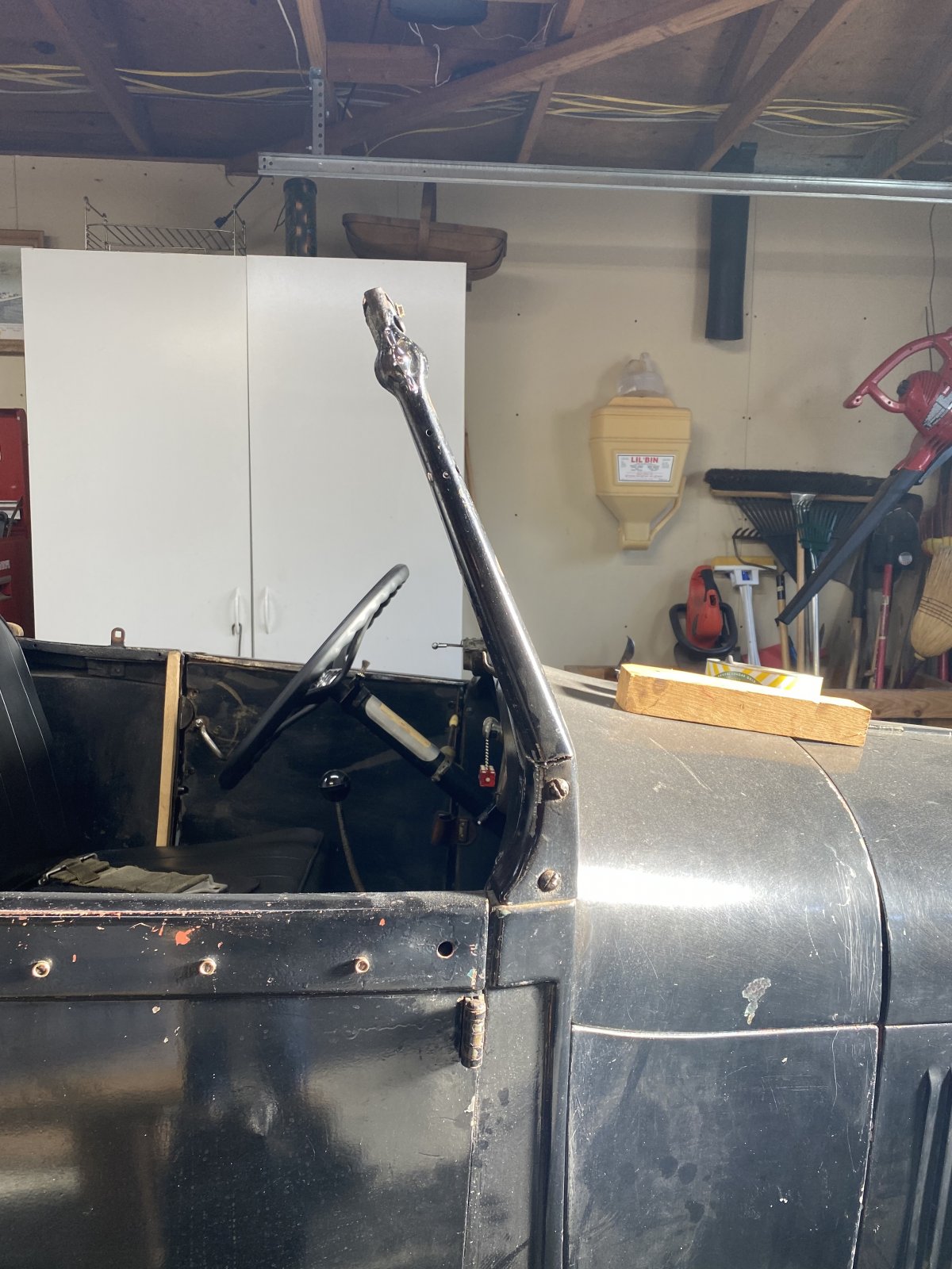

    Any thoughts on windshield rake? I’m thinking this looks about perfect but would like to know if there are disadvantages.
    LCGarage, Outback, Jet96 and 8 others like this.
  20. A Boner
    Joined: Dec 25, 2004
    Posts: 8,061
    A Boner
    Windshield looks great!
    Disadvantage...doesn’t look like an antique car now. :)
    brEad, Jeff34 and loudbang like this.
  21. Nobey
    Joined: May 28, 2011
    Posts: 1,517
    Nobey
    That looks about right, If you go to far back the lower center will bottom out and the corners
    will stick out....
  22. Stan Back
    Joined: Mar 9, 2007
    Posts: 2,644
    Stan Back
    Make sure you put your seat in and test to see if the top tube of the windshield is not directly in your scope of normal front vision. That is really annoying.
    51 mercules, Outback, Stogy and 2 others like this.
  23. Jeff34
    Joined: Jun 2, 2015
    Posts: 1,197
    Jeff34
    thanls for that. I checked it closely before I tacked it in place after I read your comment.
    I did I planned to chop it 3”, but decided to wait until I get my seat in so I can see where my eye level ends up. Thanks for pointing it out
    Outback, USMercUte and Stogy like this.

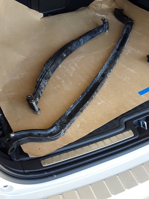

  25. Jeff34
    Joined: Jun 2, 2015
    Posts: 1,197
    Jeff34

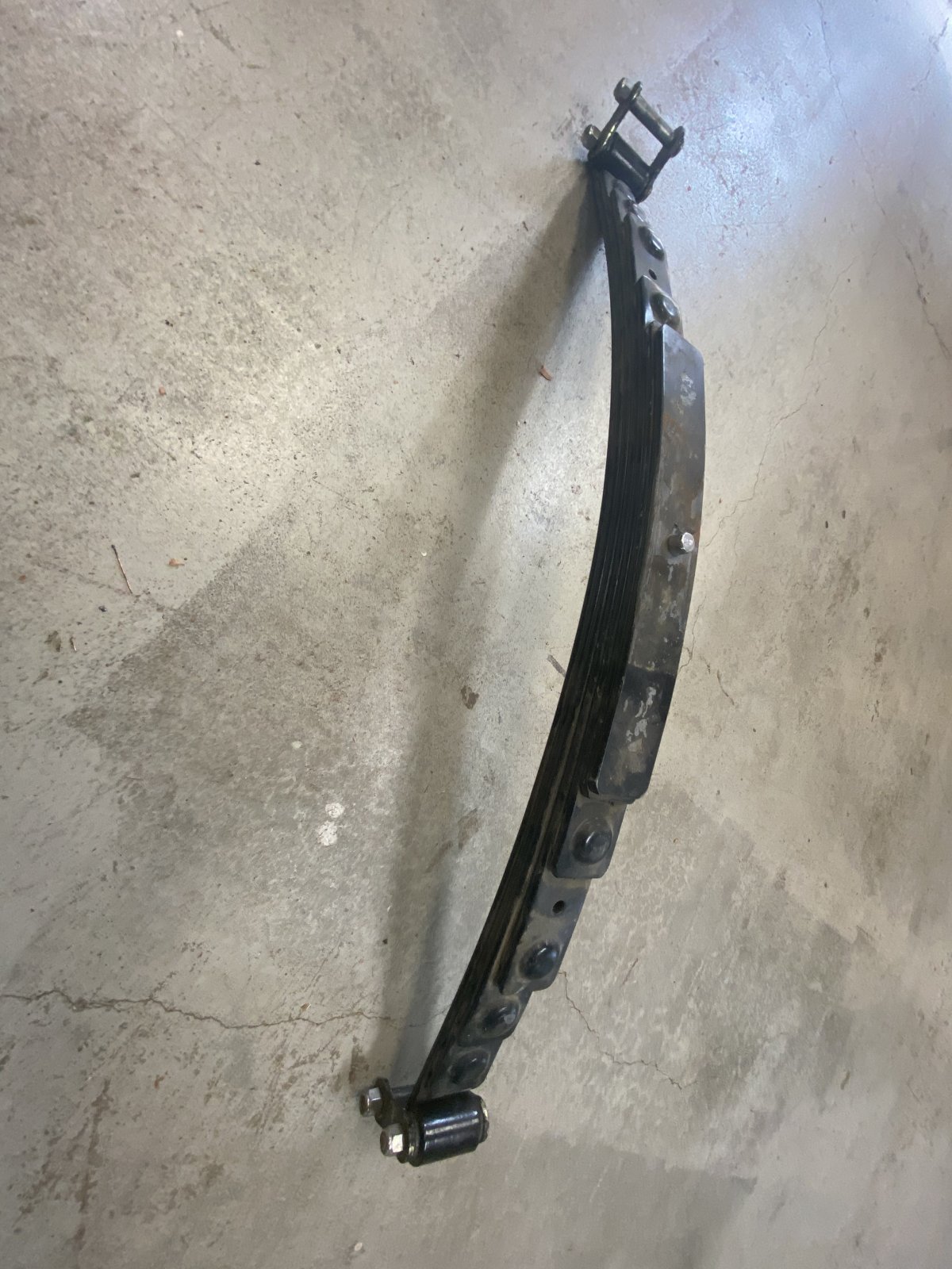

    I received my dropped axle and spring today. This one was dropped by Mor Drop in Oakland a long time ago. 4” drop, no stretch. Looks super straight. I could use some help identifying the spring. It looks newish to me. Reverse eyed, about 31” between mounts, 7 leaves. Posies? 2FEBFBF4-33C5-4604-BE5D-1717BF4B6FA8.jpeg E3A4F0F8-2088-444C-9265-7C9AFAF84213.jpeg

  26. G_Don
    Joined: Feb 17, 2017
    Posts: 234
    G_Don
    Looks similar to a posies spring. Although my posies doesn’t have chamfers on the end of each leaf… maybe it had been modified?
    not sure if it other companies make springs with the little polymer discs like posies, but I love mine.
    car looks great but could definitely use that dropped axle!

  27. Craig Owens
    Joined: Jun 28, 2006
    Posts: 468
    Craig Owens
    I second the vote: it looks like a Posie's spring. I have Posie's springs on both ends of my Model A coupe and on the front end of my Model A pickup, and they have the reversed eyes and those distinctive little button-shaped dimples to locate the delrin antifriction discs. I modified my spring ends by rounding them and chamfering 'em so that accounts for the softened corners on the ends of your spring.

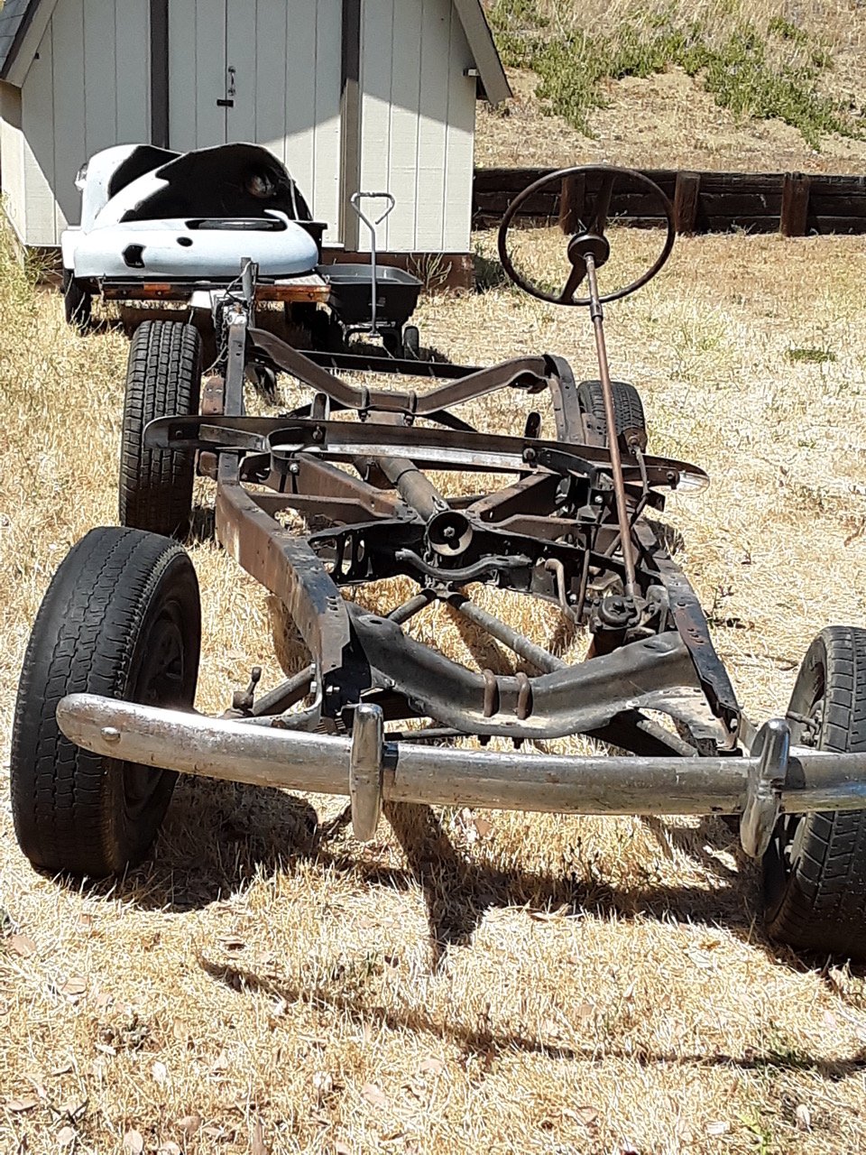

  28. Jeff34
    Joined: Jun 2, 2015
    Posts: 1,197
    Jeff34

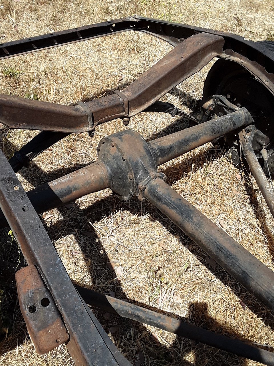

    Picked up a ‘40 chassis in Benicia today. More parts for the roadster. Got to finish another project and then I can start tearing into the car. Still need the steering tube and tree shifter. CC79F870-F541-43A8-94E0-916E1CF3AB4B.jpeg 33E5104F-3FD8-4BFB-AA55-A4B995AEAAE6.jpeg
    Outback, Lil'Alb, brEad and 6 others like this.

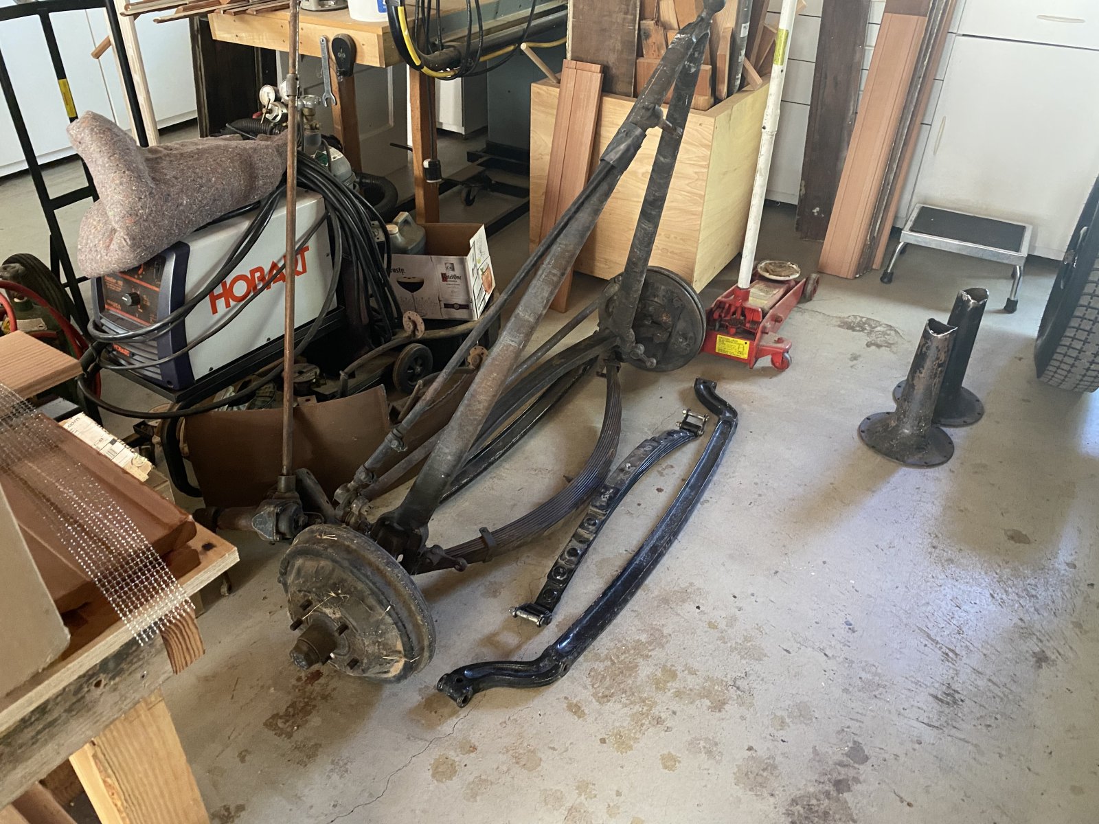

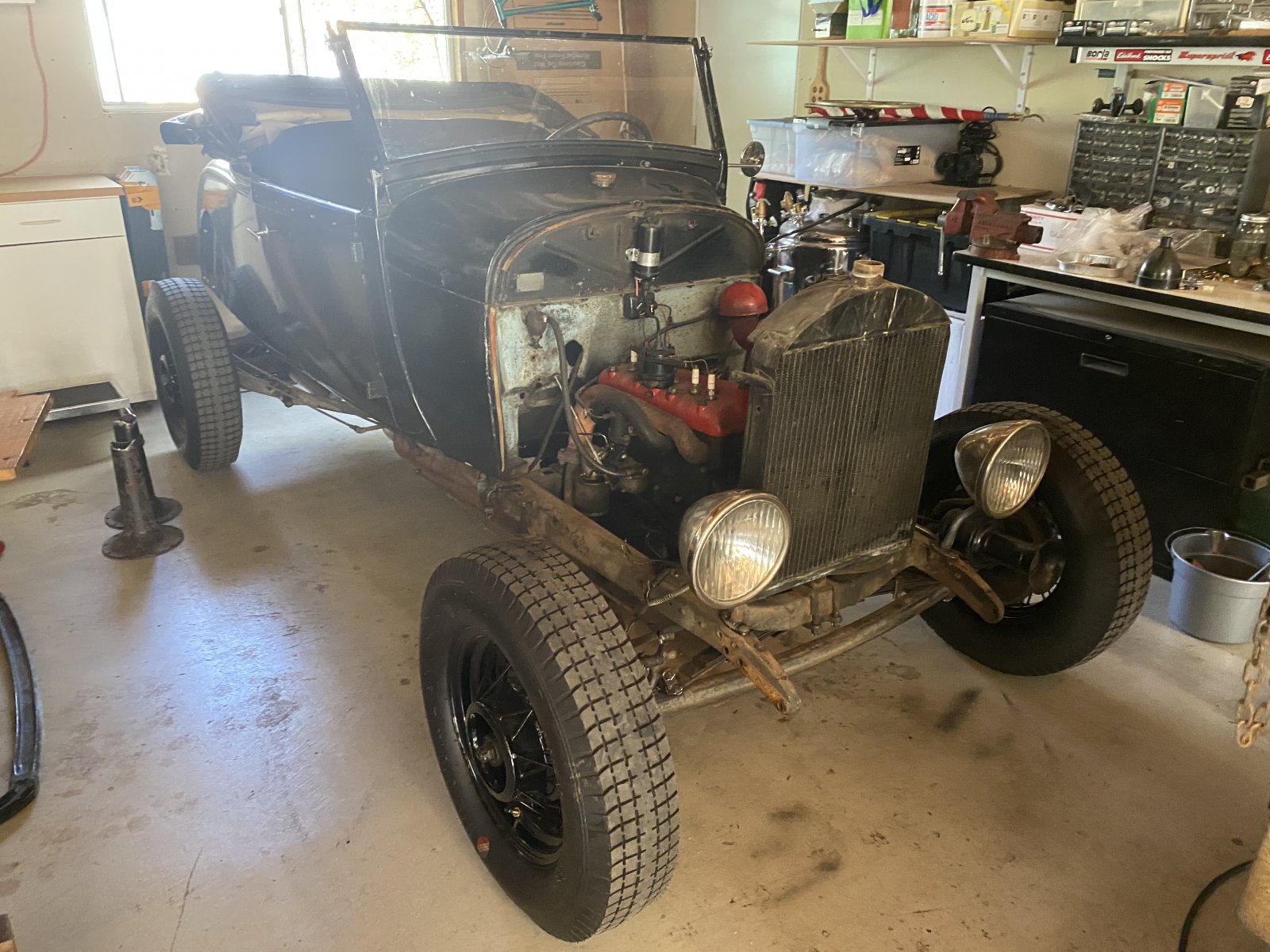

  30. Jeff34
    Joined: Jun 2, 2015
    Posts: 1,197
    Jeff34
    Started tear down today. Took the front end off the ‘40 and the front off the ‘29. Hoping to have it done by spring next year. ED98A88B-04DF-48A5-9F3F-63FF71B8DC13.jpeg 4D5E1CB8-CF61-45AA-B901-279E6E652C9C.jpeg 0769DE81-9BE9-4A6F-9C64-2897A6484C25.jpeg 8BCB336C-8CAE-4B9D-9F78-4B51C9D2EA45.jpeg AB1CF9AA-F2F1-4465-98F1-D4BD42D42D6A.jpeg D5A09E39-DCD8-4D4B-9531-3B7BCB9FEE39.jpeg
