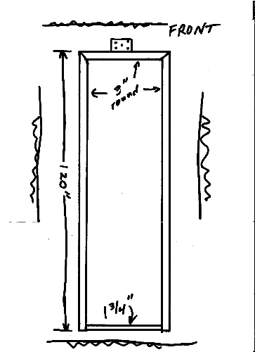

    If I were to build a short front engine dragster in a style that mimicked the diggers of the late fifties without copying any one particular brand or style, in an effort to build a ride that could pass tech and still reasonably reflect the feel of the era, with much emphasis on PASS TECH, either to 10.00 or 7.50, would the base rails in my picture pass muster as-is, or would they need changing?

    as far as I know ( not being the NHRA ) yes the 3 " and the 1 3/4 are ok,,think what comes into play is the wall thickness of the tubes.
    I would also post the question on teh Dragster Frames thread

    By your picture I'm guessing you're thinking like 2x3 framerails? The way I read it the rulebook doesn't make any provision for anything but round in the driver's/engine area. Don't remember at what point, maybe 3" ahead of front motor plate?, they don't care what you use.

  24. no, 3" round main rails. In my opinion the large diameter main rails are prominent features of Chassis Reseach and Lyndwood specifically, and more generally, separate an earlier effort from more conventional or later efforts. Using the proper wall thickness (I thought) was a given.
    what I am trying to decipher is whether there's an issue with the WAY my main rail picture is layed out or constructed.
    Is it ok that the front crossmember meets the main tubes at 45 degree angles and is butt welded, or would it need gusseted in some way?
    Does there need to be some X bracing between the front crossmember and the engine?
    Is it ok to use the 1.75" rear tube welded as shown, or does it need gusseted in some way? I have read that the shoulder hoop has to make a continuous loop around the back of the car, do the lower main rails have to make a continuous loop also?

    MoparSled - you have lots of questions (which is a good thing) if I were YOU I would be contacting the local NHRA Chassis Inspector - it's HIS approval you're gonna need.

  28. "Is it ok that the front crossmember meets the main tubes at 45 degree angles and is butt welded, or would it need gusseted in some way?"
    While I'm sure there must have been frames built with mitered corners, just about everything I've seen and have photos of used fishmouthed front crossmembers welded to the 3" main rail. When the builder used 2 smaller diameter main rail tubes on each side, they were then fishmouthed into the front crossmember.
