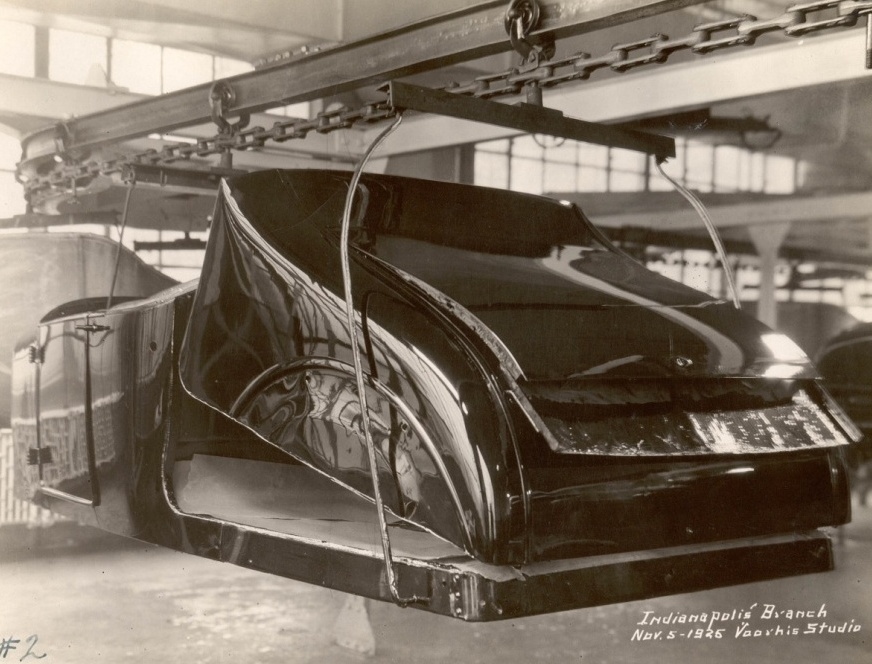

  16. Very cool! I believe the Tudor in that picture was painted with Pyroxylin (nitrocellulose lacquer)...Ford evidently made the switch from Gilsonite (asphalt-based) to lacquer in August '26 (approximately the 1926/1927 'model year' dividing line). Headlight bars were not present (to my knowledge) until right around this time.
    Here's a November 1925 shot of a 1926 (model year) roadster that had been flow-painted with Gilsonite (asphaltum). Very shiny!
    If your paint is indeed Gilsonite, it will have an almost oily sheen and may vary in color from deep black to brownish-black-blue. Small swirls and scratches will show a 'rainbow' effect as light reflects off the linseed oil base.
    I have not attempted it, but a dab of pure boiled linseed oil might freshen up the paint if it is Gilsonite.
    Will stay tuned...I only have small remnants of original paint to reference; wish I had a quarter of what you've got :)

    It's Gilsonite then... The car was built in 02 of 26 per the serial number. In your image it is very shiny. Not arguing it should dry with more gloss than nitro paint without a proper polish. but I believe the paint in that image is still wet.
    Using a 500 watt painting light on the sides of the car I can see the rainbow effect you are talking about and I can actually see checking underneath the touch up work. It's quite frustrating really... There is so much original paint on the car it's a shame it was covered up regardless of condition.
    That's where I am stuck... I want to remove it all, but I fear messing up the original. The safest bet is wet sanding it from my experimentation. It's so damn soft you can dig your nail into it. It will be a slow process though. Once I start sanding the touch up blends right into the original so I'll have to go slow. I'm sure it would love some linseed oil. Another place to stop on my way home from work. :)
    And, since you are aren't working with much and I would bet many others are the same I'll do my best to get good pictures of the paint. If there is anything you want to see larger than what I post, I shoot over 5000 pixels and save my originals. Let me know what image it is and I'll hook you up. I only post a small percentage of what I take.

  18. I'd love to see the paint on the sub rails and any shot of the body paint you might have- especially against bright light at an oblique angle. Dang, I'm almost tempted to buy a plane ticket to MI to see it in person :)
    Yeah, that pic I posted was a freshly painted car...dontcha love the 'catch pan under the deck lid to keep paint out of the trunk? My limited experience with asphaltum is that it dries pretty glossy - definitely not like plastic-y like modern paints, but with a deep yet oily shine. Neat stuff for sure!
    FWIW, I think you're on the right track in trying to preserve the paint. I'd almost be tempted to just leave the 'touch ups' alone, but if you really want to dig into it, let me test my asphaltum samples with a few different solvents to see if we can find something that will remove the 'touched up' areas without damage to the original paint underneath.

    I LOVE old assembly line pictures. The masking paper thrown on the floor, the chain and fixture to hold the body. It's all great.
