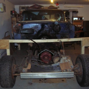

    So I got the last half of the smugglers compartment floor in. A couple little patches and the trans tunnel and that’s done.

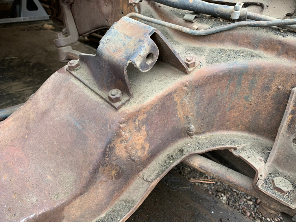

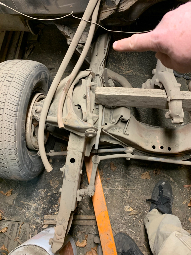

    I’ve been staring at the frame and cowl and things just haven’t looked right. The car has never had matching tires on it so I’ve been thinking that was the reason things looked crooked. The frame horns ahead of the crossmember are clean and I couldn’t find any damage until I finally noticed this kink on the passenger side right by the firewall.
    They must have jumped the fucking thing or hit a curb hard.
    I feel blind not seeing that before. I’ve looked and looked for damage. I put the back of the car on jackstands and got everything dead nuts level and then check the front side to side. The passenger side is a thumb knuckle higher than the drivers. Factory tolerance is 3/16”.
    I’ve either got to get this frame straightened or buy a parts car and just swap it out. I know of a couple cars I could buy, but then I’d have another rig at my house junking up the place. My buddy strongly feels that I should be shopping for a 4x4 chassis, but I don’t think I could do that to a first gen El Camino.

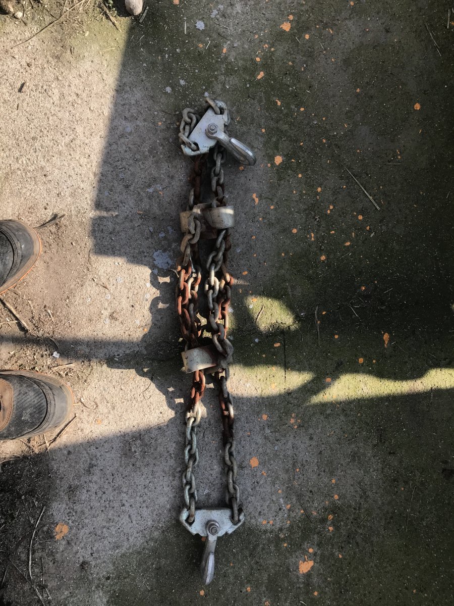

    I know how that is. I have a frame-chain thing that was used for straightening frames, I’ll round it up and send you a pic, might or might not work for your needs.
    Heck, didn’t think I’d find it that quick

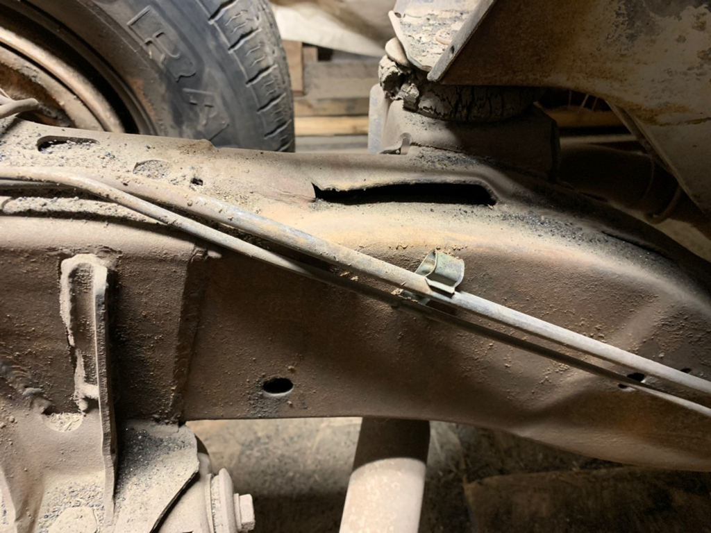

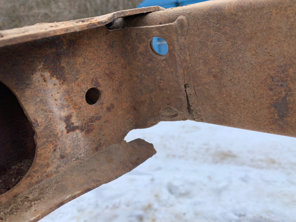

    So this happened.
    The frame is twisted, torn, cut, and welded. I’m not having happy feelings about this frame.

    Good move.

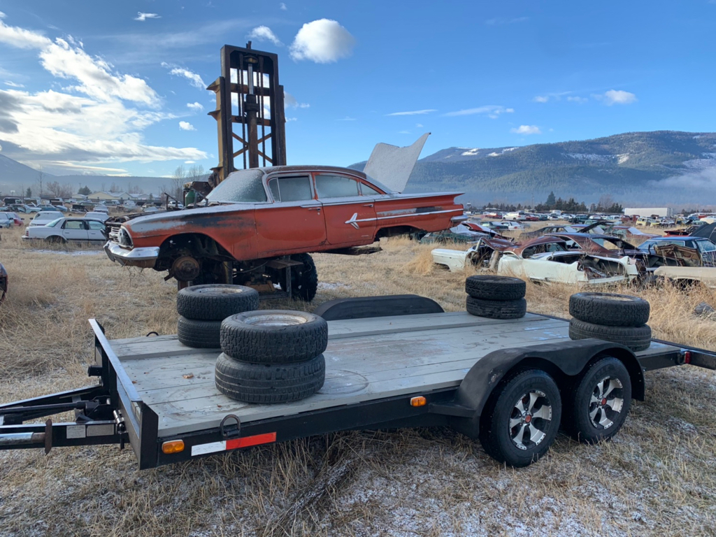

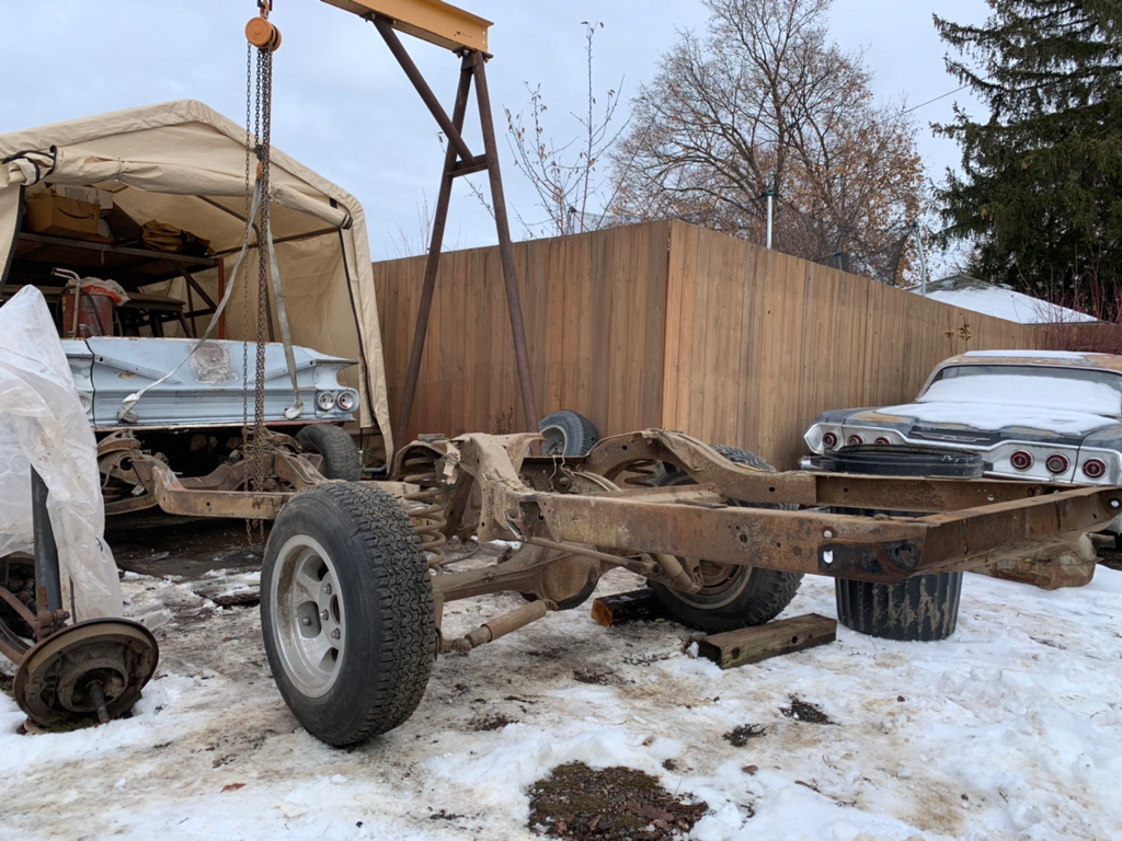

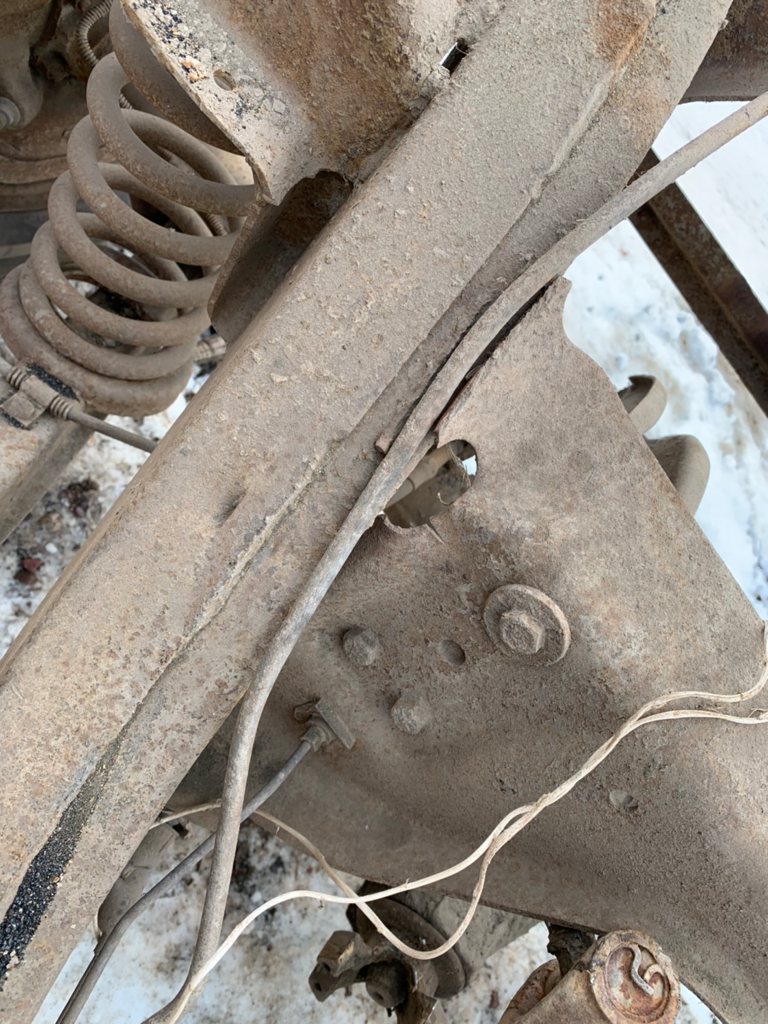

    It’s frame harvesting season. Luckily, my buddy and his uncle with an excavator were around to help. The junkyard guy has a pretty badass old Chevy V8 powered forklift too.
    We (I) missed the parking brake cable and when it broke as the excavator rotated that body started spinning and bobbing. I nearly had to buy a Subaru. Missed it by 3”.
    Not bad for a Saturday.

    So you just need to convince Lloyd that his Gasser Camino needs a nice 2x4 rectangular tubing front clip for the straight axle conversion and he needs to donate that heavy old factory stuff to your project.
