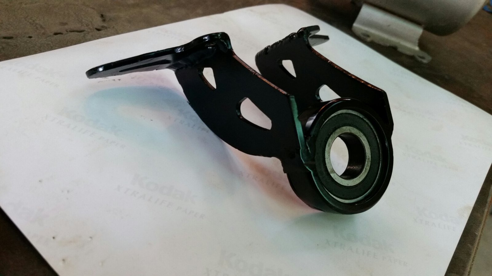

    Lower shaft bearing support

  12. Lower steering wheel bearing.

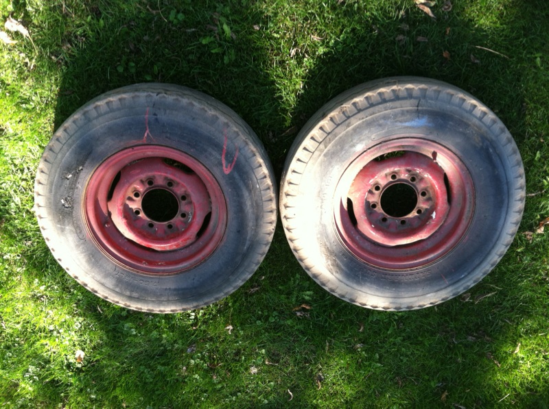

    @iwanaflattie IMG_8082.jpg IMG_8083.jpg IMG_8084.jpg IMG_1275.jpg I think I have 3 of the 16x6 non-split rim wheels that you need, Only problem is I'm in Iowa.
    Did you solve your wheel problem? Am I too late to Help?
    Thanks Jeff
    volvobrynk likes this.
