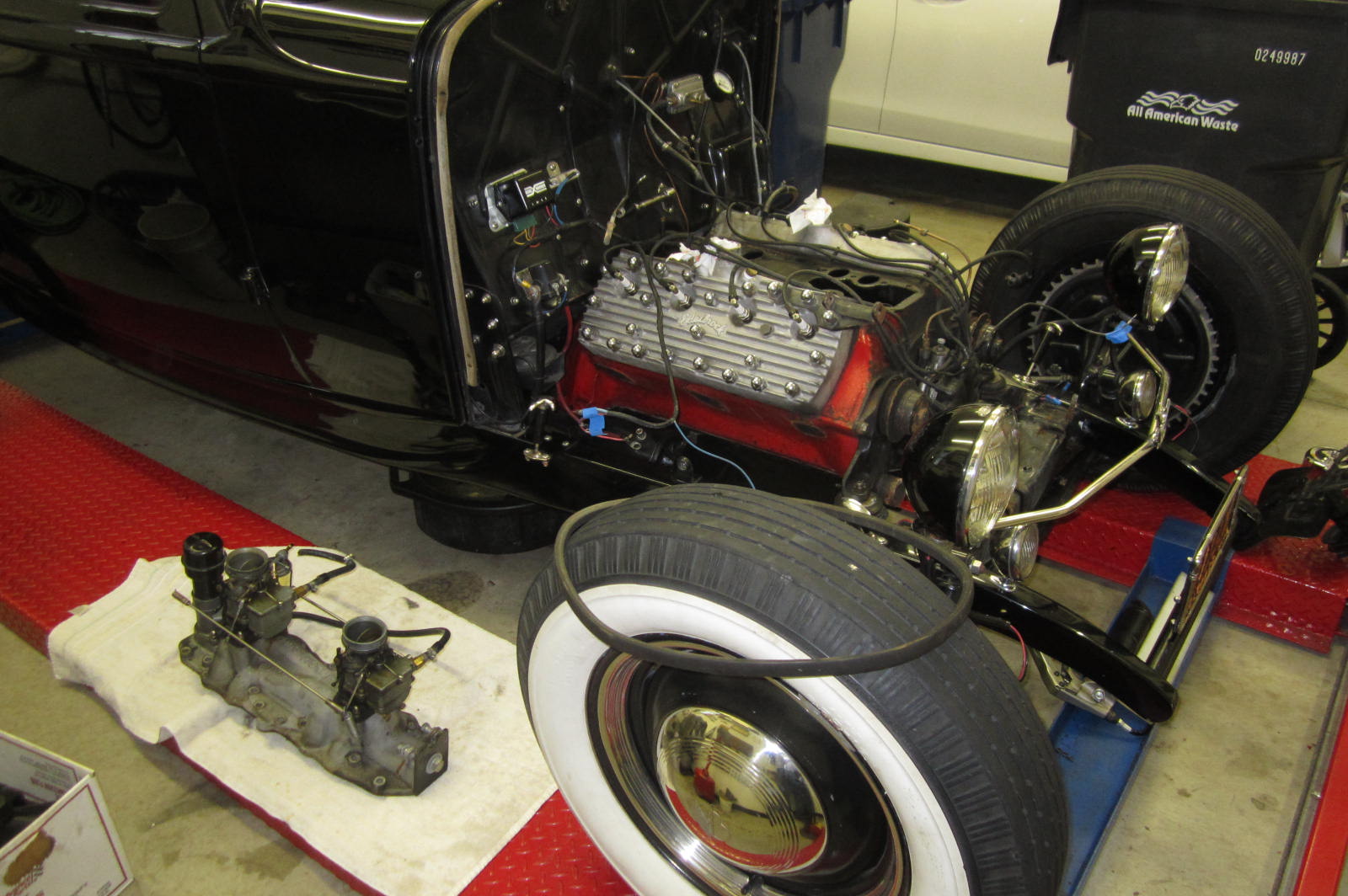

  1. Well I looked out the window this morning and snow was on the ground.:( Anyway I guess it means it is time to start taking the Coupe apart for some mechanical rebuilding. This car has been pretty much just used for many years and found it's way to me.:cool: Well I am not one to leave things alone. :eek:I will leave the patina and the components that were used for the original build. But the guts of the motor, transmission and rear end will get some needed attention. Also things like the radiator that needs some repairs and anything else along the way. So this Thread will not be too exciting. The goal is to have the car look as it did when I started but have me feel better about using it as a daily driver:cool: Now if I can follow my own plan and not do a total restoration I will have succeeded.:rolleyes: I did find some interesting things already. Like the piece of metal floating around in the top radiator tank:confused: And some cutouts in the front cross member for clearance (I guess). And some interesting objects in the oil pan:eek: I am sure there will be more surprises along the way. I will try and keep you posted.:cool:

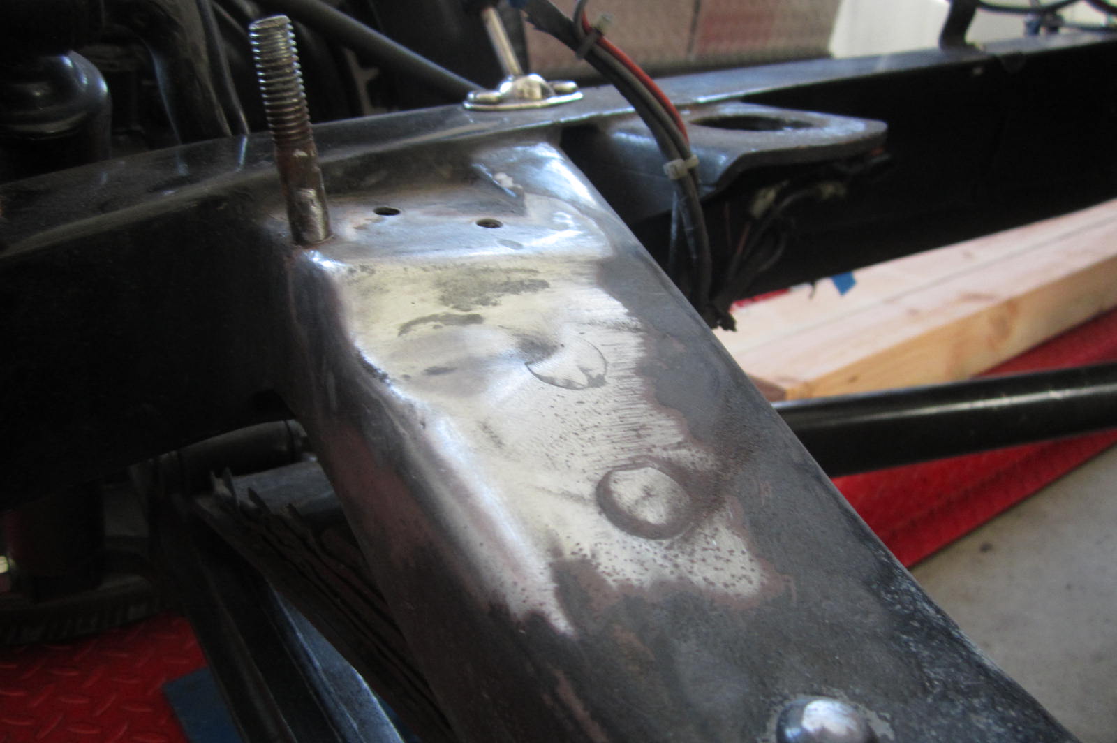

    This will be fun to watch. Those notches in the crossmember are weird, huh. Hope you don't run into too many surprises.

  7. Looks like they were for radiator clearance. If that is what I determine I will weld a plate underneath and finish it off as an indentation instead of a hole.

    Great winter project Mark, I'm sure that front crossmember will look better after some TIG time. Bob

  24. Well today I got the motor just about ready to take out. :cool:This past week was busy so have not had any time until today. Should get motor on the ground this week. :DNo big surprises so far. I told you this would not be that exciting.:rolleyes:

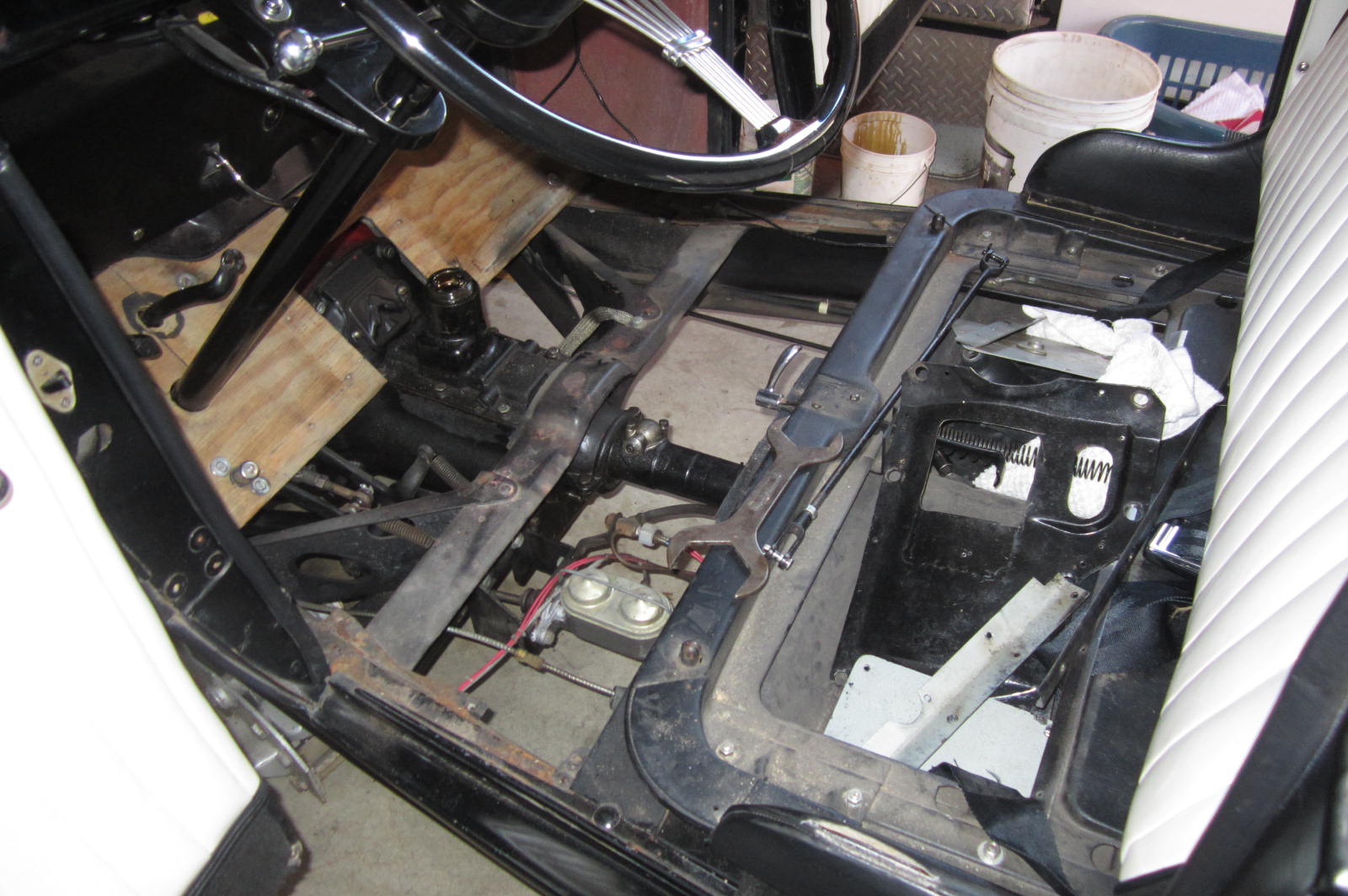

  26. Motor and Trans out today! Thanks to tb33anda3rd and Tater for lending a hand.:cool:
  27. Did the front cross member. It had been cut for radiator clearance back in the day.:confused: I ended up redoing it. It now clears but without the hacked holes.:cool: Pulling the rear next!:eek:

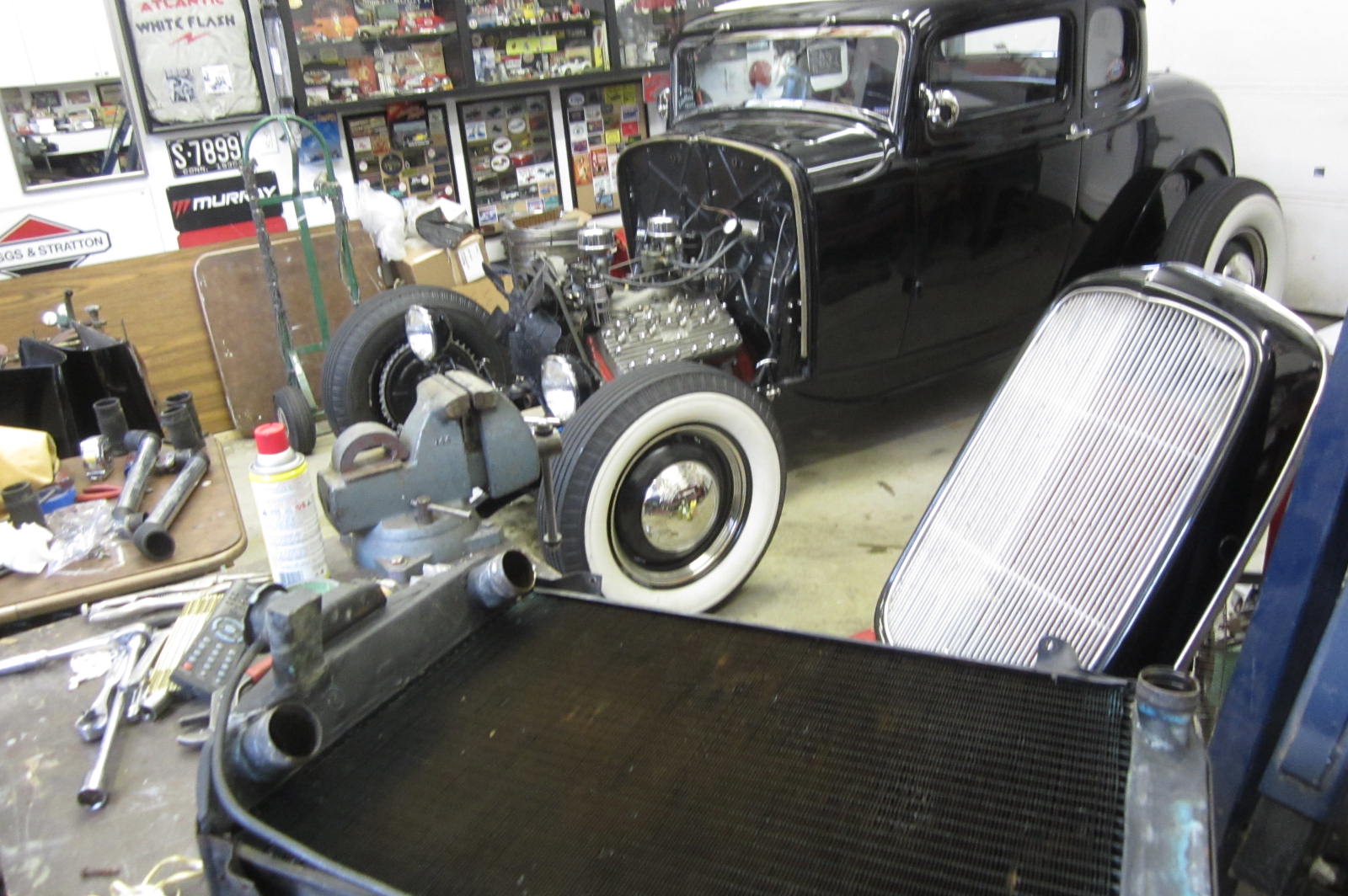

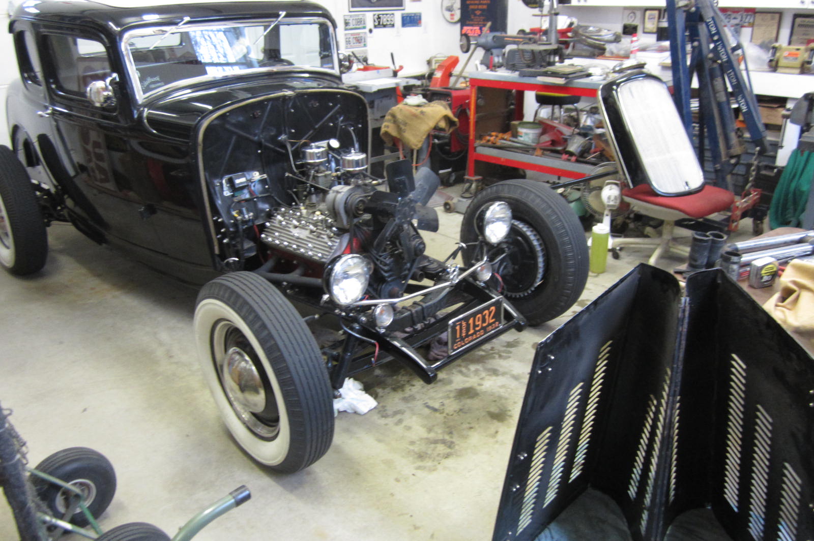

  28. Got the Coupe blocked up to take front and rear out next.:cool: Now I can give the wheels and tires back that I borrowed. If I can remember who loaned them to me!:confused:
