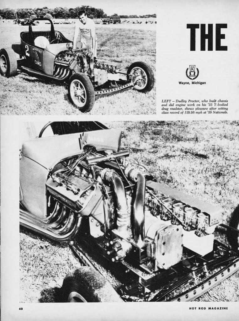

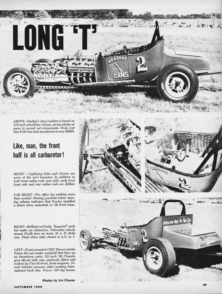

    The Buntline Special ran A/Modified Roadster in 1959 and 1960. The car was run by Dudley Proctor. It had a 1956 Chrysler 331 hemi with a front mounted Potvin blower and 6 Stromberg 48 carbs. It set the A/MR speed record at the 1959 NHRA Nationals at 139.98 MPH. In 1959 it had a steel body, then in 1960 they put a glass body on it. I will be recreating the 1960 car because there are still parts left over from the car.
    I got my first part the other day. I got a frame for the car from Chassisresearchkid. This car will be very cool when its done, but its going to be a very long time. Below is an article from Hot Rod Magazine of the 1959 car. Matt

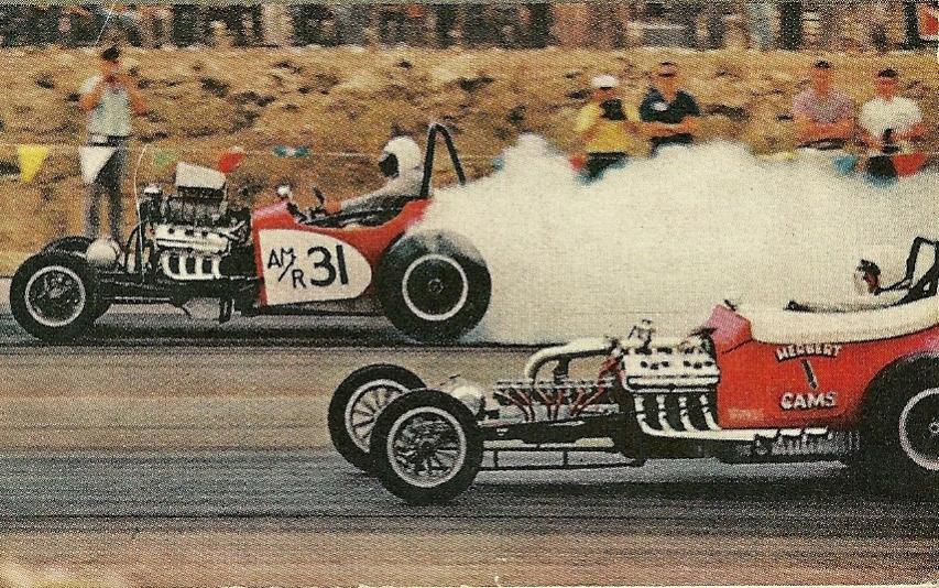

    I figured I would update the build thread. I got some more parts. I now have a front axle, batwings, gauge, and spindles! Chassisresearchkid is going to help me start on my front axle (slotting it). I can't wait to start! Here is a picture of the 1960 car from Hot Rod magazine. Matt
