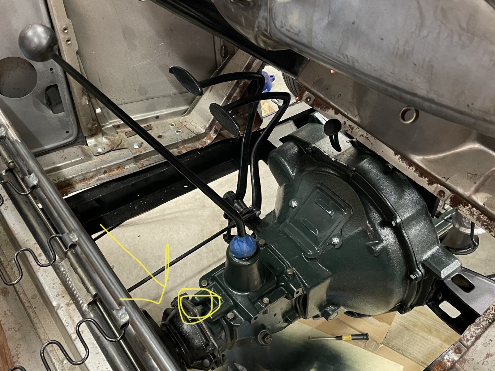

  6. Yea, those front U joint grease fittings go under the car. To make sure you get enough grease in it remove the speedometer cable and when it starts coming out there is enough. Not getting it full enough will shorten the life of the U joint very quickly.

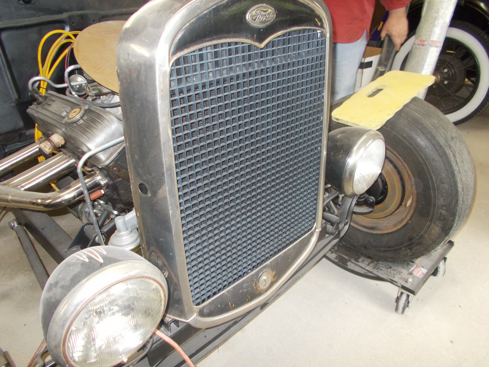

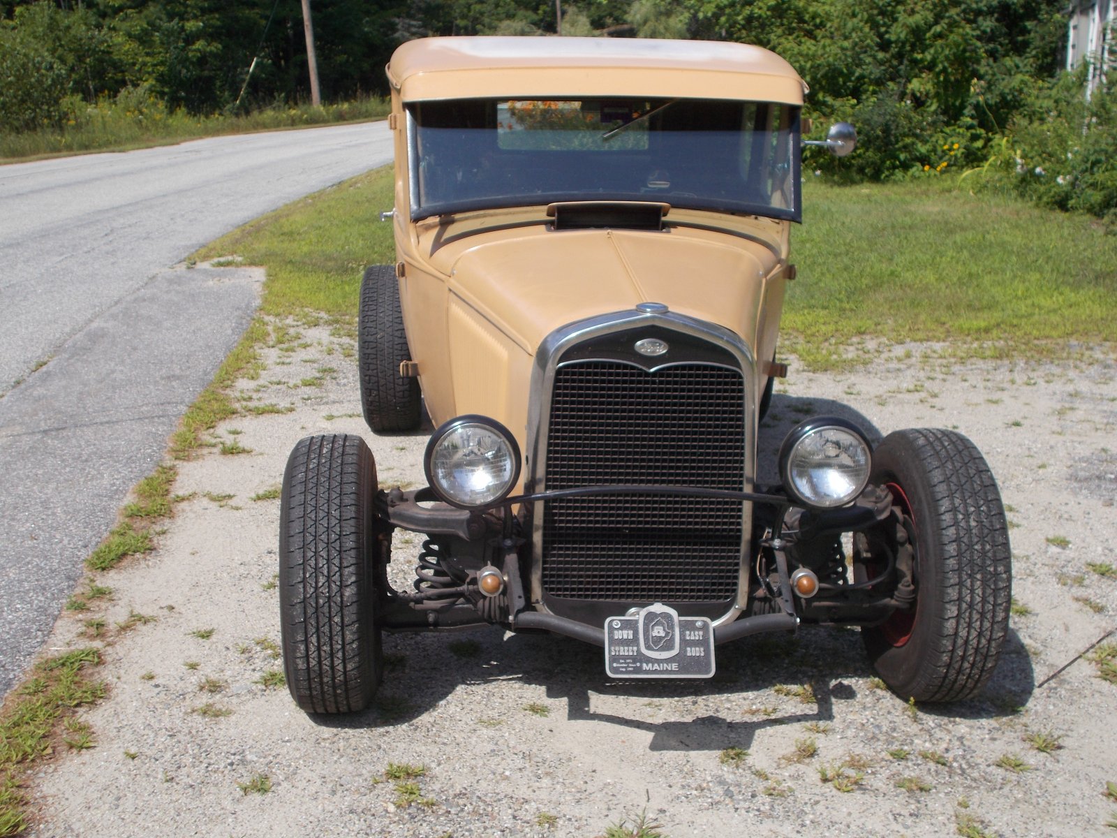

  16. sloppy jalopies
    Joined: Jun 29, 2015
    Posts: 5,256
    sloppy jalopies

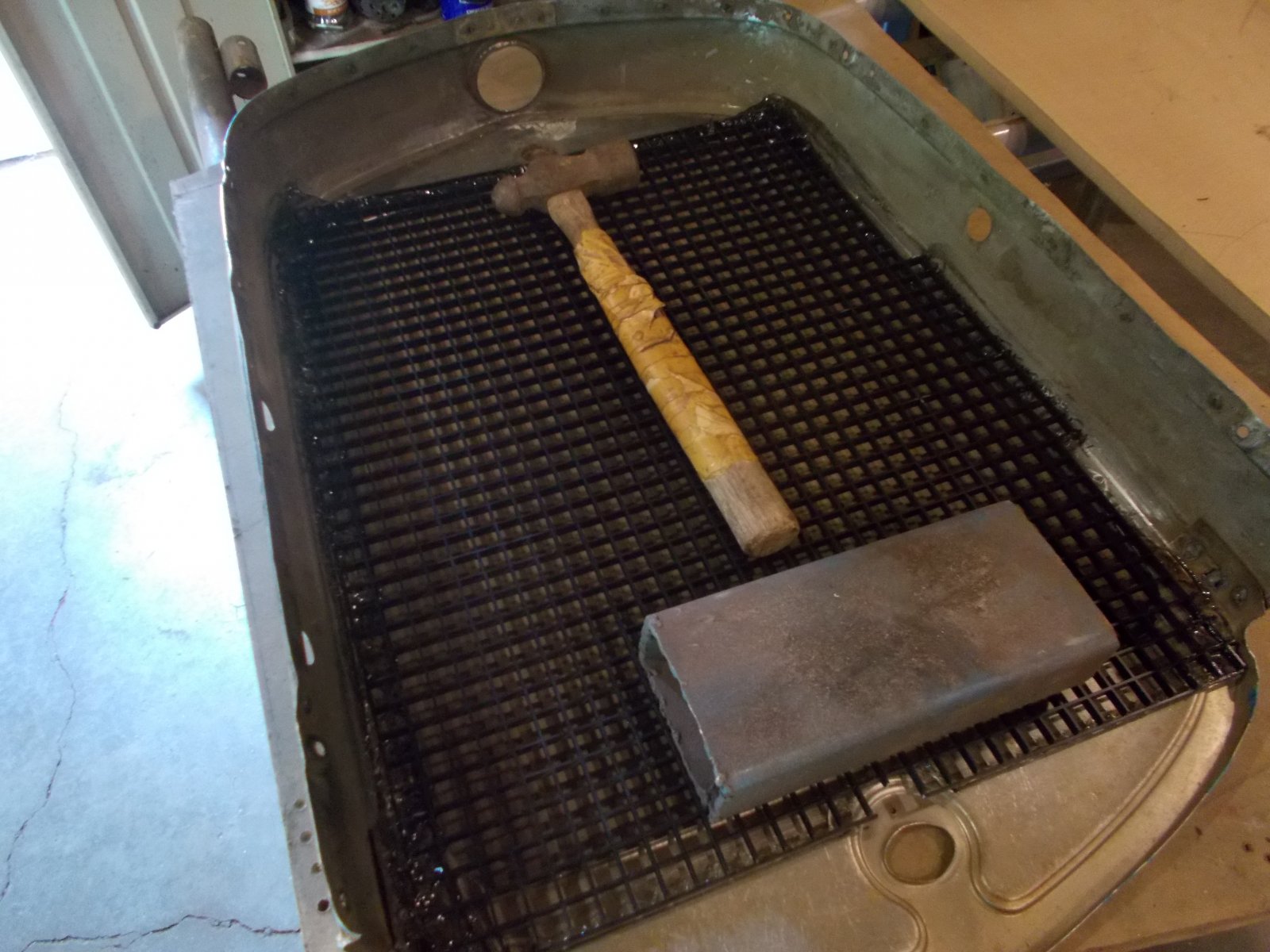

    stole a buddy's idea, he trims the plastic "square grid" light defusers from 4' florescent lights...
    $13 at lowes... it will set the radiator back about 1/2 inch...
    adds some protection and doesn't show much...
    grey one is a buddy's son's... black one with a '31 top + '30 bottom is mine...
    used silicone to anchor it inside the shell...

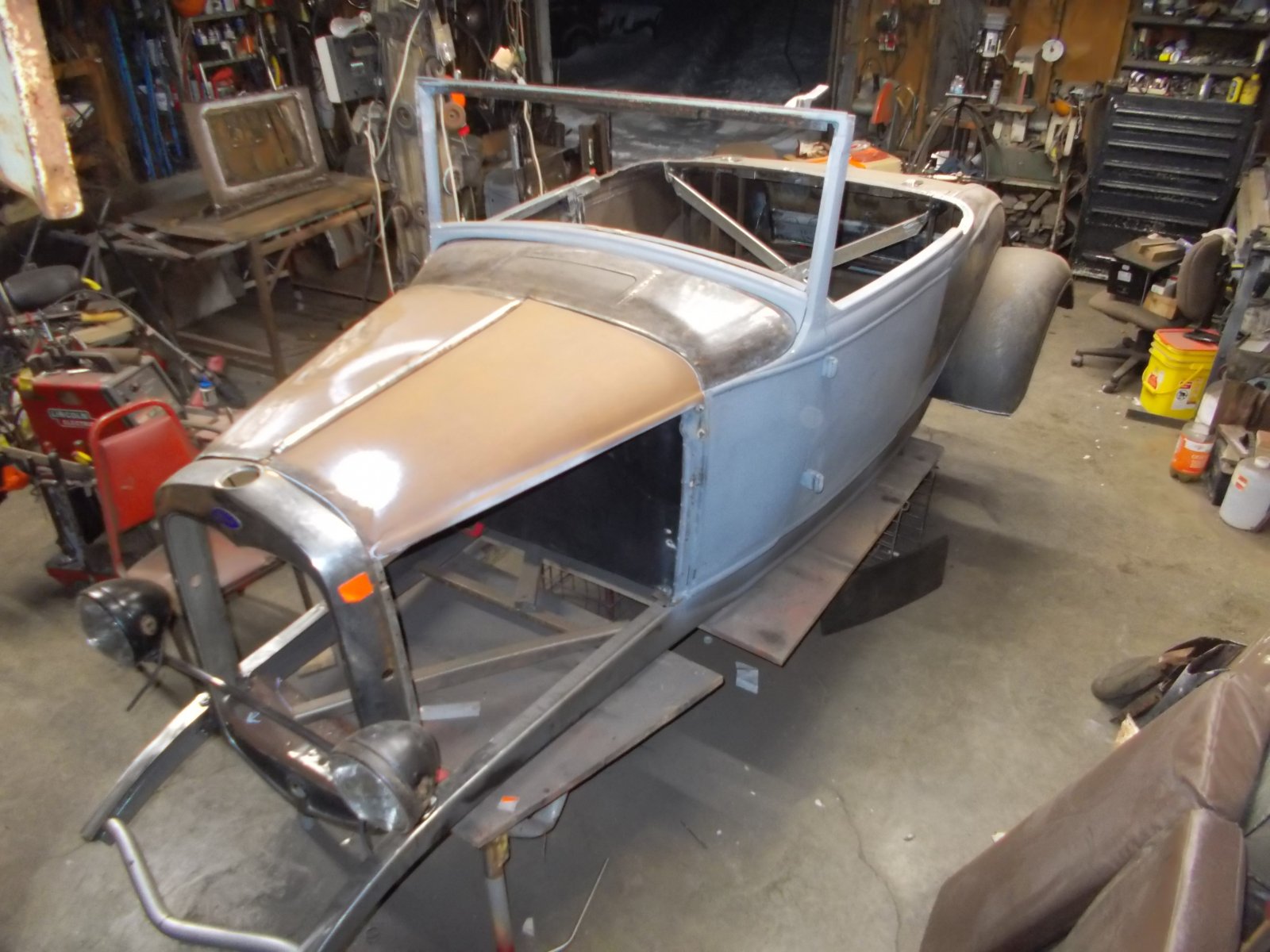

  21. sloppy jalopies
    Posts: 5,256
    sloppy jalopies
    check out the hoodside molding on a '46-'47 truck...
    i downsized one to run down the center on my '30 one pce hood...
    made the hood top from the same '46-'47 comm. hood... cut both top halves about 3/4" too long then bent 3/4" 90* on each side for a piano hinge later ?.. feb 23.JPG

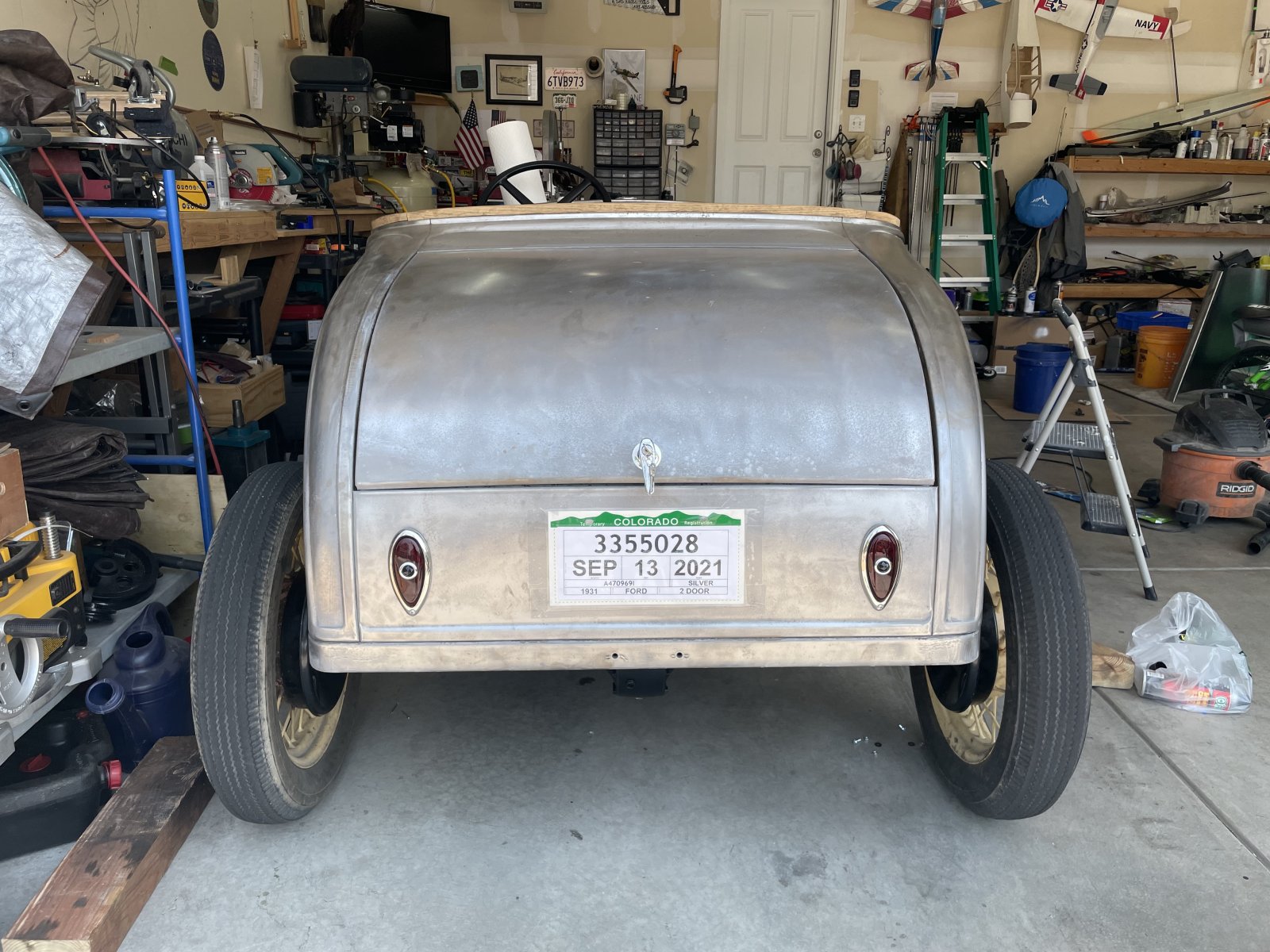

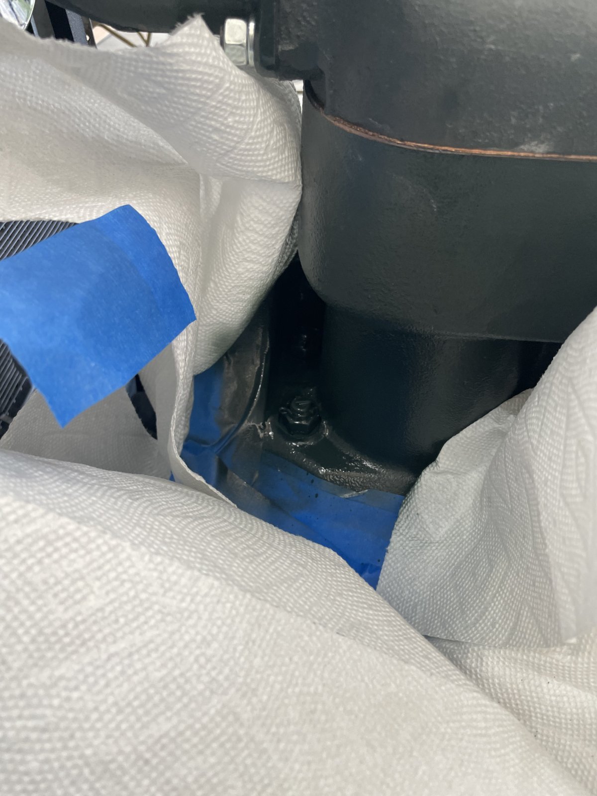

    welp, I’m barely legal. Got the temporary tags while I jump through all the legal hoops to get official plates.

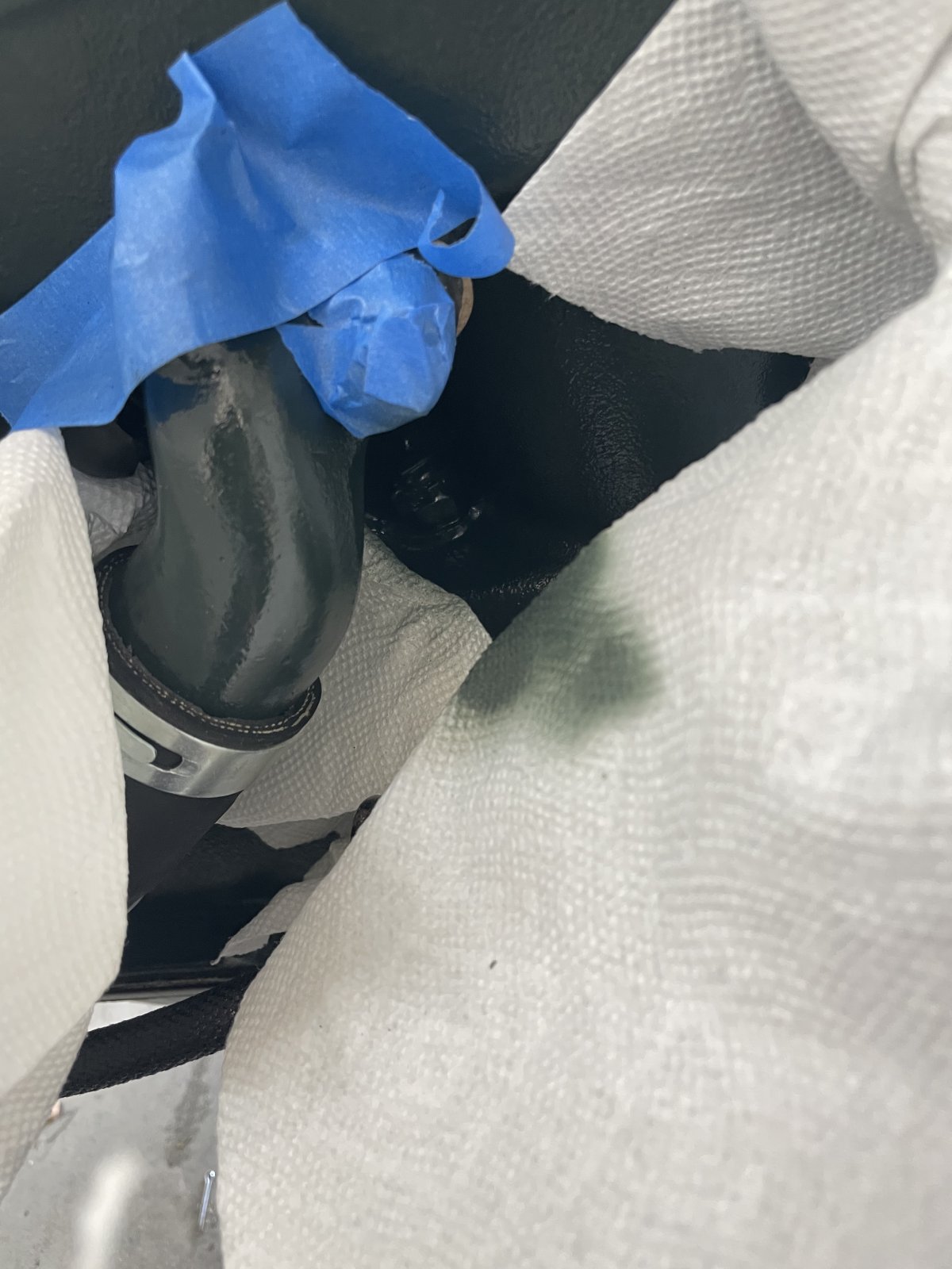

    Issue: the crank bearing cap studs that extend out of the top of the block are leaking oil like mad. Warmed up the car and shot a ton of brake clean to get the paint off around the studs/nuts and then blasted the area with isopropyl alcohol and air to remove paint and oil residue. I’m now currently saturating the area with a butt-load of engine paint in hopes of sealing the leak in from the outside. Not sure if it’ll work but it’s a hell of a lot easier than pulling the pan. Tried to get a socket on there to remove the nuts first but soon realized there would be no good way to torque the castle nuts back on. Let’s hope it works. 82C39084-CEB5-4726-92A2-3CB625F4AB02.jpeg 54A65013-8C7A-4BC7-B02C-25E3F8F6007F.jpeg 7F18E1E0-59ED-474D-B66D-B7BC7D011F07.jpeg

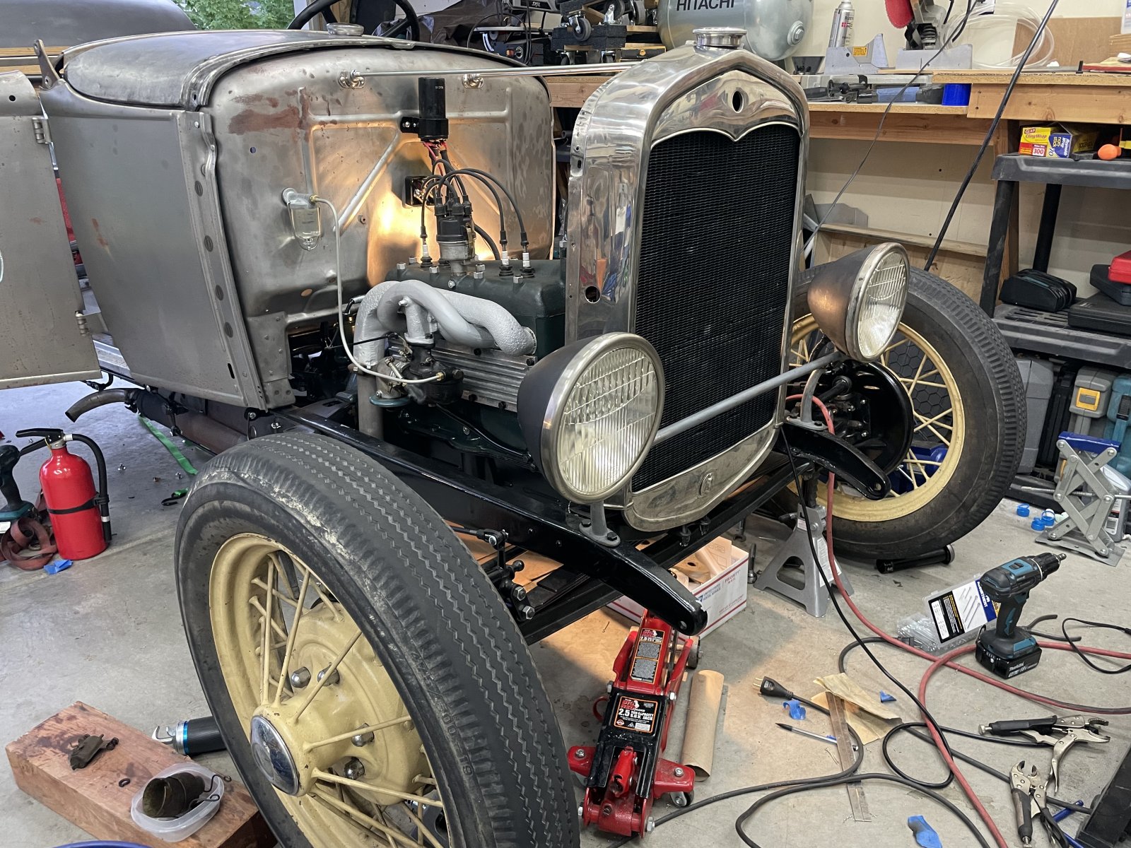

  30. LostInOC
    Joined: Aug 5, 2009
    Posts: 179
    LostInOC

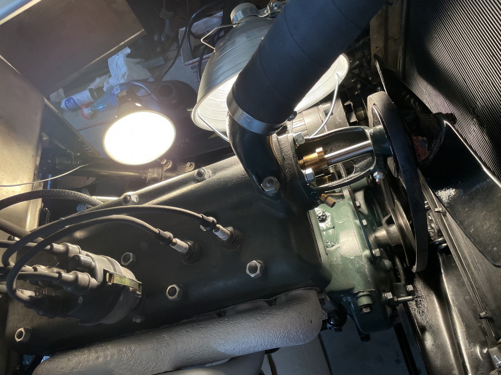

    Let there be light!
    Always liked the larger 29 lights, so what the heck. Tim over at Bert’s gave me the idea for the light mount. It’s a 28-29 bar with the end mounts cut off and bolted to the frame. The crossbar then gets welded back to the ends. I put a gentle arc in the crossbar just to spice things up and somewhat match some of the curves of the body.
