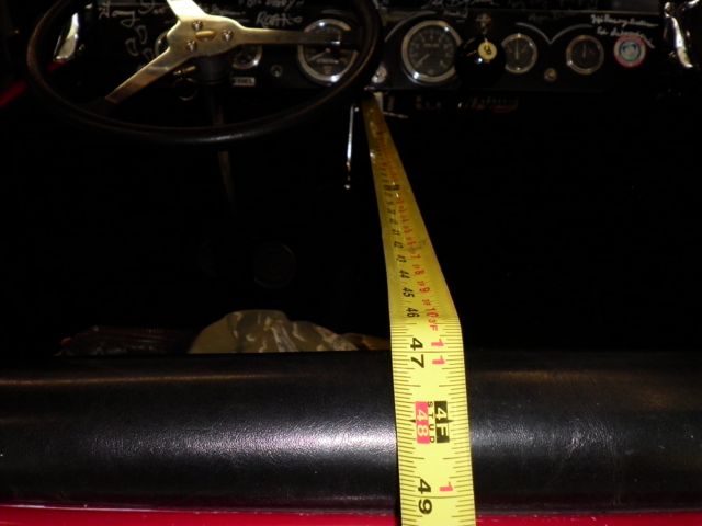

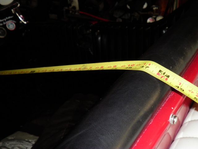

    Looking at the picture of Buddy Holley and Chumley sitting in your roadster (Damn you'll just let anybody drive your roadster) they seem to have plenty of leg room. I've often wondered if there is more room in a roadster than the front of a touring car. I measured mine from the the firewall to the back of the body just under the dash and it and without the height of the backrest padding it seems to measure 48". Take away the 3/4" plywood and carpet thickness behind the firewall on mine that measurement would be about 49". You say your body is a direct unaltered copy of a 25 T. I was wondering what the difference is. Then I guess I need to find out if an early T body is shorter than a 23 and later. This is the kind of shit that is important to me. Maybe I need to get a life. Anyway if you would measure yours it would be interesting to see what you come up with.

    Rebel, that's what mine is, 49" and probably most glass 23's. The height from the lower edge of the body, to the top of the door/body edge is 22". From the bottom edge to the top rear of the body is 28". To the top edge of the dash/cowl is 24".
    Also, looking at Louvers pic, I sit damn near the same, except I'm a little lower in the back. When he installs a webbed seat bottom, he'll sit a little lower too.

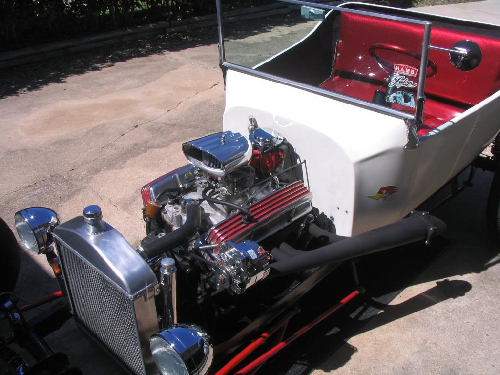

    That's a good spot, keep. I like my stem, but in the pics, louvers looked better. I broke the glass in my mirror putting the new engine in. PLEASE! Don't ask. Anyway, as a quick fix, I double sided taped an auto parts store mirror over the cracked one. It's working for now, but I'm looking to replace it before the weather gets good.
    The replacement mirror I have stuck in place is one of those optical lenses that lets me see EVERYTHING on the side AND behind. But it's just a temp thing and kind of goofy looking.
    Here's mine. It's in about the same spot.

    mine are in the same place, they work really well there.

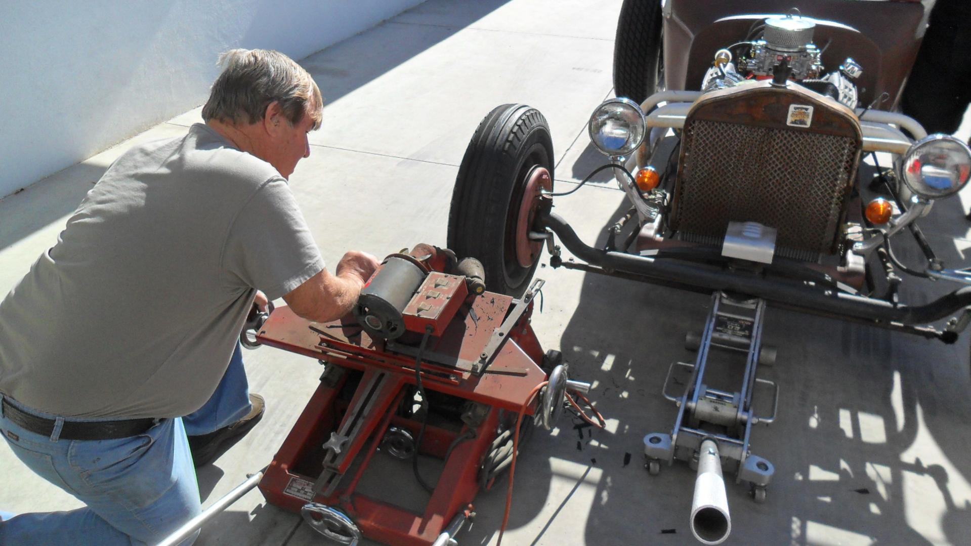

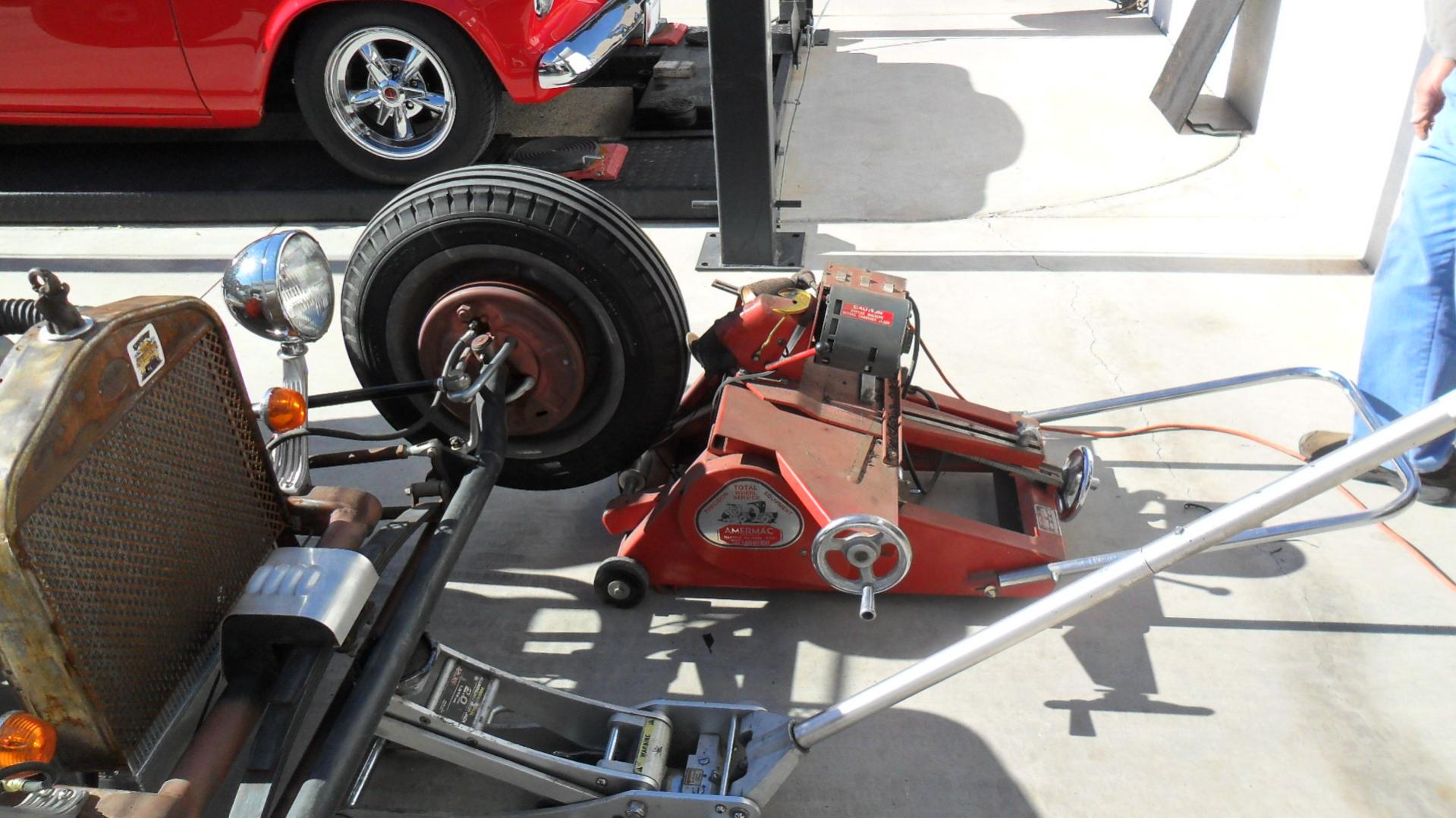

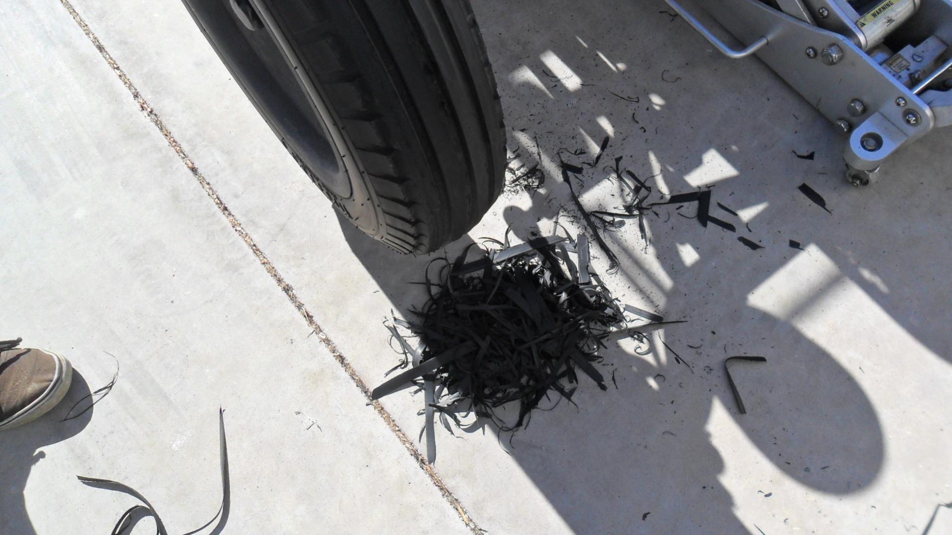

    After the bike swap, fellow H.A.M.B.er Nick Flores and I along with Bodi paid a visit too Paige from Astro Auto Body. Paige owns one of the only tire truing machines in Arizona, and graciously allowed me to cruise by his place on a Sunday. See, something I haven't shared with you guys is the fact that my "temporary" Firestones and Halibrands are ultra cool and all, but not exactly round. This solved my woes!

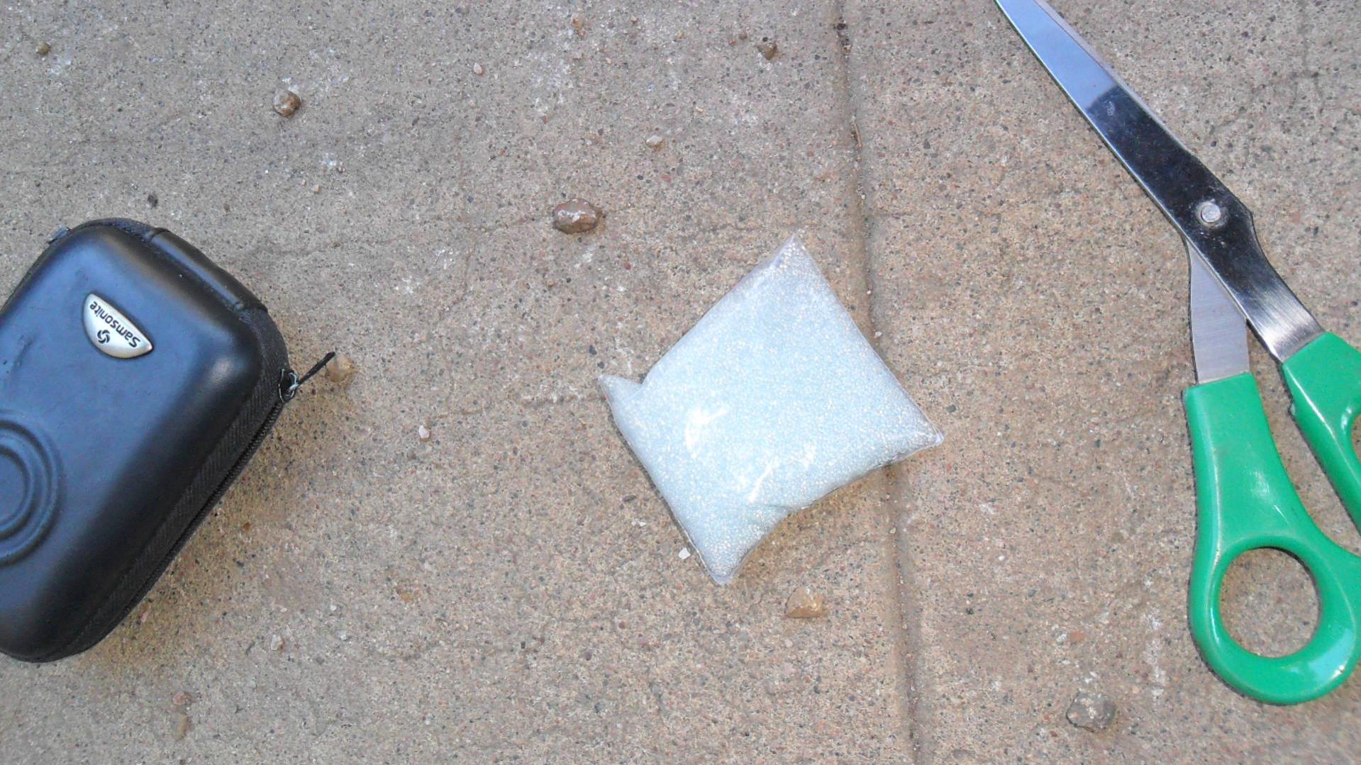

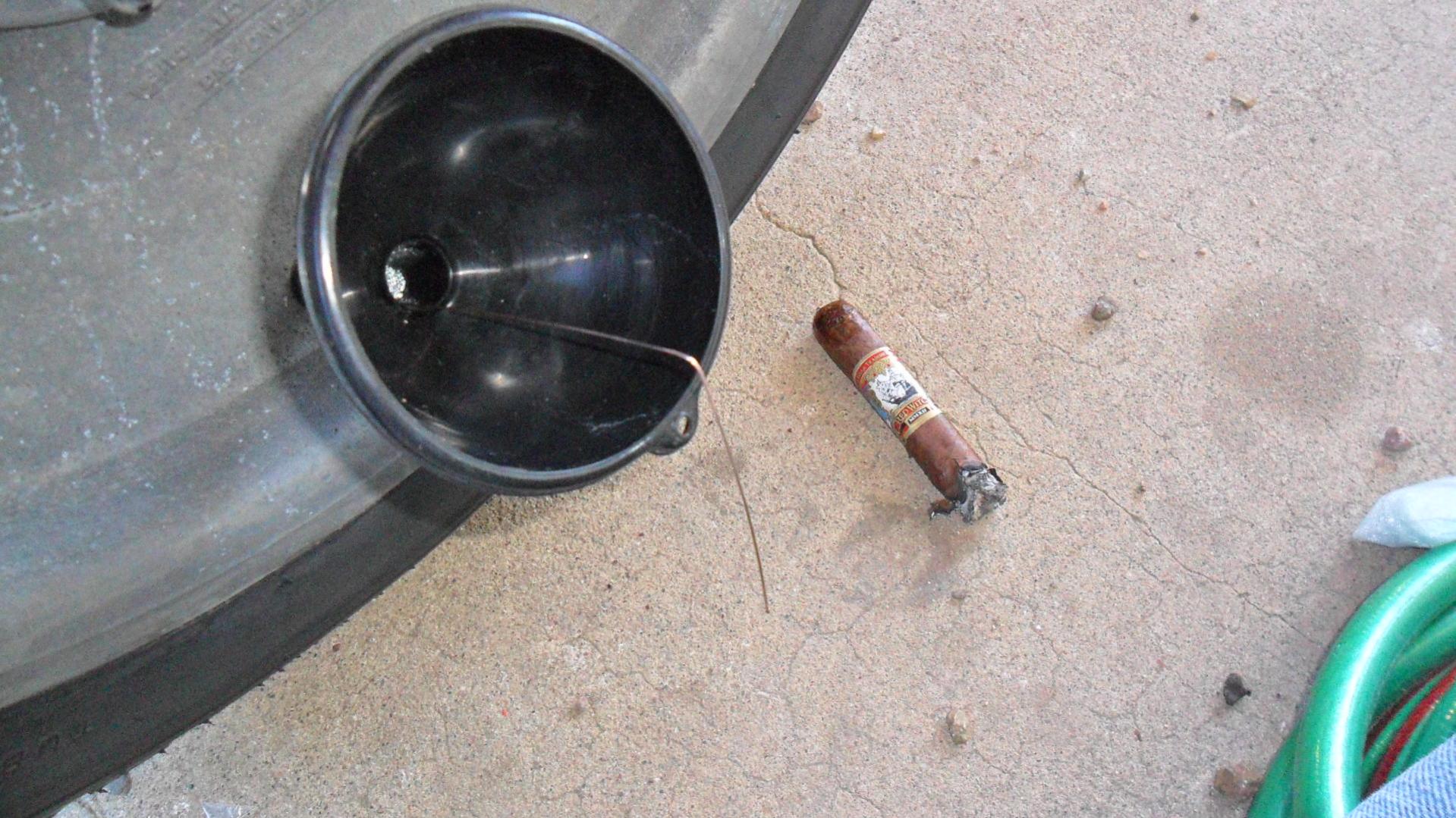

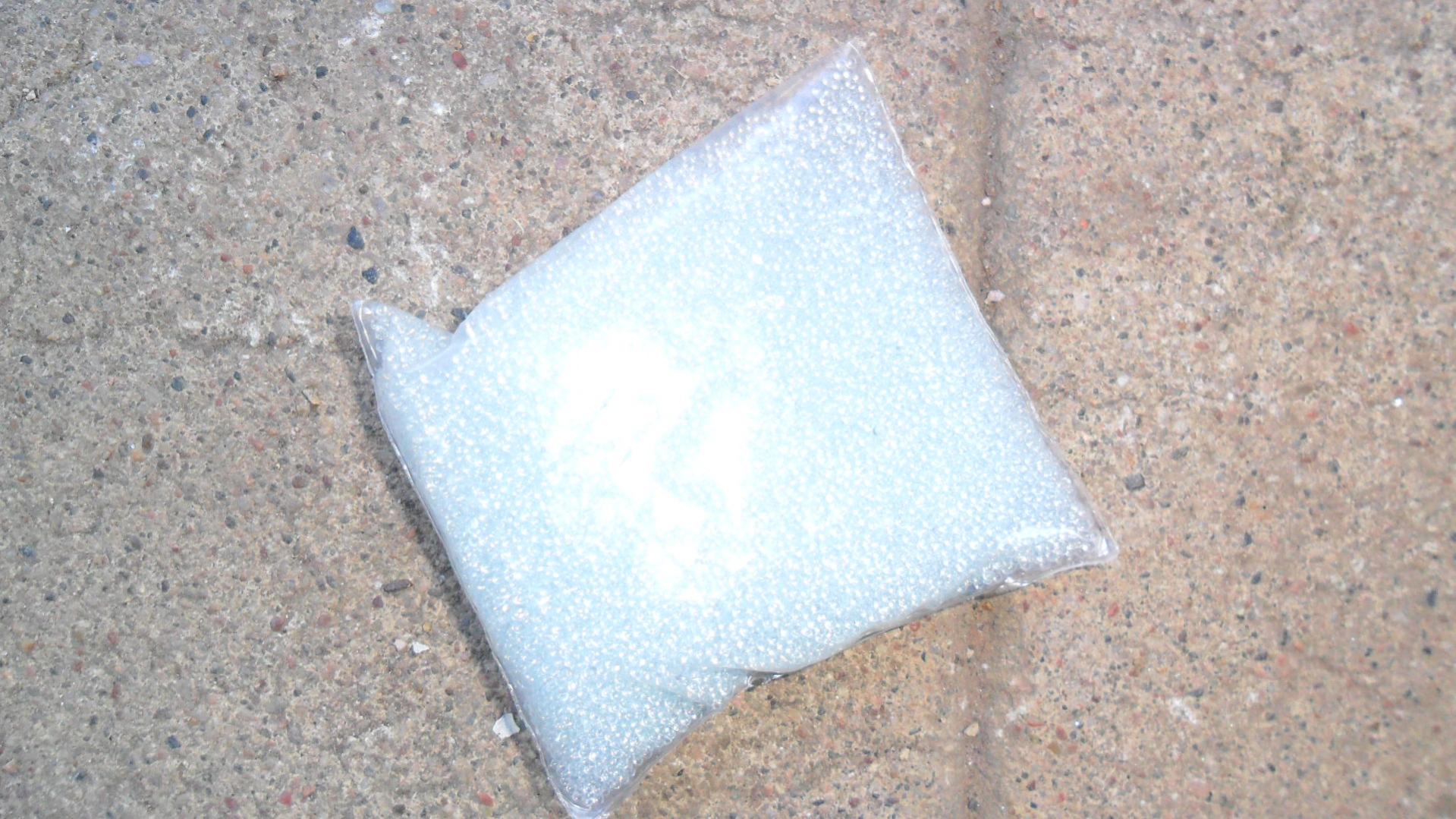

    Just to be sure, I stopped off at Ramjett Racing and grabbed some Dynabeads. If you haven't used these yet, they are awesome! They are a bit of a pain in the ass to install but I have found a method that works very well for me. First, you go to the dollar store and get a 1.00 set of plastic funnels. The smallest will just thread itself over the stem. Pull the valve stem out, thread the funnel over and start pouring... If it clogs, stick wire down and work it. About ten minutes per wheel and life is better!
