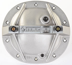

    Yer killin' me with that diff cover...
    C'mon you don't really need to eat this week, use the $ to get that thing replaced!

    Easy, man.:) This is the cover I'm going with. It's a little pricey, but I like it, so I'm saving for it. I hope it meets your approval.:rolleyes::D

  12. Meets mine Fred.:cool::) JW

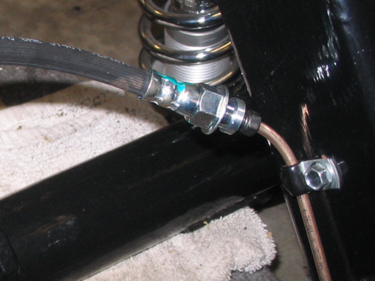

    tfeverfred, I wouldn't be too happy with the way the rear brake flexible is mounted at the frame end. Sure the brake tube is secured fairly close to the flexible but i think that flexible will work that tube over time. Seems an odd way of doing it when the flexible itself has the means of mounting securely. I bought a 41 Chevy Coupe last year that was done that way, including the fronts - i put that on the list of little things to do. Ended up a fairly long list, but didn't take too long to sort out, and i'm a lot happier with it all done.

    :D Hi Fred.Not only looks good,but love the fill/check lube level and drain plugs.

    I did my last T Bucket in basically the same manner. It lasted 5 years and is probably still working for the new owner. It's secure enough. Thanks.

    Those are the reasons I chose it.:)
  18. a boner
    Joined: Dec 25, 2004
    Posts: 4,057
    a boner
    ^^^^THIS FOR SURE!
    The end of the rubber flexible brake line should be solidly mounted to the chassis, and then the hard brake line can be joined to it. That 1" long unsupported end of the hard brake line is going to flex otherwise.

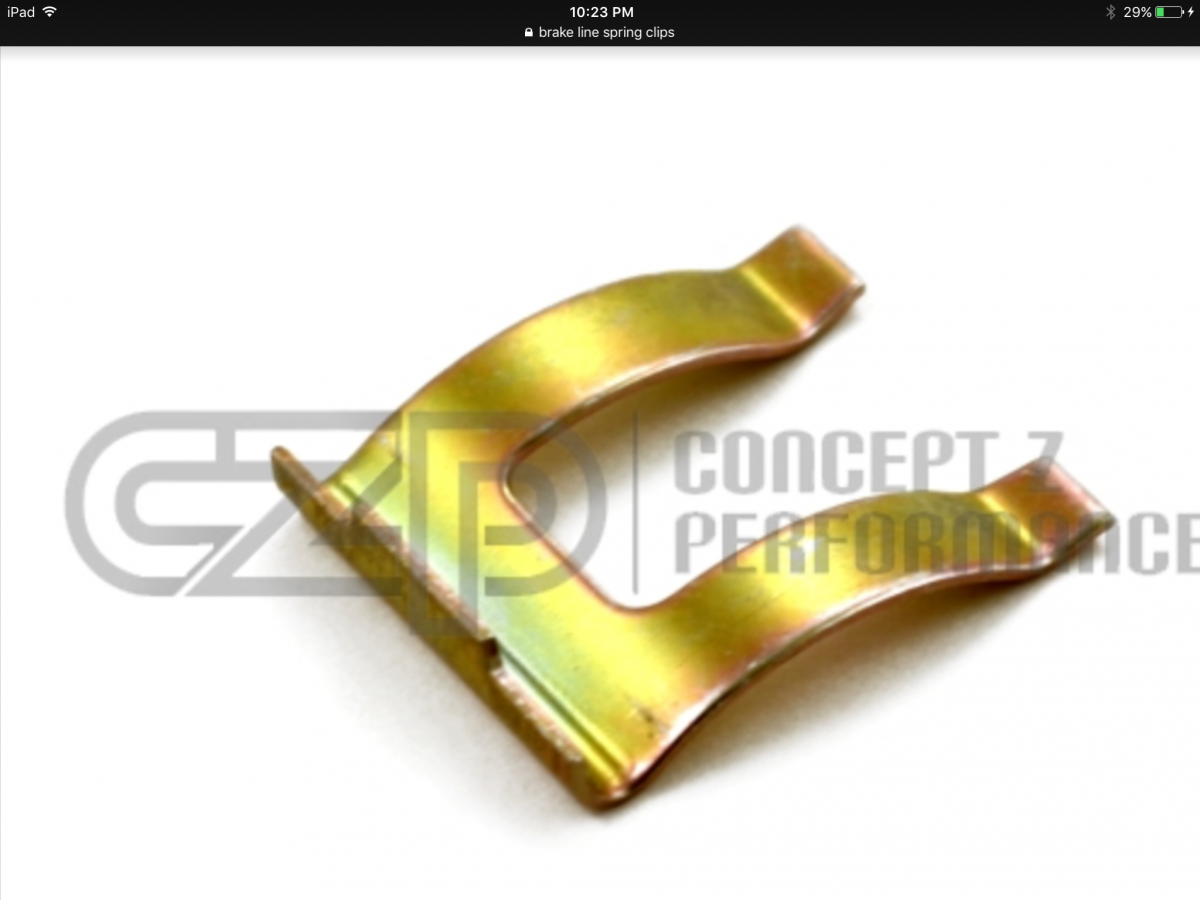

    image.png The end of your flexible hose is designed to use this type of clip to fasten it to a simple bracket with a hole in it. Do it, and I'll sleep better!

  21. tfeverfred
    Joined: Nov 11, 2006
    Posts: 15,550
    tfeverfred
    Yea, I have some of those and the frame brackets. I'll consider it.
  22. tfeverfred
    Posts: 15,550
    tfeverfred
    Better? Now....... sleep well, sir.:D

  24. tfeverfred
    Posts: 15,550
    tfeverfred
    I have to admit, it does look better.

  25. a boner
    Posts: 4,057
    a boner
    Looks perfect! Sweet dreams.
