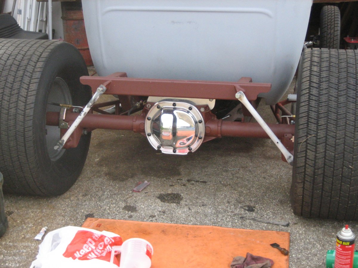

    Well, finally, I can make an update of sorts. The tax man came through and rear coil over shocks are on the way. I went with 165 lb. springs. They should be in my grubby hands Monday or Tuesday. They're adjustable, but I won't know how they ride, until that first or second drive.
    It feels really good to be back to making progress.

    Installed my rear shocks today! Man, I love progress. My next step is to save the coin for wheels and tires.

  26. Fred, those coilovers are much nicer than the ones I mentioned - good choice!
    Steve
