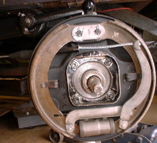

    The brake problems, were the rigid lines on the wisbone in the rear part of the problem? Doesn't the rear go up and down? Why no brake hoses to the backing plates? I'm just curious if I see something.

    The car has the stock Model A closed driveshaft and banjo, so the whole rear moves with the radius rods. The motion is all at the u-joint socket on the rear of the trans. I have a flex line there that connects the hard rear lines to the back of the model A crossmember (see pix above).
    I think the problem was that that I didn't center the shoes when I readjusted them after I had the drums off to put in the bearings and keys. I noticed that the parking brake seemed to have alot less stroke than when I adjusted it too, so I bet that's it. Kinda spokey that you can have no pedal with poorly adjusted rear brakes. I probably need to check the fronts too now that I have 5 miles or so on the car.

    What did you need to do to make those hydraulic brakes work on the model A rear end ? (besides putting them upside down )
    I am planning on using my model A rear in my own A/V8 project myself ...
    thanks ,
  27. gashog
    Joined: Dec 9, 2005
    Posts: 978
    gashog
    Thanks for all the compliments!
    The rear brakes are the later 46-48 partial floating style. Although the backing plates are installed on opposite sides, the cylinders remain on their original sides to keep the big bores on the main shoes. You'll need to drill a couple extra holes to mount them on the upside-down backing plates.
    You have a couple choices on how to correct for the shorter axle length on the early banjo. Some guys machine the backing plate mounting flanges for the clearance needed between the drums and backing plates. I just zipped about an 1/8" off the outer lip of the backing plates and the inner lips of the drums with a cutting wheel on my die grinder.
    Finally, you need to put about a 1/4" wide chamfer on the outer edge of the linings so they don't rub on the inside of the drums.

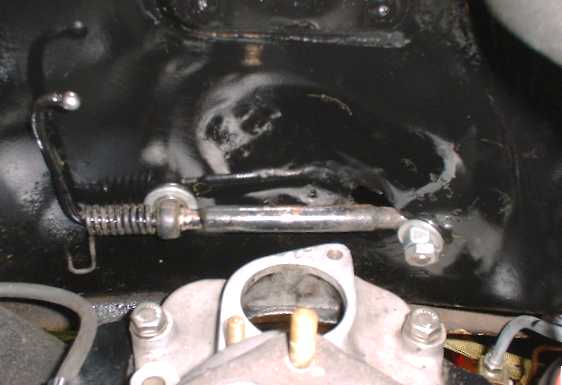

    A couple more detail shots including the stock Model A steering box, the generator mount I made up to use with the Edelbrock racing super dual, the spoon pedal & a shot of the way the car was when I bought it for grins :)
