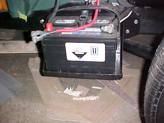

    Hoping to get some time on Saturday to reroute some wires and take care of fuel fittings, installing an electric fuel pump, and trying to figure out where in the heck I'm going to relocate the battery to.
    Any 40 pickup guys have any suggestions on that, I'd be interested to hear.
  24. primed34
    Joined: Feb 3, 2007
    Posts: 1,413
    primed34
    Put the battery inside the right front fender. Just me, but I would use a six blade fan.

  26. The 39 guy
    Joined: Nov 5, 2010
    Posts: 3,541
    The 39 guy
    Here are some pictures that olscrounger posted up for me a few years ago. He has used it on several 40's.
    LOU WELLS, warbird1 and bchrismer like this.
  27. That is a slick setup, but because I use this thing like a truck, I am wanting to mount it a little higher. 20170708_211013.jpg
    I'm going to put it behind the cab, under the bed. I will be able to access the battery posts through the opening here.
    It will bolt to the bed bracket at the top, the frame x member at the bottom, and I'll run a carriage bolt through the wood, up high for the back support.
