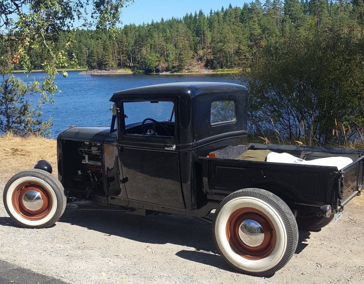

  2. OHV DeLuxe
    Joined: May 27, 2005
    Posts: 360
    OHV DeLuxe
    from Norway

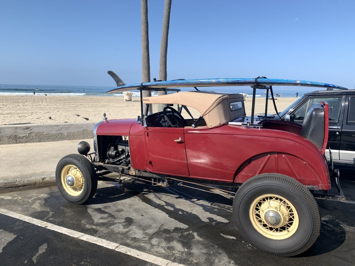

    1929 Model A Roadster
    Stock springs and ride height. 6 volt positive ground. Mechanical brakes. 1933 Diamond A block; B crank, Winfield SR B carb and matching intake, cast iron Winfield Yellow head, Winfield SU1R cam, B distributor, unknown 4 into 1 tube header. Windshield chopped 5 1/2” and laid back. Steering column dropped with 2 lower clamps inserted. Roof chopped 6” in the back. Seat lowered 6" and moved back 6”. 1935 Ford wire wheels. 6.00 & 7.50 Firestone’s. Guide 903J Headlights.
    Chopped and bent Model A headlight bar. Repurposed all vinyl and canvas from 1970's stock restoration. Rumble seat. Air Force surplus seatbelts. Model A brake cross shaft repurposed into a front spreader bar and license plate holder. Model A rear bumper bracket and cross bracket repurposed into a rear nerf bar. Surfboard racks, wrapped in 1/4” cotton cord.

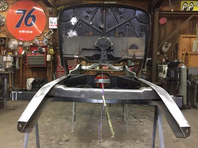

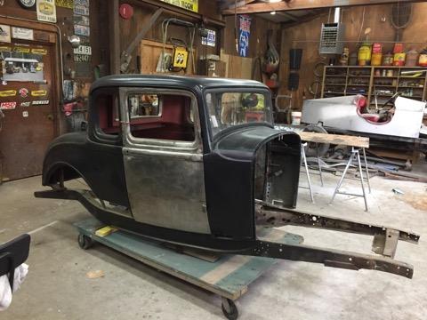

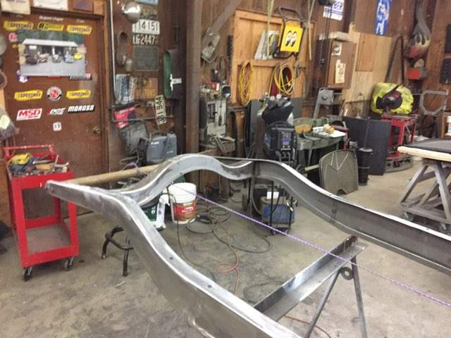

    E21DB79F-3CAC-4C67-AC0B-8F0A87146B08.jpeg E21DB79F-3CAC-4C67-AC0B-8F0A87146B08.jpeg B54A9073-3BED-4AED-A044-D35FCBC4D92E.jpeg 3EFC67E7-6E1D-463A-8FCC-F823D6437584.jpeg 779F0AB0-2D7D-4985-82E0-6FECA8556CD1.jpeg 3635E61F-00FC-4BA1-A23A-D782A9DE801B.jpeg As I’m starting to build my 32 five window, after many years setting, I’m wanting to keep this thread alive for ideas. Many great ones already from this thread. I have a couple B motors, Winfield head, lions speed head, and Winfield up and down draft carbs, plus Charlie yap exhaust, so deciding what to run and cam questions. Thanks guys for al the pics.

    Sounds like a fun build with nice parts. Cool to have them being used.

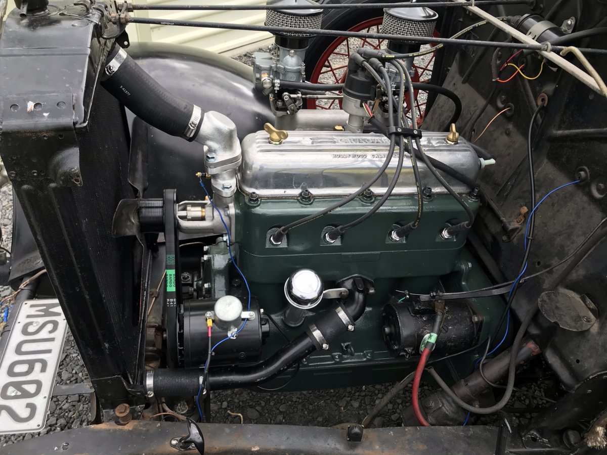

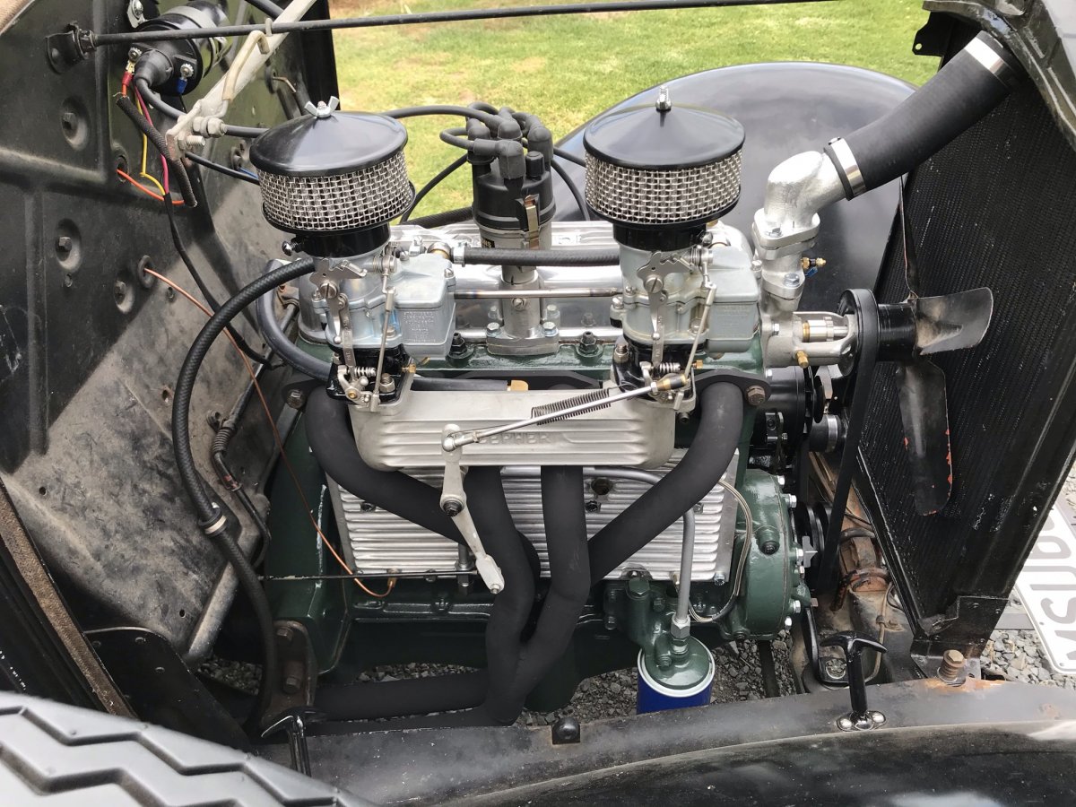

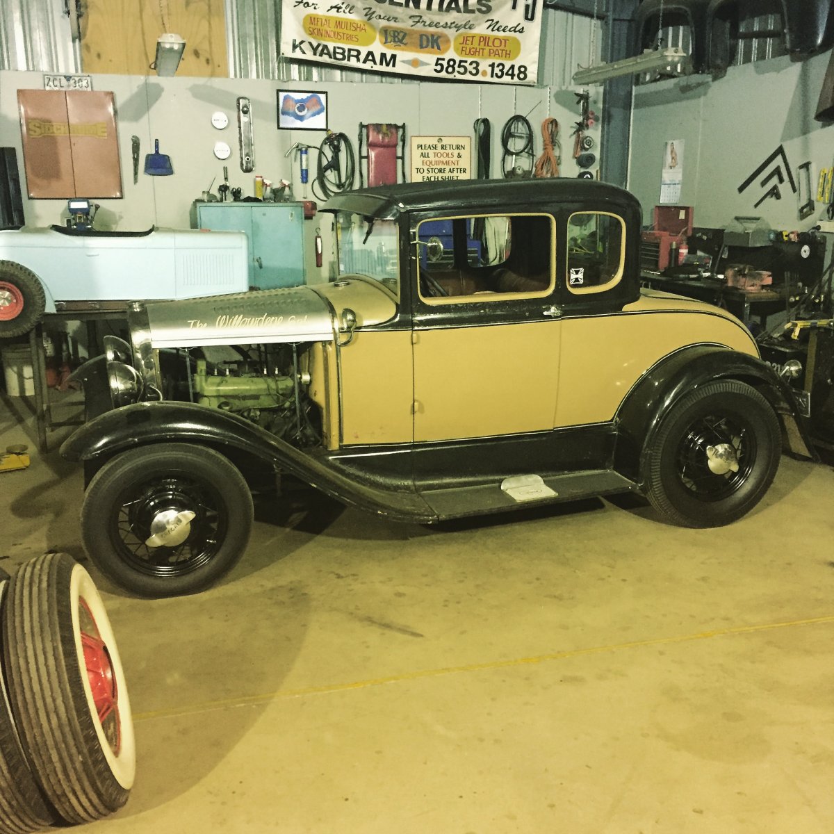

    A bit going on here, a diamond B block , Serr head milled some to raise compression to a useable level, with an original cragar cover. Willys jeep rear main seal, 440 Chrysler oil pressure relief and filter , full pressure oil system, chev 348 BB pistons, light flywheel , stipe timing gear, FS ignition , home made thermostat housing ,home made headers. Medium cam ground in NZ.Murray horn front damper.its no longer a rolling road block ,but at 90 your butt crack isn’t very big. All we aimed for was to cruise at 60 all day ,which is the limit here in NZ. E2325996-0486-41FF-8430-EF7FC56EA467.jpeg 92BDCDEB-614F-47BE-B81E-18D7CA1DECD2.jpeg

    Grace and co air cleaners that we made slightly taller to fit a better k&n type filter. Ha , regarding the carbs we had 5 of the 81 strombergs to make 2 .After 2 days of being unable to get he AF ratio dialed in getting frustrated, we finally found one mischievous 81 body was porous. Dang it all , luckily I had a new pair of 97s on the shelf which made turn around time zero , so the paint is what stromberg use.

    It's all looking good , does it live up to expectations, I know you and your engine man put max effort into the build. Which trans did you end up using?
    But it all looks far too flash for that modern truck, you better drop it off here, I will run it in for you in an old roadster get it patina-ed up for Wendy's truck.

    B4 trans with 39 gears . Had a 5 speed with the jeep TT conversion, but she who must be obeyed said nope to that idea. We do have a couple of 5 speeds in rods . I presume the same rule will apply if we get the T roadster we found with a seized motor, no upgrades.
