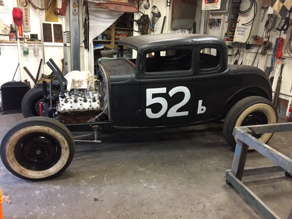

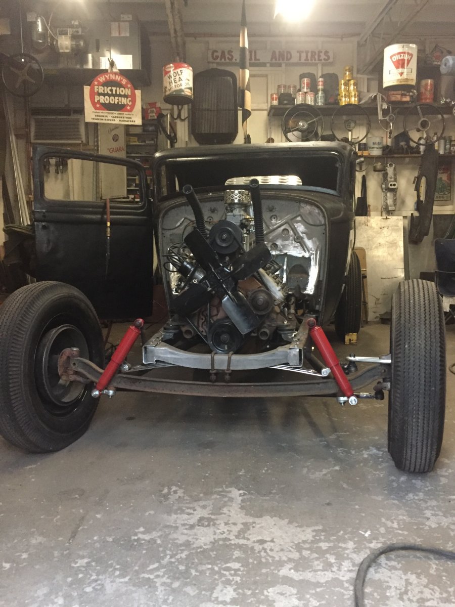

    I see you raised your front motor mounts up. Was that so you could get oil flow back to the pump??? On My AV8 I am noticing that my engine is not level. It tilts toward the radiator. I would like a slight tilt back toward the trans and I think you just showed me how to do it. Thanks.

    I raised the front motor mounts to align the lower water ports. It's much easier to find straight radiator hose than S-curved ones.
    The last flathead I did was in a model A coupe, the motor was lower in the frame which made the hoses a huge pain in the ass...so I made sure these ones were level.

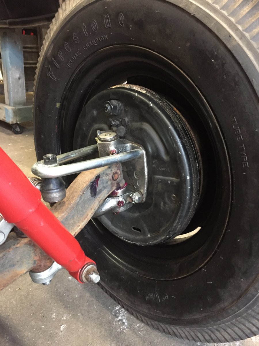

    Got the front end tidied up, new king pins and F1 brakes.
