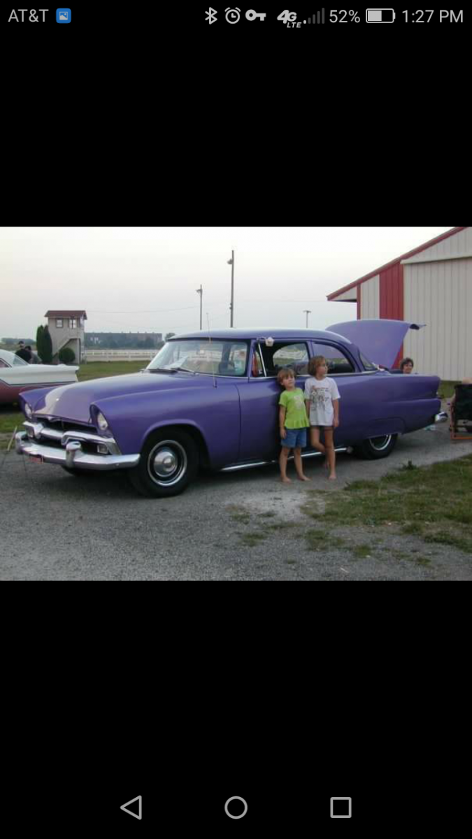

    Pics below are from a 96, expo show. The other is how she sits now after neglect.
    Color will stay plum crazy and will look just like the photo from back then when finished.
    It will be an honor and walk down memory lane to revive her again!

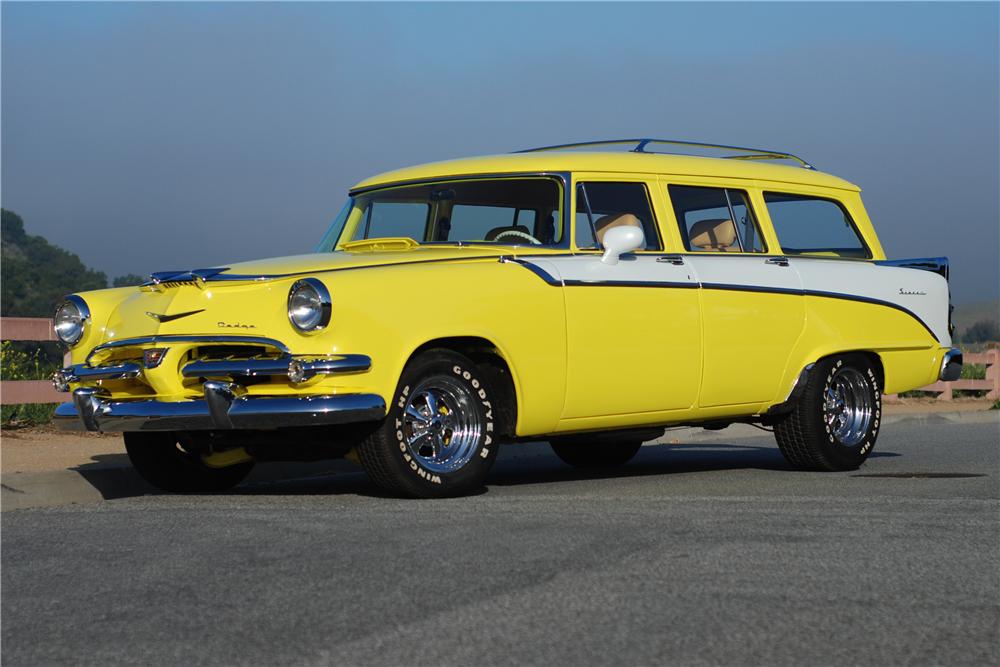

  30. low budget
    Joined: Nov 15, 2006
    Posts: 5,564
    low budget
    from Central Ky
    No just a pic I ran across that I like
