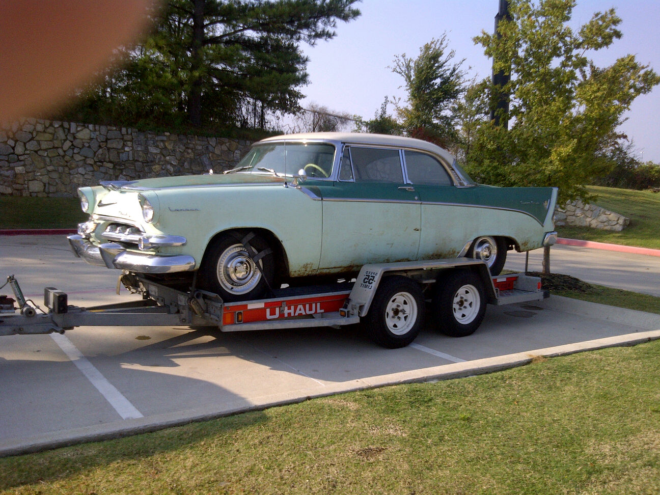

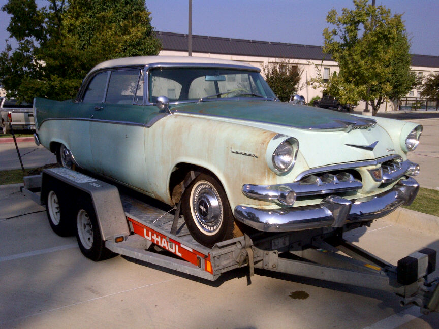

    Hi all,
    Been a H.A.M.B.er for several years, never knew this thread existed! I bought this '56 Custom Royal Lancer out of a barn in Michigan 2 weeks ago. 30,447 miles, runs and drives. Paid a serious amount, but it's a real one owner, parked it in the barn in 1964.
    Looks like it has rust, but it is totally solid everywhere. Only surface rust on the outside, where the barn wasn't real waterproof. Still has wide white 7.60-15 spare in the trunk, along with the jack.:p
    I'm trying to decide whether to paint it or just wax it real good. Interior is perfect appearance, including that fabulous white steering wheel plastic, but the windshield rubber is shot, so the rug will be history soon if I don't find a replacement rubber seal. Also need a cigarette lighter knob and a radio pushbutton. Everything else is there! (if anyone has those, send me a pm).
    Has new brakes belts, hoses, but it's all old brakes. Seriously considering the ECI front and rear brakes. Anybody have advice on adjusting the shift cable, speak up. I got info off the forward look and a literature copy from the Chrysler owners site, but it appears to be alien to my thought processes this week.:eek:

  23. What a great survivor! Try a little premixed concrete cleaner on an inconspicuous spot of surface rust. I did on my '42 parts car's fenders some time back...took rust off and left the paint. Worth a try!
    Btw...your car's the same as mine was originally.

    I'd second that suggestion. Here's a post on another message board with pictures showing how a guy cleaned up a '59 El Camino with CLR and a Scotchbrite pad. (Here's the thread that post is from.)
