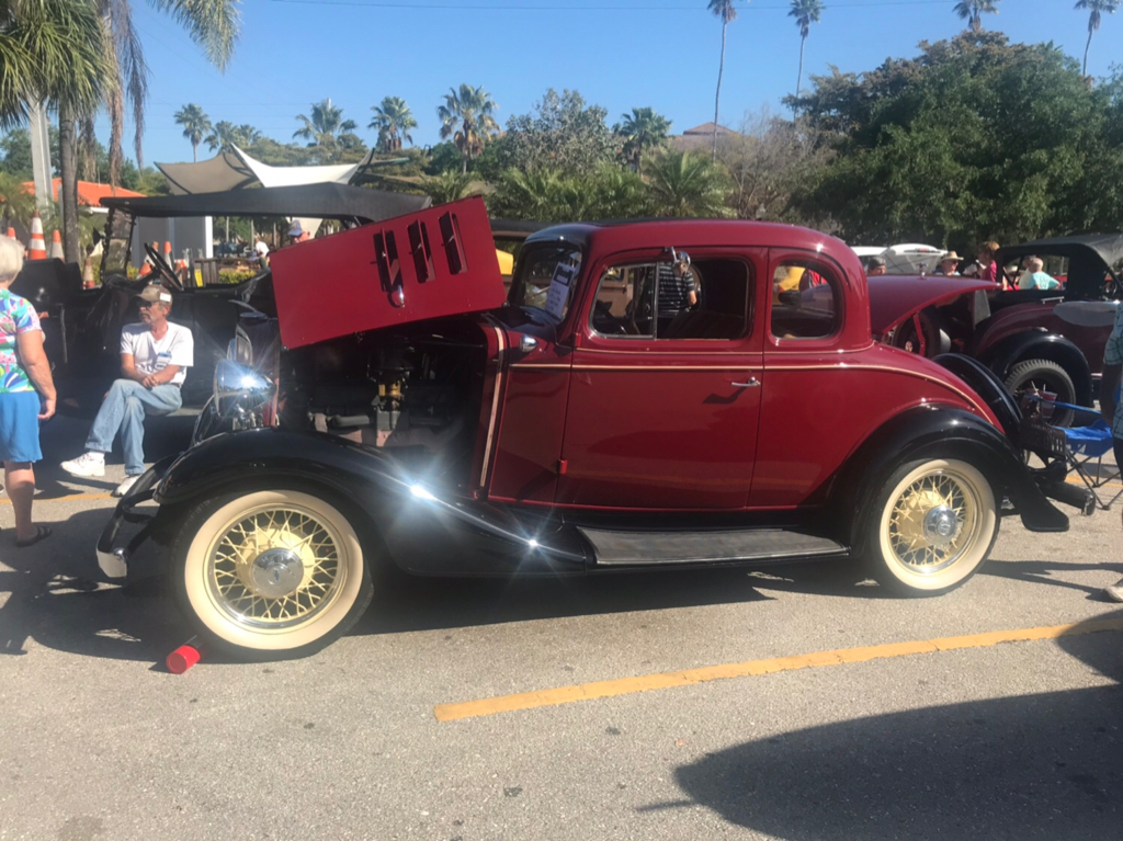

  19. ^^^^ Nice looking Chevys!
    Are the door handles on the 33 upside down?
    biggeorge and Bowtie Coupe like this.
  20. look like it to me. he probably put the one with the lock, mistakingly, on the driver side.
    29bowtie, Bowtie Coupe and biggeorge like this.

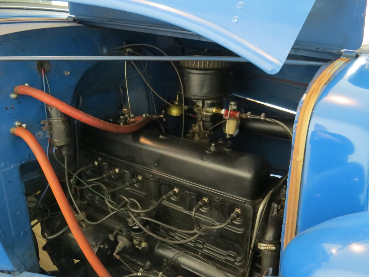

    Here is my motor # is a different set of #s from the Vin#

    The engine # is stamped on a raised boss on the right hand side of the cylinder block, just back of the fuel pump. It doesn't correspond with frame number. That looks to be a raised casting. Try that pad

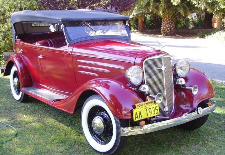

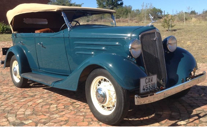

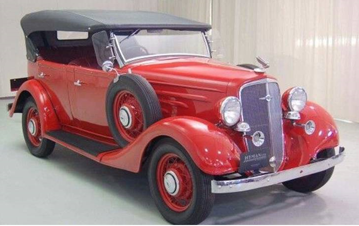

    OEM RHD Canadian / US bodied 35 in Sth Africa
    OEM RHD Canadian / US bodied 33s in India. I was actually surprised as to how many OEM RHD Ford & GM cars of this era I could find via Dr. Google.
    RHD GMH bodied 35 in USA, first time I've ever seen a top boot to cover the roof when stacked.
    This a friend's RHD GMH bodied 35 that was sold to the USA, 6-wheel equipped
    This is his current restored RHD GMH 35, still over here.
    A possible future project, a 35 GMH Master phaeton

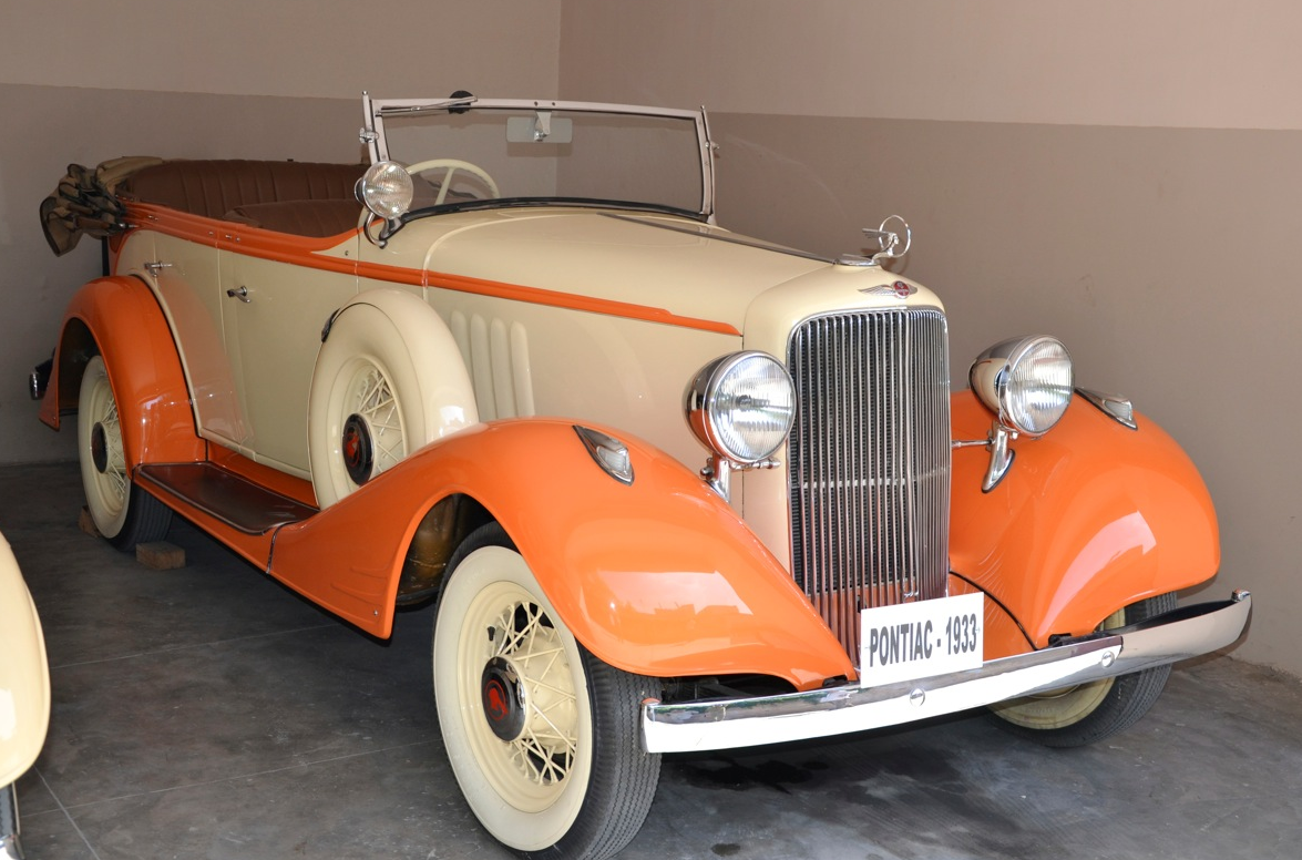

    Not a bowtie but a rare RHD Indian (Pontiac) in India, I've never seen one before. Again OEM RHD Nth American body.

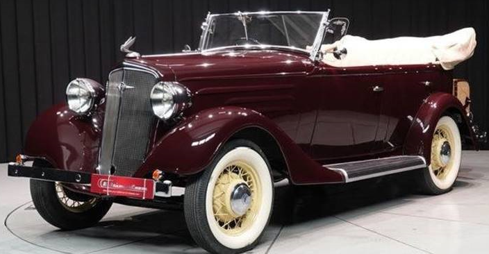

    RHD GMH bodied 36 phaeton in USA
    RHD GMH bodied 36 roadster in USA

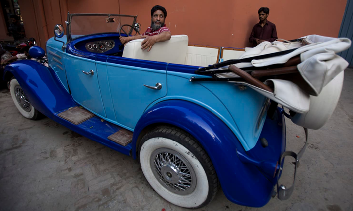

    OEM RHD Canadian / US bodied 34/5 in Pakistan, damn they're everywhere :D Non OEM front seat, running board step plates, wheel covers and rear wheels suggest something amiss? You can really notice the wheel arch pressing and that curved pressing in the rear 1/4 compared to GMH bodies.

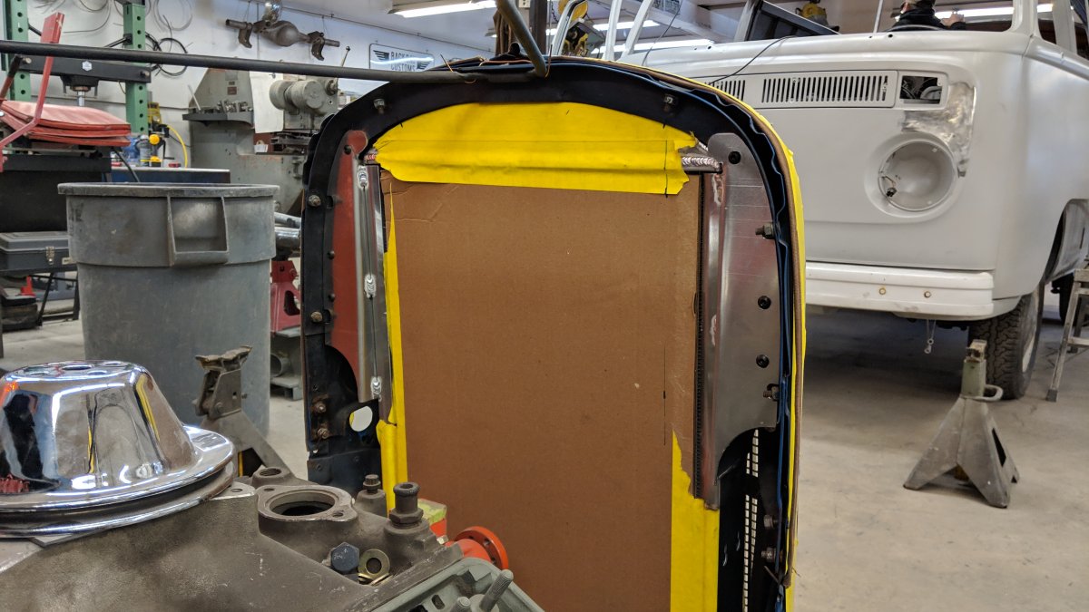

    Mark sounds like a great plan on your grille plus you got to add your grille Chevy Bowtie!

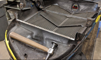

    Here's a few shots of the radiator mounts and the notch I put in the gravel pan.
    The mounts I welded on the sides are 1/8" 5052 aluminum and use the factory mounting holes. They guide the airflow on the upper half of the radiator and the curved pockets allow easy access to the headlight mount and wiring without unbolting the radiator. I also moved the brace behind the grill forward 3/8" to give more room to move the engine ahead. I just turned two rings on the lathe and tacked them on the brace.
    Under the mounts, I will make a small shroud on each side that will seal the grill shell to the radiator, down to the modified gravel pan. The pan was simply marked, cut and a .5" lip tipped to add strength. I tig welded small strips of steel to the sides to complete it the lip.
    Plus the load of the grille shell will all be tied in thru the new radiator and mounts!
    Mark do you think by adding just the 1/2 inch bend lip that my ‘V’ bar will be strong enough without adding a 1/4 inch rod?
    Rory

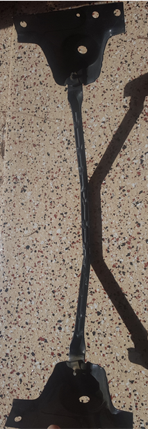

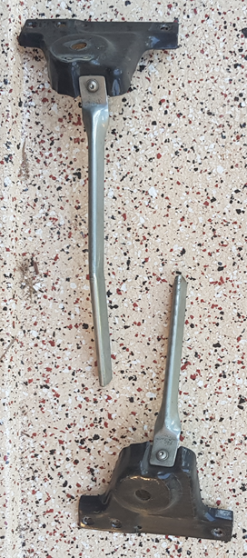

    My 'V' bar was 1/8" thick and only took 15yrs to break from fatigue, plus the radiator itself didn't have straps from sides to top & bottom tanks. You should be OK however I used reinforced rubber insulation between lower core support and front X-member and where grill shell bolts to lower core support. All the weight of front sheet metal, hood and radiator is on that core support (2x bolts) which also bolts to both front fender supports. I just wanted everything as firm as possible and minimise any movement. Like your frame, mine is fully boxed with 35 style X-member to minimise any torsional twisting.
    Very poor manufacture by 'Aussie Desert Coolers', at least it hasn't leaked like many others I know of. I've not heard of one that's directly bolted in, the one's others I know purchased and helped fit all required new mounts fabricated from new to fit.
